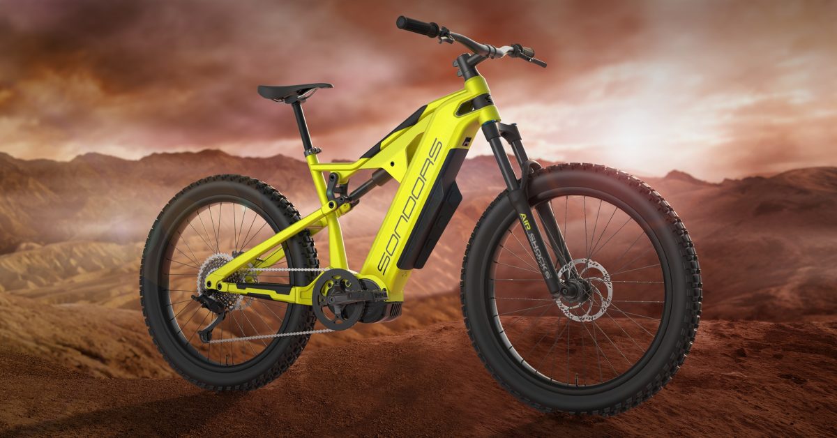

That full suspension model for $2.5k is a great deal for Ultra powered ebike.
Frey EX killer? 😲
I'd be very interested in the quality of components on the bike. The shock are call "Air Shocks!". Wondering whether they are trying to hide the component quality by removing the manufacturer labels. 🤔
I am shocked. Not one other manufacturer has ever done that!!! Not!!! 😂😂😂
Cruiser has the same motor as the other 2 new bikes. I think Sondors will sell a lot of these. They really nailed the gap when it comes to affordable higher powered mid drives.
And they come in racing slicks for track days! 😆
We're not. I'm actually very impressed that they are able to do this. But at the same time, very curious how they are able to pull this off. This will definitely be disruptive to the ebike market if the bikes turn out to be good quality.

Sondors has just revealed three new high-powered electric bicycles known as the Sondors Rockstar, Cruiser and LX. The new models are part of the company’s not-yet-released Elite line. They feature stunning new frame designs, huge 1kWh batteries though the low introductory prices might actually be the biggest shocker of all. The new Sondors Rockstar, Sondors LX and Sondors Cruiser appear to feature the famed Bafang M620 mid-drive motor, also known as the Bafang Ultra, which is known to put out more than 1,500W of power and a stump-pulling 160Nm of torque.
Sondors indicates that they are running 25A controllers, which would limit the motors to around 1,200W – a figure that is still quite powerful for anything with pedals.. The motor is a favorite of high-performance e-bike enthusiasts, though its sheer power and torque can be tough on bicycle components. The Bafang Ultra is known for sending countless chains and sprockets to an early grave. I should know – I, unfortunately, destroyed a perfectly good chain with this motor in less than 5 minutes at Eurobike 2019.
I think maybe the most shocking thing about these bikes is how well they are designed
These prices are pretty nuts, in a good way. For a Bafang Ultra motor and 1 kWh battery, let alone the impressive and novel frame designs, this is a great deal. But I’m approaching this with cautious optimism. On the one hand, these specs at these prices are essentially unheard of. But on the other hand, I’ve yet to see one single photograph of the bikes. All we’re getting right now are renders of what the Sondors Elite will presumably look like.
That being said, Sondors has a history of making bold claims and then mostly sticking to them. So if they say they can produce these bikes at these prices, I’m inclined to believe them at this point. I was a Sondors skeptic back in 2015, but I’ve seen them put enough bikes on the road now that I’ve become a believer. That doesn’t yet translate to their mythical $10,000 Sondors electric car, but I’m a believer in the e-bikes at least.
Between these three bikes, the Sondors Rockstar is my favorite, hands down. At $2,499 it is an incredible deal for a bike of this power and design. I’ve put around 70 miles on the FREY EX in the last week or so (seen below) and while I don’t expect the Sondors Rockstar to compete against the FREY EX on build quality, it seems to severely undercut its $4k price.
There are only two things that give me pause here: 1) we have no idea whether they are putting decent suspension or bargain basement springs on the bike, and 2) they are neutering the 1.5 kW by around 25% of its power. For the first, we’ll just have to wait and see what kind of shocks Sondors will give us at these prices. For the second, this could be an effort to make the drivetrain components last longer, or it could signify a weaker battery that can’t handle the peak power of the Bafang Ultra motor. Again, we’ll have to wait and see.
For now though, I’m quite impressed with what I’m looking at. Sondors has always made big promises and this new announcement is no different in that regard. What is different is that Sondors is now stepping out of the value-oriented e-bike space and appears to be edging dangerously close to the premium category of e-bikes.
