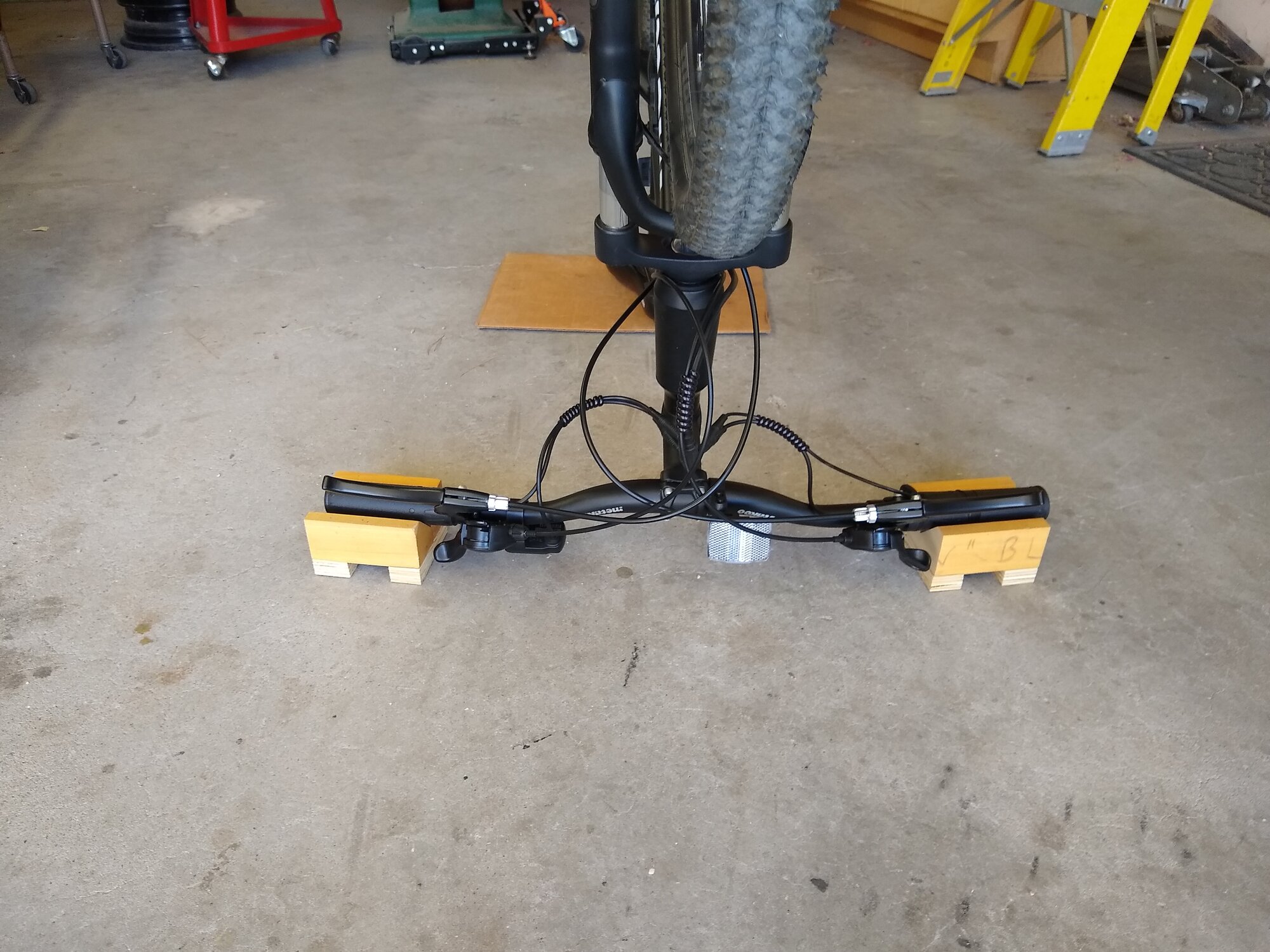

I had a flat tire almost immediately after getting my new e bike. I t didn't take me long to figure a I needed a way of working on the bike, sometimes with it upside down. I made a couple of "V" blocks to fit under the grips to keep the display and controls safe. A cheapo bike stand I guess.

Yet another advantage of adding bar ends to your handlebars. They are there to help you when you're out in the field and you need to invert your bike.

Good innovation and skillfully done. I will run across a 106 pound Grizzly fat bike with flats and they are too heavy for a bike stand. You created the answer.

You know that imitation is the sincerest form of flattery - therefore consider yourself flattered!
Out to the garage/workshop to see what materials are in stock...

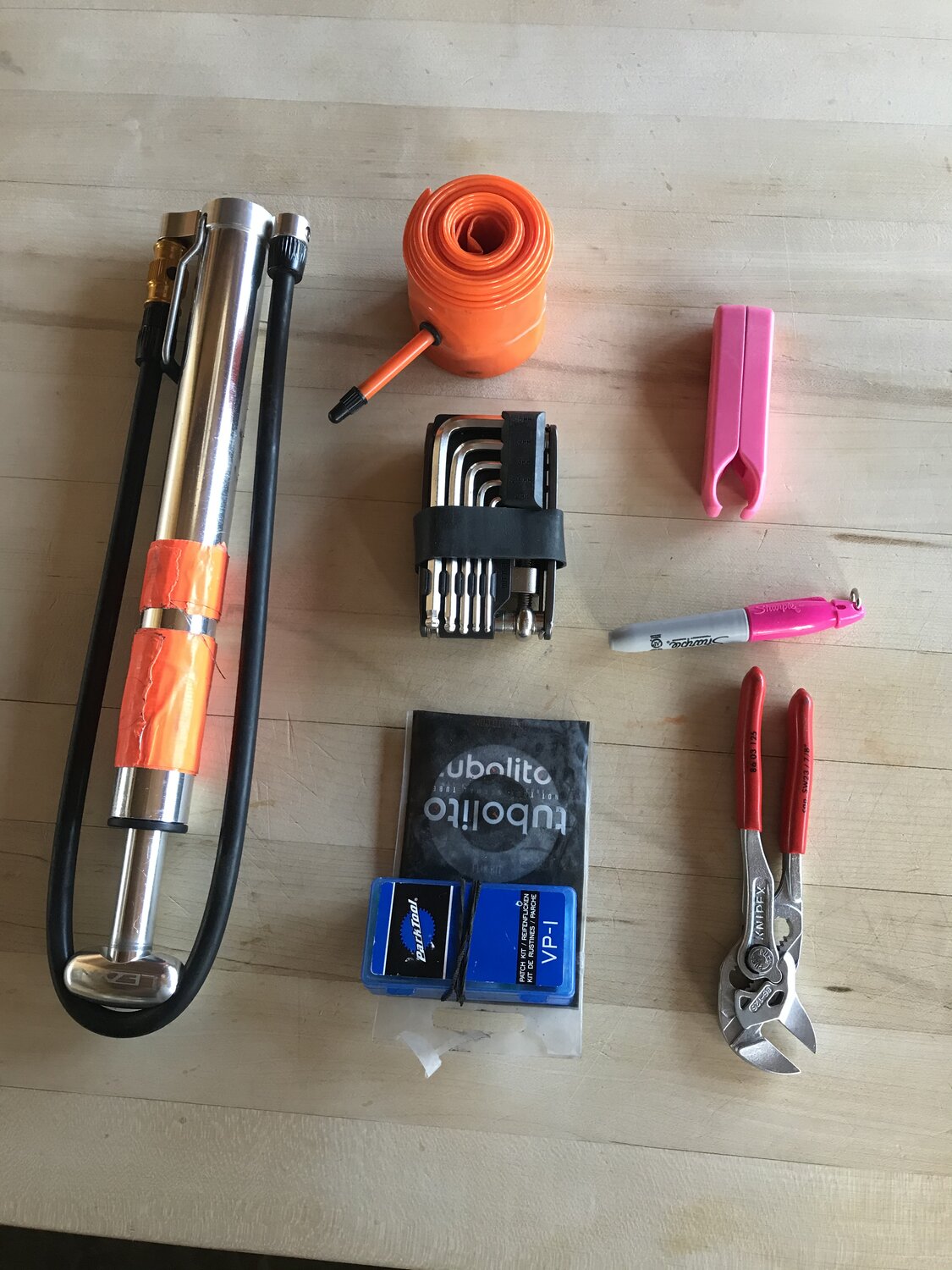

Every ride carry:
The Lezyne Micro Floor Drive pump moves a lot of air, but it has a tendency to unscrew Presta valve cores if you aren't paying attention.
The Blackburn Wayside Multi-tool has pretty much everything you'd need and a few things you probably won't. It does have a tendency to rust if it gets wet so it is carried in a ziplock bag in the frame bag.
The Park Tool VP-1 Patch Kit is nice and compact, but I replace the patches with the superior patches from a Rema Tip-Top Patch Kit.
The Knipex Mini Pliers are perfect.

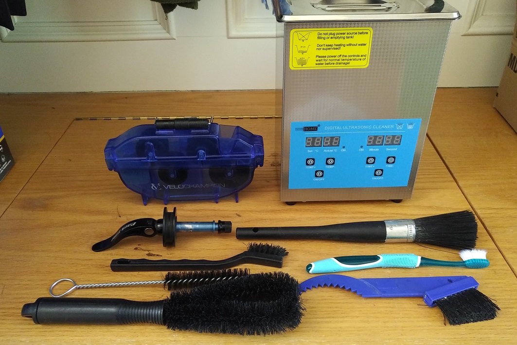

The chain scrubber with its rotating brushes is a handy device and teamed up with a chain keeper is a quick and easy method to brighten a chain and conveniently unclog the pulley/tensioner between rides. The Park Dummy Hub, for instance, can be fastened directly to a bike drop-out or can also be slipped onto a thru axle up to 12mm.
