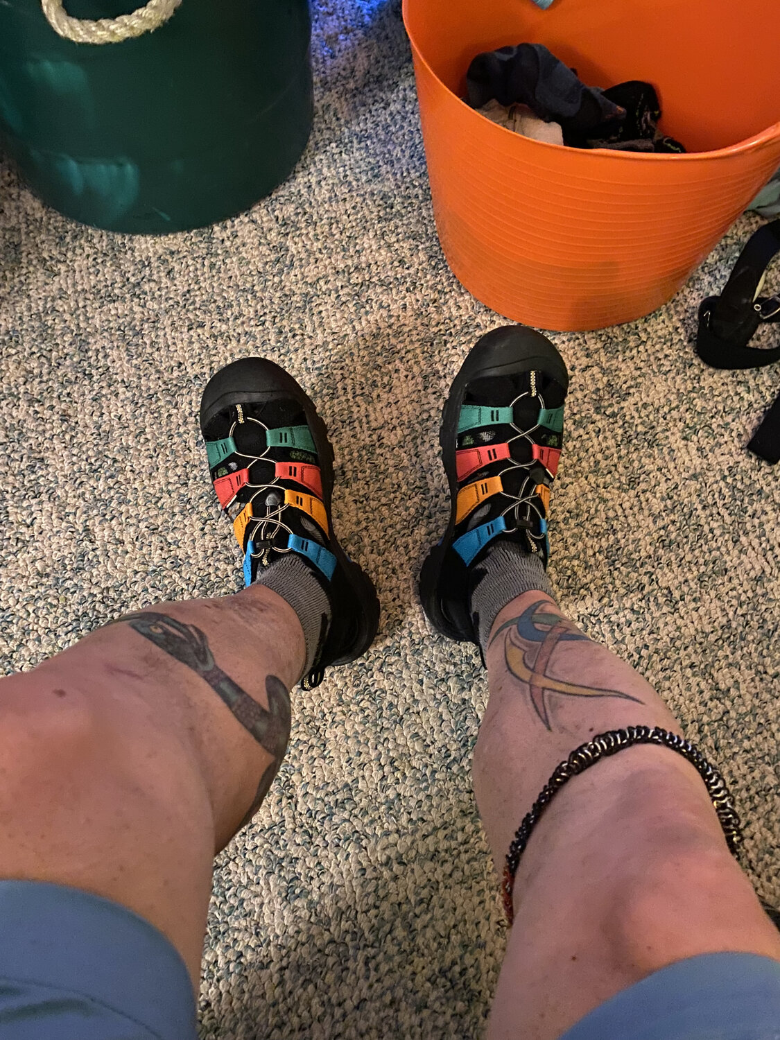

first time I ever found any keens in a less then butt ugly color in my size 14. I am always stuck with the ugly colors.
Size 14?? Contact the Navy, maybe they have a spare pair of aircraft carriers for your feet... 🤪 But remember, people with large feet have greater under standing. 😄
