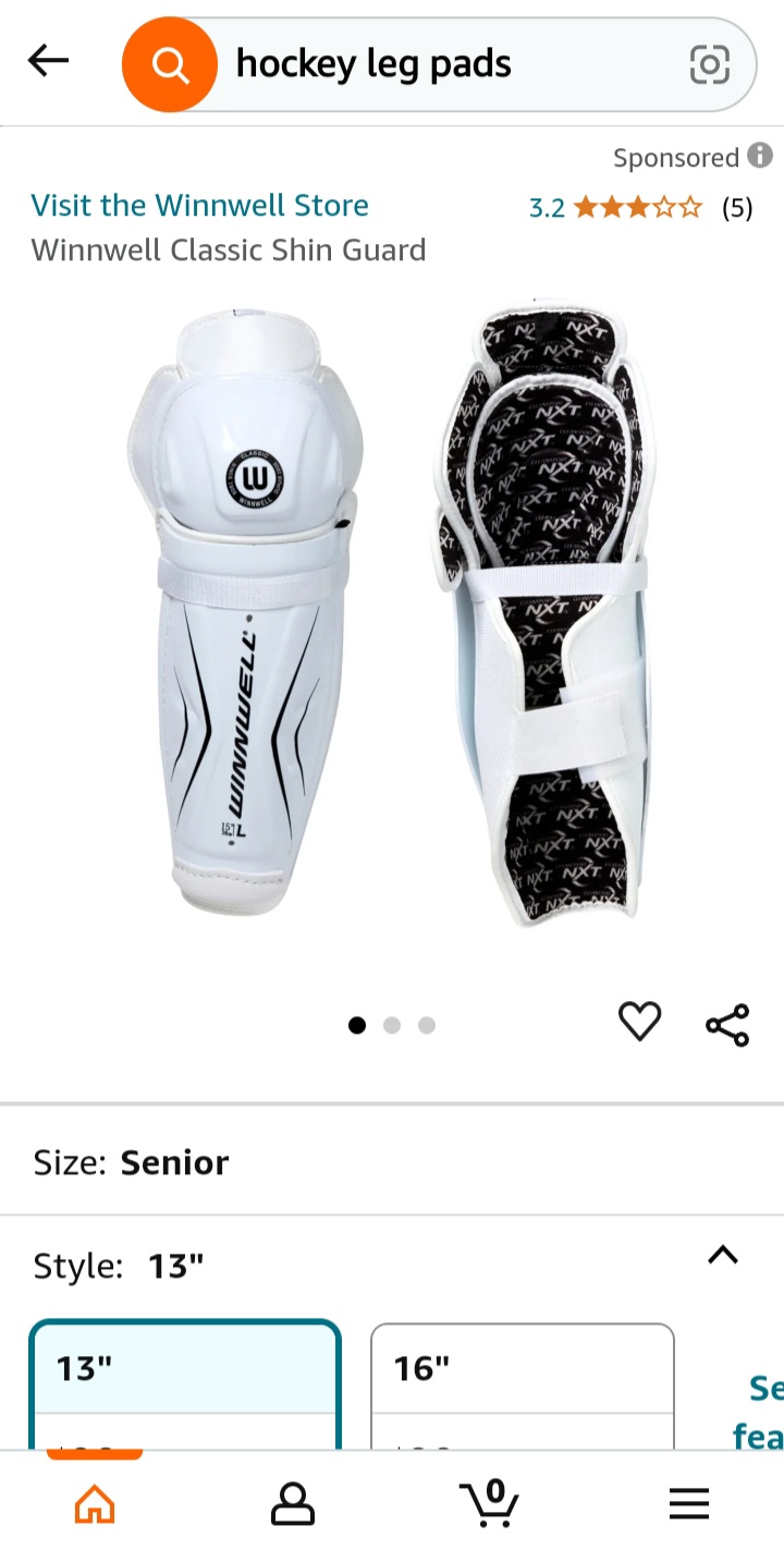

I'm thinking maybe a little more protection than a leg kick and more like a hockey 🏒 or ice ⛸ to the leg?
Maybe something like this is more appropriate?,..
It'll fit under loose fit clothing, and they make a seniors size. 🧓 😂
