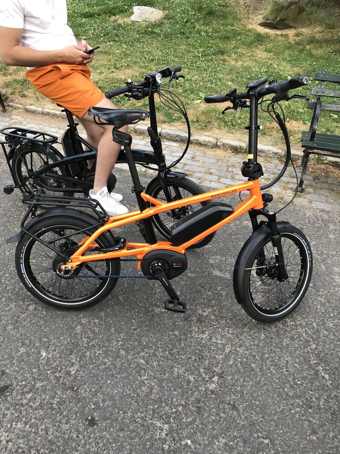

Thank you! The reduction gear, enviolo, and gates belt combined create significant resistance past 20mph. It is not a HS pedelec so I wouldn’t go into the vario version with the mindset of going past 20mph. However, the CX torque is a treat, basically you are going either 20mph or 0 based on my riding this weekend lol.
I wish I knew if R&M were updating the Tinker. My guess is yes which sucks because I just invested in this one. However I have a feeling the price will go up too if they add a powertube, Gen 4 motor.
Yes, you notice the reduction gear. If speed is important, get the hs for sure. I’ve never cared about that but tbh this bike is so much more fun than my last ebike I might reconsider if I had to do over again.

Took delivery 2 days ago :) View attachment 56999
Hi, just wondering how you find your new Tinker? Can you provide an update? I am too looking for a nice compact bike and now deciding either to get a Tern HSD or R&M Tinker. I don’t need any cargo capacity. I test ride the Tern and very impress with it. However here in Australia the Tinker has completely sold out and no bike shop has one for test ride. My concern is it’s weight. It is smaller but weight same as a full size bike Do you find it to be heavy at 25kg? It also seem to have higher centre of gravity compare to the Tern. How do you find the ride and the stability? The waiting list is 2 months here in Melbourne to order from Germany for a R&M Tinker and I try to get as much info as possible without a test ride.

Built one of these last week - was not impressed with the Gen3 Performance + Vario as the system felt very lossy on the Seattle hills compared to the Gen2 CX (go figure)
