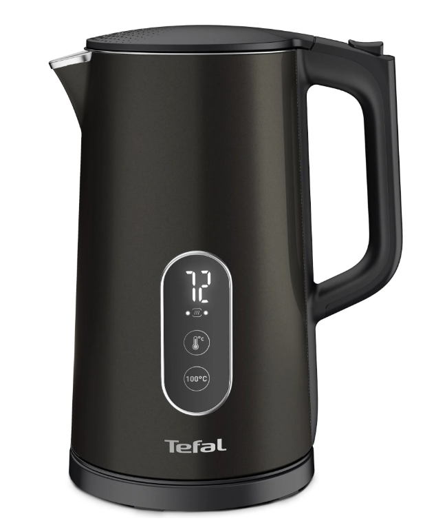

Not sure what you guys use in America but this is what we commonly use in Europe. The electric kettle shows the current temperature of water from the current state to the final set temperature degree by degree (the set temperature can be 40 or 70 or 80 or 90 or 100 C: (The top button is for any of the four settings, the bottom one is for 100 C). The kettle can also keep the set temperature (except 100 C) for 30 minutes.
You boil as much or as little water as you need...

Can yours stop at 60C? Heating only as much as I need saves nearly 2/3. That's what I was after, in the event of a power failure.

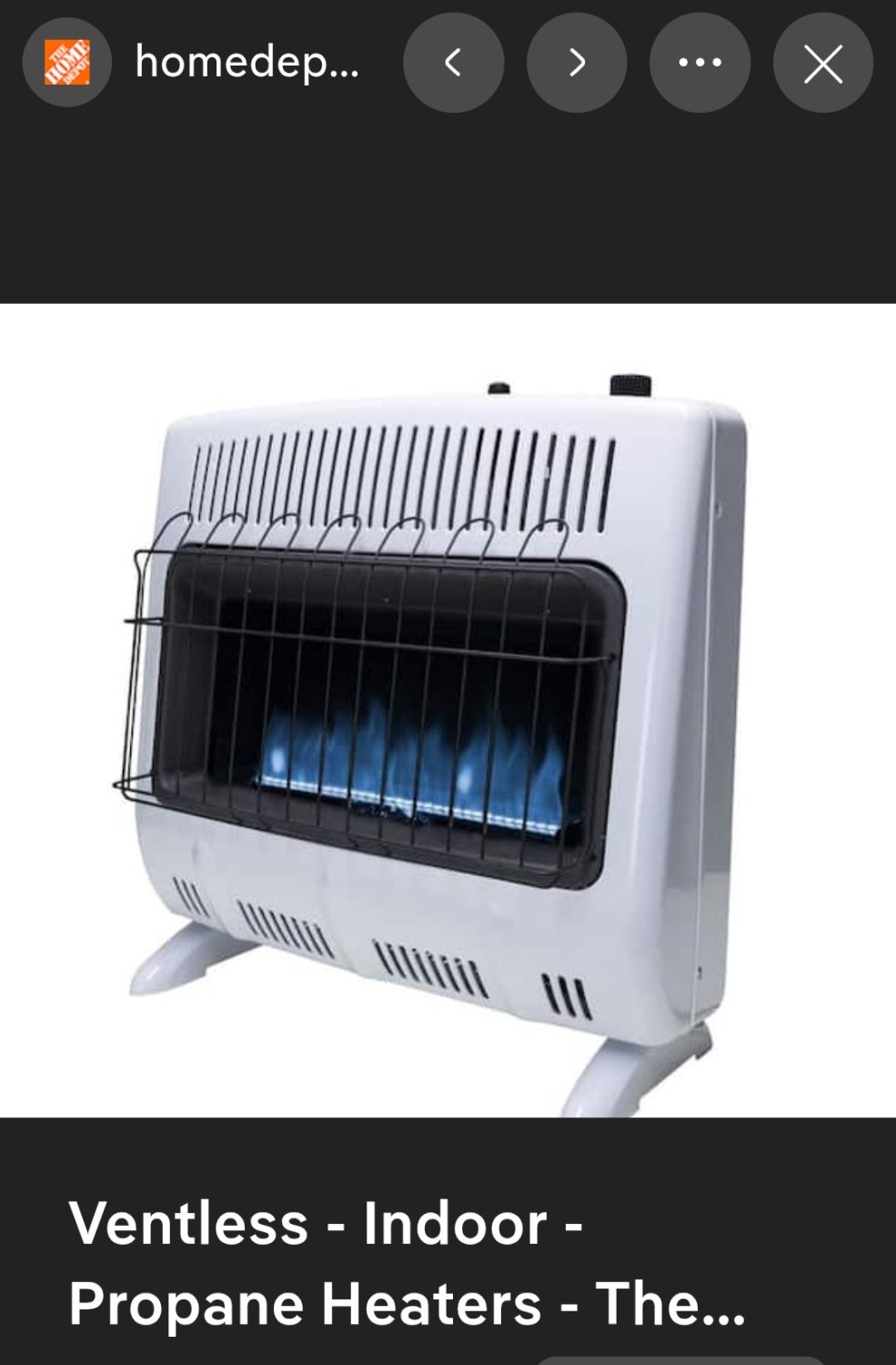

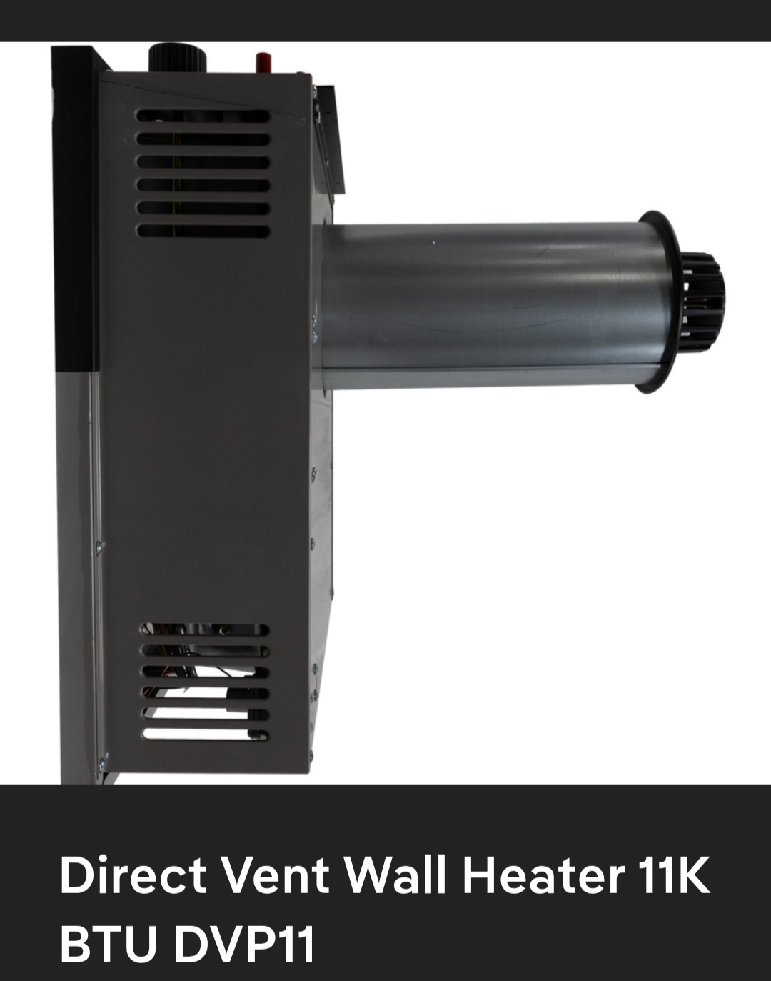

Get yourself a through the wall direct vent gas wall heater.
No electricity. (except maybe a battery to run the thermostat)
They also have propane versions including a small ventless version. (like a catalytic camping heater)
My direct vent heaters are propane (LP). I would not install a ventless heater in my house (fumes and moisture).

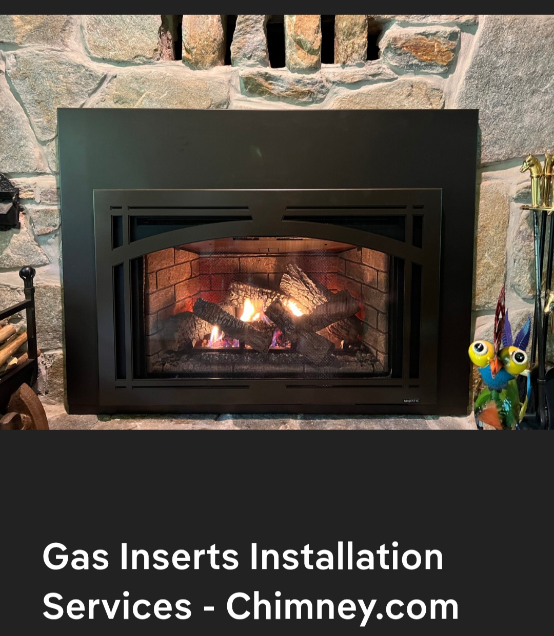

This house was built with 4 coal-burning fireplaces.
You can get a gas fireplace insert.
Cheaper than a new furnace.
No electricity needed, just hook up a gas line.

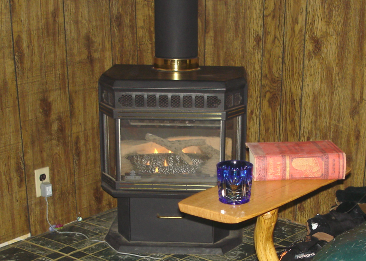

Some electricity needed ... you still would need an electrical connection (usually 110v @100w) at each fire place/insert for the circulation fans, otherwise they're next to useless as a heating source.

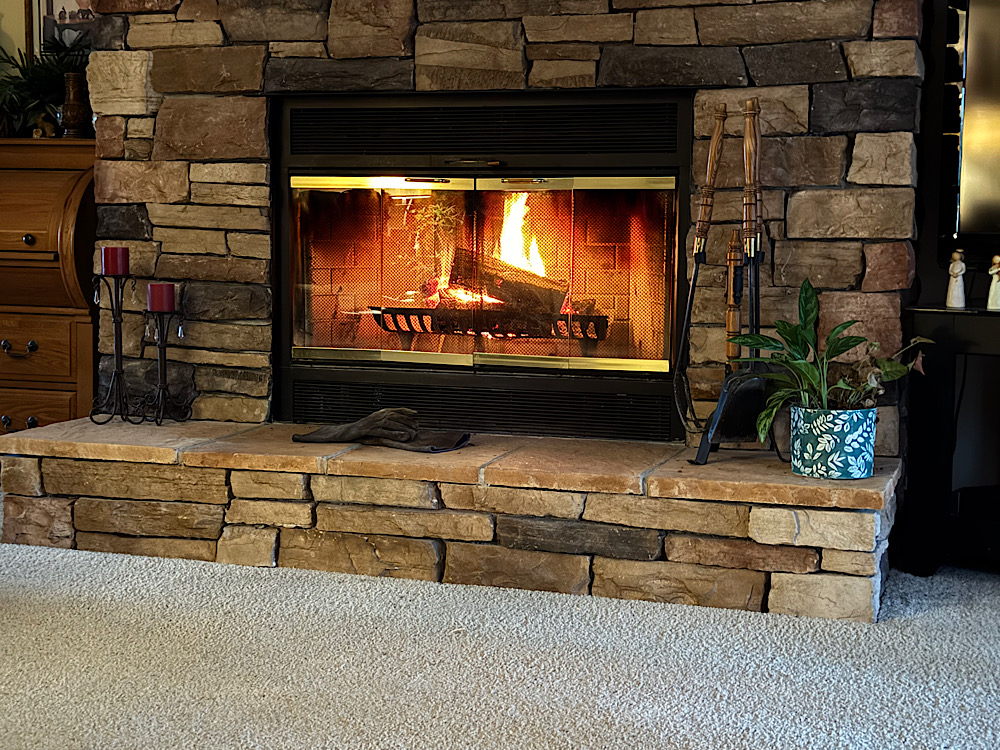

I have a fireplace that would keep our house fairly warm. It has a blower so to really get the heat out I need electricity. I have a 6000 watt portable generator and an inverter I could pull a battery out of a vehicle to use.

This is our house's primary heat. Direct vent propane, 30K BTU, no fan.
Great for heating one room. That's why we don't have one.
Our two back bedrooms each have a 7500 BTU wall mount direct vent propane heater, also needing no power. Between the three separate heaters the house stays warm in subzero (°F) temperatures and there's redundancy.
