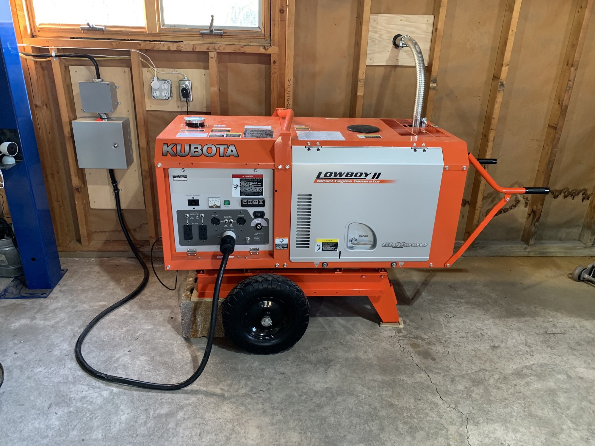

I actually do get some advantage from the waste heat generated by my Kubota GL11000. It's installed inside the garage with a thru wall exhaust. It's liquid cooled and the heat from the radiator keeps the garage warm during winter power outages. No advantage during warm weather though since I have to keep the doors & windows open.

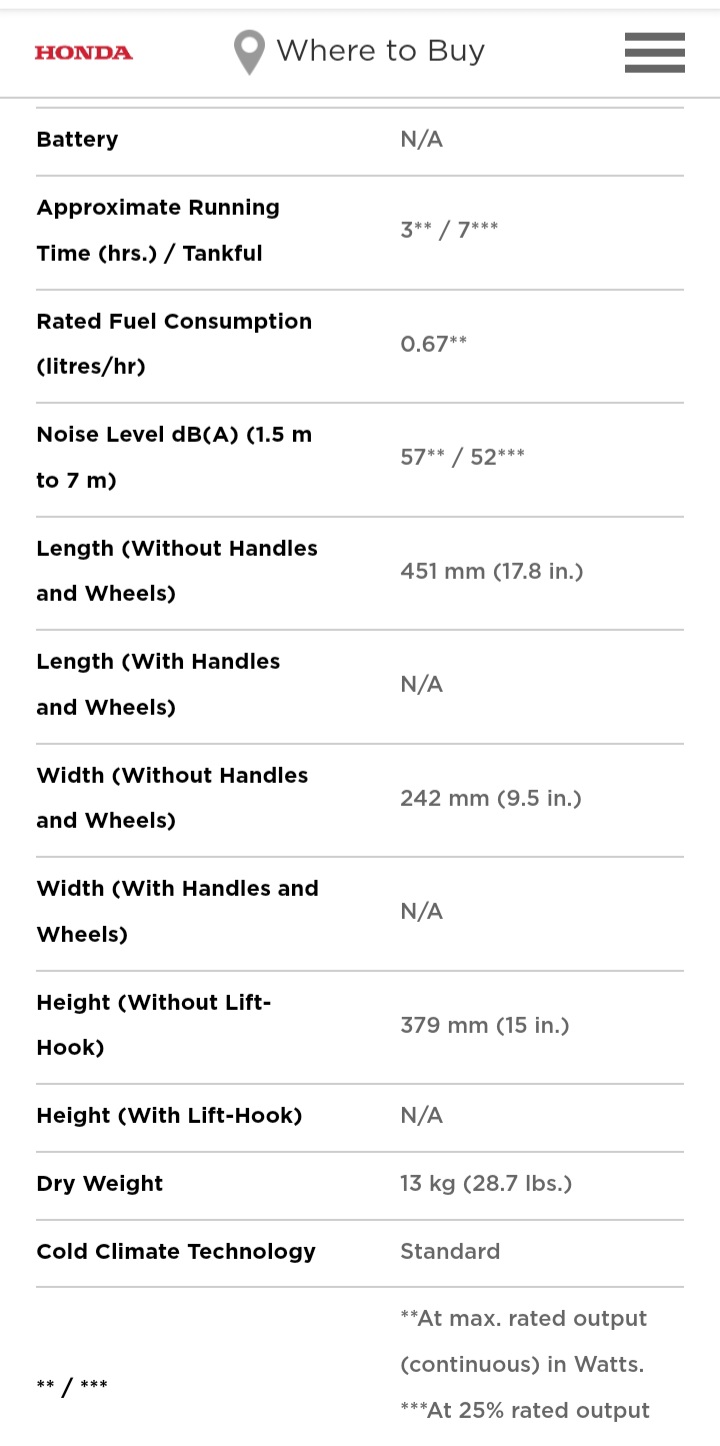

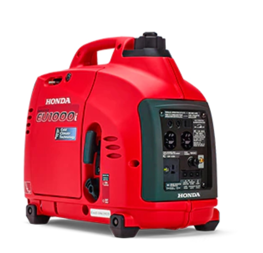

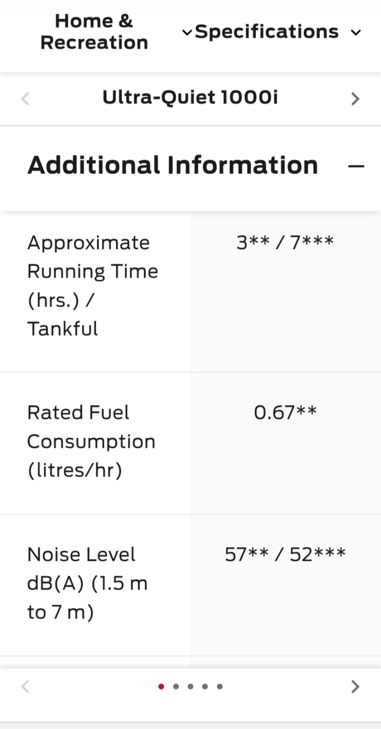

This is the generator that I wanna get,..

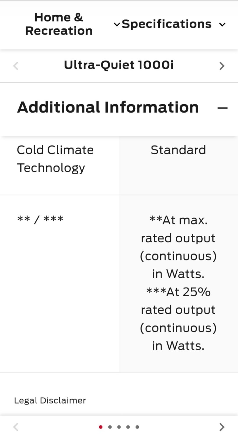

It runs for 3 hours at maximum output (900 watts continuous), so if all things are equal, it should run 4 times longer at 25% output, but it only lasts just over twice as long.
It's only about 30 pounds with gas, so it's easy to carry, and it's just under 50cc so I can use it legally as a bicycle engine.
It is more than the 500 Watt Canadian ebike limit, but if it's powering the ebike with 500 Watts, and charging a battery with the remaining 400 Watts, I might be able to float through the legal gray area. 😁

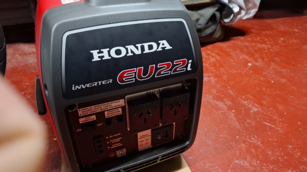

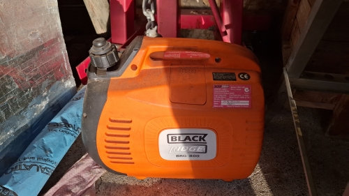

Here is a worthless $350 800W Chinese generator, but it has a really 'Tough' name so would buy it on the basis of that :rolleyes:
I did, I got 6 months out of it. It still works but it takes 10 minutes to start and believe me I know a lot about small engines and have been right through it, just a crap design.

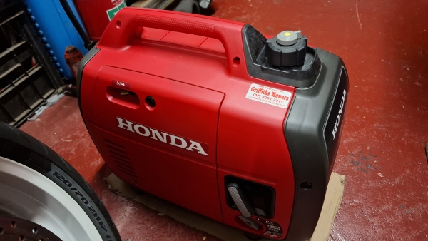

Here is my Honda, Starts first pull, even after sitting idle for 3 months.

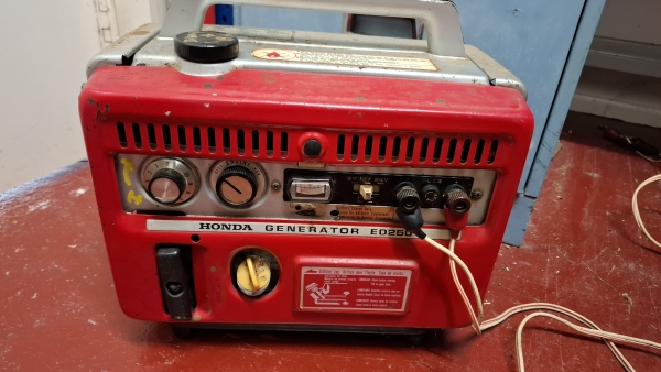

And this little sweetie is a 1966 Honda DC only. 6, 12 and 24V. It takes typically two pulls to start. I use it as a jump started if needed or I could charge my offgrid Trojan battery bank in a blackout if there was no sun was on the solar panels for it. Sniff around and you'll find these, I paid $60 for it but it wasn't running, I needed to clean out the carb bowl is all. It puts out 20A on the 12V setting
