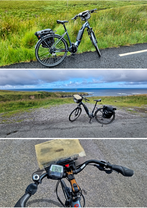

Glad to meet you! I have been to Ireland two times: once to Dublin, once to County Donegal for a longer vacation. What a beautiful country! I even cycled a rented Bosch e-bike to see the wonders of Sliab Liagh!
