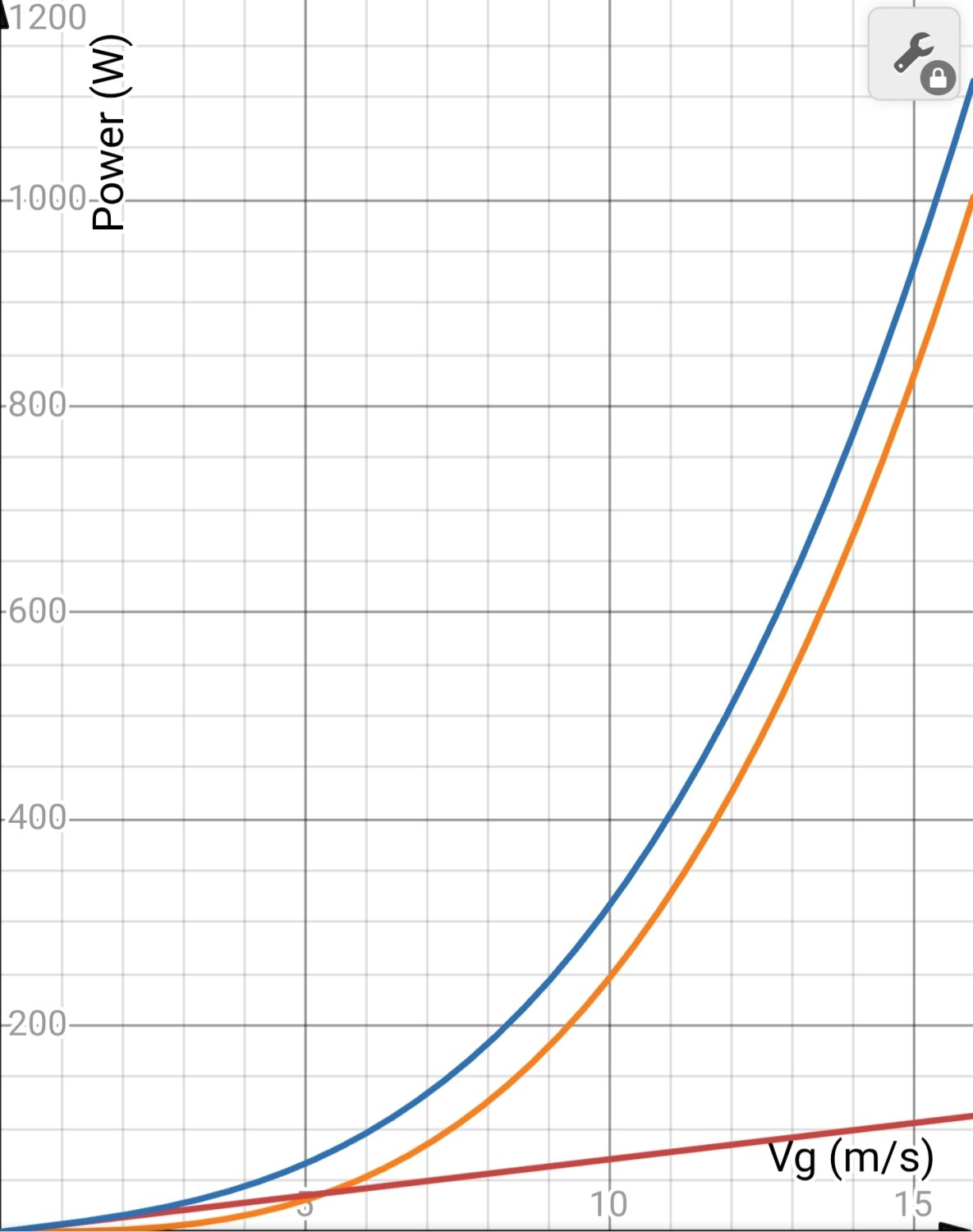

Resistance to forward motion is an ever-present foe in cycling. In the spirit of know thine enemy, here's an interactive visualization of the 3 main power losses due to air, gravitational, and rolling resistance. It's made in the Desmos online graphing calculator.
The visualizer lets you manipulate the key rider, bike, and external factors with 7 independent sliders. The effect on the power-speed profile shows on the graph in real time.
Great for visualizing what-ifs bearing on things like how best to spend your bike money, your battery range, or your own effort.
The interactive power-speed profile
Power-speed profile for a typical TdF scenario.

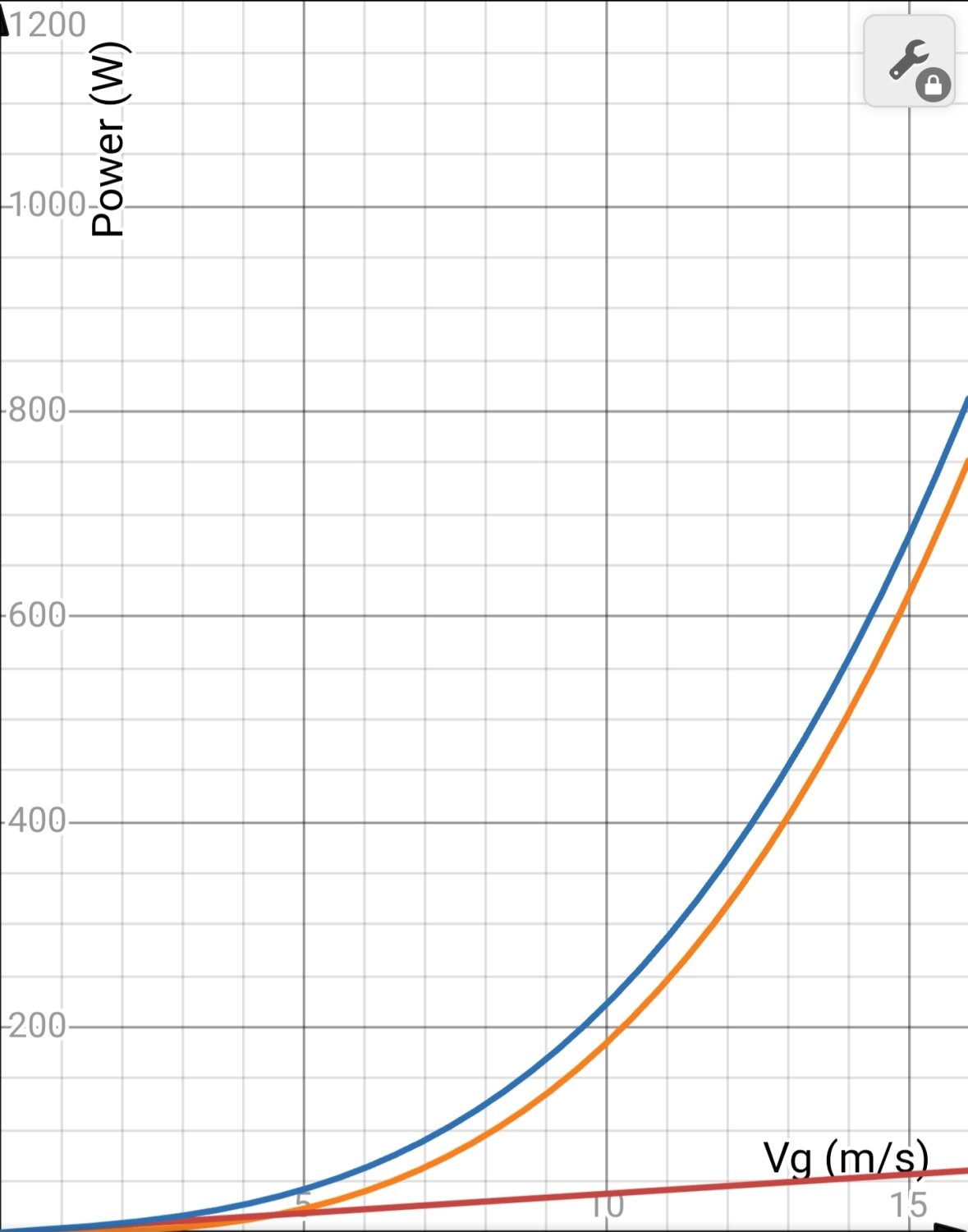

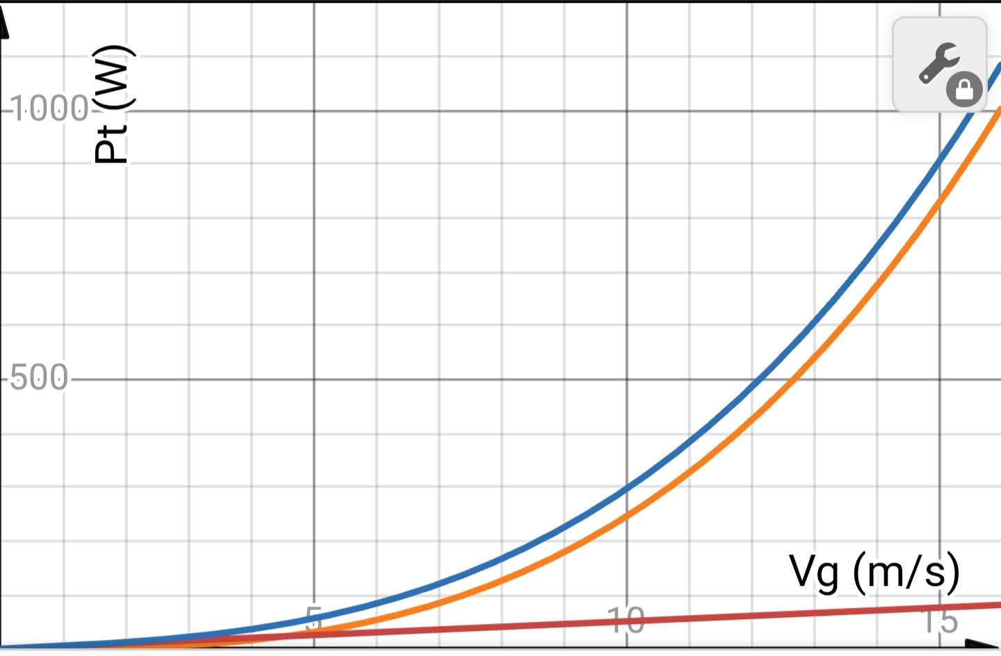

The model graph plots ground speed Vg in m/s on the horizontal x-axis and the associated mechanical power loss in W on the vertical y-axis. The orange curve is the aerodynamic power loss Pa as a function of Vg. I think of this kind of plot a power-speed profile.
The red profile shows the weight-dependent power loss Pw due to gravity and rolling resistance combined. This profile rises as speed, system weight, and especially gradient increase.
The blue profile shows total power loss Pt = Pa + Pw. Blue is the mechanical power needed to hold speed Vg with the parameter sliders as you left them. The few watts of drivetrain losses are ignored.

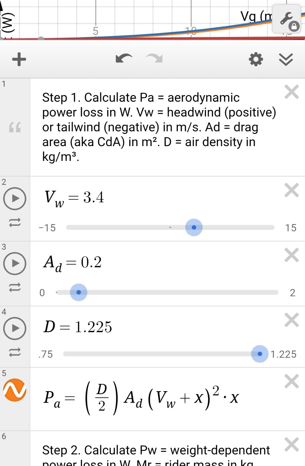

The headwind, drag area, and air density sliders determining air resistance.
Below the graph are text lines for symbol explanations and slider lines for playing around with key parameters like bike mass Mb and system drag area Ad. Don't worry, the sliders are the only things you need to pay attention to here.
The default slider settings describe a best-case Tour de France scenario on smooth, flat pavement in still air. These result in the power-speed profile above.
Power-speed profile with my own bike and rider parameters.
The sliders are there to be played with. My own bike and rider parameters produce a power-speed profile significantly taller and steeper than the TdF profile above. For example, on flat pavement in still air, it takes 225W to go 10 m/s (22 mph) in the TdF case and 320W in mine. About 80% of the 95W difference is aerodynamic.
Other lines set constants or do the actual math and graphing. Diddle with the sliders all you want, but messing with anything else will likely break your local copy of the model.

Example: When does bike weight really matter?
Set the sliders for you, your bike, and a familiar flat ride with gradient G = 0. Then watch total power loss Pt (blue profile) as you play with bike mass Mb. Note how little Mb affects Pt on the flat. Now repeat with the gradient upped to a steep G = 0.1 (10%). Pt's much more sensitive to Mb now.
So, if you ride only on the flat, improving handling is the only real reason to spend $$$ lightening your bike. However, different story if you ride a lot of steep terrain.
Example: Crossover speed
The intersection of the orange and red curves shows the "crossover speed" at which the aerodynamic loss equals all other losses combined. It may be lower than you think.
Now watch how crossover speed changes as you vary the drag area Ad and bike mass Mb. How's your upgrade money best spent? Lowering Ad with more aero clothing or a less upright posture is generally much cheaper than shedding even 1 kg of bike mass.

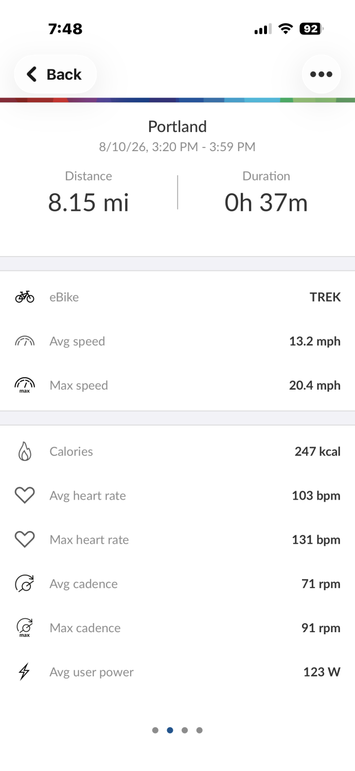

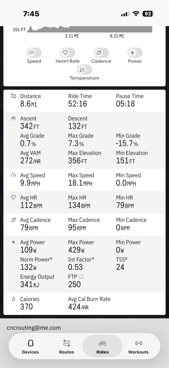

I don't need perfect but I just want an idea on what I am doing. here is my regular bike. looking at the data it would look like I should burn more calories on the trek.
and the trek.
and the trek.
If both data sets were from the same route ridden the same way, comparing the 2 bike's kcal per mile figures would be a good start.
But one route is 8.6 mi, and the other is 8.15 mi. And I don't see any climbing info on the 2nd route.
So I don't see a basis for a valid comparison based on the data shown.
The model above doesn't help here as it only deals in power (energy per unit time), not energy per unit distance. These are 2 different rates with no fixed relationship. The latter is more pertinent to your question.
The model above doesn't help here as it only deals in piwer vs. speed, not energy per mile. These are 2 different rates with no fixed relationship.
in this case yes but it's pretty close to this when they are exact. yes I don't get much info from bosch. its more energy on my regular bike without trying. I have to work on the e-bike to get even close to the workout I get on my regular bike. I think the norm power rating I get from the power meter arm is closer to what I am doing.
If your rider power changes a lot over the course of a typical ride, or you're doing a lot of accelerations — say, due to traffic — normalized average power's a better metric than simple average power.
Guessing that riding your regular bike is significantly easier than riding your ebike in OFF — especially if there's climbing involved. Can you reprogram your lowest assist mode to make the efforts more comparable?
it is my commute that I know exactly all the details of it after so many years. Lots of ups and downs and stops and starts. when I first started riding my regular bike I tried adjusting the level on my e-bike so it was close and got it a bit harder than the regular bike. It was a good workout too good. but I really had to work at it. I dont work hard on my regular bike but its more work.

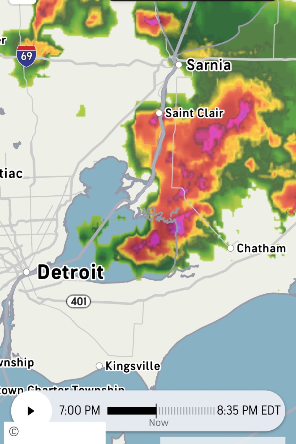

So what if,.. the wind is blowing NE in the morning and switching to a NW later in the day?
And the wind is blowing 20 mph gusting to 40.
And the gusts are different from one moment to the next.
Your ammeter is bouncing continuously between 3 and 18 amps, but your throttle is Locked at a Constant 32 kph.
It takes two hours to top up both your batteries, and by then the wind has changed.
So,..to get the most range, do I head NE directly into the headwind, cuz it's still morning, and use the changing prevailing winds to blow me home?
Or do I head NW to make sure that I will be blown home, (perhaps with the help of a ⛵️ or kite ?), once I get as far NW as my debilitating Range Anxiety and my Complete Lack of interest in pedaling take precedence?
It's kinda hard for me to plan my route when it's windy and there's 🌪's about. Lol

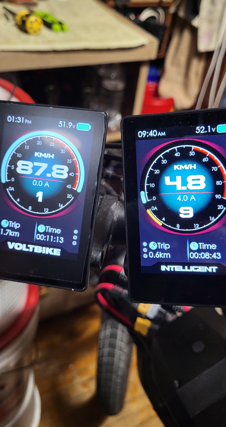

My current setup will go at least 88 kph, but that's with a tailwind.
I have 3000 watts available that I can crank up to 5000 watts if it's really windy.
My hub motor can only go 32 kph before the motor cuts out (or 43 kph with it turned up), so after that it's up to my mid-drive to take over with up to 25 amps to a top speed of 88 kph before my mid-drive reaches top speed (BBS02B with a 52t chainring on an 11t cog 28" diameter wheel)
What kind of tailwind will I need to go 88??
(keeping in mind that top speed drops as your running low on voltage)

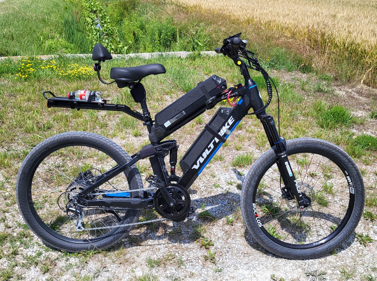

Dual battery dual motor rear wheel drive

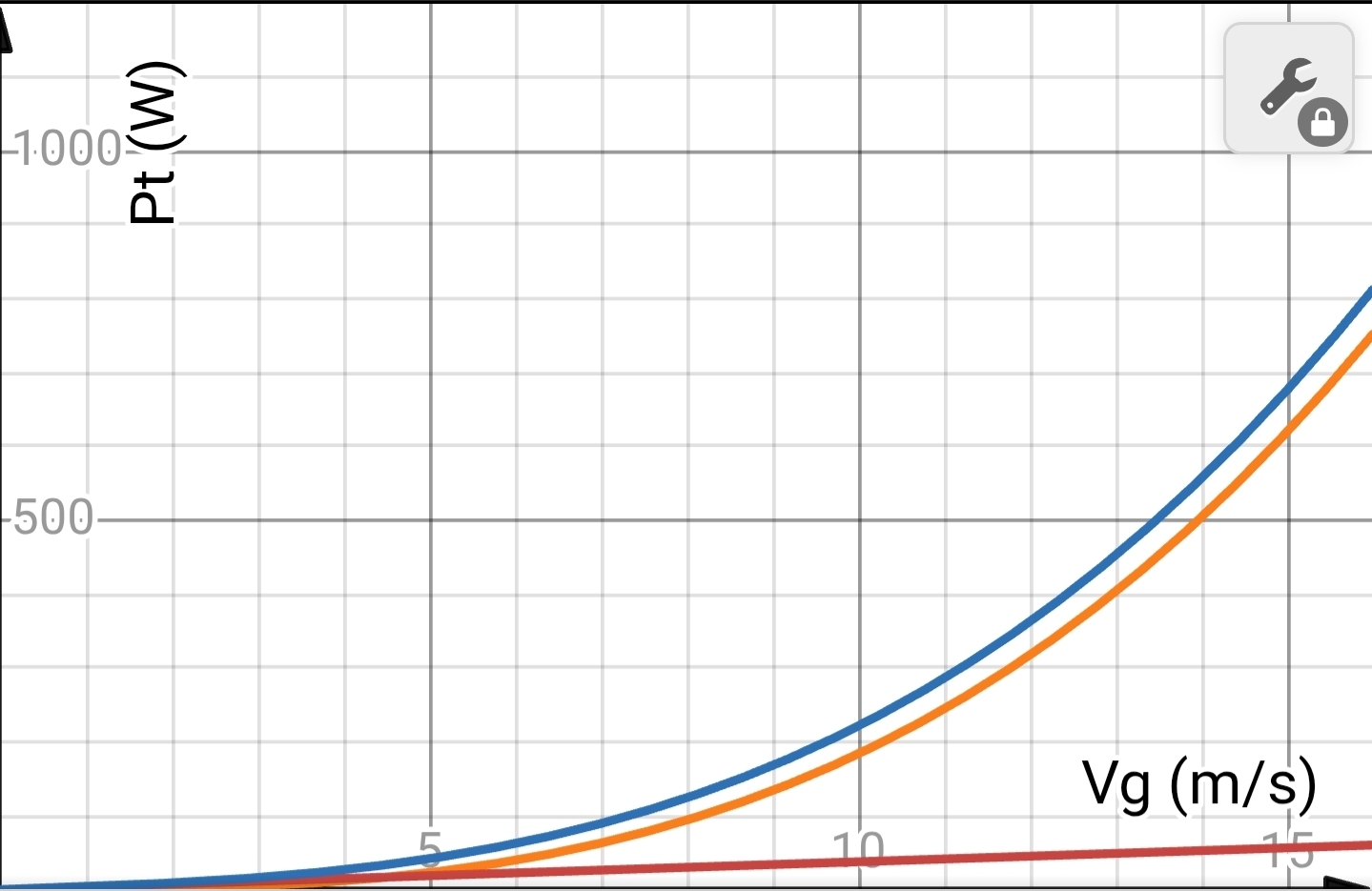

Need to put in good value for Ad, the frontal area of bike and rider. Google sez a commuter bike and rider is around .43 -.50. Sliders start at .3, which is pretty small, I used 0.50 but I think I;m wider than that, plus I wear baggy shorts.
The tire resistance has a small effect, I use .006. Also 190 lb rider (80 kg) and 40 lb bike (20 kg).
15 mph is 6.7 m/sec. SImulator says I need 150 watts, I'll buy that. 25 mph is 11 m/sec, and over 500 watts, If I trust my ebike displays, it would mean I'm kicking in about 20% of the power at 15 mph. as the display says 100-120 watts at 15 mph.

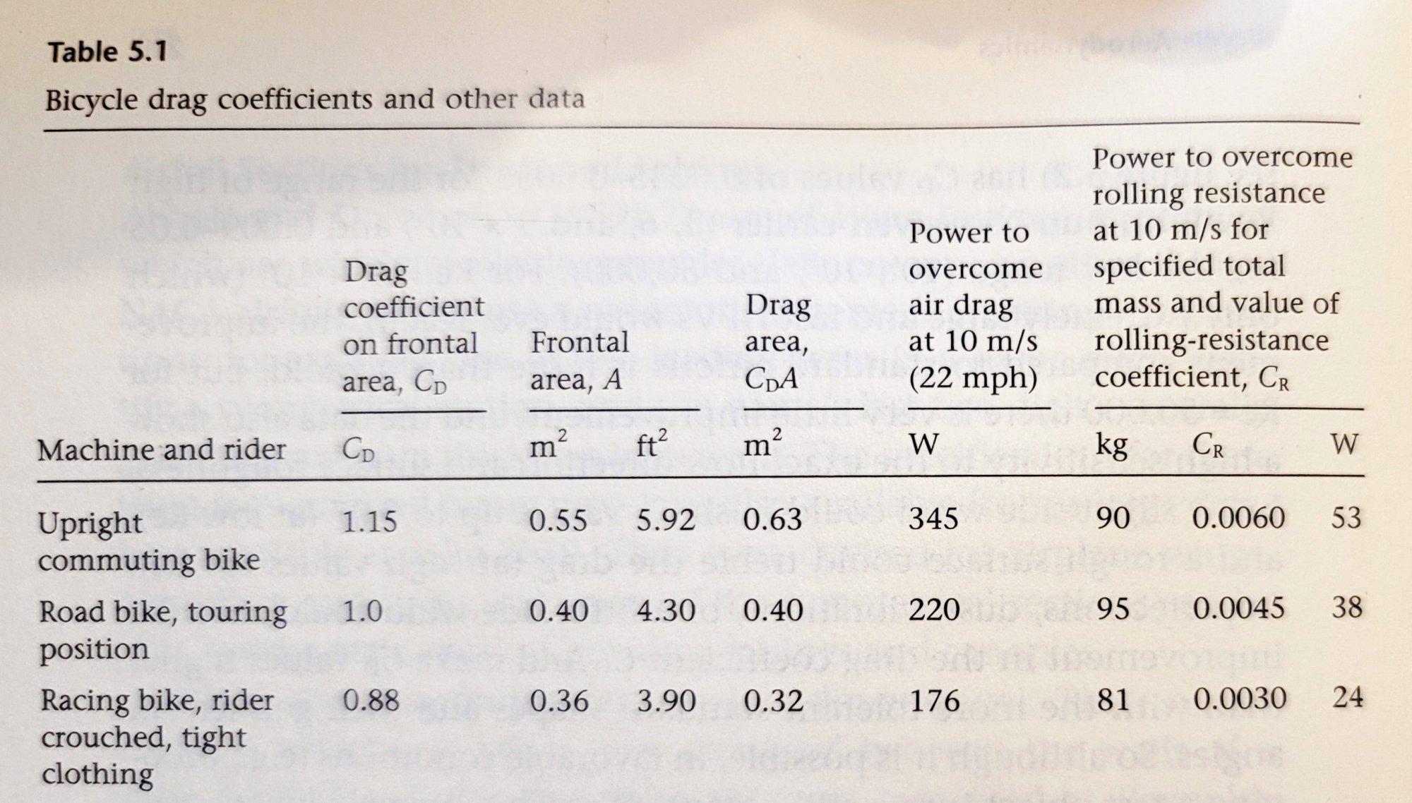

The table below from Wilson & Schmidt, 2020, Bicycling Science, 4th ed. offers some good guidance on bike and rider inputs for the model's sliders. Ignore the power estimates, as they assume bikes lighter than most ebikes.

The default slider inputs describe a typical Tour de France bike and pro rider as a reference case. Anyone here should expect to put in higher values for bike mass Mb, drag area Ad, and coefficient of rolling resistance Crr and see higher power losses at all ground speeds.
The top line in the table gives typical parameters for an upright commuter in street clothes. The 3rd column gives Ad estimates under the more common abbreviation CdA.

Total power loss Pt is most sensitive to Ad and gradient G and least sensitive to Crr. On the flat, it's also very insensitive to Mb.
So it's worth getting a decent value for your own Ad. Search for "bicycle CdA calculator" online to find help.
