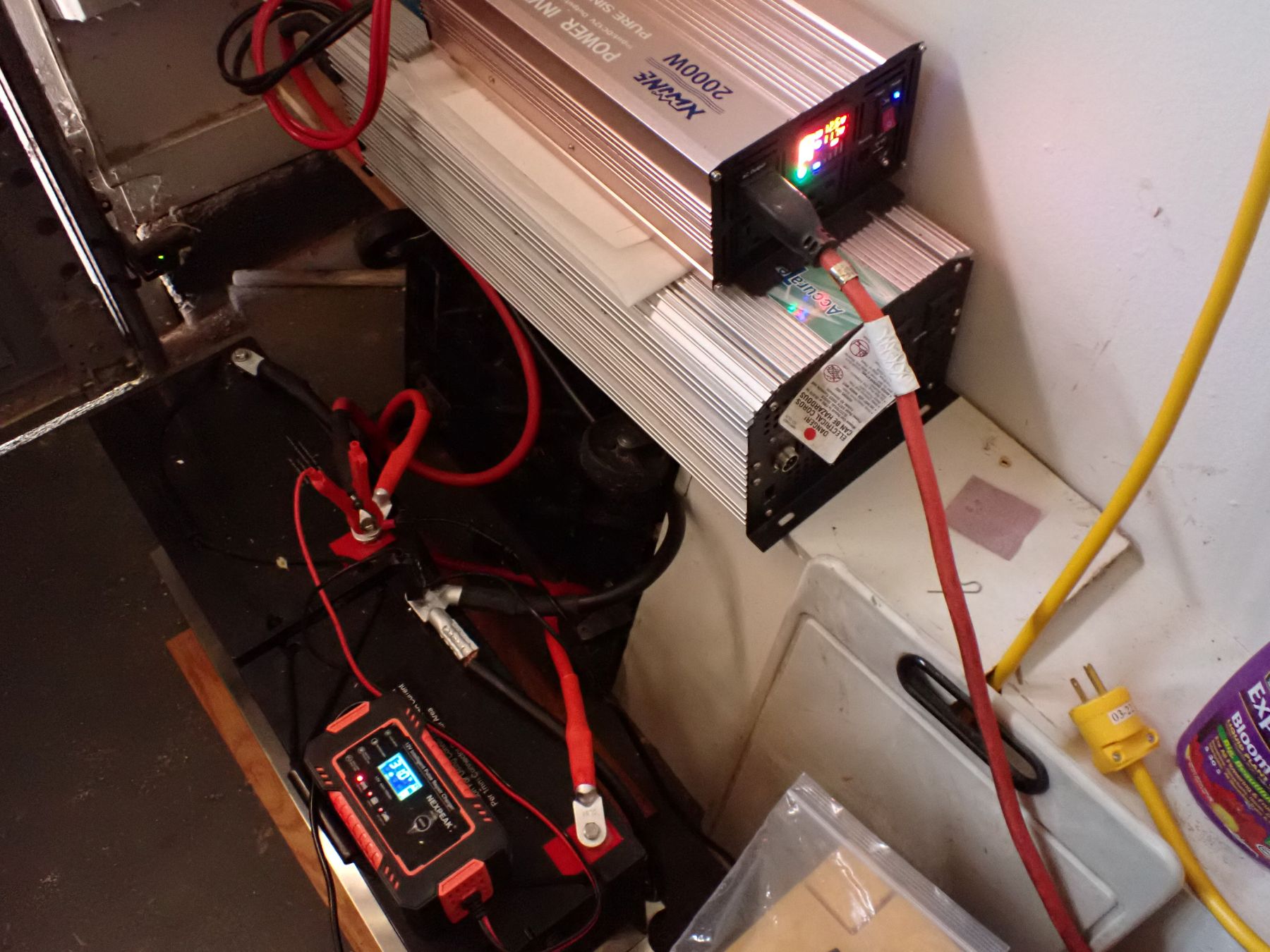

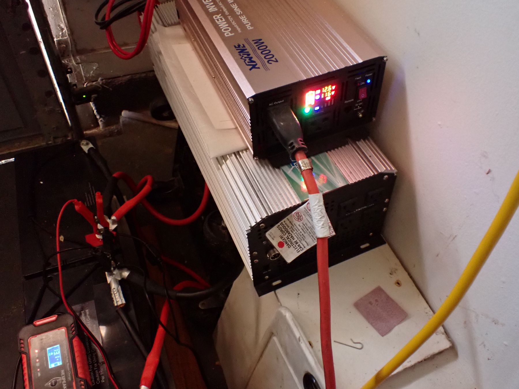

Today charged 3 lawn batteries, made coffee, plus two loads of clothes washed. Hooked my washer up to my other backup inverters which I have rarely used before. One is 10,000 watts, (which I doubt} the other 2,000 watts running now. I did one wash with each while the battery charger is putting out 5 amps into the two parallel AGM 12 volt 100 aHr batteries pulling 80 watts out of the ecoflow with 309 watts going into it from the solar panels. Now going to cook some noodles in the microwave.

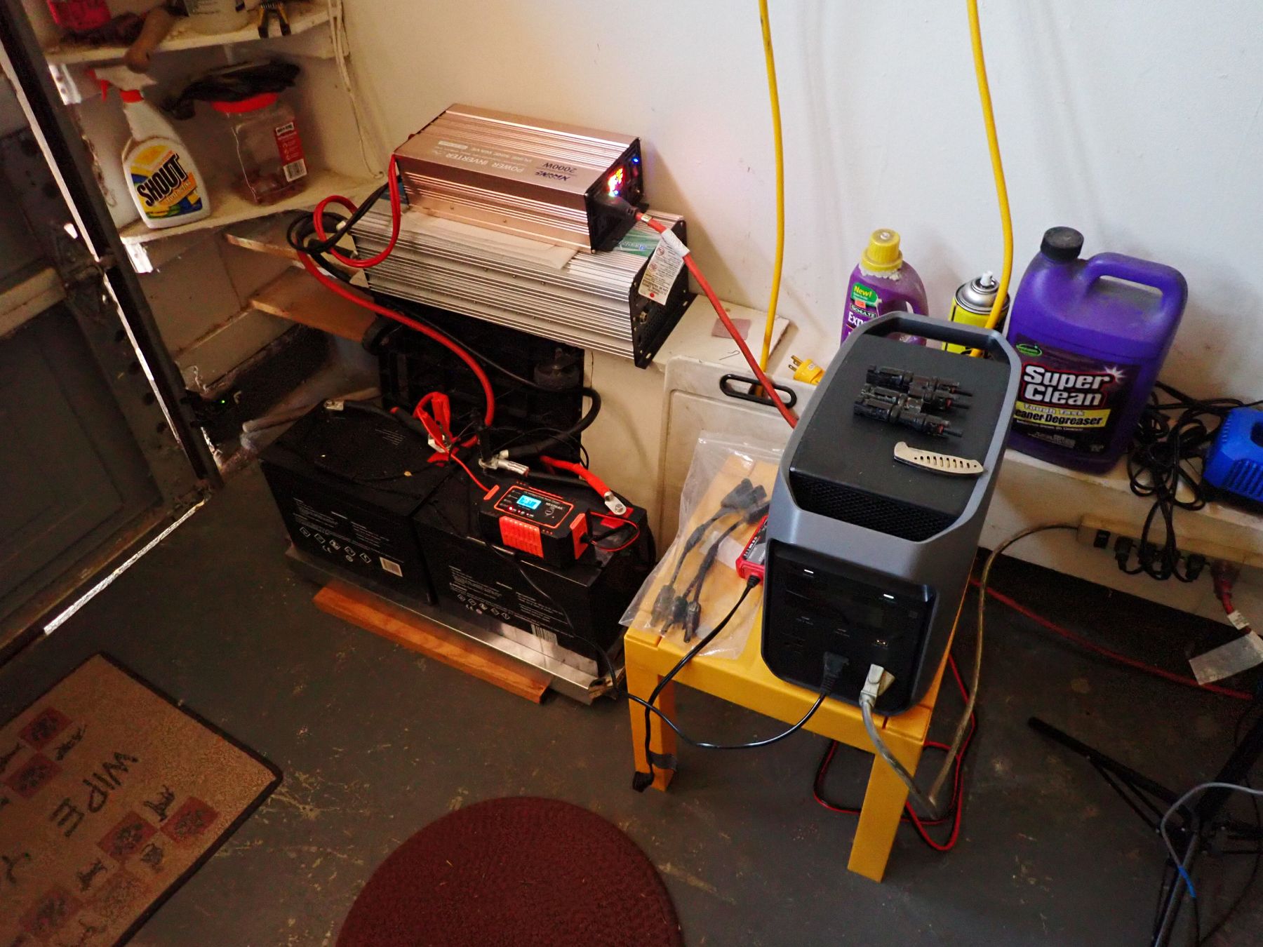

Upgrade....ordered an Anker SOLIX F3800 Portable Power Station - 3,840Wh | 6,000W
With this I can run our 240v dryer along with all the other stuff at the same time.

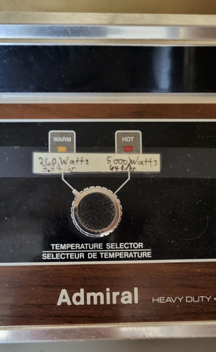

My 240 VAC dryer draws just under 5,000 Watts. (with the heat on)
That would drain your power station in about 40 minutes, and would stress the Hell out of your batteries.

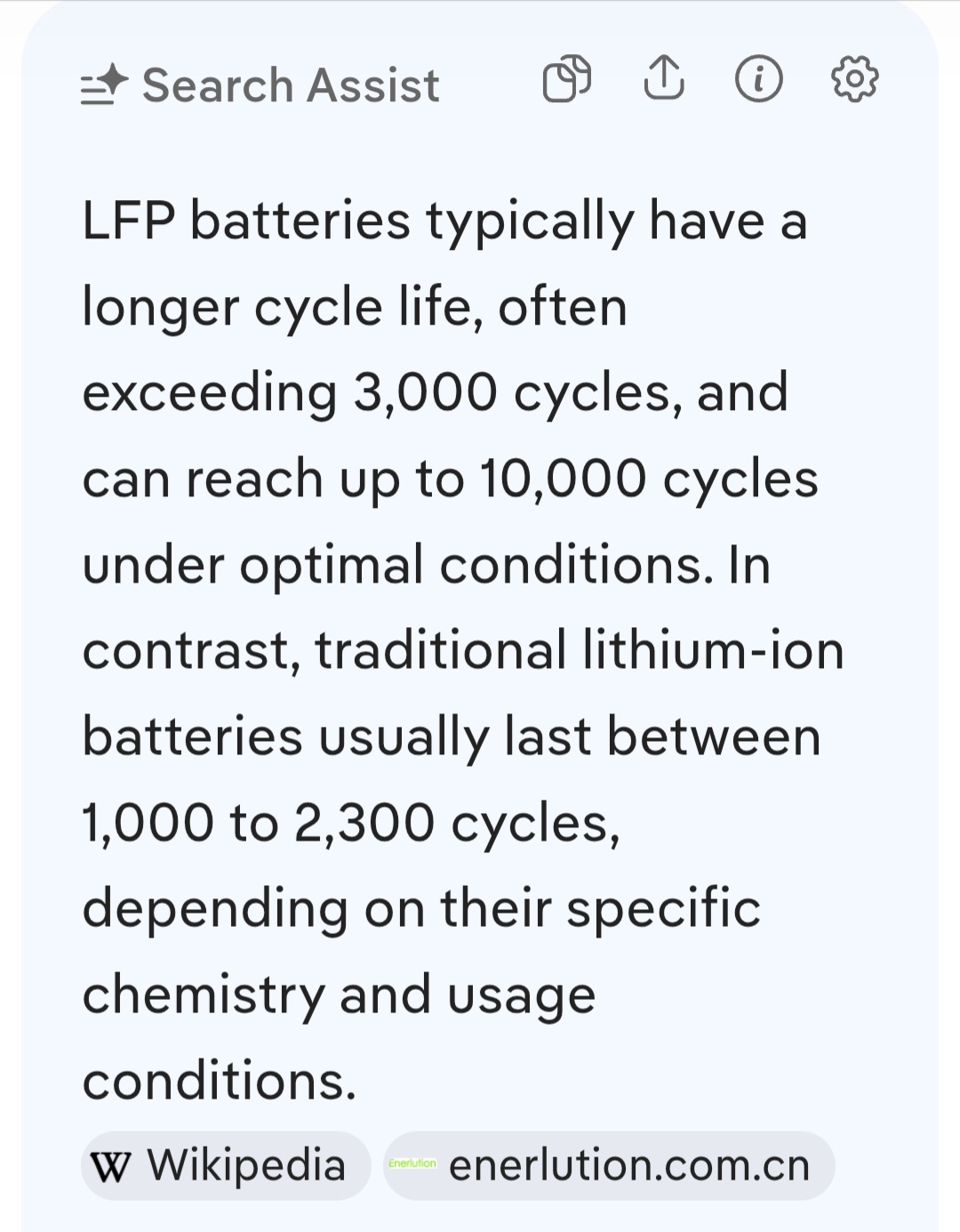

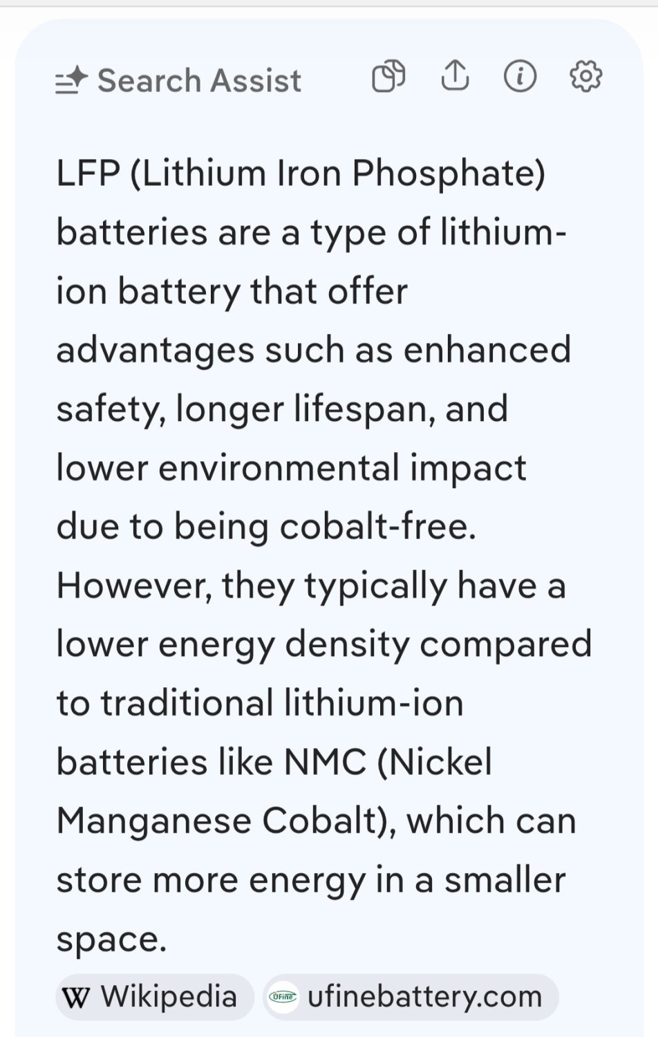

All these "solar generators" have Lithium batteries, and most allow you to pile up several of them to increase autonomy.
Lithium Iron Phosphate batteries are different, and Much safer than e-bike batteries.

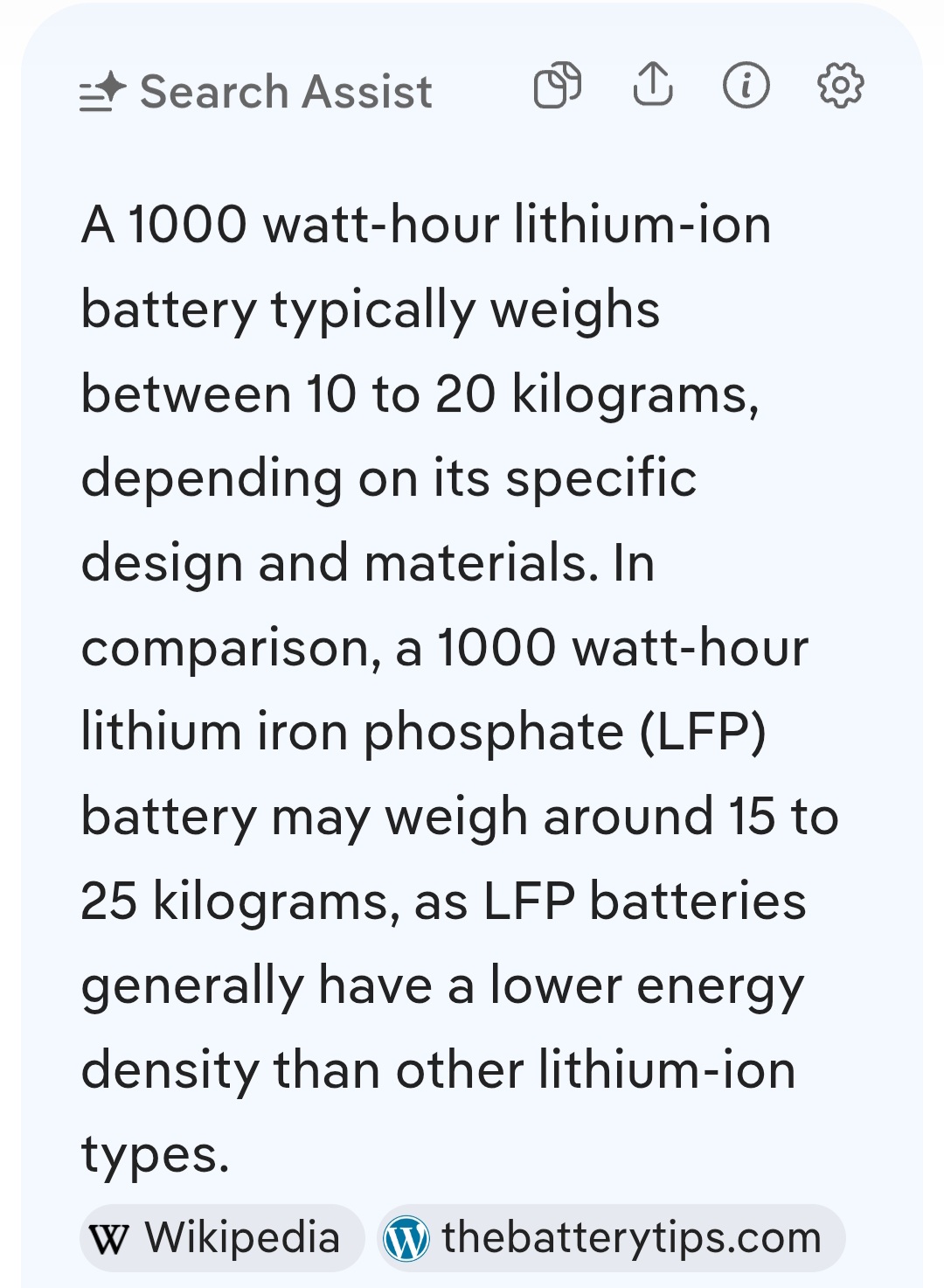

Yes, if given a choice LiFePO4 (LFP) are safer than Lithium Ion.
That said they are bigger per kWh, so if space if a concern you have to keep it in mind.
Either way they offer the same type of performance.
Missed FedEx delivery today as I was out shipping back the Ecoflow as defective. Thing was the Southaven FedEx store would not accept the package and sent me up to Memphis. Lots of traffic ..fast trucks high winds but easy drop off there. About a 20 mile ride today. Took the Radwagon 5 which is really nice to ride. Switched solar over to my old 20 amp controller and inverter with the 200 ah agm batteries until Anker gets here.

Well my 30amp controller (thought is was only 20 earlier) died last night. Opened it up and nothing looked burnt now my panels are hooked to nothing and I don't like using the grid anymore. Go figure. I have not been using the dryer the past couple days and just hang clothes inside. Hope FadEx gets here today with the Anker so I can get back on track.
Well FedEx delivered a folding camp chair bonus gift from Anker not the power station so I ordered this while I wait.
I just did laundry today.
I pay 12.8 cents per Kilowatt hour so my 5000 Watt dryer costs 64 cents per hour to operate, but only uses 260 Watts with the heat turned off, so I only had the heat on for half an hour, then finished drying for an hour with no heat.
(It says "WARM" but it's wired for no heat on the "WARM" setting.)

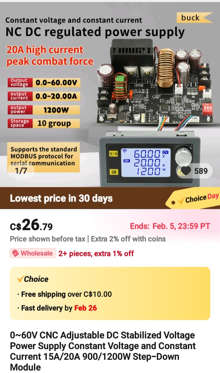

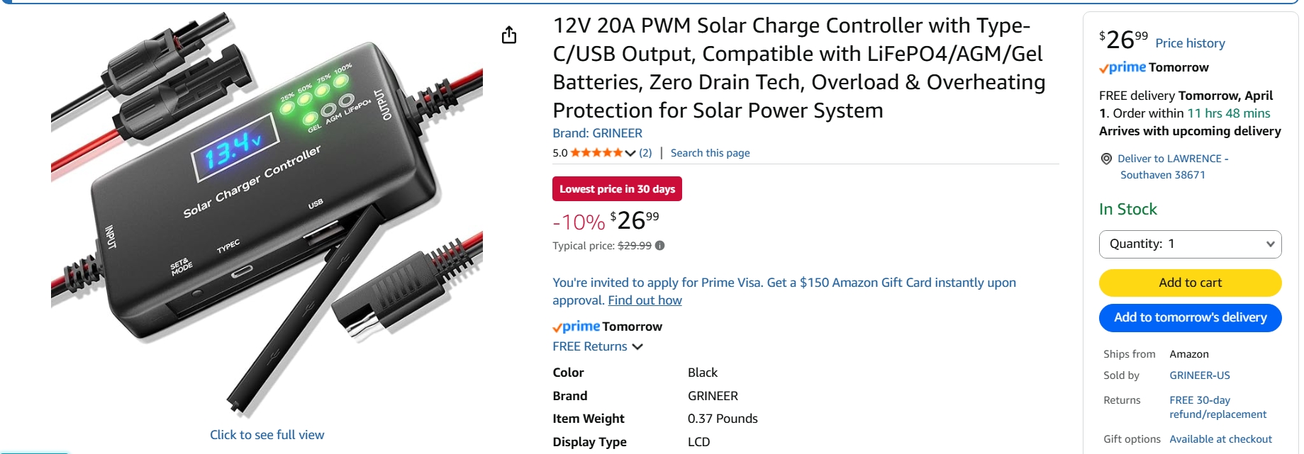

I've got a buck converter that I could easily use as a charge controller to charge my ebike batteries, but I don't want to trust a twenty-seven dollar piece of crap. 😁
It says it's "combat force" ready.
That could mean that it will blow up my batteries??
I dunno. 🤔
It's bound to fail, especially if I actually run 1200 Watts through it, but I have no idea if will break down by simply shutting down, or will it fail by setting my batteries on fire?
