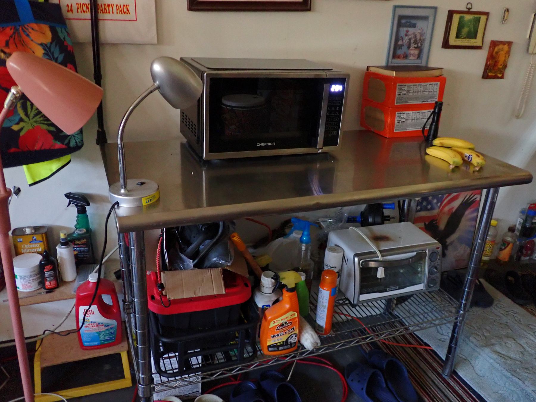

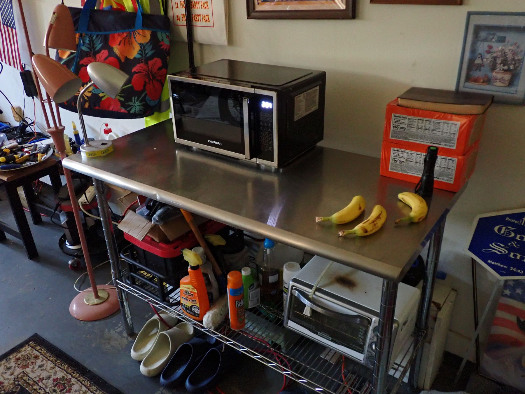

Hot Coffee and noodles cooked with solar today. Hooked up the lights and 3D printer as well.
The new 900 watt microwave uses 1494 watts when cooking. It has eco mode that turns off display to save power when not in use.
