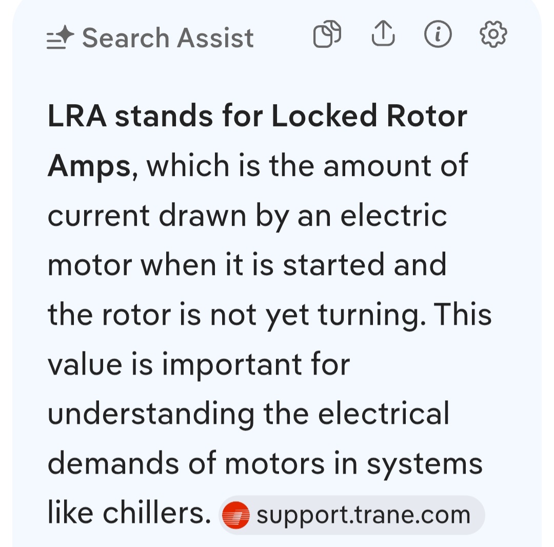

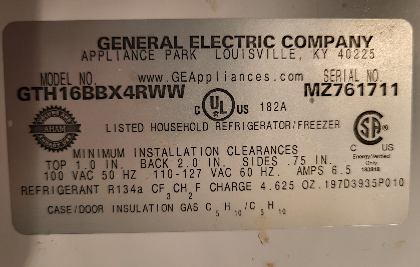

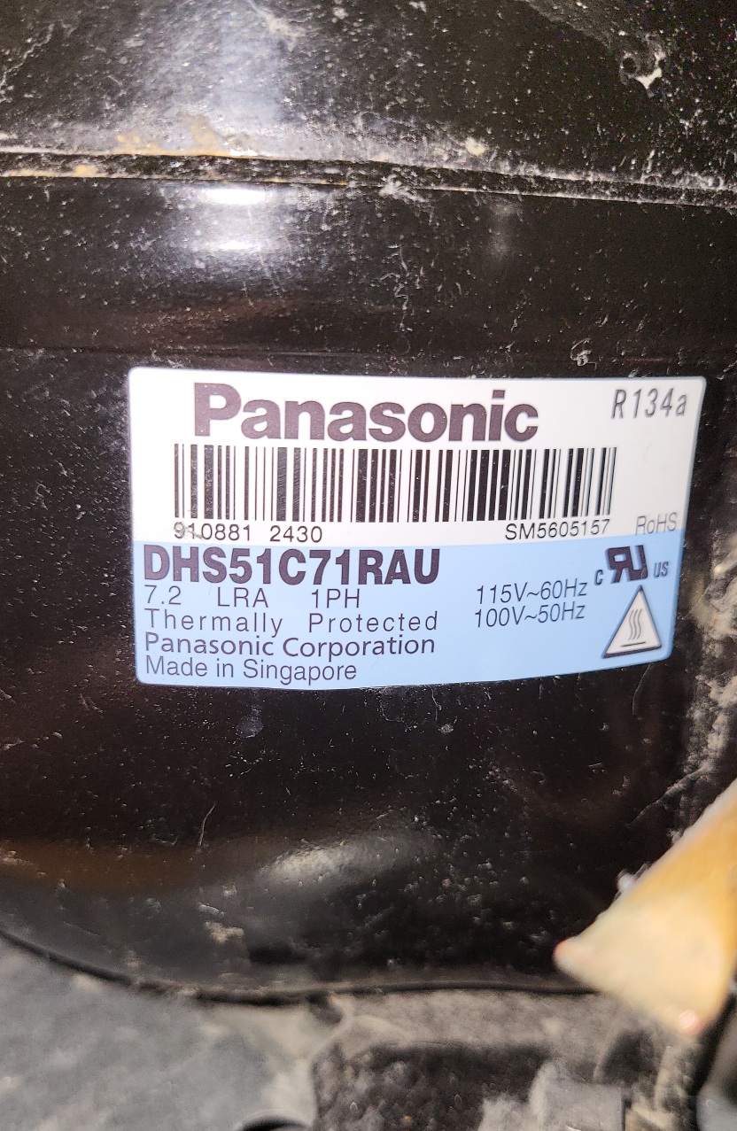

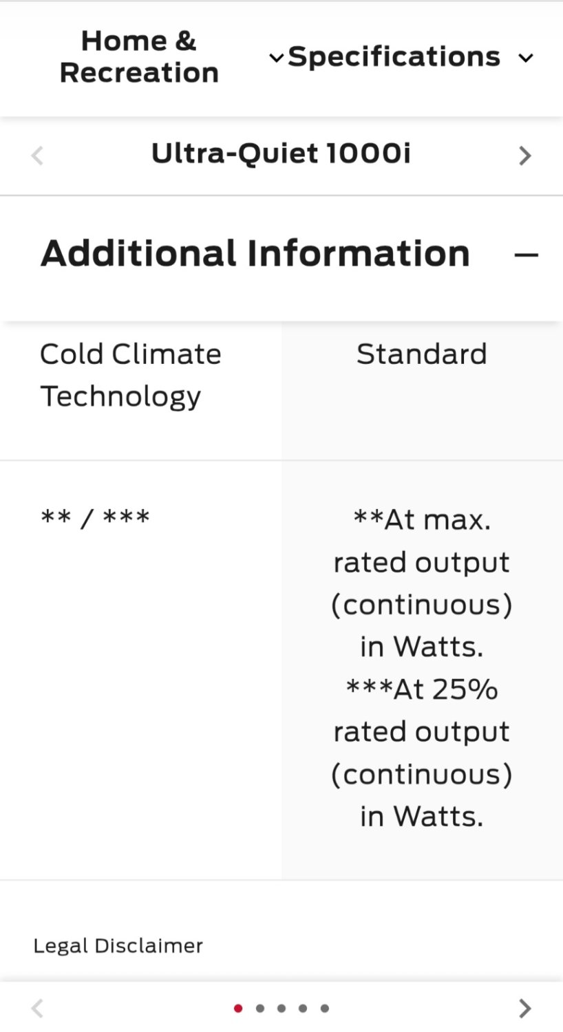

Don't forget about the surge current of your compressor,..

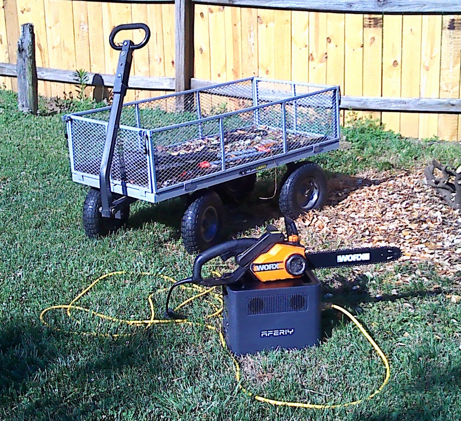

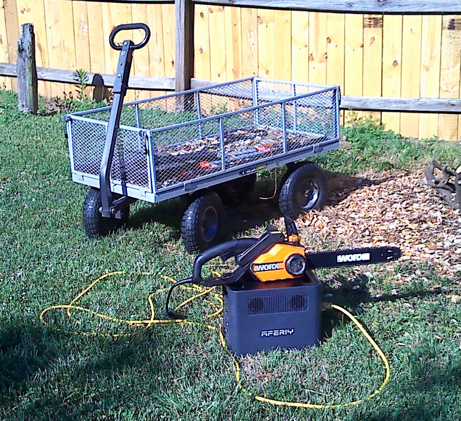

I love another advantage. Corded tools are likely to be cheaper, lighter, and less trouble than those powered by gasoline or batteries. However, if a task is 50 yards from an outlet, that's a lot of trouble laying out and bringing in cords. You'll have to move them as you move, and you won't be able to go farther than the length of the cords available. A cart is helpful on most outdoor tasks, and that makes it easy to take my 26-pound battery. This morning I made cuts for half an hour. The biggest thing I cut was a 5" stump. The display said I'd used only 4% of the battery.
I do similar but use a wheelbarrow to move my Jackery unit from place to place. However I do have a cart just like that which I use to carry a 200 watt adjustable solar panel and my Jackery unit to wheel around and face the sun at different angles depending on the time of year.

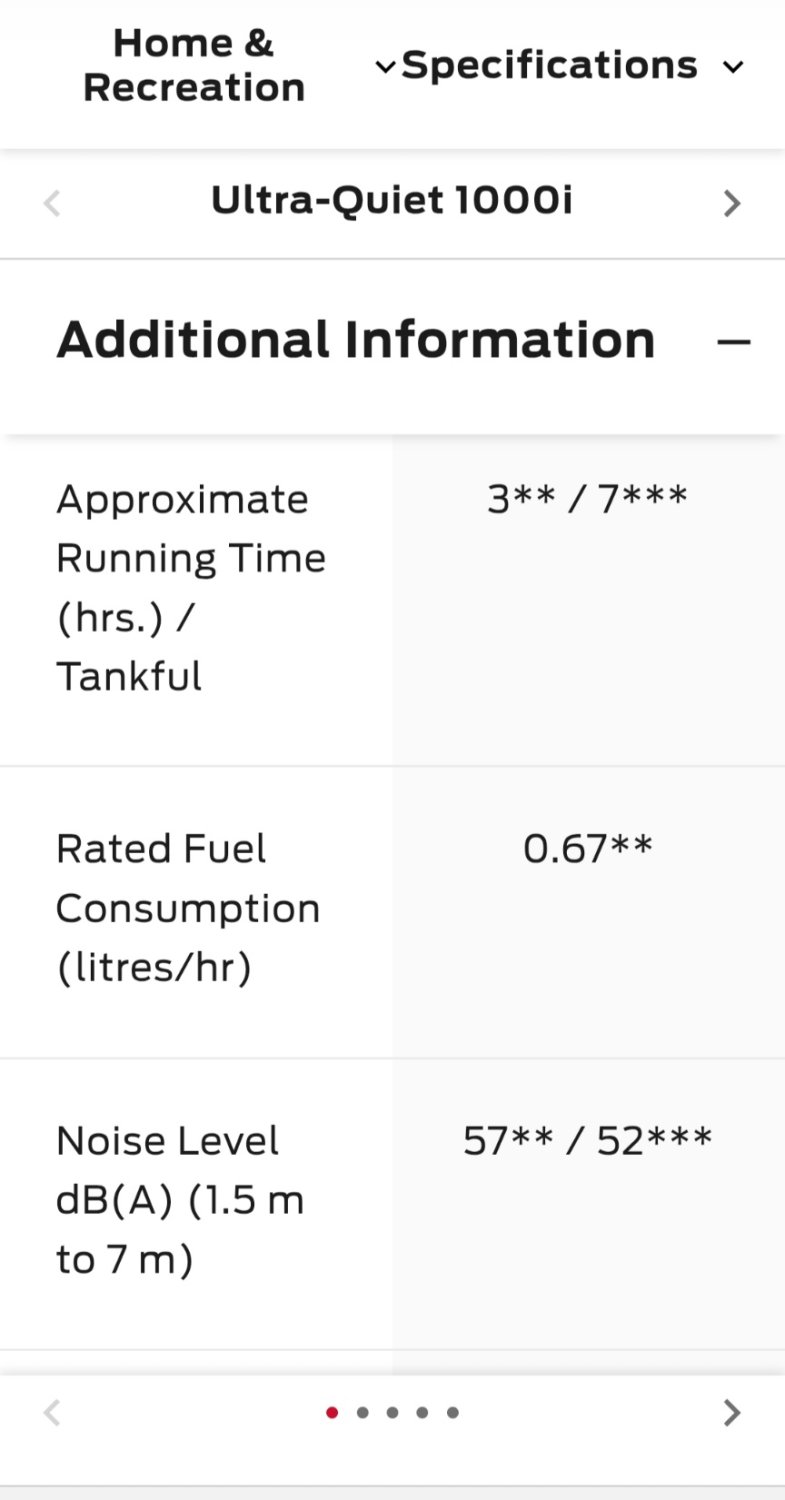

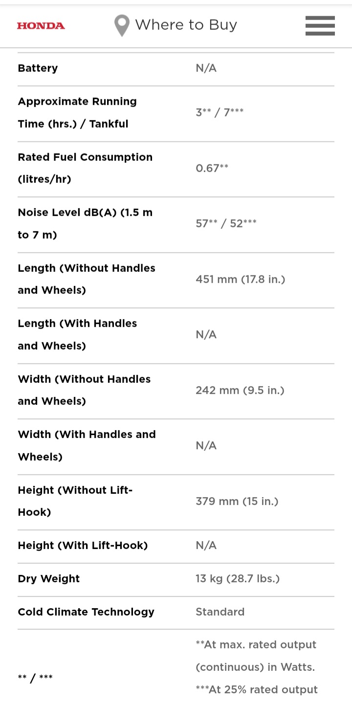

It can charge at 500 or 1000. There's a switch. The generator is rated at 3400. The manual says it will run 3.5 hours on a tank at full power and 14 hours at 1/4 power (850). I guess the efficiency is similar from 850 to 3400.

For chainsaw work out of range of an electrical outlet, it seems a LiFePO4 battery is far more efficient than a gas saw or a generator. It's a 14.5 A saw, so it might have pulled 1750 W cutting through the stump, yet in half an hour it reduced the battery energy about 40 Wh. Chainsaw work is often like that. You want the saw ready, but it's idle more than 95% of the time. In that half hour of idling, my generator would have burned gas with which it might have increased the battery charge by 391 Wh, making the battery 9.8 times more efficient. A gas saw would likewise have been wasteful unless I shut if off immediately after each cut.
