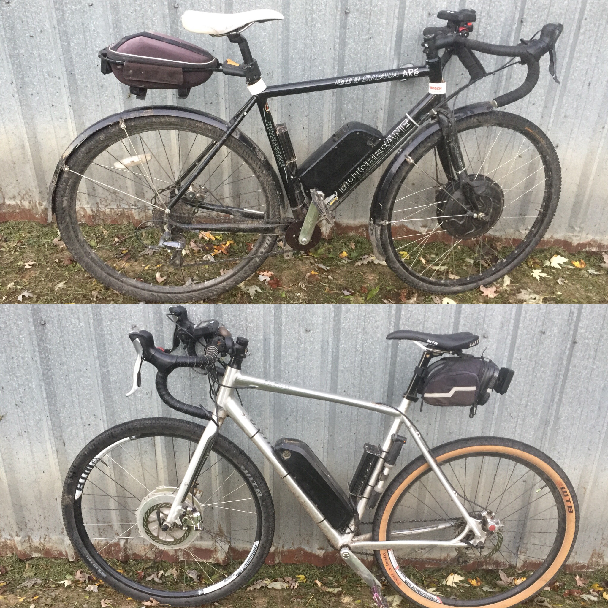

I like the way the overall bike weight is distributed better with a front hub. I can still lift the front wheel plenty to avoid man holes etc. and I also like the two wheel drive feature as sometimes I get jiggy with back country loose surface hill climbs

I use Schlumpf 2 spd bb drives. V2 is a High Speed 2.5/1 and V1 is 1.65/1 so the 27t rings get bigger. On V1 all the way to a 160" gear which is plenty for pedaling along at 35. You can use conventional cranksets but as you suggest you would need pretty good sized chain rings. I have actually put a Di2 Alfine 11 spd on V2 since the picture was taken which works really well also. Basically as I said keeping the pedal input segregated from the motor drive makes for the most realistic pedaling experience.

V1 is a bikes direct bike. If you are willing to spend another couple hundred bucks you might find one with tubeless rims. I find tubeless to be the way to go as flats are pretty much a thing of the past. I got a 1 5/8" gold screw in my back tire the other day, stopped, threaded it out, rotated the hole to the bottom, shook it around, added air and kept on going. Still haven't had to add air to it. Try that with tubes......
Not the closest photos, but are you using a torque arm on the hub motor? Are the forks aluminum?
V1 has as Grin TA that sits on the disc side axle and attaches directly to a brazeon. It is a Carbon Fiber fork with Carbon Fiber dropouts and in over 2000 miles of use and I must admit to a certain amount of abuse, with constant watch has never shown any undue signs of distress. 1200w peak motor that gets full torque applied on occasion.
V2 has the Any Axle motor which has its own torque arm that I made a fitting for the aluminum fork of that bike. I like this setup better because it is tool less removal. Once again no signs of stress to the fork/headtube/headset over 2000 miles.
I realize that this goes against the grain of most peoples logic but I tend to depend on theory based experience rather than theory based on hearsay and it has led me to the conclusion that a properly set up front hub motor is fine, no matter what fork you have it attached to.

I use Grin because they have the best hub motor going, the Any Axle. It is the lightest DD motor and DD is what I prefer for high speed road riding. Here are my bikes, V1 (black with 48v, 25a, 9c) and V2 (silver with 52v, 25a, AnyAxle).
I only have the 10ah shark battery on V2 and the 11ah Dolphin on V1 and they both will do 30 miles averaging 25 mph +/-. But I would get a 13.5 today if I was in the market to have a little more on tap for a longer ride or a faster short one.
Top speed on both bikes is north of 30 and they will climb hills fast and efficiently if you pedal along in the correct gearing. FYI I prefer to use just a throttle for my road bikes and the cruise control function of the CA3. That way my cadence is set by me and my desired output at all times. I find this important when spinning higher cadence. On my mtb i have a torque sensing system that works great at lower cadence but at higher ones the "magic legs" feeling is too plastic and I find it hard to settle in. But on that bike I never really do much road and for what I do it is fine.
