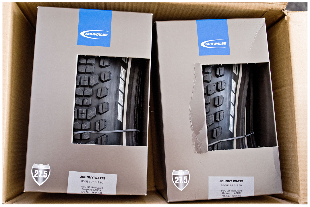

Please recommend some tyres for my ebike
If you ask me FlatSix, I would have used Johnny Watts 2.6" :)
Which I plan to use on my Trance E+ for the warm season. Yes, there is another matter: the Trance's rims are 35 mm. Try to read in more detail, FlatSix :)
@Flo: I forgot to tell you your Johnny Watts tyres will be very good for off-road unless you plan to ride in the sand.
Agreed... Johnny Watts is a good all-road "SUV" tire with smooth-rolling resistance and level 6 puncture protection;)
Cool tire...have never even seen these before.
I tend to go all smooth for road, all knobby for offroad. Great 'suv' tire in balloon sizes.
A set is to be delivered to me today. It will wait for the Spring. It's the latest thing from Schwalbe, I think.
Now we get to see whose weather cooperates better so we can try them out.
Unfortunately the weather here is somewhat fickle and spring could be in June...
Thankfully, when I put the Ice Spikers on to replace the Forekasters, I figured out some good tricks on getting the tires on - off was dead simple.
It had been a VERY long time since I'd changed out any tires.
My situation is even more complicated because of tubeless setup. I use help of Jacek to change tyres on my Trance: He owns a compressor with a Presta valve adapter to seat the tyre bead on the rim quickly and properly...

Johnny Watts update:
Rode 45km on them yesterday.
Very quiet and really nice rolling characteristics.
After riding for the last few months on Ice Spikers, I couldn't believe how loud my motor was! ;)
Most of the ride was on paved surface, but some grass and dirt as well as a little snow and Ice.
For the pavement, dirt and grass, they felt very secure. On snow and ice - they felt like they were on snow and ice...
From the Schwalbe website:
JOHNNY WATTS​
THE PERFECT CHOICE FOR SUV BIKES.
Like no other, Johnny Watts unites smooth rolling on hard ground with longevity and puncture protection. Off-road instilling confidence, while on pavement rolling whisper-quiet.
• Versatile tread for a wide range of use from asphalt to off-road.
• Blocks with large contact areas for excellent rolling, little vibration and high durability.
• Steady and forgiving cornering behavior on hard ground.
My personal opinion (albeit from only one ride) was that there is the occasional "truth in advertising" and this is one of them.
