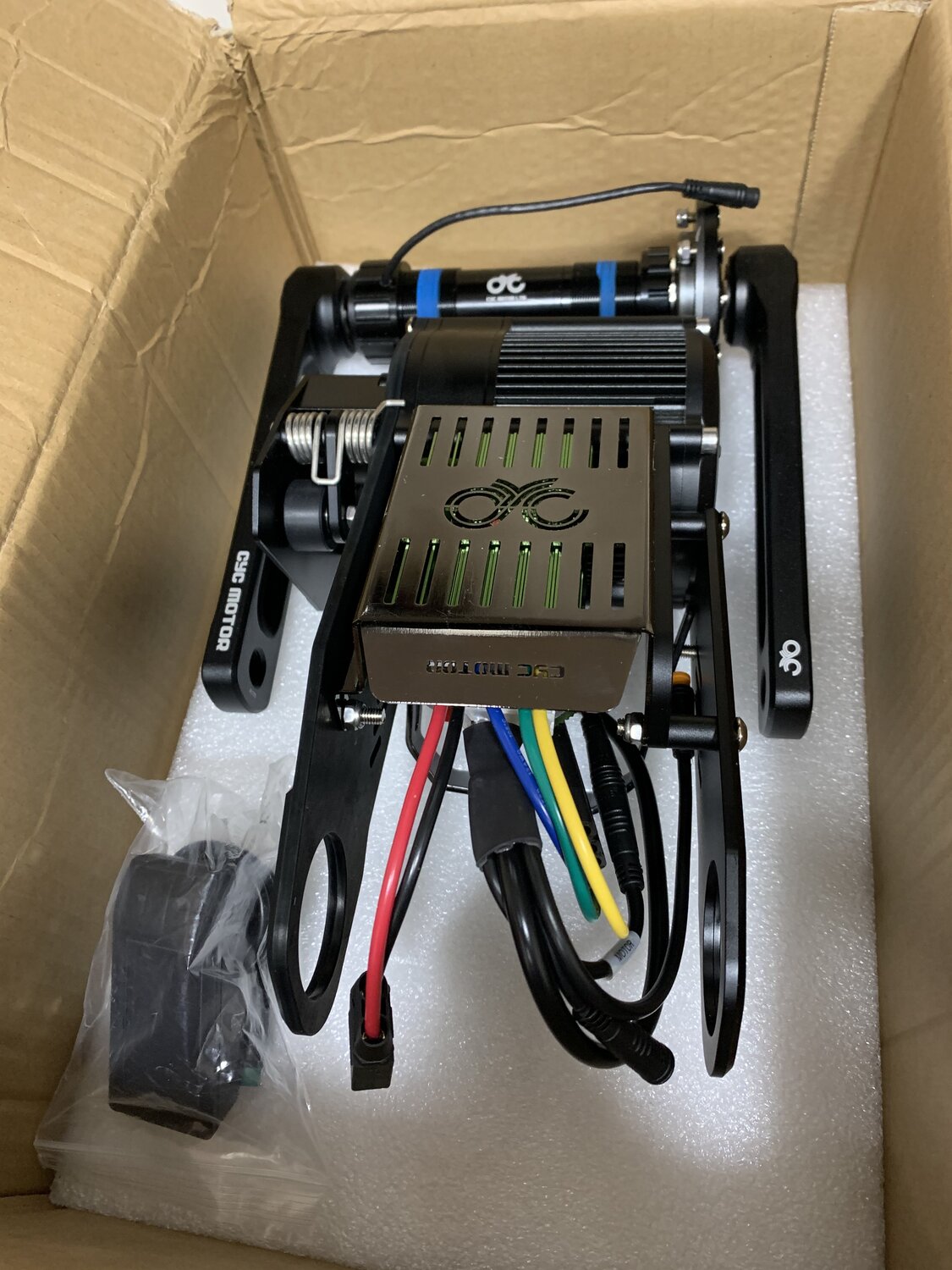

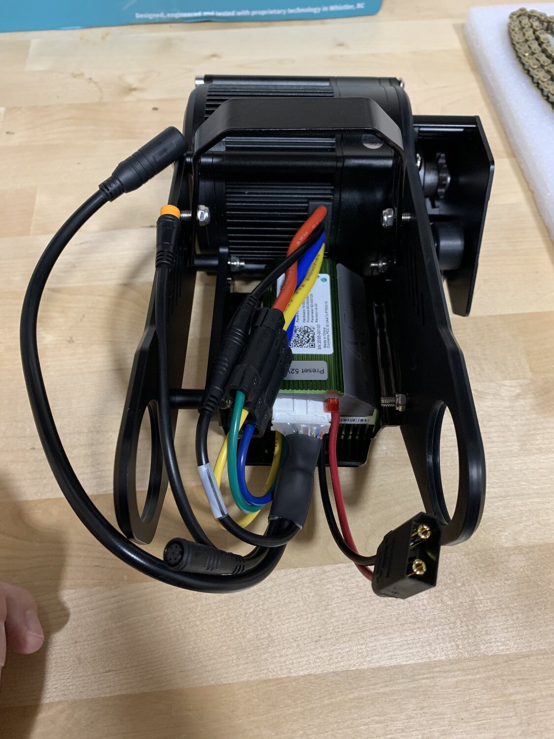

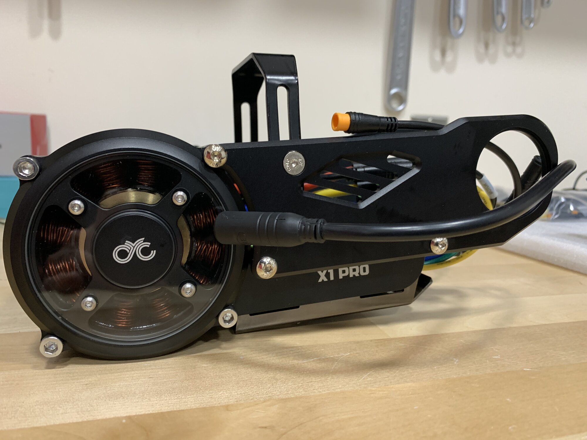

I ended up purchasing the CYC motor kit from Mark at Electrify Bike, who was great at getting me started spec’ing parts for the build. I’d highly recommend them to anyone in Canada or the US looking to build up their ebike.

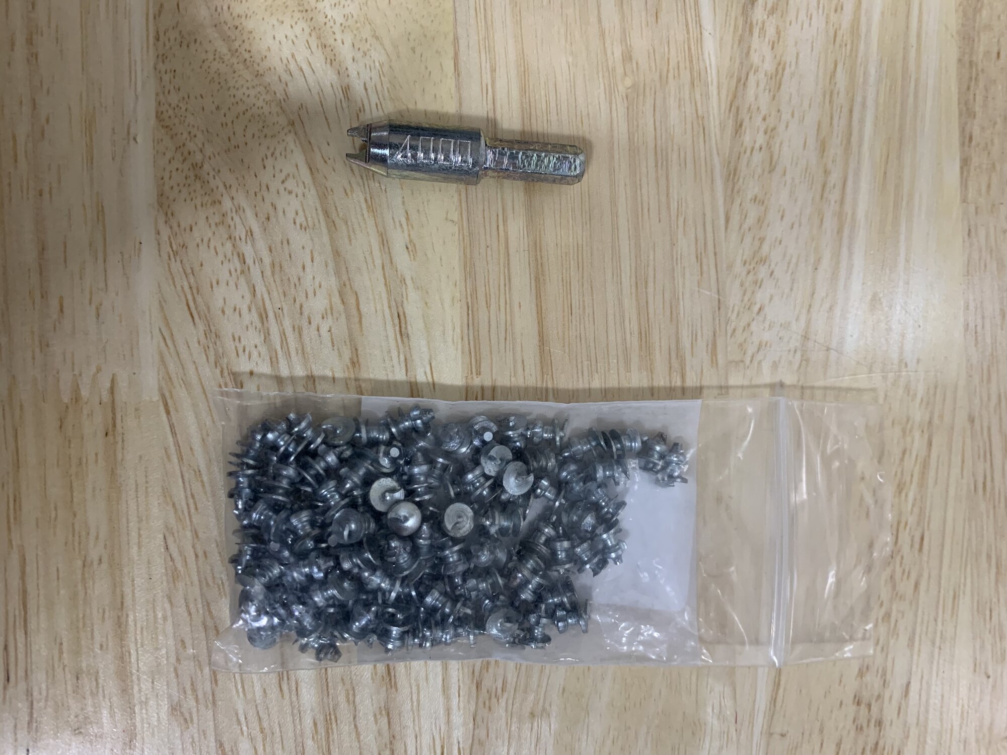

Winter – 4.6” Specialized Ground Control Fat – studded with Grip Studs

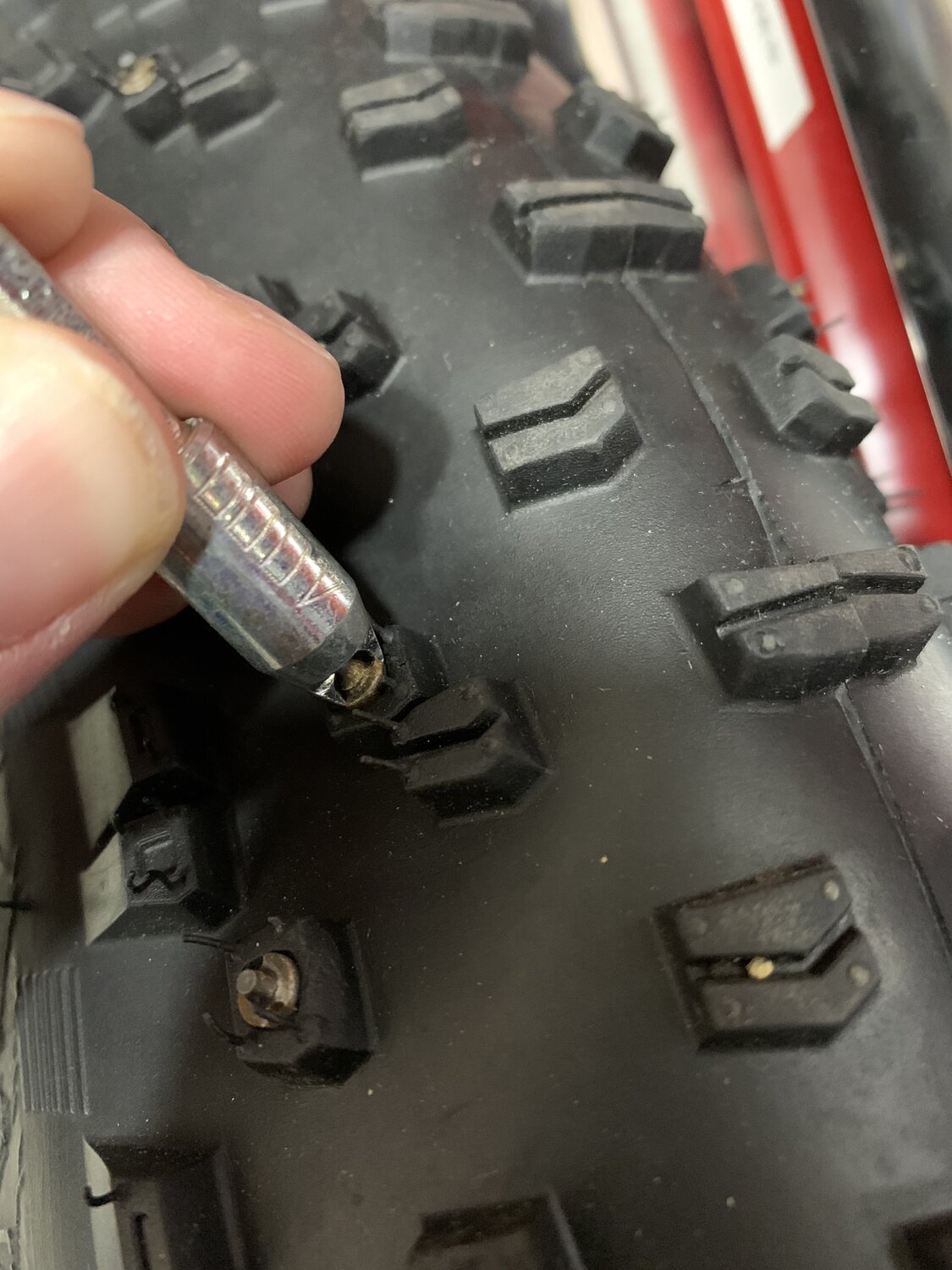

Seat/Stem – Stock Seat, added Suntour SP12 NCX suspension dropper post, which is a cheap way to add a lot of plushness if you aren’t going to run a dropper post.

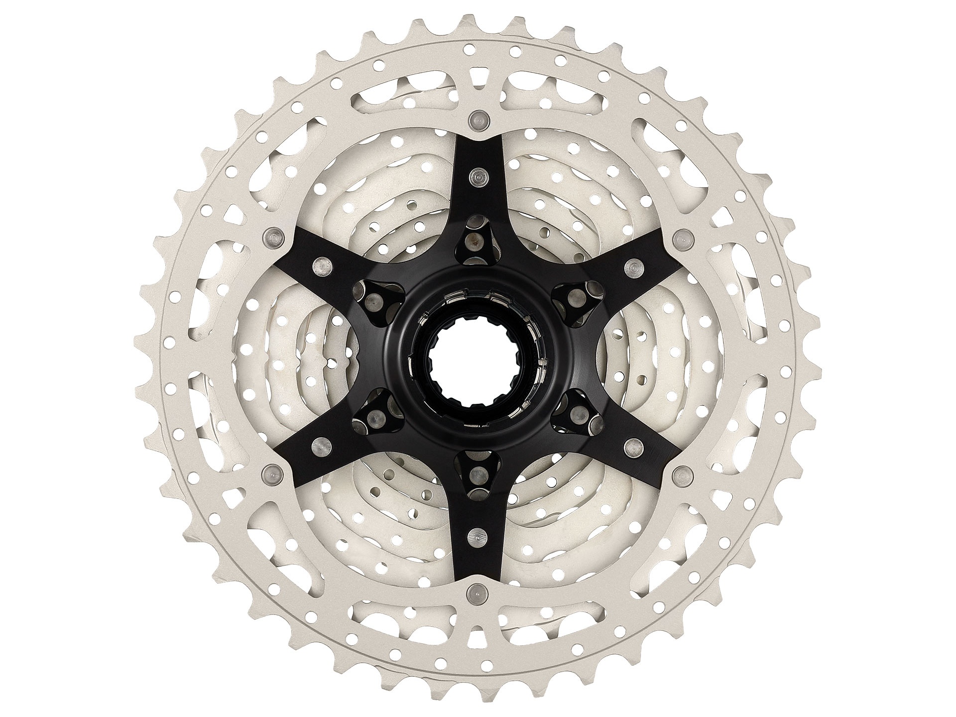

Cassette – All Steel, pinned cog Sunrace CSMS 11-42 10 speed

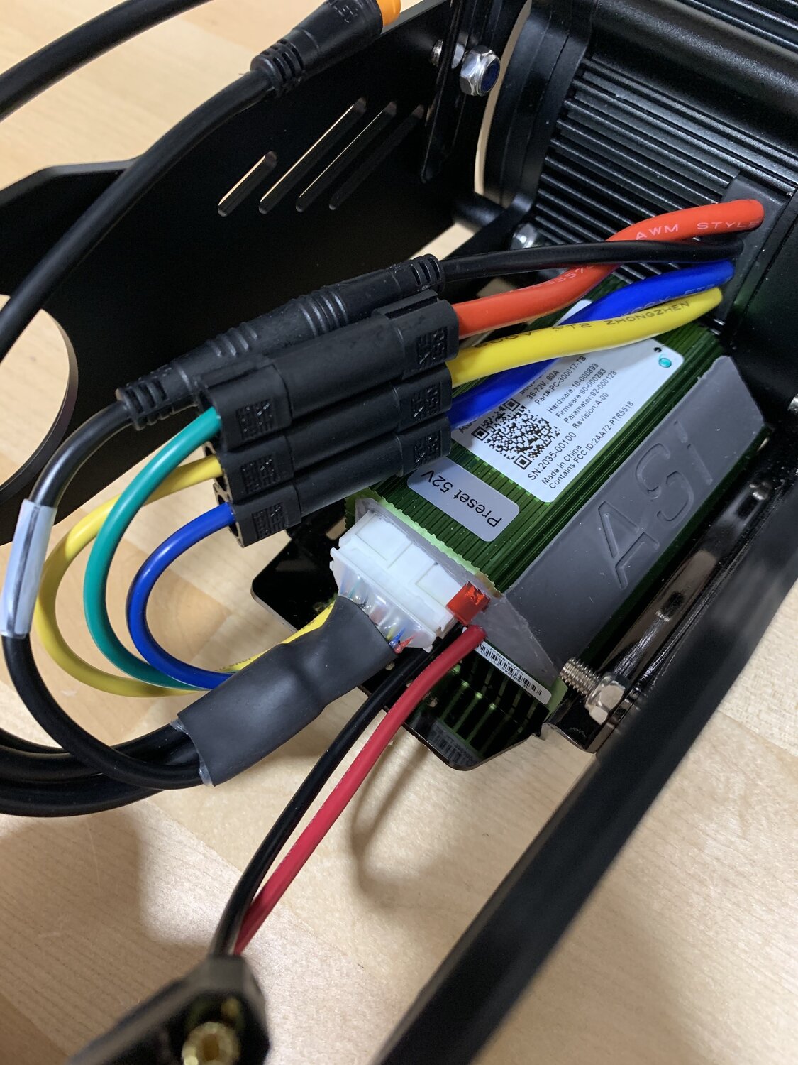

CYC X1 Pro Motor w/ BAC 855 Controller

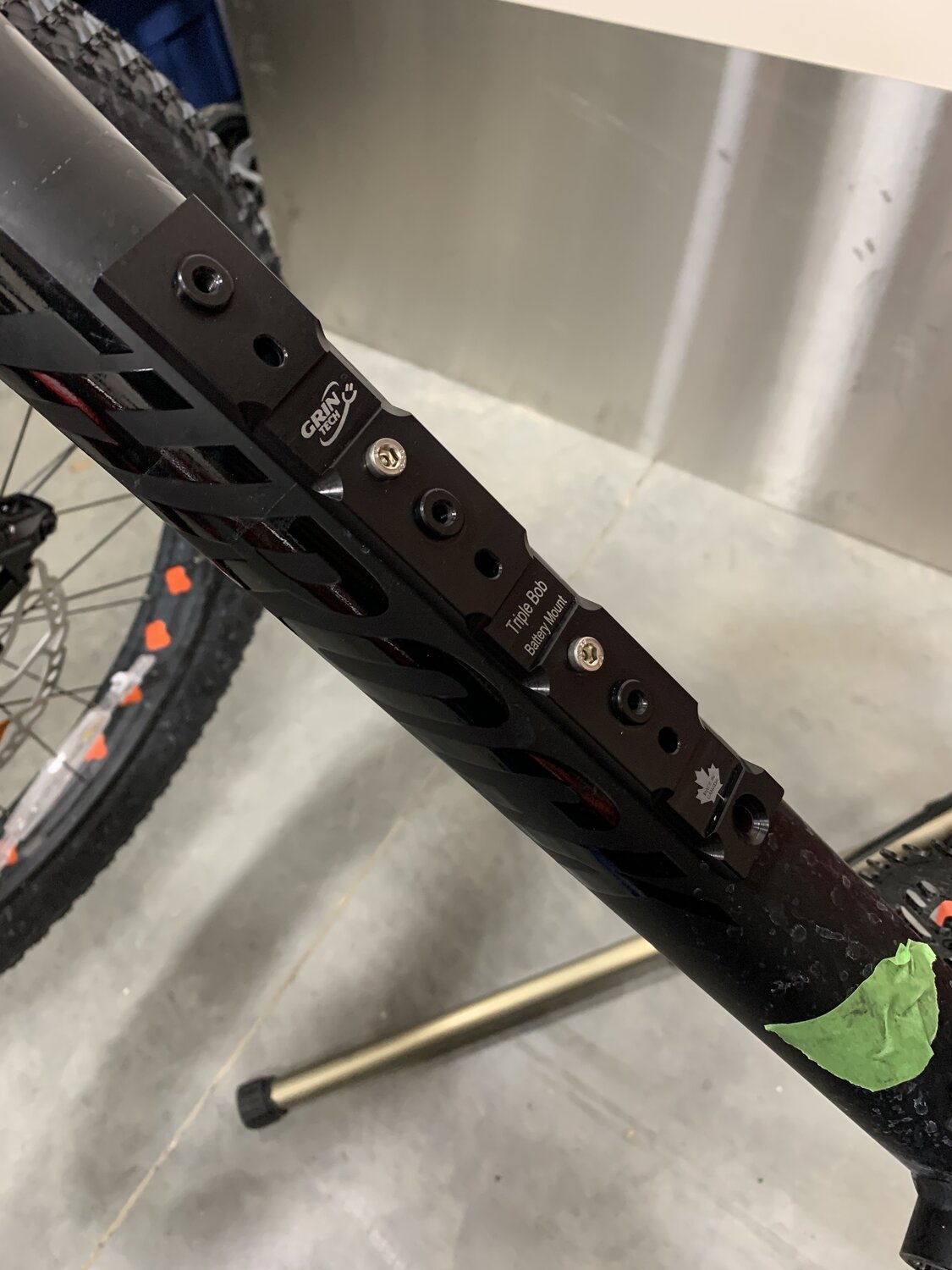

Mounted to frame with Triple Bob (hose clamped in recesses after picture was taken)

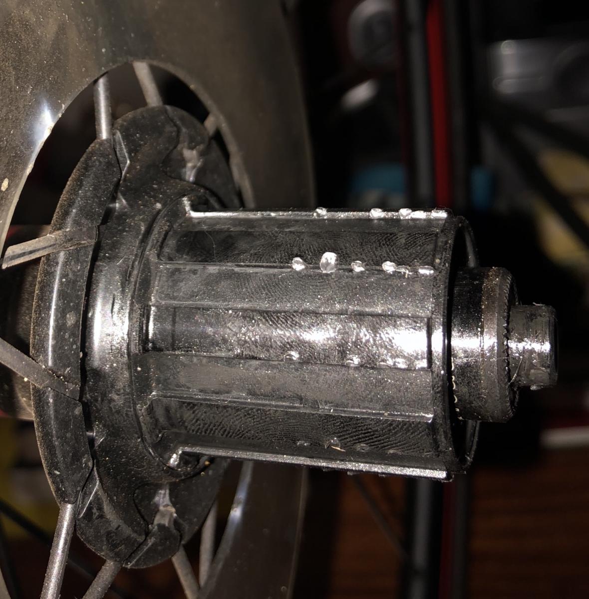

Another thing I’d like to touch on is the drivetrain durability. Standard mountain bike drivetrains aren’t meant to handle this amount of power and torque. Also, higher quality bike parts on conventional bikes end up focusing on cutting weight which doesn’t help durability.
For e-bikes, steel is your friend. Going with a cassette that uses steel cogs only will greatly reduce the chances of bending or shearing off teeth on your cassette. Also, look for cassettes that have as many teeth as possible pinned together (you can see this from the back of the cassette). That allows the freehub body to share the load of the individual gear with neighboring gears and prevents it from biting into the freehub. Shimano Deore and SRAM NX cassettes are both valid options if you are running a 12 speed system.
Pinned Cassette
Damaged Freehub Body (not mine). Marks are from individual Cogs digging into freehub body

On that same line, aim for a bike with a steel freehub body. Most are made of aluminum, which is more prone to gouging from the cassette gears. The DT350 hub I chose had an available steel freehub body which I purchased to reduce the risk of gouging.
The DT Swiss 350 freehub uses a star ratchet system instead of ratchets and pawls like a conventional bike. The star ratchet system has 16 points of engagement on the ratchet, many more than the 3-4 pawls on a standard designed hub. Great for if you want to put out large amounts of power reliably.
View attachment 98613View attachment 98614
Pinned Cassette

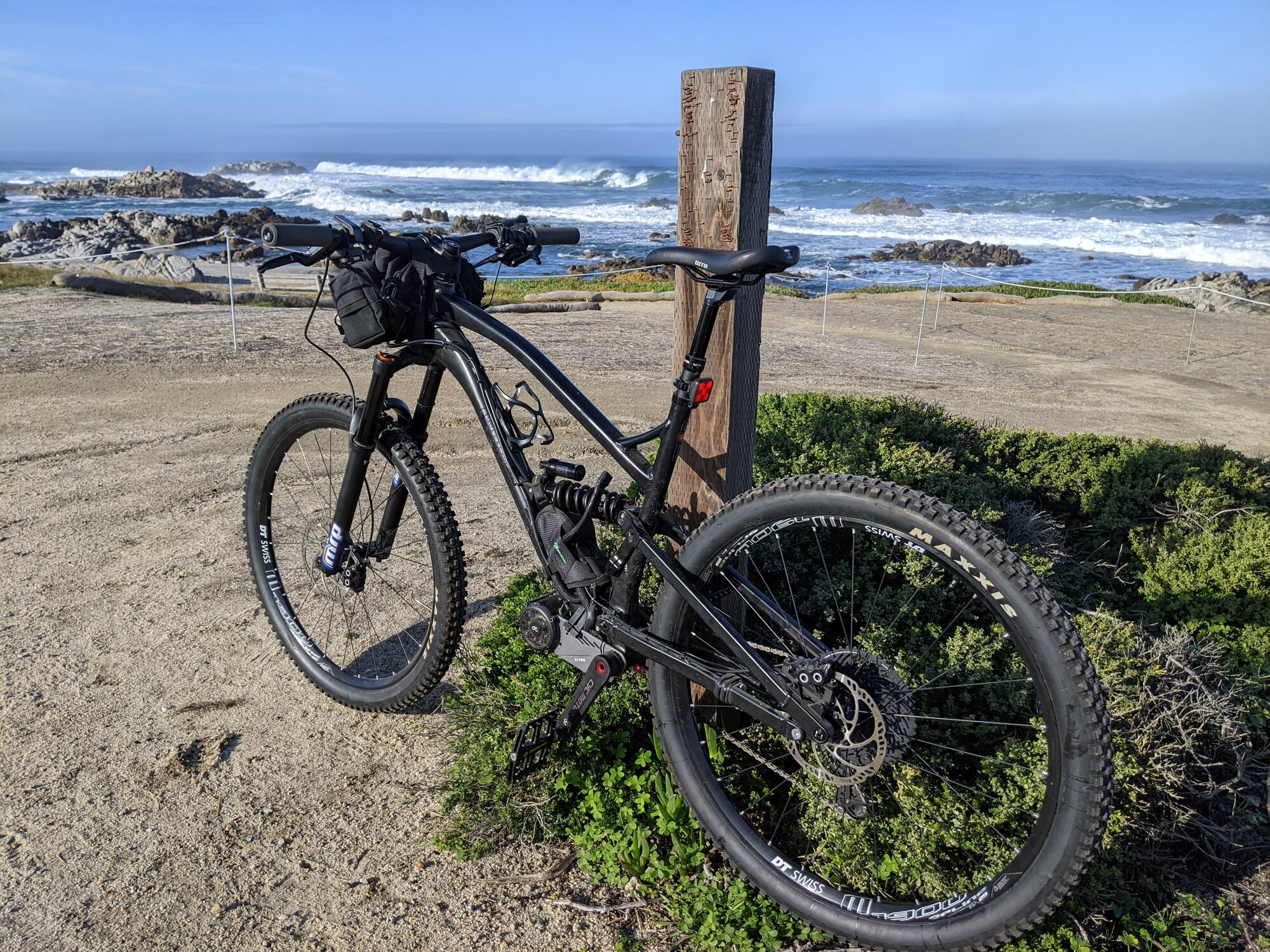

Hey, I just bought the same Northfork bike used. You've encouraged me to go ahead and use it for a first conversion build and to go with the CYC Pro G3 motor over the BBSHD. How much of an issues for you is the sound with this motor? The gen3 is supposed to be quieter. also...what frame did you find that's based on the Dengfu?
The Cyc X1 Pro is noisy. No way around that description. Mind you... its not what I'd call bad. But its never going to be mistaken for anything considered quiet like a BBSHD. On the flip side of that, though, its one hell of a lot more powerful. Mine has an aftermarket BAC800 programmed by ERT and it gets so high up in rpms its more than a little scary if you think on the stresses the kart chain is going thru. But... its never failed on me and there's no sign of excessive wear.
@Boostin22 is dead on the money about the drivetrain components. I would add to them: Buy the steel DT cassette upgrade to accompany the pinned cassette. I also use the Sunrace CSMS in 11 speed for the same reason: Pinned and all steel. Also the DT Swiss 24 pt ratchet upgrade is a big plus. If you buy the DT 350 Hybrid hub - meant for ebikes and tandems - it includes the 24 pt reinforced ratchet and the steel cassette out of the gate.
For the last couple of builds I have used the 9 spd 11-46t Microshift cluster which is pinned like crazy, and solid steel cogs... no spiders just 1-pc hardened steel.
