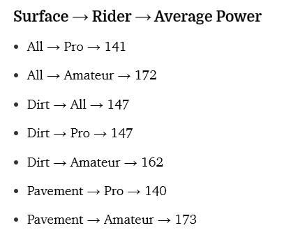

The average leg power of a competing pro athlete riding a traditional road bicycle is 300 W.
It is far less for the rest of us.
E-bikes provide far more power, hence chain stretching is common, especially with mid-drives. However, chains do not snap on good e-bikes with reasonable assist. Now, apply the full 1000 W to a cheap (low end) drivetrain and just wait for the trouble :)
