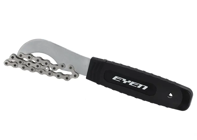

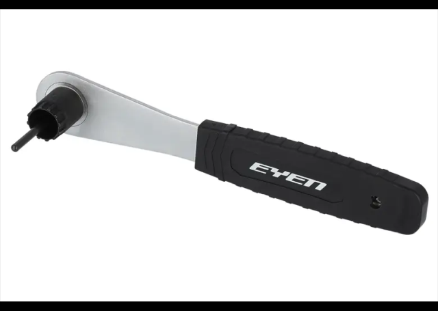

Following the severe breakdown of my Vado that resulted in the warranty rebuild of the Vado 5.0 to the current Vado 6.0, I lost the count of kilometres ridden on the two incarnations of that e-bike. As the outcome, as many as five smallest sprockets on the cassette wore out. I thought to myself you needed to replace the entire cassette once in a while With the new cassette in my hands, I discovered both my brother and the local bike mechanic had no time to do the cassette swap for me fast. So I pedalled my Vado SL to a good bicycle store in Warsaw and bought a cassette wrench and the cassette whip (at last having these tools in my collection!)

When the process was done, I placed the lockring in the socket, did several turns with my fingers to secure it, and then applied the newly bought cassette wrench. Rattle! and the thing was done! I have never thought the cassette replacement could be that easy! Ya, but I knew I should be very careful during the process.
First of all, I had to watch a Park Tool video on YouTube to understand how you actually apply the whip to the cassette sprocket!
