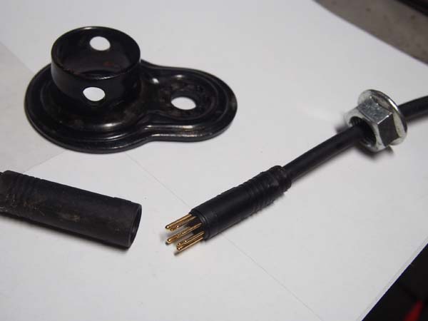

If your present motor has this kind of connector, odds are another motor/wheel with the same 9 pin connector will fit. (Ignore the metal bracket. That's for a trailer hitch.) I've owned three different motor brands that used this connector, and they all were plug-n-play.

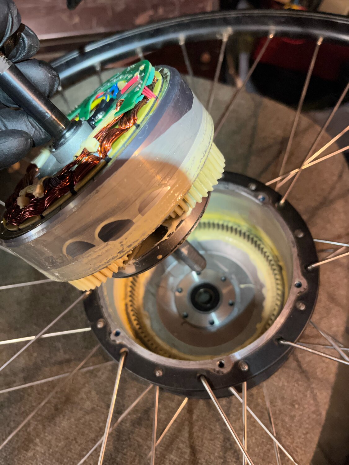

With Bafang hub motors you pull the guts from a good motor, pull the guts from the fried motor, and plug in the good motor guts. No fussing with wheels of spokes at all. No idea about compatibility in what you are looking at.

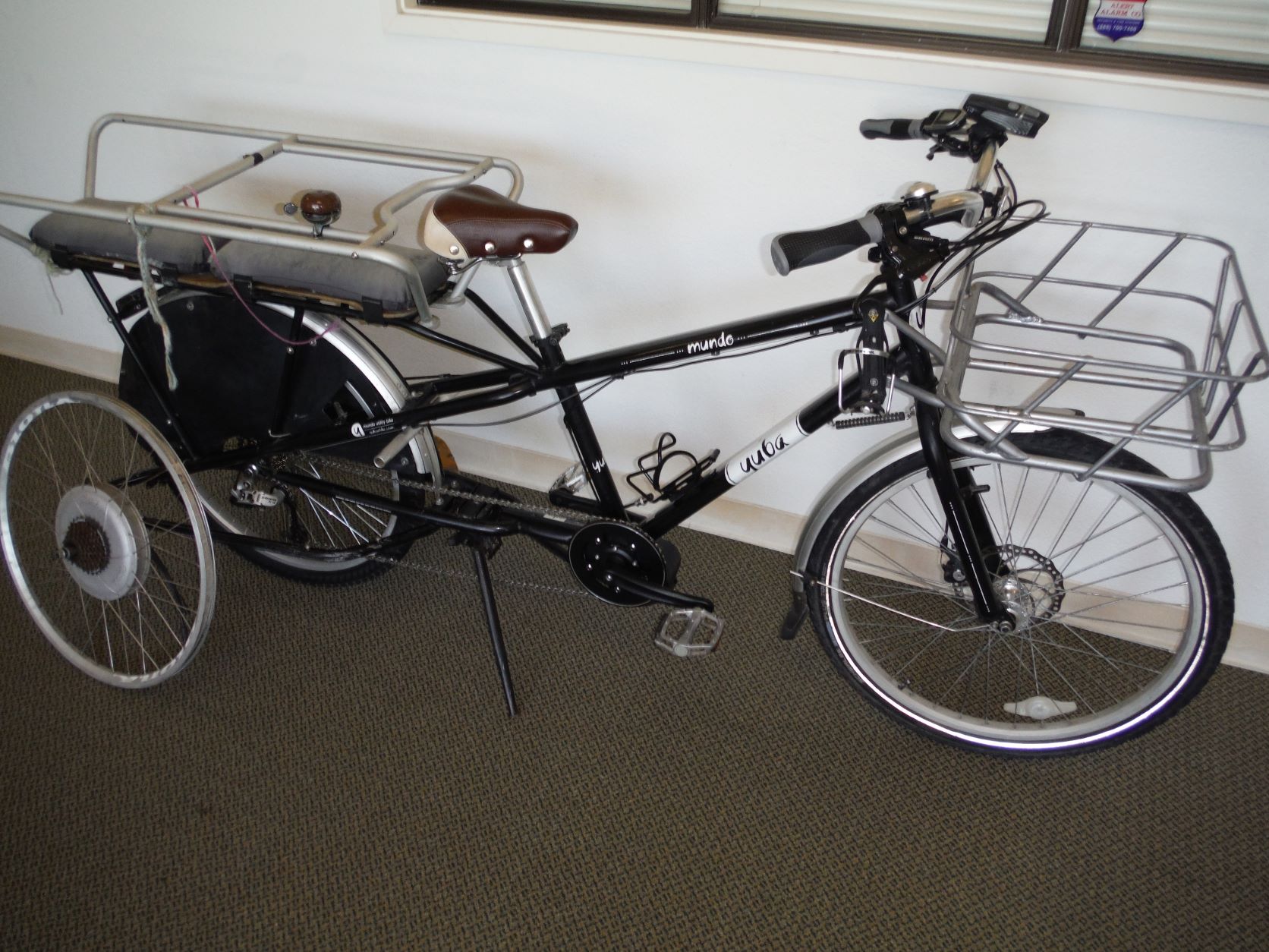

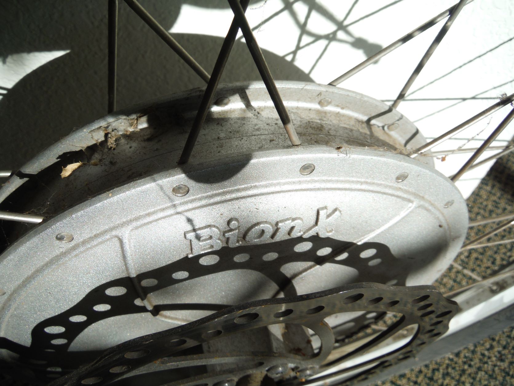

This bike had a failed hub-drive. So, I ditched that and made it a mid. Here is before and after. As of this hour it looks like I will be doing that to another Mundo.

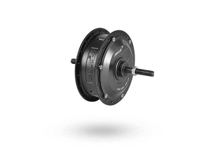

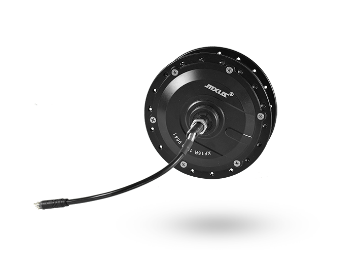

If Leon is out of stock I'm curious if I can simply order a replacement motor from another supplier and swap out the internals? A few folks on this forum have identified the Das Kit motor as a Mxus xf15r and looking at the measurements and specs, it seems to be the correct motor.

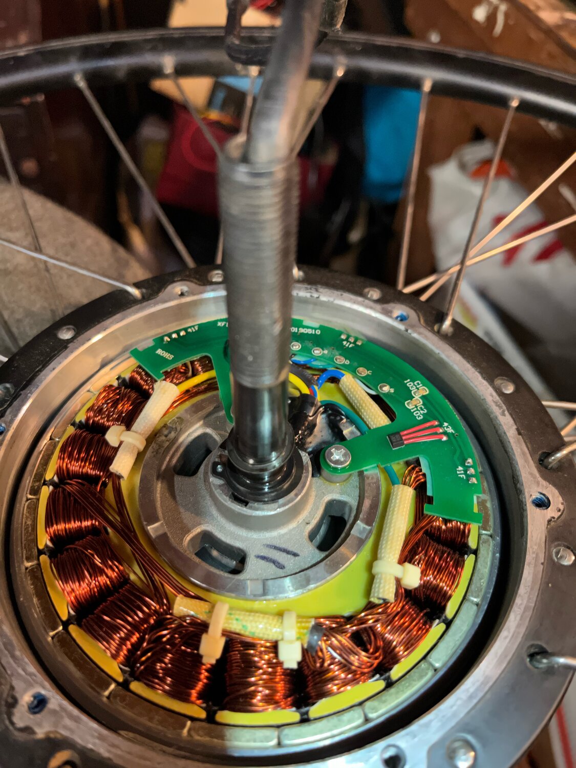

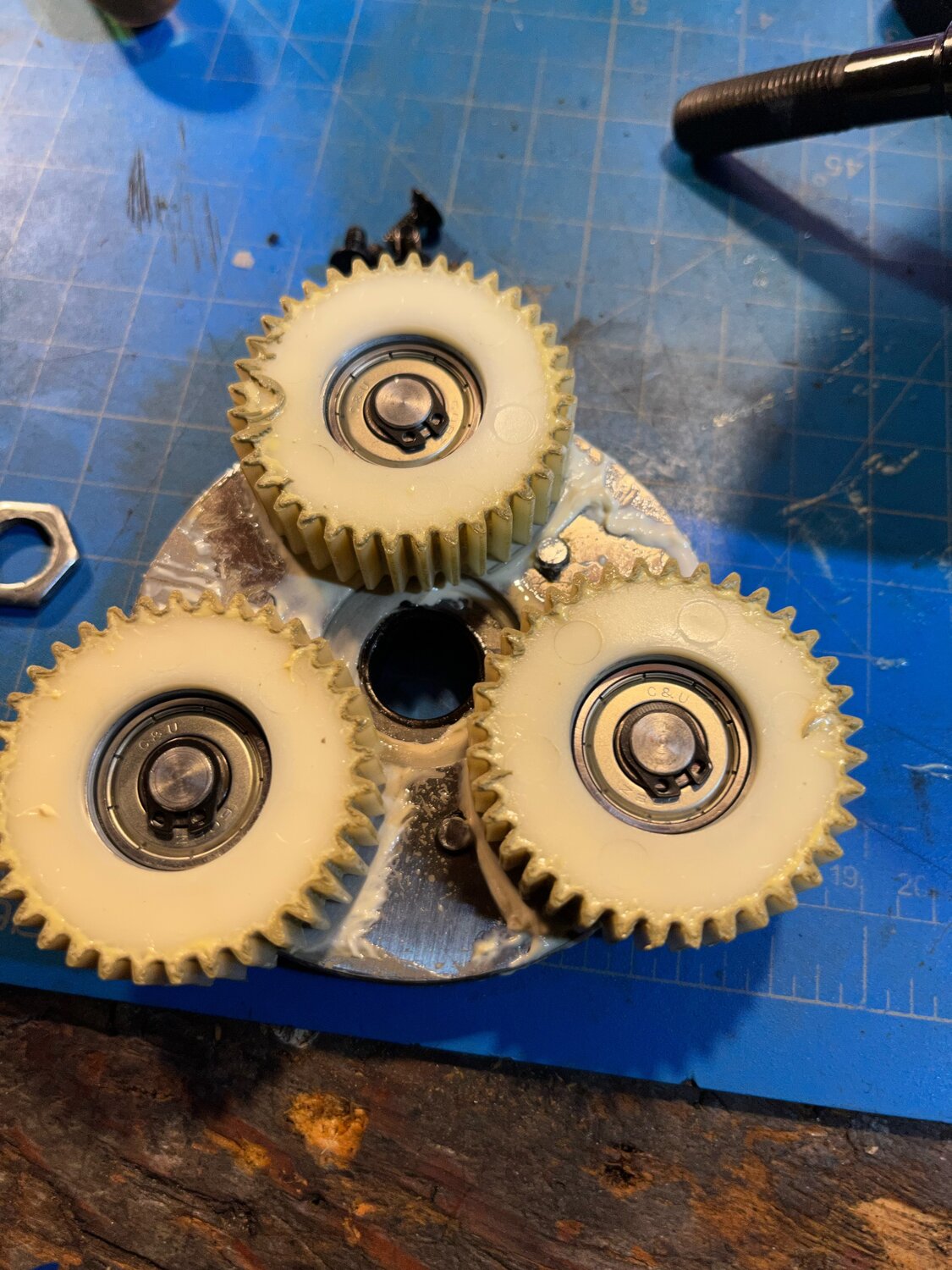

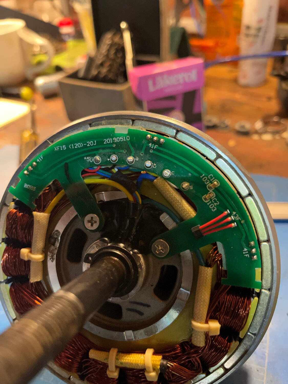

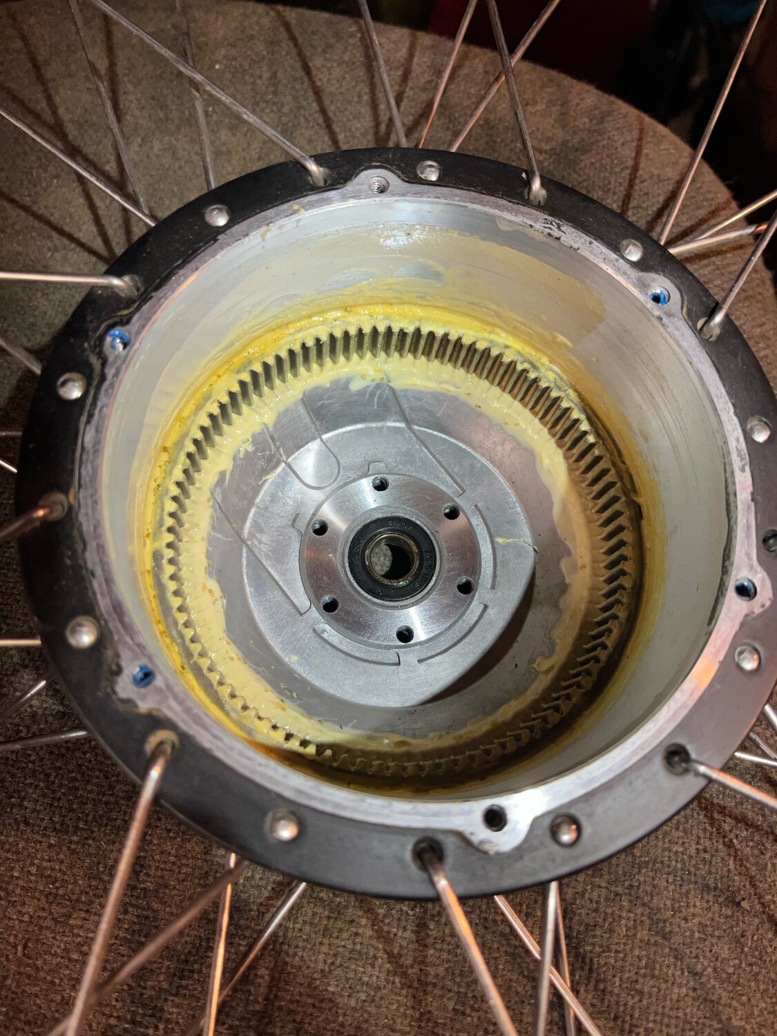

I pulled apart the broken Das Kit motor just to see how it comes out, and it's surprisingly easy to simply pull the "guts" of the motor out. It's definitely a geared motor with nylon cogs. Nice to see a decent amount of grease used.
I couldn't see any obvious signs of failure, like broken connectors or burned out parts, but I have no idea what I'm looking for.
A Mxus xf15r would run about $100 +shipping from China. Considering the shipping delays and lunar new year, it would probably take 4-5 weeks to arrive. For about $200 I could get a built wheel, might be worth it just to have a spare.

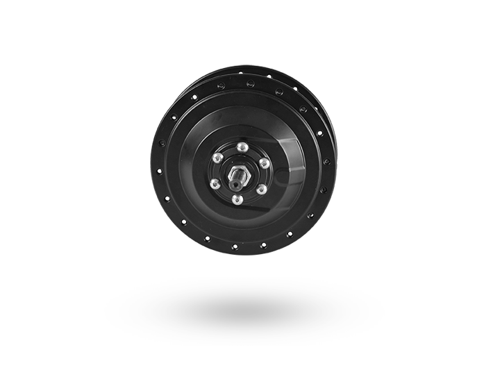

Anyhow here's a random link on aliexpress.com with the motor + wheel. Think it would work?
Some pics of the stock Das Kit motor (my broken one):

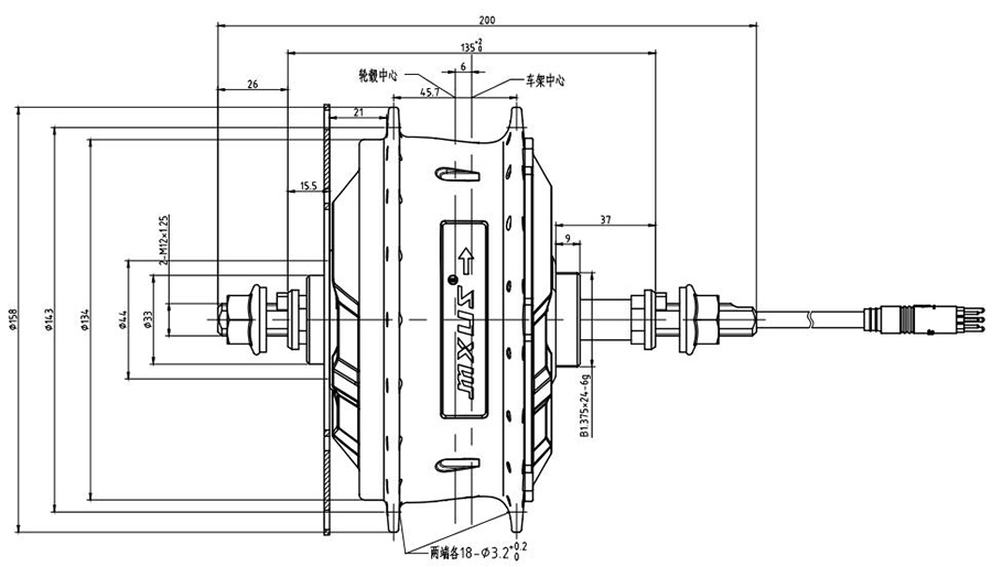

Here's the product page for the Mxus XF15R
http://www.mxusebikekit.com/proshow.aspx?cateid=68&productsid=196
From the site:
Gear motor
Rated Voltage(V):24/36/48
Rated Power(W):250-350
Wheelsize(inch):16-28
Rated Speed(km/h):25-40
Weight(KG):3.5
Open size(mm):135
Cable location:shaft center right
Color:Silver/Black
Brake type:V brake/Disc brake
I don't know if my original motor is 250 or 500: the manual says 250, the website says 500. I've pulled it apart just as you did, @EnduroDad, and saw just what you show in the pictures, above. I was looking for wear on the nylon cogs, but didn't find any and don't see it in your pic. Another EBR poster claims that if the plug matches the motor will work, and this is indeed the plug my bike has. Furthermore, both of my bikes have the X15R### on the motor. I'm convinced it is indeed the Mxus XF15Rs and I see lots of them for sale on eBay for @$100 with $45 shipping charges. Before ordering, however, does anyone have a thought on whether there is an obvious upgrade to be had here?
