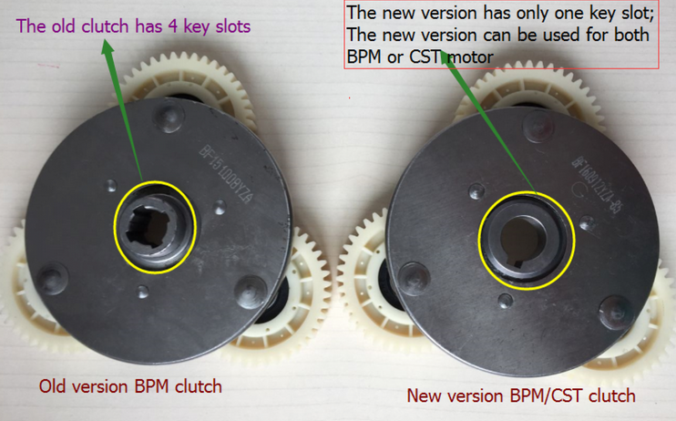

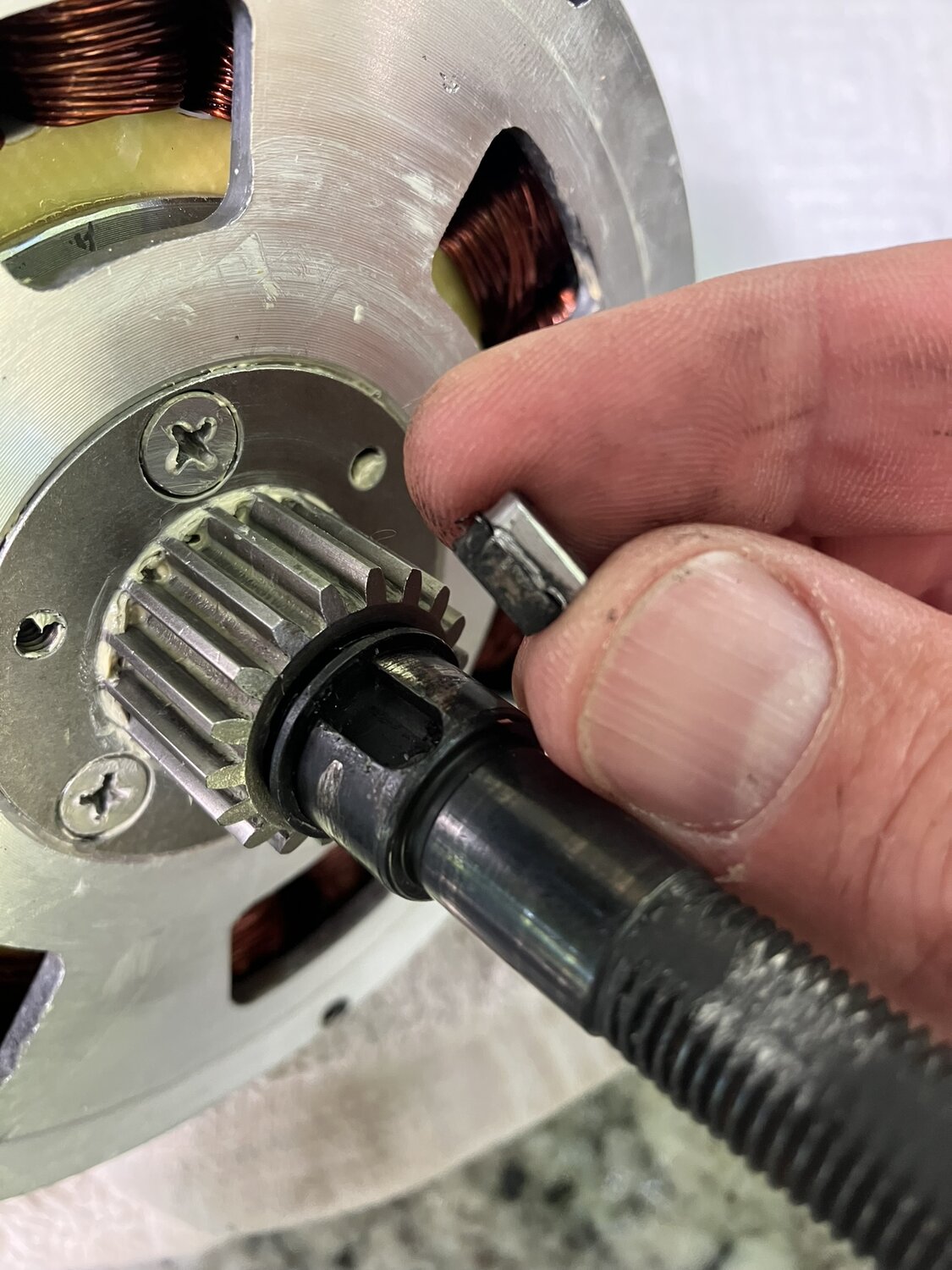

I received my new planetary gear and clutch and the gear puller to get the old one off. There was no sign of visible damage on the old one; aside from the grease it looked exactly like its replacement, so I suppose I shouldn't have been surprised that replacing it had no effect on my problem. But the exercise was productive, because it was only when I pulled off the old assembly that I realized the metal piece (shown in the photo below was broken.... In the photo, below left, I hold it as a single piece, because I'd glued the top (the part that sticks out of the little u-shaped hole above the central sprocket) to the bottom (the part that goes in that hole). The top and bottom halves of this had sheared off, so I think that's what's prevented power from transferring between the motor and the shaft. I think this is a design flaw: as shown below, there used to be four slots with metal fittings to transfer power between the motor and wheel, and in the new design there's only one. I'm sure it makes it easier to install a gear and clutch assembly, but it also means that if you have an issue with that one slot you're done. Seems doubtful that some superglue will fix the problem but that's what I'm trying because a replacement part doesn't seem to exist.

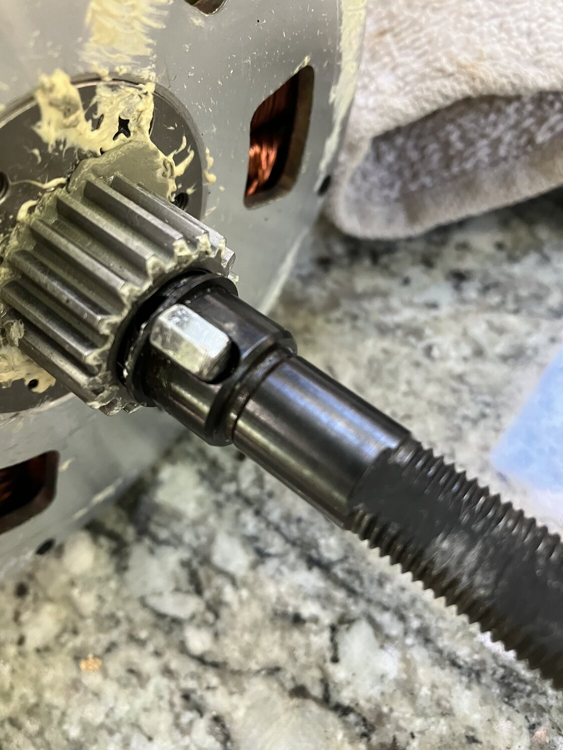

It's done! The broken metal "key," shown above, was indeed the problem. I checked with MXUS in China (fast reply!) if they had replacement parts for this, but, after scolding me for trying to repair my motor on my own, they confessed that this wasn't a standard part, just something they made in their own factory for these motors. They were willing to send me one, but it was much faster and more certain to make my own: I cut off the end of an appropriately sized hex wrench, stuck it in, regreased the motor, and am back on the road. Thanks all for the advice. My conclusion from this experience is that if the motor breaks, you just have to pull it out, disassemble it to a reasonable degree, and look at all the bits. Had I started with that this would have been days, not months, to get it up and running again.
