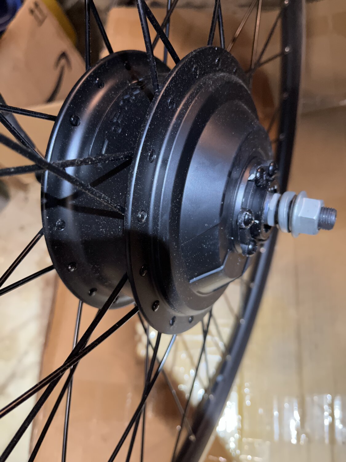

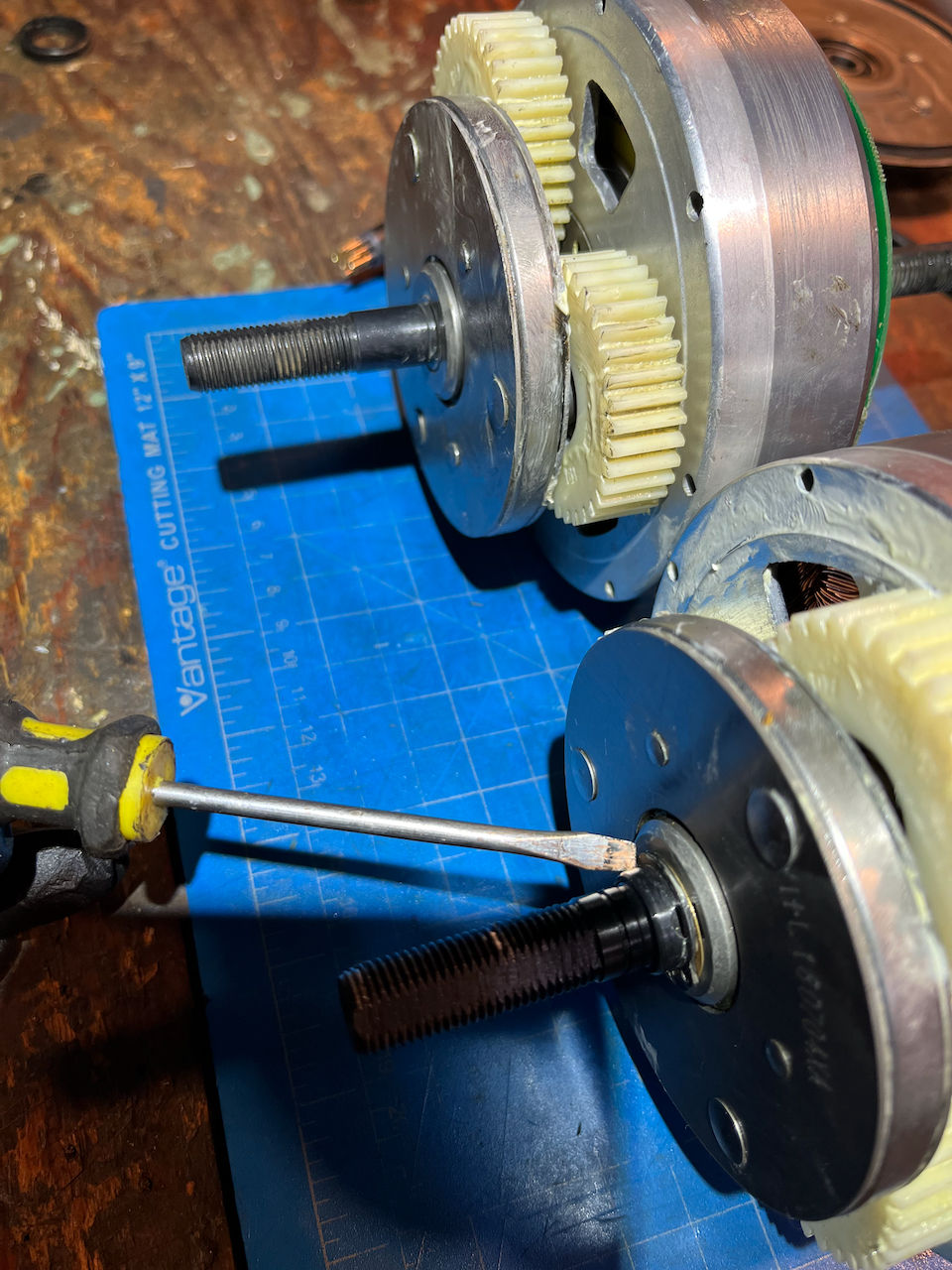

Hi all, another update: I was hoping the new 500w motor core from Leon would have done the trick, but it turned out that the axle is different on the old 250w and new 500w motors. So I couldn't fit the new motor all the way into the old hub shell, there's a "buldge" or collar on the 500w axle. I'd imagine the new 500w design has a larger bearing on the brake-side to accommodate the larger axle.
Attached is a photo pointing out the new 500w axle, compared to the straight axle in the old 250w.

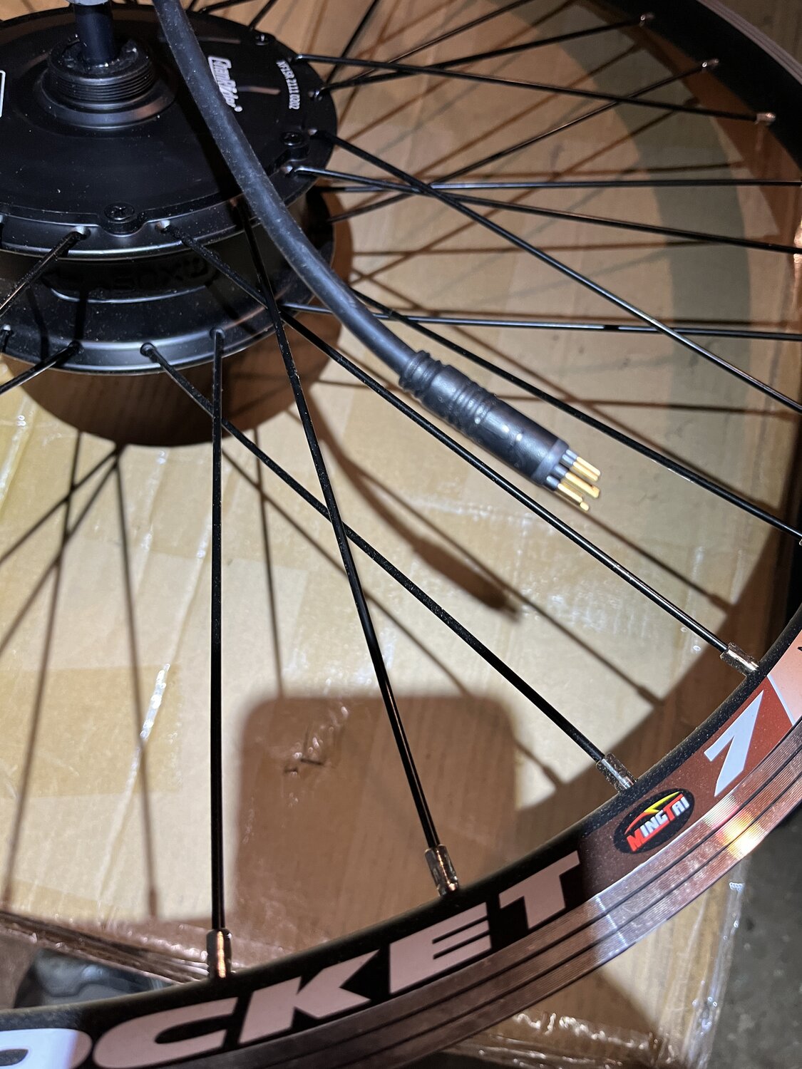

@cornmaze I'm sorry to hear it, that sounds super shady. Which vendor did you purchase from? The vendor I used was "chamrider Official Store" on aliexpress. It took forever but it finally arrived. I messaged them on aliexpress asking if there were any updates, and they said "The delivery time is about 60~ 75 days. Please wait patiently."
I ordered Feb 15, finally arrived April 7.
The new wheel installed easily and works fine but there's a problem I haven't sorted out yet: The speedo no longer works, and as a result the bike has no high-speed cutoff which is a bonus for me :)
Power is the same as the stock motor, graphics are a bit odd but it's just a sticker that can be removed:

It is likely that the wheel magnet to speed sensor pickup is not aligned. It needs to be within 2mm. I remove both from my builds. I remove everything that hinders feel and performance. And chop off any ugly wires and connectors to make for a clean build.
