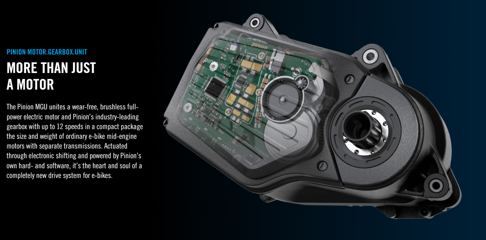

Surprised that there hasn't already been a thread on the new Pinion MGU motor/gearbox combo.
I think it's been something a fair number of people were expecting for some time now.

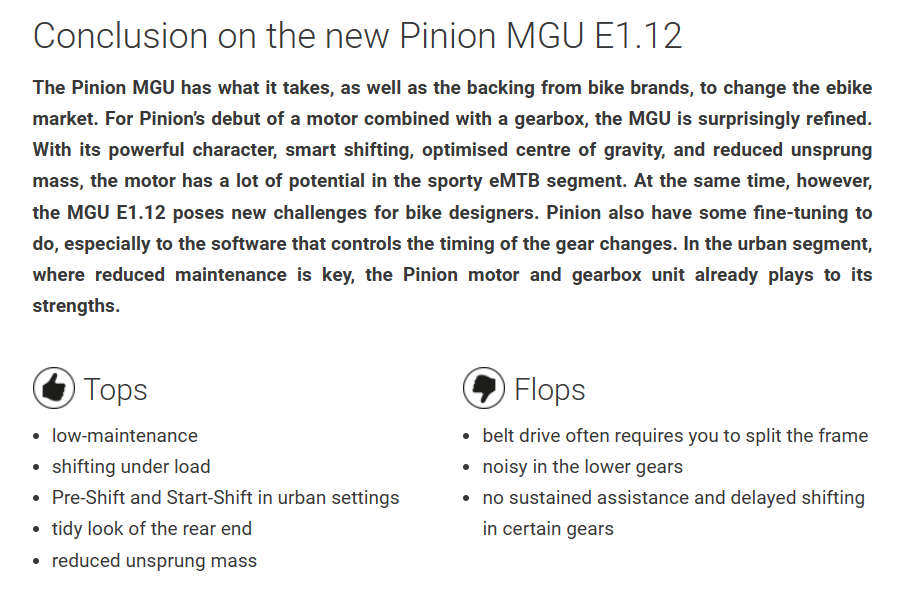

ebike-MTB.com has a first ride report which reports mostly good things. Oddly, it seems that technical climbs are one of the weak spots, or maybe it's a matter of getting used to the shifting in the new system.
The company is reporting that a 10 minute oil change every 10,000km is about all the maintenance it will need.

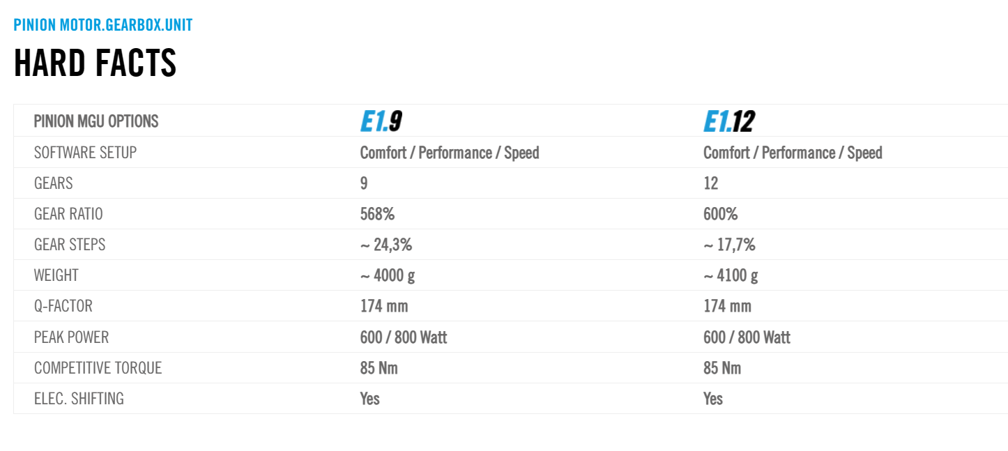

Can be used with a carbon or traditional chain, and will have both 12 and 9 gear options (600% and 564% ratios respectively, with even stepping)
Looks like it's comparable to the Shimano EP8 in size, but with less rounded edges (there's an overlay on the website that looks like the EP8).

The 568% gearrange is overkill considering 11-46t cassette is about 440% and more than enough for trekking bike with loaded trailer or 45kmhr commuter. Going to 400-450% would give smaller jumps between gears. NB also have 600% 12spd version.
