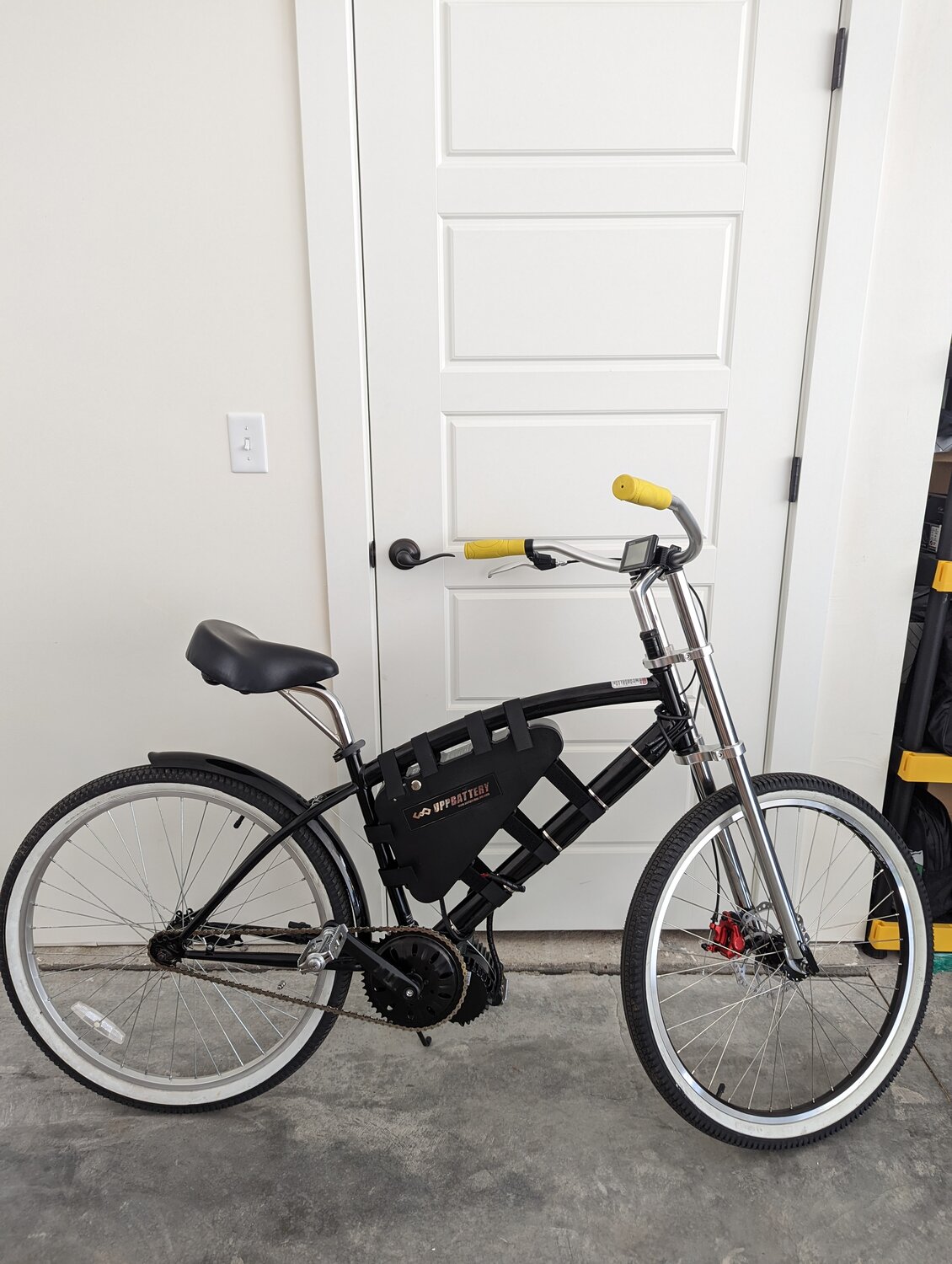

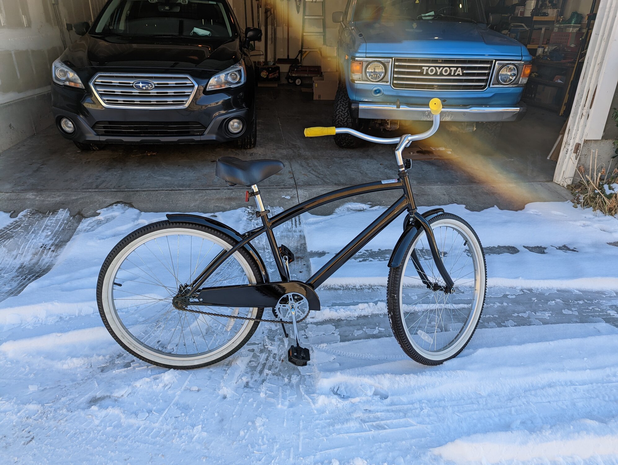

Hi All,
Ignoring all common sense and the remonstrations of my local bike mechanic, I converted a beach cruiser to electric. Before and after pics attached. I call it the "bad ideas" build because when I took it into the bike shop and told the mechanic what I had planned, they said "ok, you have several bad ideas going here". Lol. As I learned, they were right on a lot of counts, but not all. Below are the basic specs. I have found it to be a blast to bomb around on! Though, the fear it may fly apart at any moment probably adds to the exhilaration. :)
Bafang BBSHD 1000w
52v 20Ah battery
Chopper style fork
Front disk brake
Layback seat

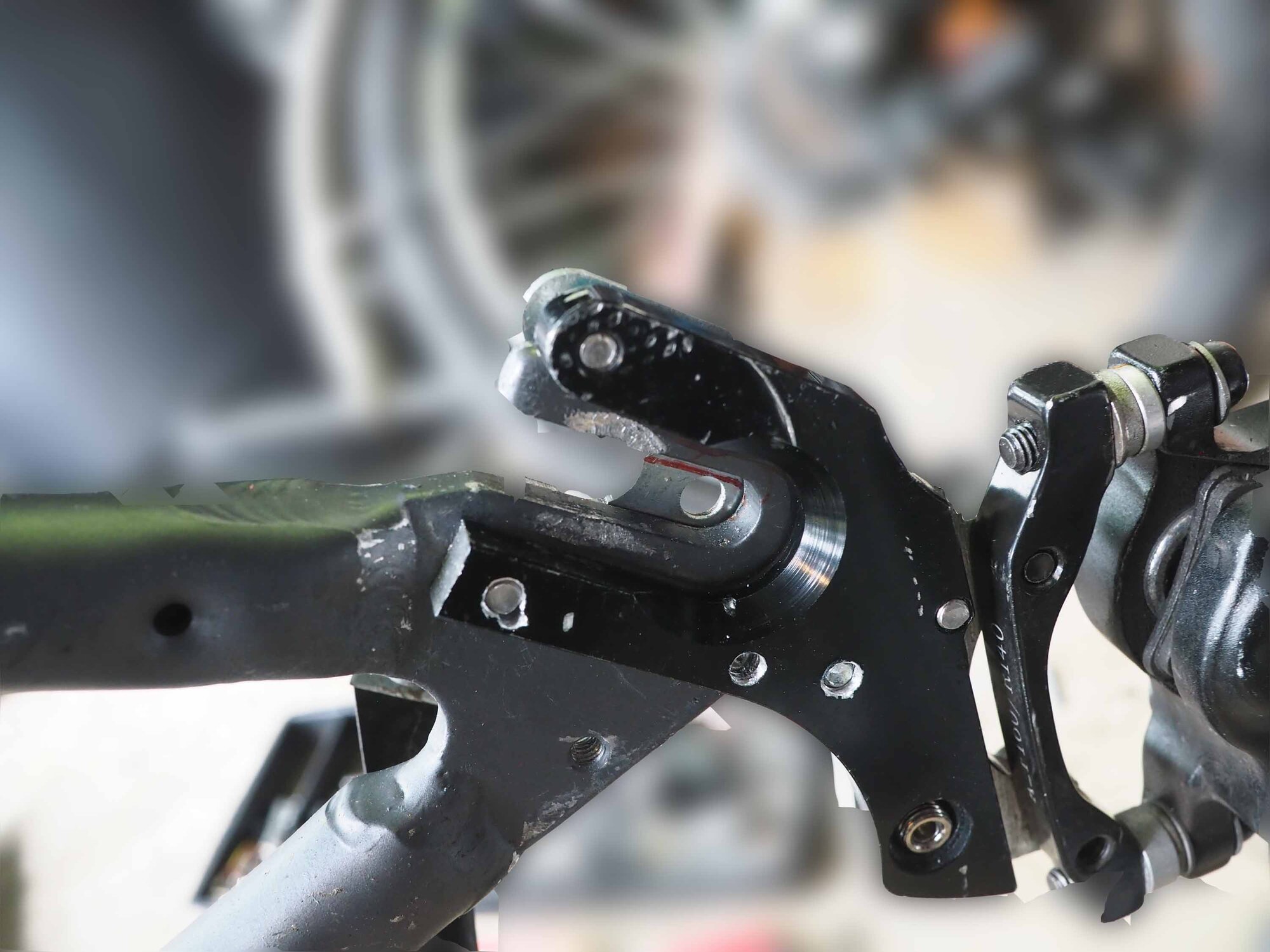

I've used this adapter on the rear of a frame, and also on a front fork to attach disk brake calipers. My machine shop comsists of a sawzall, a vise, and a drill press.
It was designed as a thru hole bracket for gas powered bikes. I cut a slot in it to line up with the notch on the frame dropouts and positioned it so it could be bolted to the frame. It's CNC aluminum. Just a matter of removing some extra material, locating it on the frame, and mounting it. It's mpre suited though for a motor mount.

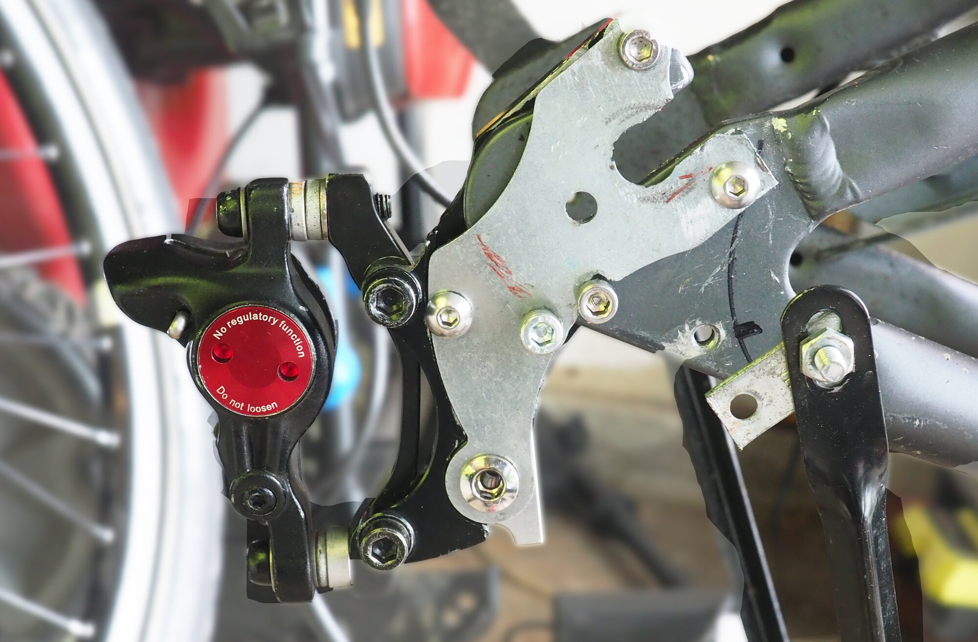

Here's one that can be used on a regular wheel without any machine work. It clamps onto your dropout, and the wheel axle, skewer or nuts, is torqued down on the metal plate to hold it.
While it worked, I wanted mine to be tighter, so I attached it to the frame with screws. Picture shows a mechanical caliper, but I later switched it to a hydraulic plus hose.
