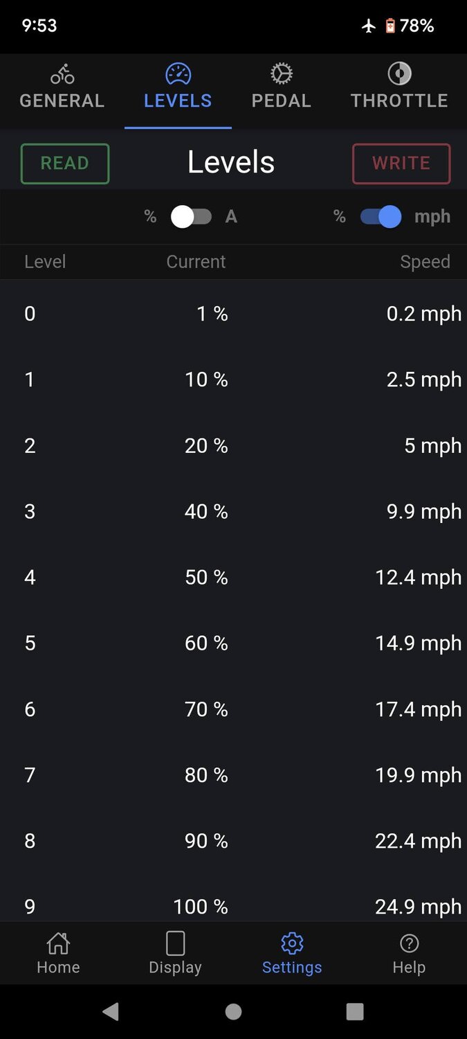

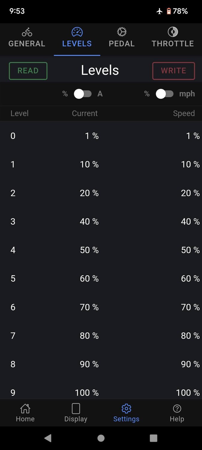

One thing that might be happening is that the controller can take the setting either way and that eggrider uses road speed. The reason I say this is the SPEEED app gives you the choice... though I've always used % (edit) as that was the method I started with on a PC. And now I like the % setting in that I really don't care about road speed to the extent I do cadence as that's what I try to maintain during a ride.

I would be very surprised to find that the controller could interpret data in more than one way. I believe that the Eggrider or the Speeed application are simply reading and writing various data streams to the controller. I suspect that the controller firmware is stored in some sort of programmable memory. Once powered on it responds according to the values that are in memory. The normal display has ability to send certain data - like global speed limits and wheel size - which it does at powerup. Once running it reads operating data and writes PAS changes to the controller but it can not make changes to the profile. The Eggrider and Speeed application are different in that they can read and write many more data fields as occurs when a Read or Write operation is requested
I suspect that the Speeed application does a simple speed to % translation based on the global speed limit but sends the same data as the Eggrider or the computer program.

I concur.. and assume as you say that the SPEEED app is doing the translation.
But we are having two very different experiences. Perhaps we have different firmware versions on our controllers... not that Bafang ever provides this type of information either.
I guess one way to test would be for me to try using mph and see what happens with one of the test mentioned earlier. But since I'm pretty happy and pretty much done experimenting for now... You're more than welcome to try % 🤣
