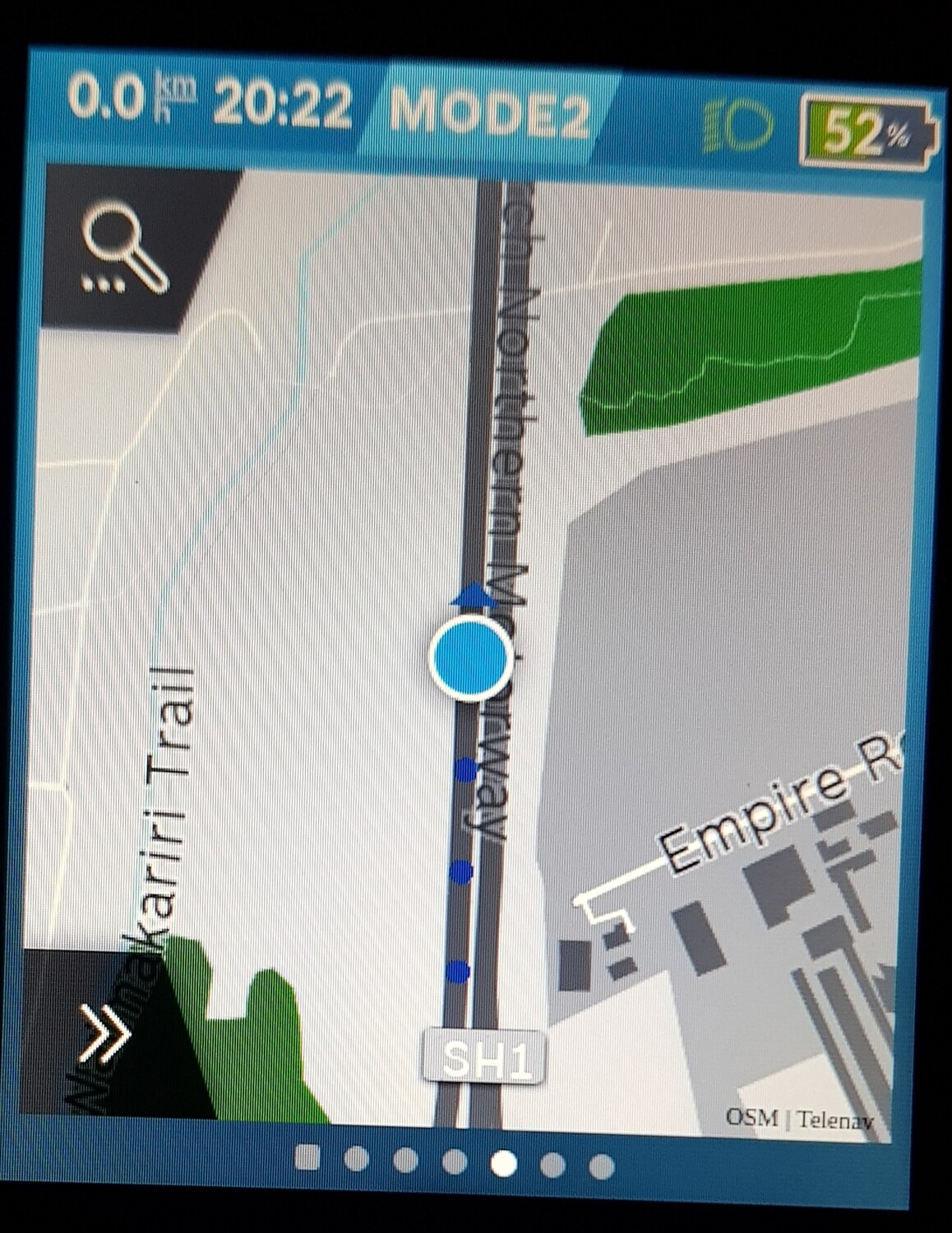

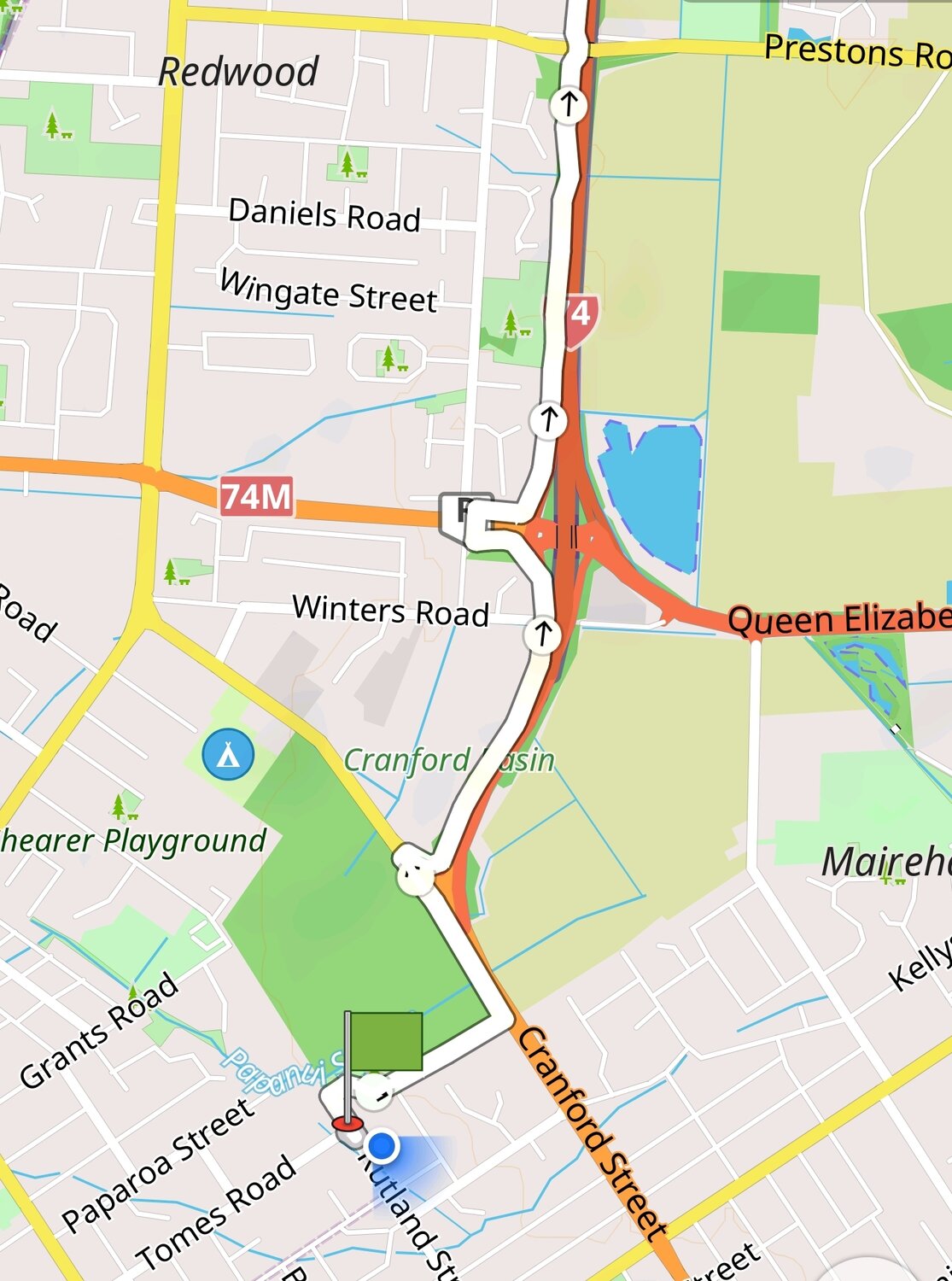

I would like to add to the above discussion on the problems encountered using both the Nyon 2 and Ebike-Connect mapping and routing functions. I hope that this might point to the source of the problem and perhaps lead to a solution.
The test cycle trip is along a path which meanders alongside a new motorway, opened about fifteen months ago. At the time of opening, the cycle path was displayed and active on Open Street Maps (the base map of Nyon/EBC) and implemented correctly in my alternative app which also uses OSM.
Currently Nyon/EBC only recognizes the mid section of the "test" cycle path. I understand the Nyon/EBC map was last updated in October 2020.
For this test I simply displayed the map screen with the position marker. That is, no built in routing nor imported GPX track following.
While riding the mid section of the path the displayed map behaved as expected. That is, the location marker was shown in the correct location moving along the cycle path.
When the section of the path not recognised by Nyon/EBC was entered the marker hesitated for a few seconds and then spontaneously jumped about 100m to the left, to the far lane of the adjacent motorway, and then continued in that lane. This behaviour is bizarre to say the least.
Surely the marker should show the bike's actual location regardless of map features and mode being used ("none", internal routing or GPX track following).
This behaviour occurs regardless of the rerouting setting.
Thankfully the exported GPX showed the actual bike location throughout the test trip.
Clearly an updated Nyon/EBC map would at least mask the idiosyncracy. Has the OSM map been modified by Nyon/EBC to such an extent that regular map updates are not practicable?
Cheers
Peter
The marker incorrectly on the motorway:

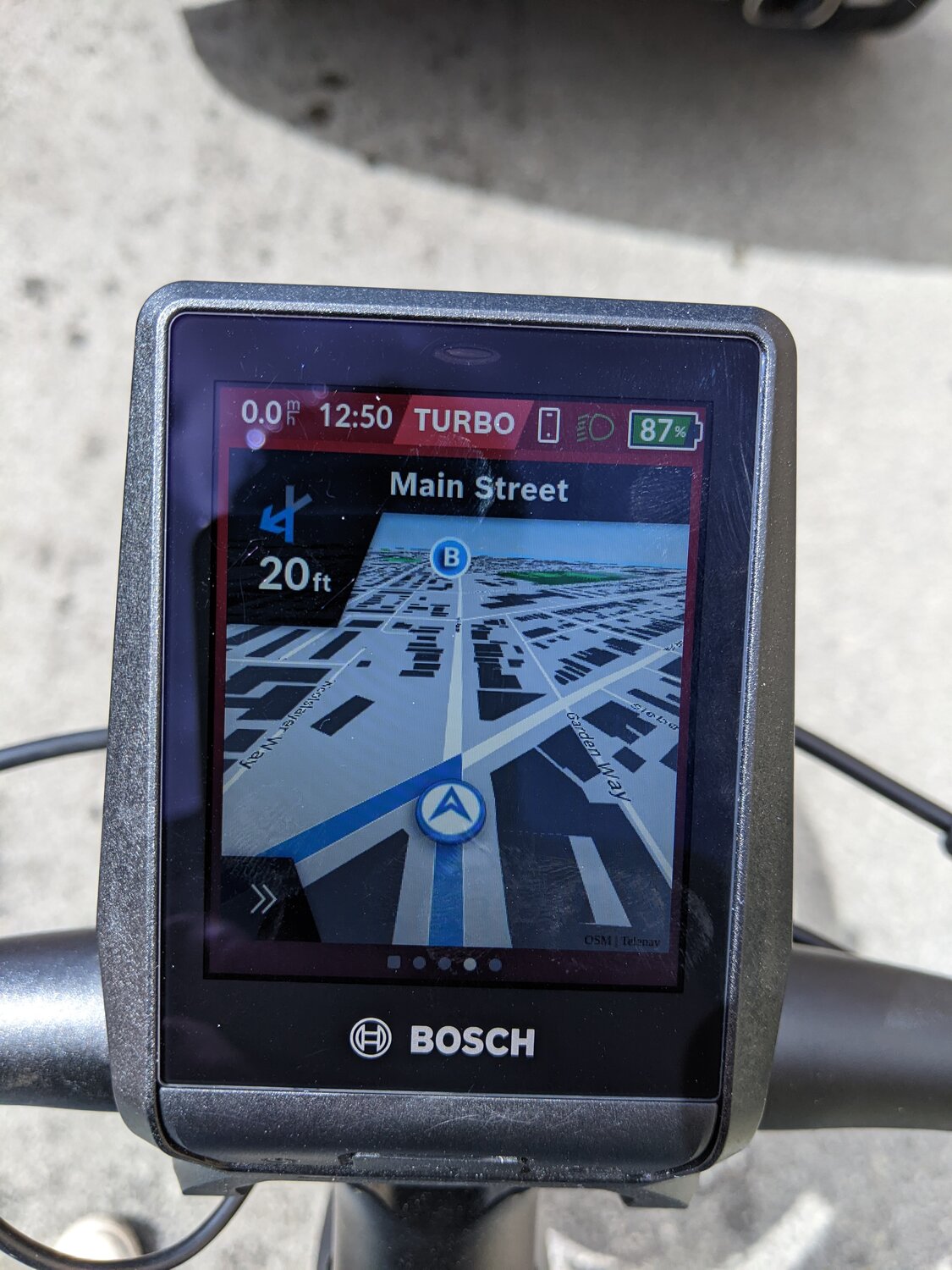

wow, i read people talking about nyon routing before i upgraded and thought "how bad could it really be?" well, that was foolish...
i used it for the first time today, I looked up a destination on the phone app (not sure if that was the cause of some of the misbehavior?). I was kind of in a hurry (going to an appointment) so I didn't take a good look at the route, just sent it to the device and went. As soon as I left my house it was trying to make me turn in the opposite direction I'd normally go, although certainly you *could* go that way. but, since time was a factor I decided I'd just ride the way I always do and let the Nyon re-route. That essentially never happened, I mean it did re-route but it kept trying to make me go back to the original route or something?
Here, you can see the destination is almost directly in front of me, it's not *quite* on the road I'm already on, but all I need to do is go a few more blocks, hang a right, and it's like the 2nd place from the corner. So, where is it trying to take me???
Of course, that pales in comparison to what happened when I got here. I didn't get a picture of the Nyon because the light was green... but the road splits into two one way roads with a parklet in the middle for a couple blocks and it tried to send me down THE WRONG SIDE! There is a bike lane there but it is *not* contraflow. wow that's bad!

Isn't this caused by the poor decision to make rerouting start from origin rather than next waypoint?
If you don't pass your origin, it will always try and take you back there. It's a really bad default value, and the engineer or product manager responsible needs to have a very hard look at themselves... It makes the product look way worse than it at is
hm, that's actually interesting... i guess, if I were in a car I pretty much always just want the GPS to re-route from the current location to the destination, although I could see cases on a bike where you may not want that, like a section of trail is closed so you want to detour and go back instead of having it route you on the road... so, i guess it would be nice to have a prompt. I'll have to try the stop and restart next time.
routing me the wrong way down a 1-way street though... no excuse for that, at least it was an area i am really familiar with.
Yes, starting navigation by choosing the "from next point" option solves one of the issues. However a number of other idiosyncrasies remain which seriously hobble its map function usability.

Using Nyon 21 with map displayed and using location pointer (not routing nor following a GPX track):
I mentioned earlier how the location pointer on the Nyon 21 map screen spontaneously jumped, from following the cycle path I was on, to an adjacent motorway and tracked along the motorway. This no longer happens on that particular test trip. That's definitely an improvement.
However, I wasn't sure whether the change was due to the updated map or a change in the software logic. To test this, I rode along cycle paths next to large open areas (playing fields) and diverted from the paths towards the centre of the open areas. In all tests the location pointer doggedly remained on the cycle path until I was at least 100m from the path, at which point the pointer jumped to my actual location. The following image shows two of these tests. The blobs on the tracks within the open spaces represent the point at which the location pointer jumped to my actual location (I rode in a tight circle to mark the point).
It seems that some "stick to roads" function has been implemented. I realise this is warranted in some situations. However this is of no value to me and I would rather have the option to turn that function off, as is the case in other software I use based on OSM.

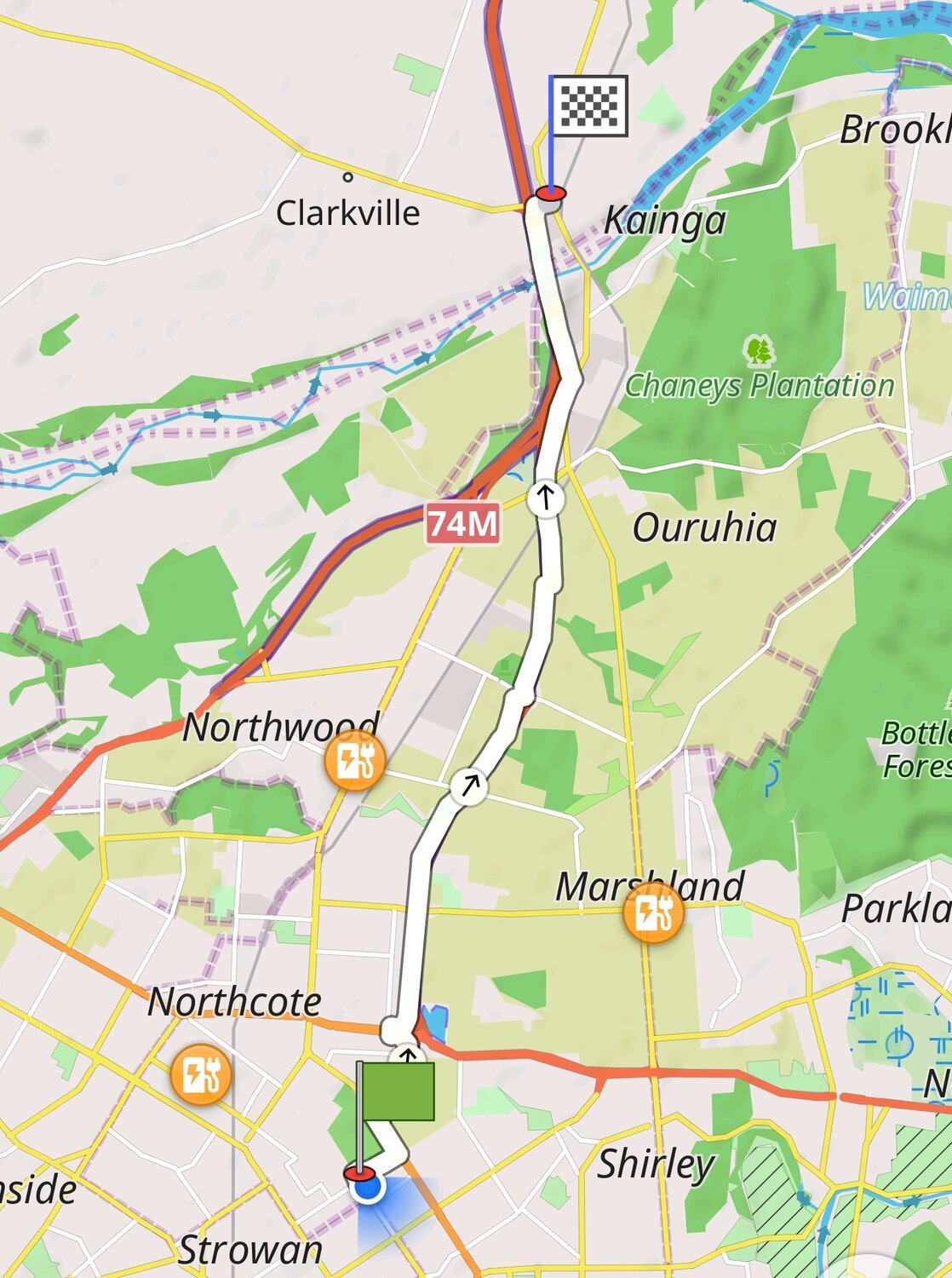

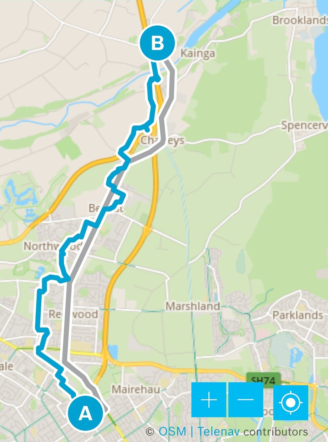

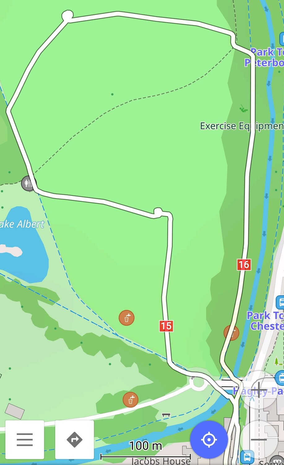

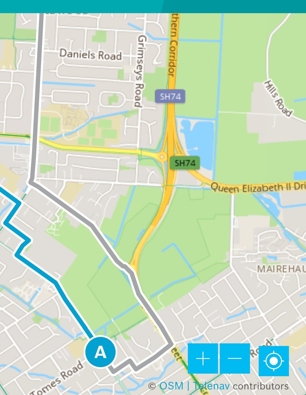

Trip Planning and Routing:
In both EBC and Nyon 21, trip planning continues to result in illogical and inefficient routes with cycle paths seemingly being avoided, with considerable inbuilt determination. The following images illustrate routes produced by EBC compared with OSMAnd, both with the same starting point and destination which are along a contiguous cycle path. Both mapping systems are based upon OSM. (Complete routes and details of the beginnings are shown)
EBC
OSMAnd
As another example, I'm riding on a cycle path and I set Nyon 21 mapping to "take me home". There is then a frenetic attempt by Nyon 21 to get me off the cycle path and onto various streets, including some I'd avoid on a cycle. Logically one should stay on the cycle path which is appropriate and heading in the correct direction.
