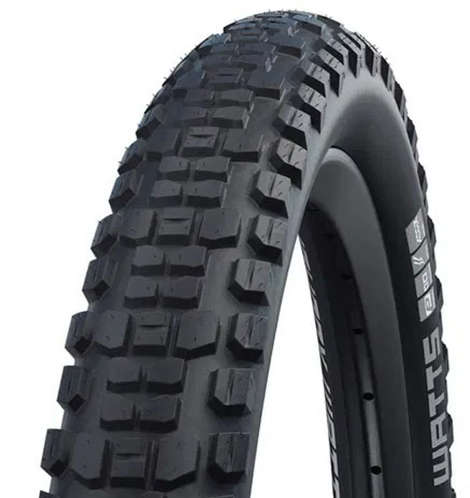

I just installed new chain, cassette, chain ring, and brake pads on my Delite Mountain as well as replaced the front fork and rear shock with the Fox Factory Float Kashmina fork with an added 10mm of range and the rear shock upgrade as well. I put the Fox performance fork and shock off the Delite on Nancy's Homage, which took the travel from 80mm to 100mm. What else should a cyclist do while waiting for an inflamed tendon in the foot to resolve? The final addition to the Delite Mountain was a pair of 27.5x2.6 Schwalbe Johnny Watts. I will post my impression once my foot is better and I have gone on a few rides with it.

I shall be (schwalbe?) curious how that goes. Their site is not good guiding you to what tires are/are not tubeless ready. Unless I'm an idiot and they all are.
They should be more specific, true. A good guideline is a tyre being "folding" (as opposite to "wired"). Typically, a folding tyre is tubeless ready. In this context, Johnny Watts are tubeless ready ("folding tyre") and Smart Sam or Hurricane are not ("wired tyres").

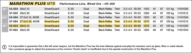

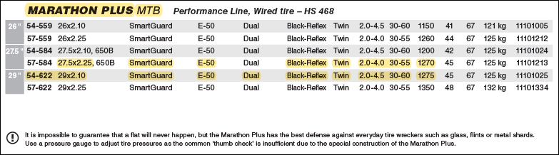

Marathon Plus MTB
+2 for the Schwalbe Marathon Plus MTB's. I've been using them on 3 of my bikes for 2 seasons now with no issues. The 26x2.25 size however has not been available in the US for some time. I wore out the rear tire on one of the bikes and had to order a replacement from Germany.
@Alaskan, Thanks for posting the info on the Schwalbe Hurricane. I may try them on one of my bikes but the 26x2.25's are also unavailable in the US.

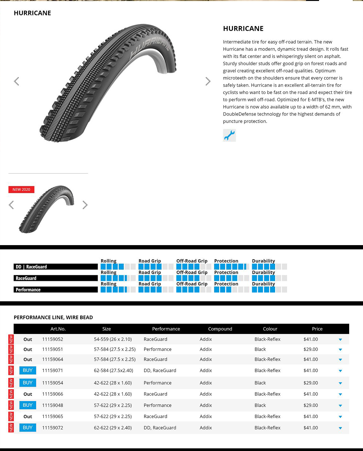

Schwalbe has come out with a new tire for 2020, the Hurricane. I have been riding on a pair for two weeks now. In the main, middle tread, the tire has ridges of micro knobs, similar to those found on skinny gravel tires, with a center strip of fine ridges. There are aggressive, bulky knobs at the edges. It offers 5.5 protection rating with a rating of 4 across the board for rolling, road grip and off road grip.
I have been riding mostly on Super Moto Xs. My riding is mostly on paved rural roads but I do like to explore logging and fire roads. We have several packed gravel trails as well. Finding a tire with low rolling resistance, good traction wet and dry and good grip off pavement has been a tall order.
This tire is whisper quiet on paved surfaces and rolls very easily. It is a very fast tire, almost as fast as Marathon Supremes. The traction on road and trail is very good, verging on excellent. It is sure footed on wet pavement as well. The protection level is only 1/2 a mark lower than Super Moto X tires. The rolling resistance is the same as is the road grip but they are 1/2 mark better on off road grip. To me they feel like they are actual better off road by a greater margin and they are noticeably quieter.
They are quite affordable at $41 usd for the 27.5 x 2.4 size Double Deffense Race Guard with reflective side wall stripe.
For me the new Hurricane fits with my riding better than any tire I have ridden on. This tire comes across as the best all purpose tire I have ridden to date.
