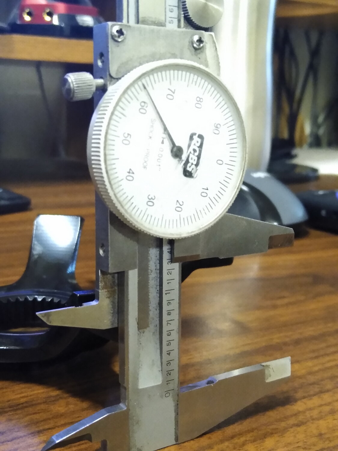

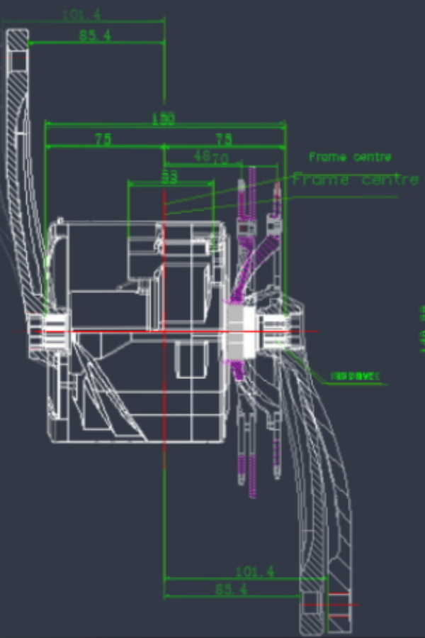

I measure my fat Christini spider at 32.8 mm from the base to the face of the outer ring position, 29.1mm to the face of the spiders' inner ring position (3.7mm thick) but I don't have a Bafang spider to compare. When I lock my caliper to 70.01mm (I can never get it perfect) put one end on the outer ring position of the Christini fat spider, it looks to line up with the centerline of the motor as depicted in the diagram. I did getsome spacers from WickWerks but they're too thick (the ring is too thick, not height-wise) to allow the chain to fully seat on my WT 30T, so unless I remove ~1/3rd of the ring on each of those I'll need to just grab a 32T and use the 30T on a non-assit bike or if the chainline allows on the inner position of the Christini on my 29+ wheelset (don't know if it'll clear the fat tires yet)
@Fast n' Furious depending on the tires you run, squaring out the profile by using a wider rim can prevent the tire lugs from catching your chain while giving you more float on sand/snow and the ability to go a little lower pressure should need it. I was actually discussing this with someone on a fatbike forum as I need to get educated enough to get the right pogies and fit in with the cool riders, and they said going from an 80mm to 100mm Clown Shoes fixed an issue they had with 2XL's in the rear. But of course this doesn't work if it's the tire casing you're not clearing - and that tire is an extreme case.

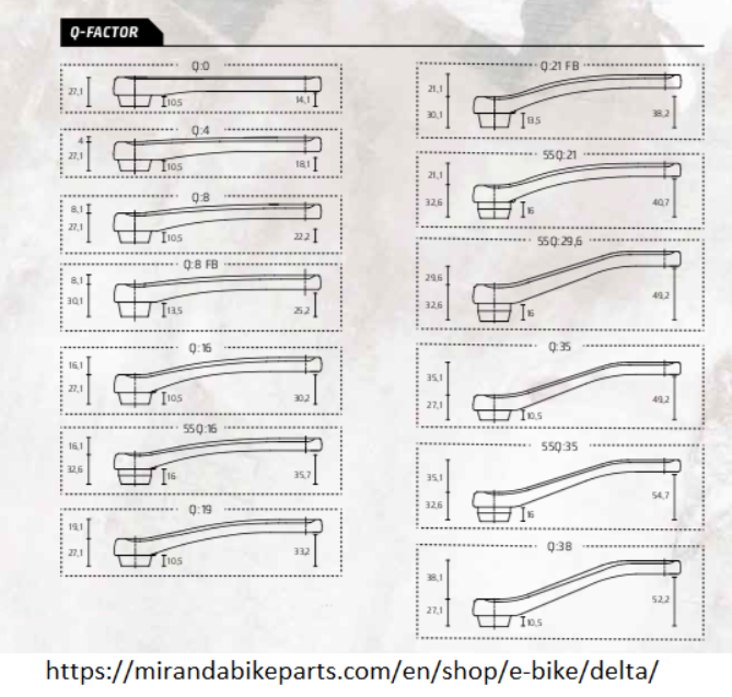

So I tried digging through Miranda's new site but they don't have their charts on every crank arm page like they used to - but I did find the chart. Note the 'FB' versions are for fatbikes.

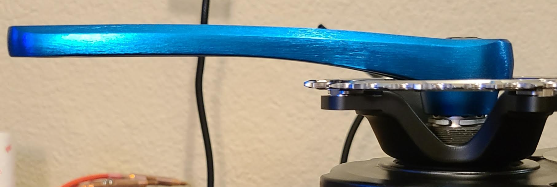

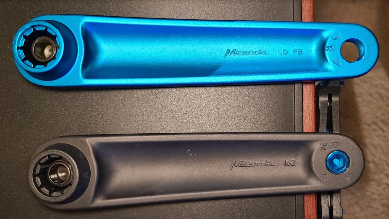

I ordered 2 pair - a 152mm Q:16 & a 170mm Q:8 FB and they both clear the Christini + Wolftooth 30T on the outer position. I believe the Bafang fat cranks are closest to 55Q: 16 but I could be wrong - from the diagram in Jon's post it looks like the standard Bafang cranks are closest to the Q:8. Unfortunately in my case the snazzy blue cranks I got don't clear my chainstay - the black ones do so by around 2mm so I'm seriously considering ordering another set... ugh. I wish these both would have cleared fine as I'm just trying to go as narrow as safely possible while as short as I can comfortably go, ground clearance and being easier to keep a higher cadence and all that. No idea what size I'd get if a test ride proves to show the black cranks will wind upknocking into the stays under trail riding conditions.
Yes. Beautiful. 2mm is tight. That's a wide frame! Thanks for lingo I understand.
Thanks for posting that! I had tried to make sense of Miranda's site a while back and gave up. I wouldn't mind some shorter cranks, but when the double offset Lekkie cranks I bought didn't clear my frame, I shelved the idea for a while. I might be able to find something off that chart that'll work. The Q factor doesn't bother me so I want more than 2mm clearance. ;)
Mine's on the bike so I can't measure...but, here's my stock Bafang Fat spider:
That's 32.08mm for those who don't want to bust out the calculator.
@Jon A oof, the Lekkie bars are not cheap mistake either! I'd suggest order a few Miranda cranks if you're unsure or have multiple bikes. They're like $50 a pair but where it hits you is shipping, the Delta cranks are pretty nice looking and very light so definitely worth using them on future builds too. Their 'Double Diamond' finish is what my2 sets are but I'd love a pearl set. I think we've already established I'm a sucker for bling but what're you gonna do when they're the same price as the regular finish or even cheaper on sale?

Yes, if you want to run 5" tires you want a 190/197 hub. To be clear, I was saying the cassette stays in the same place when converting from 190 to 197, or from 170 to 177. Obviously 197 places the cassette 10mm farther out than 177 as shown in the previous chart.
Uhm, no. I'm not going to be sure enough to tell people parts will fit based upon a picture of....different parts. The fat spiders have a lot more offset and the fat cranks have a lot of clearance built into them. If you look closely at Bafang's drawings it shows a likely interference:
When you include the Christini fat spider in that, its smaller bolt circle makes interference even more likely. I'm not saying there's zero chance the combo would fit, but I'm certainly not going to tell people it will.
And no, the standard cranks with 100% certainty will not fit my frame. They obviously will fit Deacon's, but that frame won't clear a 5" tire. I really doubt you find a frame that can clear a tire of that size that doesn't need the fat cranks. That's what they're for.
You lost me with the chaff. What "Standard cranks"? Bafangs? WW's? Miranda's? What "fat cranks"? Bafangs, etc/

Christini say's their "Bafang Ultra Mid Drive Boost Chainring Adapter" is "18mm distance from base to inside of chainring."

Yes. Now I have the specs. The "boost" Christini being 18mm, FB being 32 x 33mm. From what you (29mm x 32mm) and Jon (32mm) post, they are the same offsets.

Now it's looking change the spider as well - and with that, I may require spacing the cassette outward/ mods to the spacers - whew 🥵 - oh, and different cranks of course when the Q- factor goes haywire, but I'll be on sand not pedaling cadence long distance - all I wanted was a Pepsi (and to yank another fat halibut outta the April - May surf).

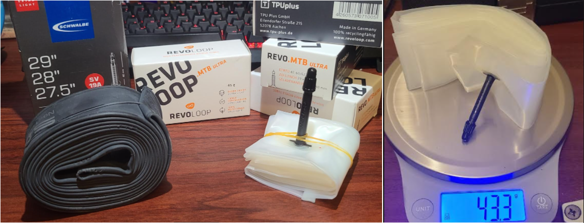

I ordered my 29s with a solid rim bed and extra layup and they came out to 498g & 501g for just the rim. They've got some videos of them slamming the rims in a big... bike rim guillotine? to show the strength. LightBicycle is another carbon rim builder that has a little bit flashier wastern-oriented marketing & support, but plenty of positive ride reports from customers & the bike rim torture dungeon video we good enough for me. built up (before tires) front wheel is 960.1g & rear is 1180g - steel freehub will never gouge :)
I have tubed Tannus armor in the 29's so I opted for the lightes tubes I could find - there's several TPU tube options and I'm pretty sure they feel like the same material used for latex-free condoms. Super light and pretty compact too so they don't take up as much space in an emergency tool kit. They take a specific kind of patch though and I think the way it works is that it's better to replace & then repair the damaged one at home. Idk I got the armor so I don't have to worry about it, but for the fatties it's Stan's Race Sealant and some Huck Norris inserts Pole Bikes sent for free with the tires I got from them
Beautiful, balanced setup. Ultralight tube 100% offsets the Tannus 150gms. Unaware, I'd decided 'no' about adding 300gms.
