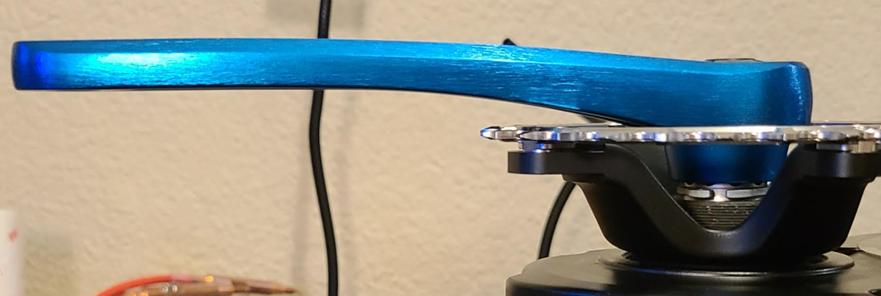

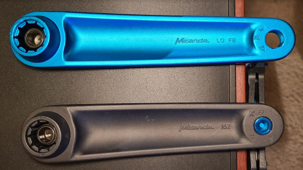

Interesting. I'd only seen two type cranks offered - carbon and alloy. WW's photos of the UC's cranks clearance (https://wattwagons.com/products/ultimate_commuter_pro#build_product_direct) showing plenty of room for offset confused me.
(BB has great developing commentary/ setting torque input/ output response levels. He 'knows things'.

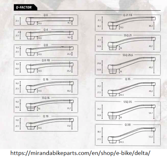

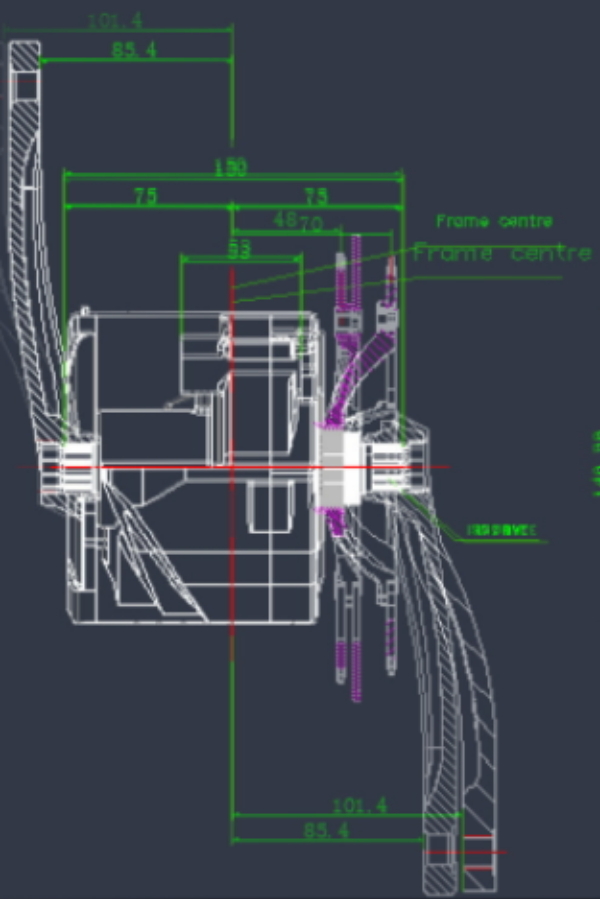

I don't know the details of that frame, but people quite commonly use 190/197 interchangeably and/or incorrectly. In most contexts it doesn't matter because it denotes the same size frame, tire clearance, chainline, etc. Jump down to 170/177 (the older, smaller "fatbike standard") and you are talking a different sized frame, likely tire clearance, required chainline, etc. That's why in charts like this they are lumped together:
They may offer something I don't know about, but I've only seen the Ultra offered with two setups from Bafang--the standard or MTB width, and the "fat" width. In this case it's pretty clear Deacon got the MTB width but needed the Fat to match his hub more closely.
As Deacon says, the Q comes from the cranks. However, I'm pretty sure if you tried to install a Fat spider (Christini or Bafang) with the regular cranks, you'd get interference so you need to use the Fat cranks. Most frames for a 190/197 hub would also interfere with the regular cranks, but that doesn't appear to be the case with Deacon's bike.
Hopefully when people dig into the programming of the X1 they'll figure out how to improve that. With my stock Bafang I have it down to less than 1/4 turn. Of course that's still a lot if you're in a really wrong gear, but in an appropriate gear it works pretty well.

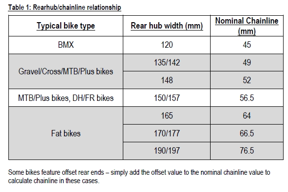

Bafang's Ultra spiders were designed ante 2017 - when the product debuted in Taipei.
I've asked Christini if their (designed post 2019 for xxl fatbike width tires) fat spider's have the same offset as Bafang's.
They will know.
The problems arising accommodating xxl wide tires while keeping the cassette inset at a 177mm's position would include tires rubbing
If the cassettes position "remained the same", offsetting at the ring would = high (small) gears working great, but low (big) gears being out of whack - the opposite Deacon's malady.
9sp cassettes? Sure. Spacers? Well, yeah. It's chain-line should centered where a 12sp's would be - in relation to the correct size axle length., so same story as above.
I have a 197mm 5.5" rear wheelset and the offset's HUGE compared to my 2.75" wheelset.
Being only half as much as it appears, it's still clear to me the wider frame would have a significant outward bias offset, given the fixed midpoint center of the motor/ frame, or the whole frame would have to be offset 50% of the difference in width of the added offset required.
Interchangeable?
"I am running this set up, Chosen 190x12 thru axle hub, 197mm spaced dropouts. I have 2x3.5mm spacers that make it the right width." (https://www.mtbr.com/threads/190mm-rear-hub-for-a-197mm-frame.935001/).
No doubt - with spacers. Inherently different, but adaptable.

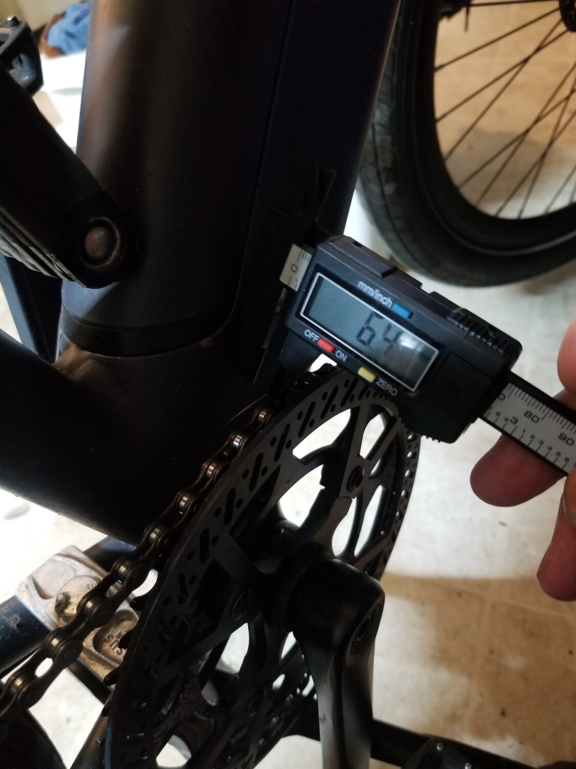

RE: "I'm pretty sure if you tried to install a Fat spider (Christini or Bafang) with the regular cranks, you'd get interference so you need to use the Fat cranks. Most frames for a 190/197 hub would also interfere with the regular cranks..." I think not.
The photo of a UC 177mm Commuter at WW Commuter_Pro_Set_44_Cranks-Clear-by-a-mile.jpg shows ample room for additional offset spiders, and a much wider frame - using the same cranks - the Q factor remains unchanged. I hadn't seen WW offer different offset crank options, only Alloy or CF versions of the same geometry.
Certainly not saying the Maestros at WW can't/ don't/ won't. Just not in my database of 'did, we have or do'.

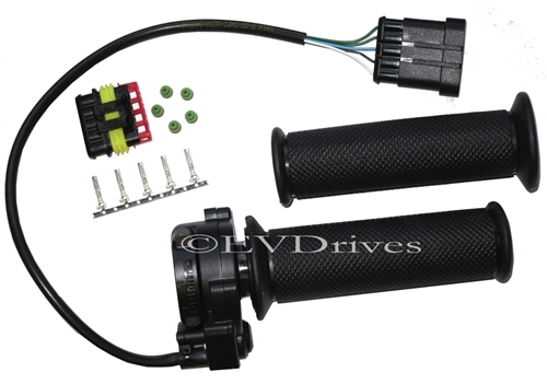

I like these because the grips can be changed https://evdrives.com/domino-twist-grip-throttle-0-5k-ohm/
@Deacon Blues I know KWSeattle replaced the hall sensor in their throttle with SS49E and got better response out of that. Not bad for a sub-$4 part. I'm kind of disappointed in the response of the motor if it takes half a revolution at the crank to get going... I thought part of the benefit of the X1 was being much more responsive and snappier - does it have the same lag to cut power when you stop pedaling? I really hope there's a way to remedy this via the programming harness because that kind of kills the point of it all for me, ugh. I too found out the hard way that I chose a bike too large for me many years ago even though I bought based upon manafucturer's size rating. I'll always err on the side of caution when it comes to sizing stuff like that in the future. Cool that it's not that hard to pedal with no assist though, to get the most out of your bike you're going to have to find some kids to race - definitely not going to really punch it much on the senior group rides unless you start an ebike gang with them!

Yes, if you want to run 5" tires you want a 190/197 hub. To be clear, I was saying the cassette stays in the same place when converting from 190 to 197, or from 170 to 177. Obviously 197 places the cassette 10mm farther out than 177 as shown in the previous chart.
The photo of a UC 177mm Commuter at WW View attachment 108840 shows ample room for additional offset spiders, and a much wider frame - using the same cranks - the Q factor remains unchanged. I hadn't seen WW offer different offset crank options, only Alloy or CF versions of the same geometry.
Uhm, no. I'm not going to be sure enough to tell people parts will fit based upon a picture of....different parts. The fat spiders have a lot more offset and the fat cranks have a lot of clearance built into them. If you look closely at Bafang's drawings it shows a likely interference:
When you include the Christini fat spider in that, its smaller bolt circle makes interference even more likely. I'm not saying there's zero chance the combo would fit, but I'm certainly not going to tell people it will.
And no, the standard cranks with 100% certainty will not fit my frame. They obviously will fit Deacon's, but that frame won't clear a 5" tire. I really doubt you find a frame that can clear a tire of that size that doesn't need the fat cranks. That's what they're for.

So I tried digging through Miranda's new site but they don't have their charts on every crank arm page like they used to - but I did find the chart. Note the 'FB' versions are for fatbikes.
I ordered 2 pair - a 152mm Q:16 & a 170mm Q:8 FB and they both clear the Christini + Wolftooth 30T on the outer position. I believe the Bafang fat cranks are closest to 55Q: 16 but I could be wrong - from the diagram in Jon's post it looks like the standard Bafang cranks are closest to the Q:8. Unfortunately in my case the snazzy blue cranks I got don't clear my chainstay - the black ones do so by around 2mm so I'm seriously considering ordering another set... ugh. I wish these both would have cleared fine as I'm just trying to go as narrow as safely possible while as short as I can comfortably go, ground clearance and being easier to keep a higher cadence and all that. No idea what size I'd get if a test ride proves to show the black cranks will wind upknocking into the stays under trail riding conditions.

Okay. TY. Comparing our stock WattWagon's cranks, they're much wider than Bafang's.
The measurement of concern is the distance from adapter's base to inside of the chainring. That's my relevant blueprint.
I see Bafang's 48mm and (fat) 70mm - from frame center - a 22mm additional offset.
Since I have a near identical machine ordered, I'm relying on an owner I trust for accurate information. He's teaching me.
Anywho, My question: Is the Bafang fat-spider the same offset as the fat-Christini?
My reason: I'll be running 4.5 sand tires - part time/ and addressing cog jumping in top gears running my 3"ers in the City.
What I know: Christini's dimensions 👋. 18mm.
What's missing: Bafang's spider's dimensions 🙊 (doubting it's 22mm, but could happen).
You've been helpful, so if you know bless your soul and spit it out. It's elusive information.
