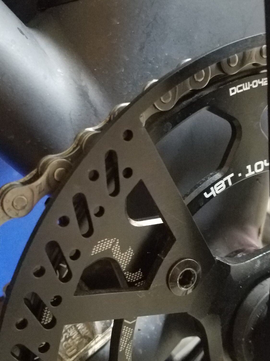

I've got a 48t Wolf Tooth chain ring coming. I'm hoping that with the 48 I can get the cadence/cruising speed I want and still keep the chain on the 2nd or 3rd (13t, 15t) cassette cog.
I was a bit worried that the huge 'Q' factor would feel strange and maybe bother my arthritic knees, but after a couple of kms I forgot about how wide apart the pedals were, and the 40km ride didn't bother my knees at all.
I had looked at Wolf Tooth, but found Dekas at 1/4 the price.
I like the Made in USA thing but another problem was they do not make a 48t 110BCD Bash Guard.
Finding all the 48t BG's I could locate were not-so-hot variations of the same cheap item, I located a custom American company and at that they only had templates to produce a 46t in billet for me. I think they since went out of business.
This is pretty awesome (but not in 110BCD - sigh) https://bikerumor.com/2-piece-titanium-bash-guard-41-grams-of-custom-fabrication-from-texas/
Worthy of your machine when you 'upgrade'.

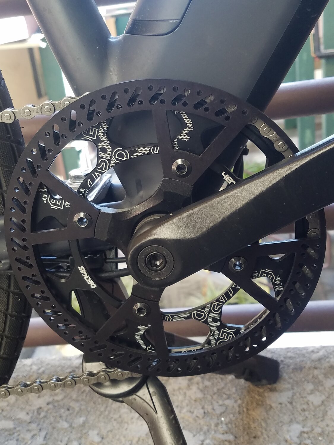

I'm not concerned about the lack of a bash guard, because my UC Pro will never see anything more adventurous than a gravel pathway.
You're right about the price of the Wolf Tooth ring......it's expensive!
It keeps my pants off the chain - and was even more $$$ than the WolfTooth ring was or is.
It 'Guards' me from bashing that toothed grinder. lol. I'm a klutz.
Three pairs of my Carhartts with chain marks, now no more $50 pants being ruined.
That's laser cut billet stock. I can't find the company. They went bye, bye. It's an heirloom product and will undoubtedly end up on my new machine.
My simpleminded thoughts ... what happens when alloy interfaces hardened steel? Alloy will take most significant wear and die the fastest - a great canary in the coalmine.
A Ring's more leveraged interface (more teeth gripping the chain) in this case won't help.
When the power comes on, the (harder) chain is still trying to tear the teeth off the ring (it want's to go slower = to the mass difference of the wheels drag) and the (softer) alloy ring is trying to rip the links off the chain to get the giddyap on (wanting to go faster = shaft N.M. output equilibrium factor. Ie: 'Somethin's gotta spin' effect). Continuous application of power is different. Intermittent is 'bang, bang, bang' force.
On the other hand, a hard steel Ring (with all those teeth employed at any given time) would eat the cassette/ chain first.
I concluded > buy cheaper ring gears.
Although I purchased from an MTB Cottage Shop, I doubt my guard qualifies as a real "Bash" Guard. Those are much heavier duty, aimed at preventing high-centered impact from raised obstacles. I agree, no plans here for off-road.
