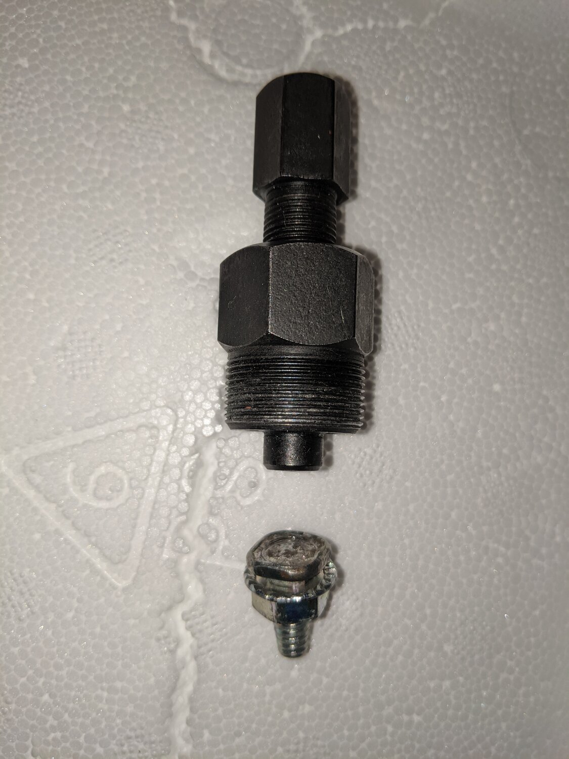

I have a cheap puller (from the Luna tool kit) and improvised with a bolt that gave it the requisite leverage. Here's a pic. Basically insert the bolt into the hollow part of the crank.

the tool for the spider is a 44mm 16-notch, Park Tool BBT-19.2 is the PT part, any of the links here work. I think a couple of them actually pulled from comments from TomD in other threads, go figure lol. It's super weird about the cranks needing a puller. I could have sworn WW cranks were made for them by Miranda and my Miranda cranks have self-extracting bolts that are fixed into the crank arm so as you unthread them the arm is pushed off the crank. When you re-install them put a little assembly grease on the outside of the axle so the arm is less likely to seize up on there. Maxima waterproof (blue jar) is the same as the Chris King blue at 1/5th the price.
tool for the spider lock ring
cheap amazon one, another, nicer cheap one - I bought this one, official PT one and not that expensive, fancy Wolftooth one if you want US-made
I bought a crank puller, but I couldn't find the correct bottom bracket tool, so I ended up taking the bike to a local bike shop that I deal with.
I haven't had a chance to ride the bike yet (raining again), but the mechanic took the bike for a short ride and said that he couldn't get the chain to skip in the smallest cog.
Both the mechanic and shop owner were really impressed with the bike's overall quality.
loamoaf, thanks for the links for the bottom bracket tool. I ended up ordering the Park Tool.
