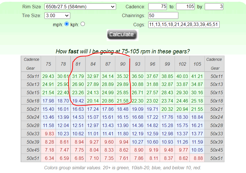

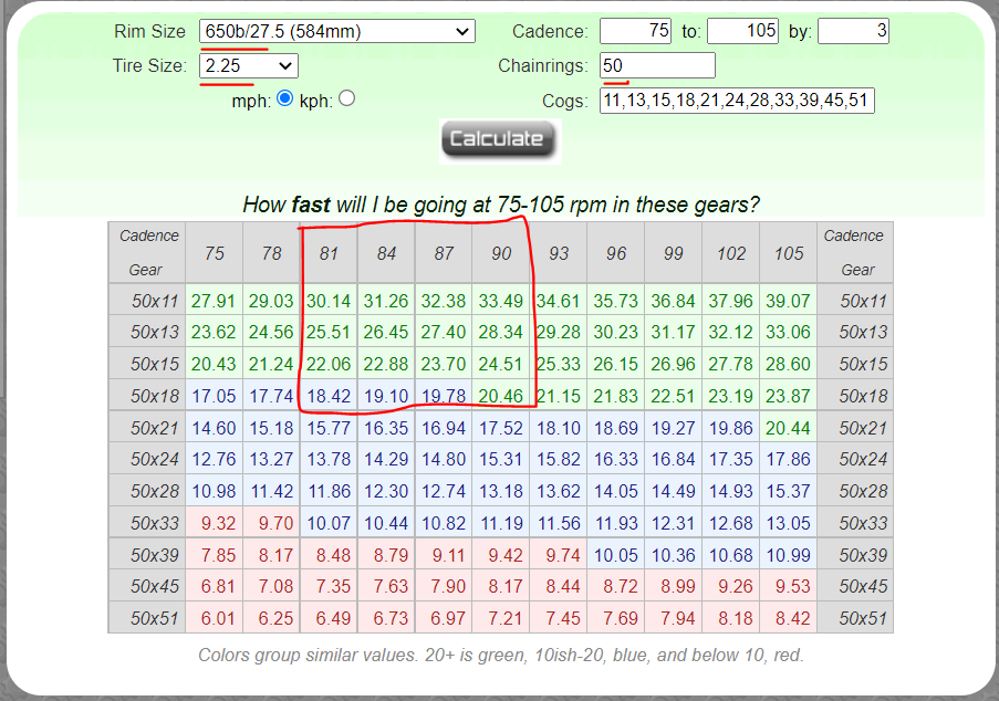

I want to be able to maintain a constant speed in the 23-25mph range, without pedalling like a madman.
I could go with a larger front ring, but Pushkar doesn't recommend going any larger than 50t.
I believe the concern with the front chainring size is to make sure it does not start touching the swing arm.
Depending on the Chain line position (how far from the motor), you may be able to go higher like 55 may be even more, but you would want to try and make sure that it clears the swing arm properly.
If it does, I can't think of a reason not to, if the new ratio works for you
50T will give you nice cruising speed! My 50T ring clears my swing arm by just a teeny amount mounted outboard of the spider without any spacers, a little too close for comfort for me. FWIW I was cruising comfortably around 24-26mph on 42x11, maybe asking 150-180W from the motor with me pedaling. Using a 40T with 26x2.4 the red box tops out just over 26mph. The Deckas chainrings are cheap enough to experiment with, stock Bafang spider is 130mm BCD. I think they go up to 52T
Loamoaf, thanks for the graphs.
I have a Garmin cadence sensor that I can put on my crank arm and monitor with a Garmin app on my iphone.
Next time I go for a ride I'll see what cruising speed an 80 to 90 cadence gives me.

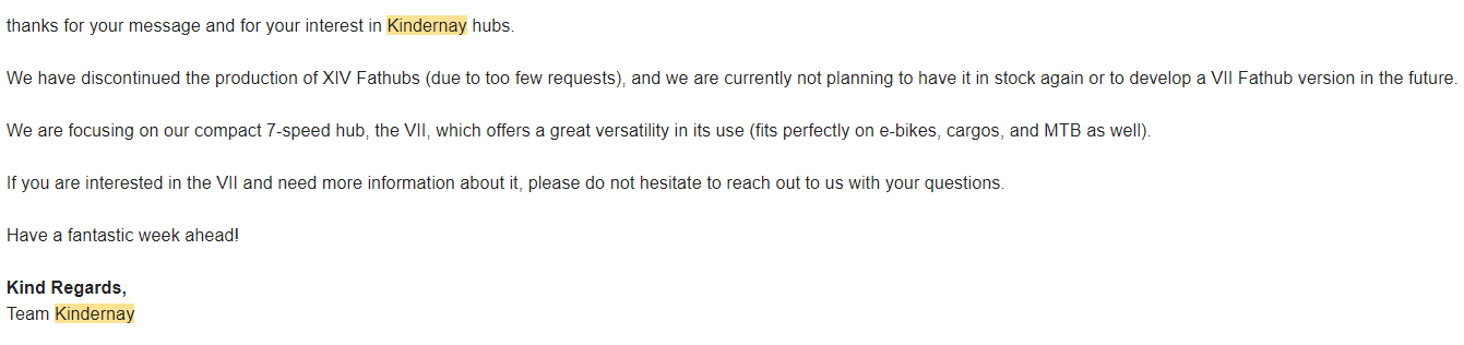

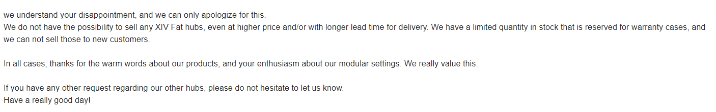

Big bummer because I was really looking forward to an IGH that I could switch from 29+ to 26" fat
Yup. Only need the cage and the right ancillary parts to accommodate it.
Uh, WW doesn't make a +29er Fat tire, do they? "+" tires come in two sizes: 27.5 x 3" and 29 x 3". The 29" being 1.5" taller of the two.
Bye Bye fender. Highly likely not even be possible with that fork. Oh well, buy a 29" fork, huh?
Do they even make any Ti 29er?

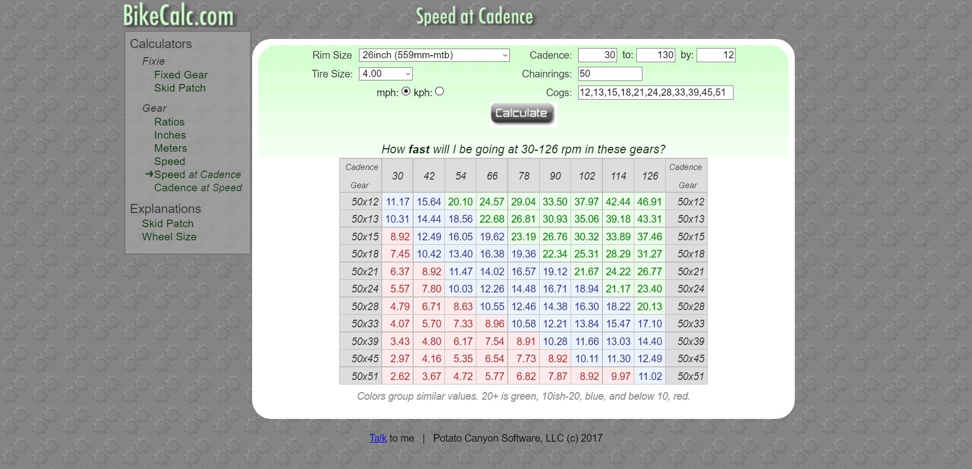

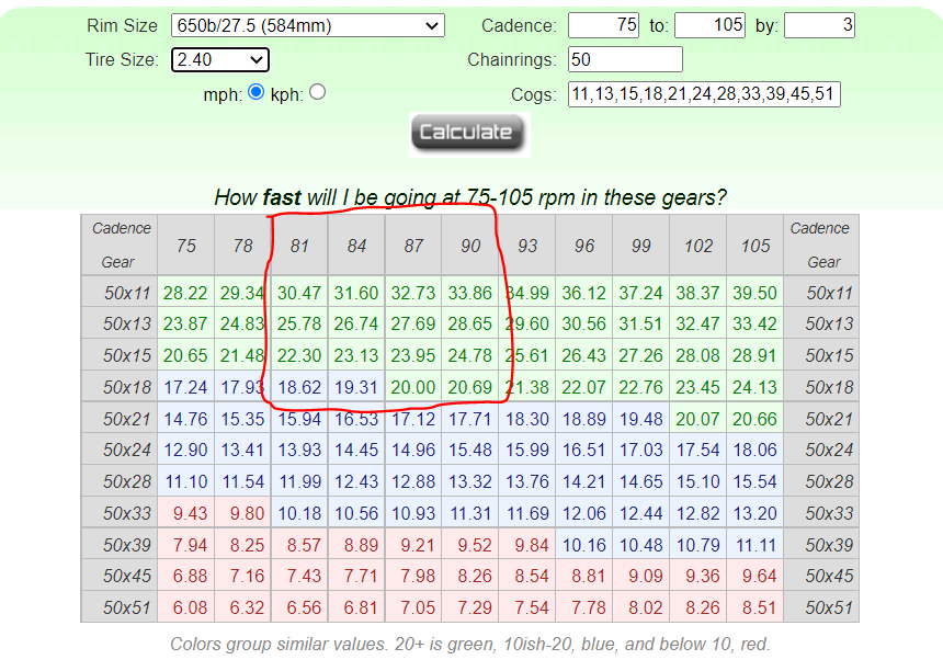

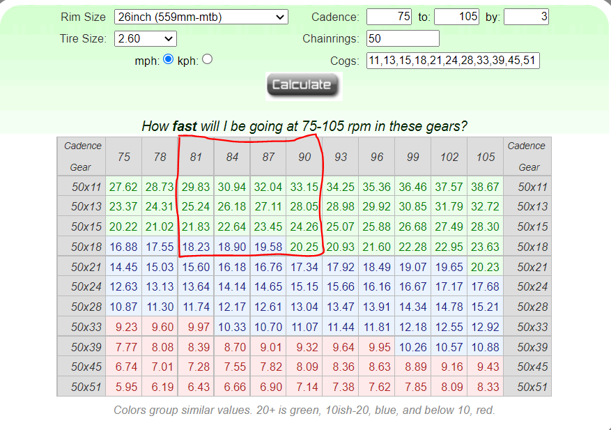

A couple questions.
Upper right corner. Isn't that how many speeds? "3", not "12"?
Are your tires 2.25"?

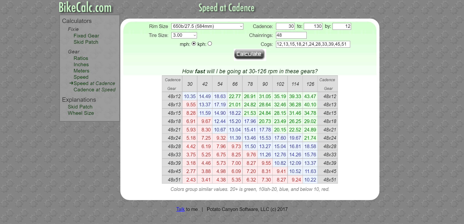

I get :
A 48t Ring also seems workable.
With the 26 x 4 tires and 50t I get the following.

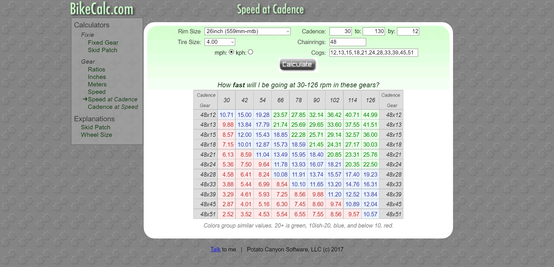

With 48t

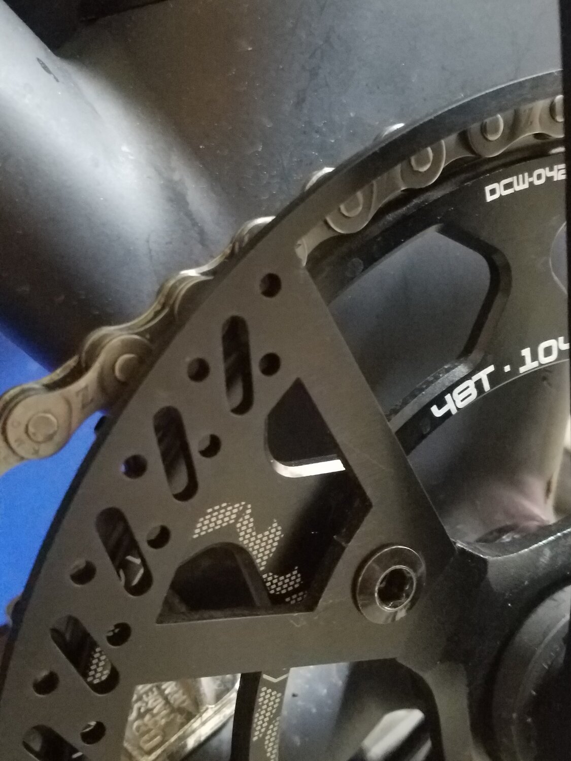

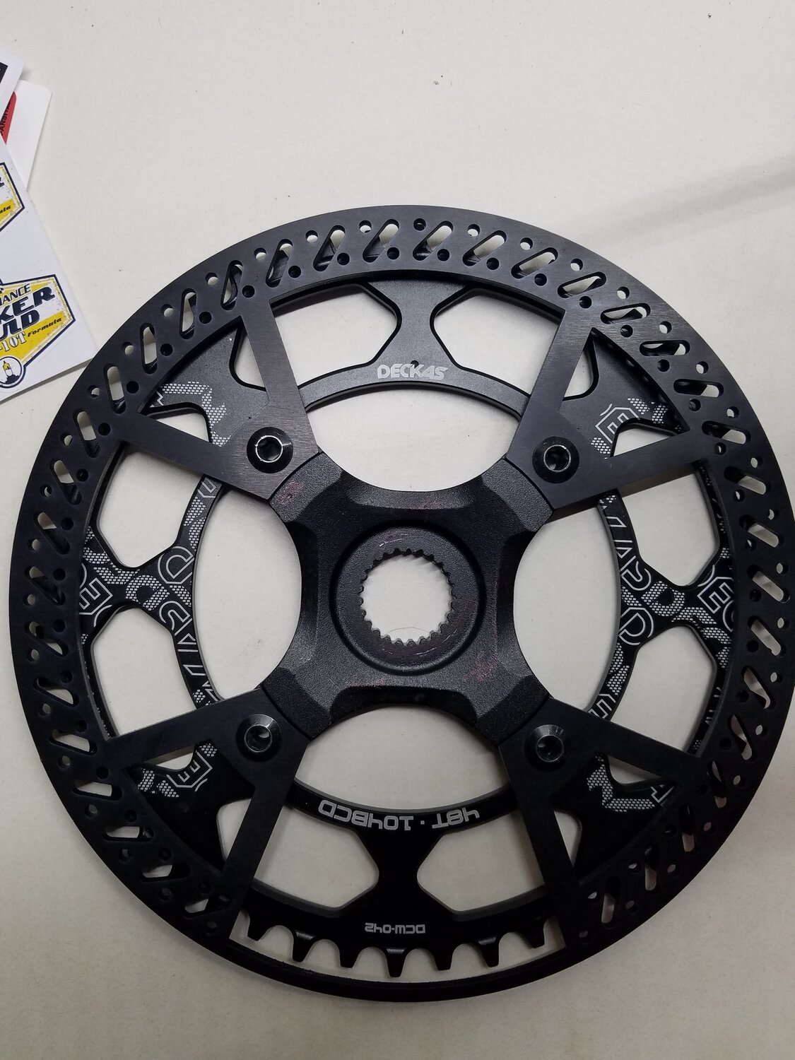

I'm currently running a 48t - max unless I offset about 4mm more.
I had to use a 46t guard. Fits perfect.
Pretty dang close when installed ...
I can't see a 50t reducing ground clearance that much and it seems a pretty reasonable speed curve.
I'm sure I'll try a 46t, 48t and a 50t. On alibaba, the cost for all Dekas 3 is under $50. They also have a 52t for $17.00.

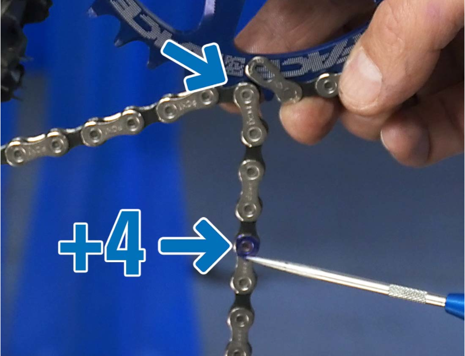

Here's a chain length question:
If I replaced the cassette that came with the bike (11-50) with an 11-42 and I replaced the 44t front chain ring with a 48t or 50t, would I need to change the length of the chain?
My package from WW should be arriving today, so hopefully I'll be able to install the new, smaller cassette and the fat spider.
I also plan on ordering some chain rings (48t and 50t).

The 3 in the upper right hands corner of the bikecalc tool in the increments in cadence, the number of speeds is determined by the amount of numbers separated by commas in the 'cogs' field, you can do the same with chainrings if you want to chart out everything you're considering.

@Deacon Blues if the chain was properly sized with the original setup on the bike then that combo may work out without needing to change the chain length. According to Park Tool with a 1x, you wrap the chain over the largest rear cog and the front chainring without snaking through the derailleur pulleys, find the tightest you can go on the chain while connecting link, and then go out 4 rivets from there

What's your take on why the factory discontinued?

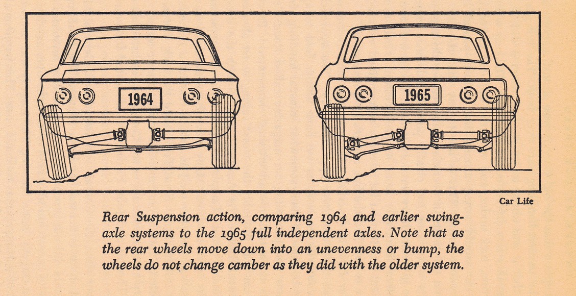

Below is the reason why.
All of them up to 1965 are deathtraps. The car’s rear suspension could tuck under on a turn, resulting in a rollover. The car also required precise tire pressures to reduce oversteer, with 15 psi in front and 26 psi in rear, which Nader said put too much of a burden on everyday drivers and in my experience can cause a tire to roll under and blow out in a turn. I've had it happen. When it does, you'll be lucky if you don't roll the car and
Many Corvair owners protested and said it was the drivers, not the car, while GM muddied the waters and eliminated the swing arm set up.
GM said "See, you just have to drive correctly". Most of them were comparing their post 1965 cars though, and those were the cars GM was sending in to test by NHTSA, so it was "What Rollover? I don't see any rollovers?".
History rhymes, not repeats.
