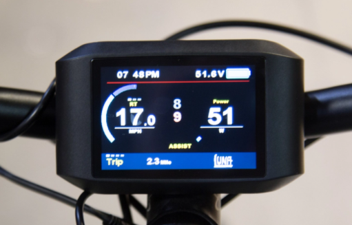

I have a display and battery charger questions:
1. There's no number or name on the display, so I don't know what model it is. It sits in the center of the handlebar. I can't get into the menu. Pushkar said to press the 'on' button and then quickly press it twice more. It worked the first time I tried it, but I can't get to work again. It just goes straight to the regular display.
2. I have the WW charger that is adjustable. I set it for 90%, but it only charges the battery (shown on the display) to 78%. Can anyone tell me why that is?
Also, another dial shows 2,4,6,8,10A. What should I have it set to? Right now it's set to 10A.
The display is DPC18. Double press the "i" button to enter the menu. Allow me to link to a competitor for the user manual. 😂
I found the DPC18 and the 500C battery percentages conservative compared to the charts found online. Kind of like how empty on a gas gauge isn't really empty.
I always charge at 10A. That is the maximum for five 35E cells in parallel according to the Samsung datasheet. You can charge at 4A for maximum life cycles.
@Deacon Blues if your display looks like this it's the 750C here's a thread including link to manual for it

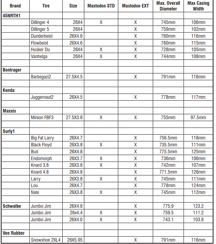

I sped read this and missed that. You confirmed the bafang fat will fit a 197mm? I keep seeing it's for a 'boost' width.
Yes--the FAT, not the Boost. However, for the record I need to revise that statement slightly. While test fitting some really fat tires and spending some more time eyeballing lately, I'd say it's not perfectly in the center--more like 1.5-2mm inboard of center of a 12 speed cassette. This matches what you'd expect based upon the Bafang drawings posted earlier. In any case, especially when compared with the chainlines posted in this thread and others, even if not optimum it's certainly pretty darn close and has been close enough to work very well as I've never had a chain skip in the smaller cogs with 1500 peak watts. Of course I don't make a habit of hitting full power in the small cogs at low speeds (shouldn't do that anyway). And interestingly, in that BikeRumor! article loamoaf posted they said 70-72mm works the best and so the Bafang standard of 70mm should give one confidence you're starting in the right ballpark. But it does make me feel a bit better as I won't need to feel guilty spacing the chainring out a bit for more tire clearance.
Looks like I may need spacers to clear 197mm -
I'm interested to see what you'll need to clear those 2XL's. Temporarily mounting the Johnny 5's on 80mm rims (with tubes) I get no chain rubbing without any spacers. However, it is close and I suspect with wider wheels and after some tire stretch, I'll need some spacers.
My next concern is should I go 9sp?
The Prime 9 certainly does solve a bunch of these issues, as the biggest cog is spaced outboard 6mm relative to a 12 speed. This makes it possible for a much better chainline at both ends of the cassette. I just wish the reviews of their derailleurs gave me more of a warm fuzzy. I get the impression they'd be a downgrade from the Sram stuff I'm used to and didn't feel like experimenting at this time. Maybe I will at some point in the future....
