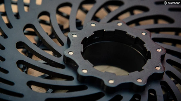

If I remember correctly, the EX1 cassette requires a 1.85mm spacer on the freehub which would imply the biggest cog is spaced outward somewhere around where my 2nd cog is. That alone.....

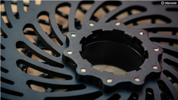

For the record, I was only partially correct. The EX1 also has a spacer built into the end of the cassette:
From here: https://www.bikeradar.com/news/sram...5&type=gallery&gallery=1&embedded_slideshow=1
To reduce cross-chaining, the position of the biggest cog is 7mm inwards compared with an 11-speed drivetrain, Braedt said.
That's a pretty significant difference, putting it on par (or even a bit better) than the Prime 9 system for having a good chainline in all gears. It should make chain-rub a non-issue for even the fattest tires when properly set up so it has a lot going for it particularly for fat bikes.

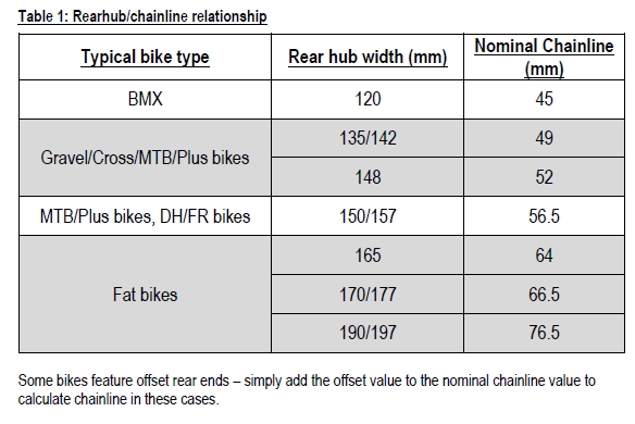

Yes, the Cross Tour frames are wider. Two widths. 190mm and 197mm. You're indicating a 197mm.
I believe I ordered a 190mm CT - but I'm cool w 197mm. I'll be running sand tires a bit, not in dunes, on stretches of West Coast beaches.
The rest is commute using 3" road tires.
The right cassette(s) for the low end fattie work/ commute daily might be a bigger challenge that I thought.
148mm being UC's normal width - I saw WW advertised in "177mm" too (could have been a kit).
190mm is considered "fat bike" by bafang for their idea of a fat bike offset.
The christini is the 'fat-back hog' - appearing on 5"+ tires - a full 7mm wider, more than 1/4" additional offset.
This christini (photo) is runs fat meats and a huge offset. 197mm?
That's their 197mm fat bike xxl (running 26 x 5.5" tires).

My take is unchanged. A 48t ring gear w/ a highest gear cassette of 12t (for 6 teeth on the chain, not 5 when changing gears).
I doubt you can attain the correct offset for a 197mm using a bafang fat bike spider if there is a 7mm bias to the lower gears.
Maybe I don't get it. You ordered an Ultra powered commuter and have a Q factor concern.
If the motor's width, the shaft length, the cranks offsets and pedals placement are fixed values, how would an IGH provide a different Q factor than a chain ?

While the bafang fat-bike spider fits 190mm offsets on it's outer side, the christini's inside mount is for 190mm and the outside is 7mm further out. Being two gears thinner, spacers make sense.
That's not the case. There is no difference in cassette location between 190 (quick release skewer) hubs and 197 (generally through axle hubs). Many hubs can be converted from one configuration to the other--the cassette doesn't move.

I'm thinking 🤔 Deacon has 197mm skewers. I ordered 190mm axles. I've been under the impression the cassette did move further outboard with wider widths - why bafang made a wide offset type spider, as well as to eliminate rubbing. The specs will be interesting once I have both spiders in my hand.
Not knowing Q factor from Agent 99's armorer, I looked. 'Q Factor, also known stance width or tread, is the distance between the bike’s crank arms, which is essentially the distance between your feet as you pedal'.
So, a Hydra, given the same motor and cranks on the same length shafts, and a 197mm Cross Tour have the same Q factor
I'm a go out on a limb here -- from my experience the offset of the ring gear has nothing to do with a Q factor -unless the ring is too close to your pants - not John Wayne, more that Slim Pickins limp.

'from my experience the offset of the ring gear has nothing to do with a Q factor -unless the ring is too close to your pants"
It's not the fat spider/ring itself that has increased the 'Q' factor on my bike-it's the fat bike crank arms that Pushkar sent me to give me more chain clearance.
I don't know the details of that frame, but people quite commonly use 190/197 interchangeably and/or incorrectly. In most contexts it doesn't matter because it denotes the same size frame, tire clearance, chainline, etc. Jump down to 170/177 (the older, smaller "fatbike standard") and you are talking a different sized frame, likely tire clearance, required chainline, etc. That's why in charts like this they are lumped together:
They may offer something I don't know about, but I've only seen the Ultra offered with two setups from Bafang--the standard or MTB width, and the "fat" width. In this case it's pretty clear Deacon got the MTB width but needed the Fat to match his hub more closely.
As Deacon says, the Q comes from the cranks. However, I'm pretty sure if you tried to install a Fat spider (Christini or Bafang) with the regular cranks, you'd get interference so you need to use the Fat cranks. Most frames for a 190/197 hub would also interfere with the regular cranks, but that doesn't appear to be the case with Deacon's bike.
