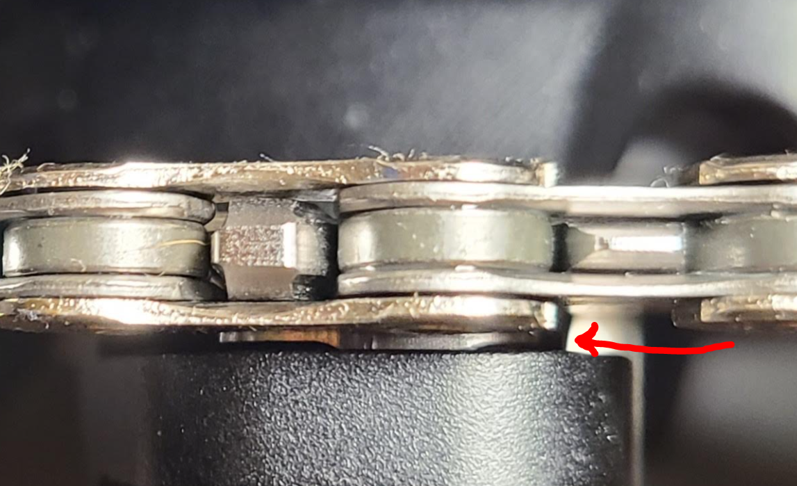

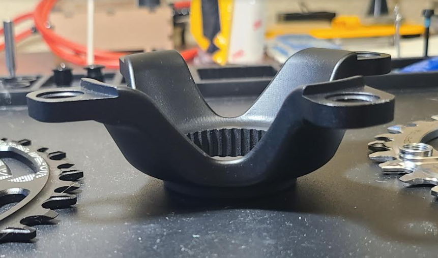

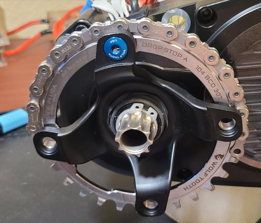

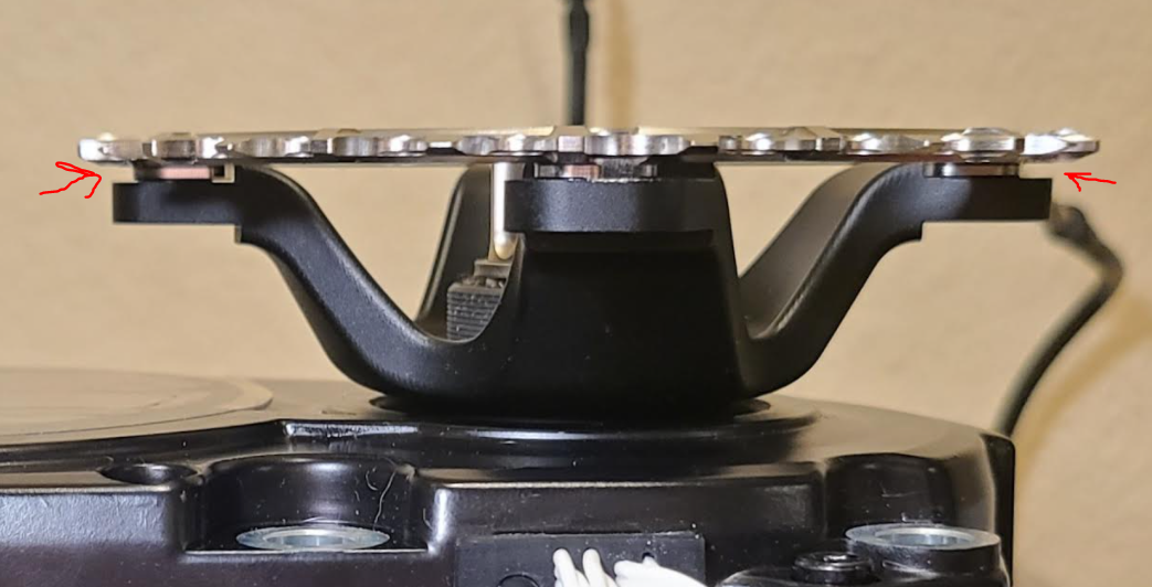

Looks like the Christini is the way to go. Chainring inside the spider for 177mm, outside for 197mm. The way the Wolftooth mounts on my spider it's looking like I may have to grab little spacers to get it on the outside of the spider with clearance. It has offsets built into the chainring for mounting inside, or placing a guard on the outside, but it needs spacers on the other side - I wish it was symmetrical and had offsets on both, oh well. Can't just flip it because the dropstop tooth profile is direction. The Christini fat spider + 30T stainless steel ring weigh 186g. Gap with the built-in standoffs facing measured at 1.75mm, SRAM EX-1chain (10-spd width) clears it fine, so an 11-spd should as well. You need the long Wolftooth bolts to engage enough threads on the chainring, any longer chainring bolts with M8 x 0.75P threads.

(Belated) SUPER POST Award! Only photo shot missing is 'mounted on the outside, side view'.
Spacers (of various sizes) can be made to order (just need a cad cam or suitable digital plans), but to be less than $5 each (USA Made), probably need to order 1000.
