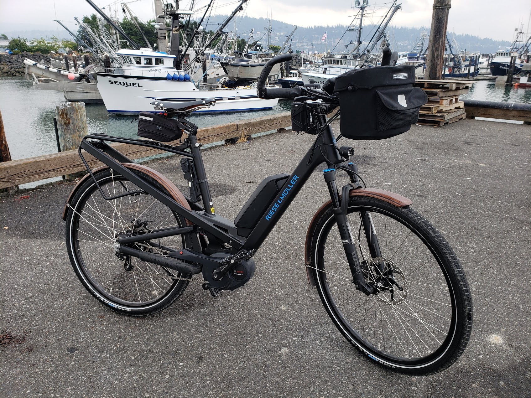

I am 67 and have a step thru bike, Riese & Muller Homage, that I often as not swing my leg over when mounting. This bike has a higher than normal, suspended cargo rack, so when there is a trunk bag mounted, it is too high to safely swing my leg over. I step on on the left pedal and thread my right foot through the frame onto the right pedal. The alternative is to step through before mounting, probably the safest method. I also figure that the time may come when it won't be so easy. If the step through is properly designed and built, it need not compromise stability and stiffness in the turns.

Alaskan I had the opportunity to test the new Homage dual battery Rohloff and found the bike has lost it’s ability to be a step-thru. The second battery is too close to the seat tube.
