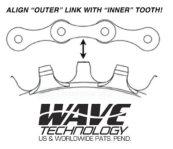

Majority of your problem is likely Torque of the chainring . It has to be exact on all of those tiny bolts . I've had teh same thing 3 times . Your manual should give you the specs for torque and a pattern as well to tighten . Doing it by hand and guessing won't work
You have to align outer chain link with the inner tooth. In your video, the outer chain link is on the outer tooth.
This is incorrect.
See the attached images.
OUTER teeth of the chainring must mesh with OUTER links (plates) on the chain.
Try it.
If you put an outer link on the inner tooth it jumps to the correct one, no matter how you try to do it.

Guru: As TS25 explained to me, the whole misconception is most of people think the Narrow-Wide or Wave chainrings should be looked at from the side, while the correct look to understand the concept is from the top. As my eyes are not as good as they used to be -- I just follow the diagram as you have done it.
My misconception was the photo:
which is wrong.
My physical viewing and chain placement, testing negated the photo above, which is of concern.
I think the confusion is around the definition of outer and inner for the chainring. When the chainring is fitted on the bike and you view the chainring side on from the drive side then the inner side is the side closet to the seat tube. In that scenario the statement of aligning outer chain link with inner tooth is correct and the picture is correct as what the picture depicts is the outer side of the chainring. On the chainring itself the printed diagram is also correct as it is stamped on the inner side of the chainring ie the side closest to the seat tube. I think they should have made it clearer that the photo is being viewed from the drive side of the bicycle so effectively the outer side of the chainring. At least that’s my take on it. If you follow the stamped diagram on the actual chainring all will be fine.
This is incorrect.
It all depends from which side of the Praxis wave chainring you're looking at it.
You are showing the inner side of the chainring as the drawing is on that side. Now turn it around and look from the other side, which is the side you normally see when the chainring is mounted on the bike. Then it is correct to say: mount the outer chainlink on the (now) inner tooth.
But what baffles me most with your Praxis wave chainring are the abrasions on both sides of your chain teeth shown. It shouldn't be like that, and it might be due to an incorrect chain line. I have marked your abrasion in red (regrettably "normal" on that side with wave system) and yellow (unusual on that side, even with wave system) in your picture I'm attaching.
Looking at the abrasions on your wave chainring teeth I now understand why a number of Vado users complained about the Praxis chainring because it didn't last long. My narrow-wide Deckas chainring doesn't show any abrasions after 2.500 km so I think it was a good choice to have switched to it.
PS: mordase was the hedgehog beating the hare (me) :D

The drawing as shown attached to my #28 is on the inner side of the chainring, facing the bike frame. At least it was that way from the factory with my Vado, and the Vados of others who commented in this forum.
And the abrasions on your chainring aren't normal, even not for a wave chainring.
