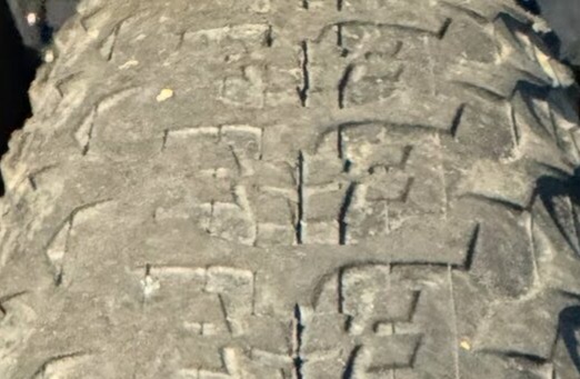

Mid-Drive - Front Tire Wear More than Rear Tire Wear?
When I've seen fast tire wear, there's a lot more weight on the faster wearing tire,
Then again, since this is only two tires, maybe one was just a crappy tire.
My 26" fat tire bike, with 26x3" Veeco Speedsrs does have its own mind when it comes to steering on pavement though, It picks its own arc on a fast turn, so maybe you got some extra sideways stress on your tores.
That looks like uneven tire wear to me?
It's worn on one side, but the middle and the other side are fine.
That doesn't make much sense.
Is your rear tire wearing evenly?
Do you have one side of your e-bike loaded down more than the other?
Do you ride in crosswinds that only blow from one side? 😂
Do you only go around corners one way? 😂
If that was a car tire, you'd need to have an alignment done.
I do notice that I ride on the left sides of my tires a bit. Partly because the weight of my e-bike isn't quite centered, and I ride on the right side of the road where the crown of the road slopes to the right.
It's possible that your wheels aren't perfectly aligned in your frame causing your ebike to lean.
