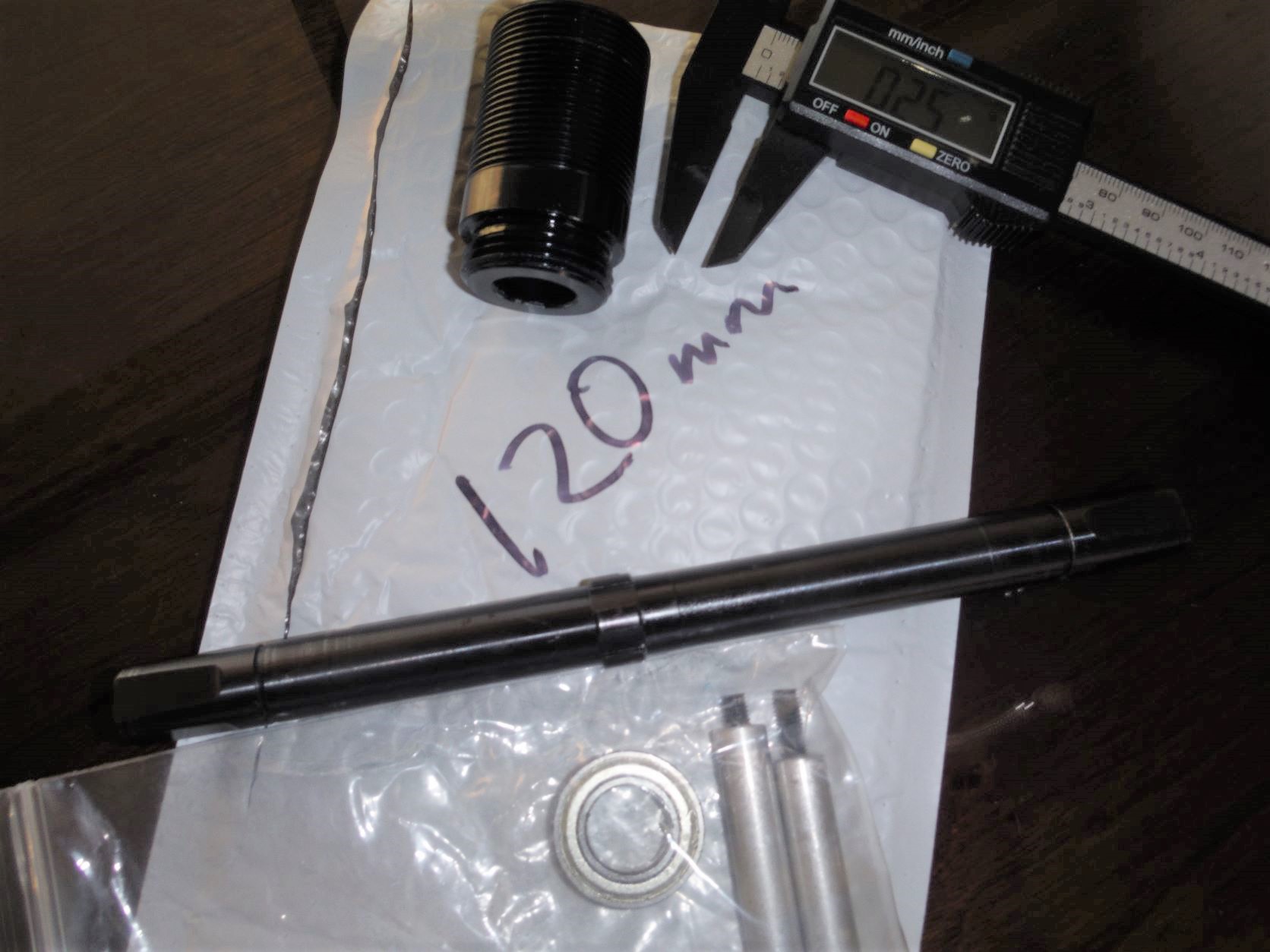

I am getting a TSDZ2 120mm fat bike extension today from Doug at California eBike. I will need to cut threads into the motor housing to attach it. Any idea what the tap is? They play dumb and won't tell me. Is it a plumbing thread? Is there anyone who has done this and knows?
I am getting a TSDZ2 120mm fat bike extension today from Doug Jeannette at California eBike.

Thanks for the info and the offer. What I will do when it arrives is photograph it and take the BB extension to a couple of farm supply places to have the thread TPI and diameter measured so I can buy the tap. Hopefully is not some obscure thread, but a standard plumbing pipe thread. Thanks again.

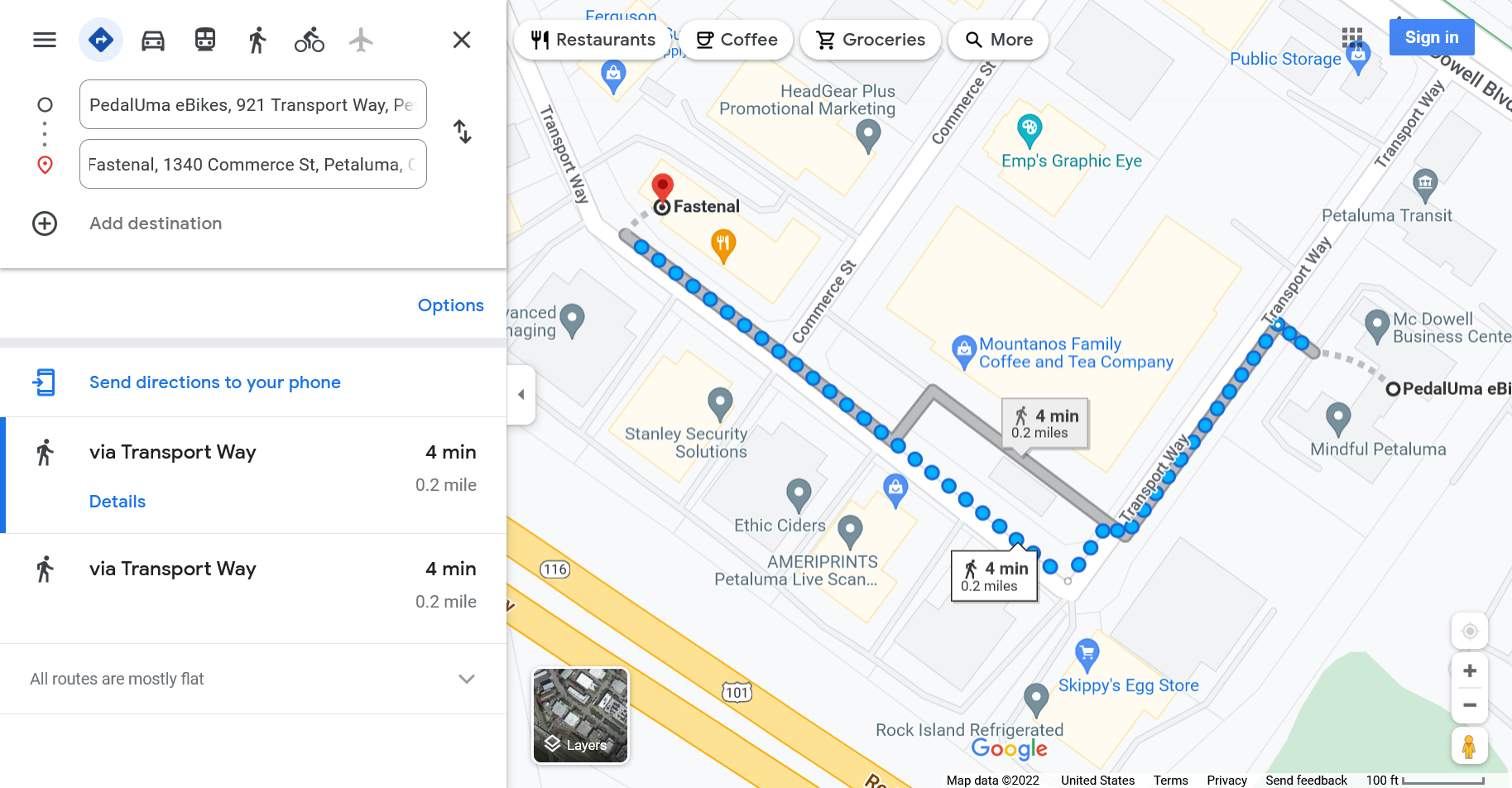

A Fastenal store near you?
Fastenal is a short block away. The other side of a parking lot. Funny you ask. ;)

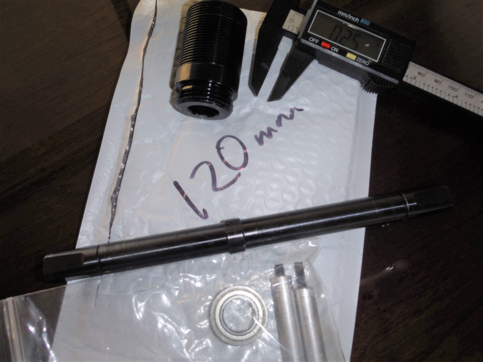

The thread is 4 threads per .25 inch, making it 16Tpi. The outer diameter is 29.8mm. Or 1.17 inches which is very close to 1&3/16
Um, you realize that is a HF caliper in your photo?
I have a HF tap and die set, used it many times without a problem, at least no problem other than caused by the user
I got that caliper on Amazon when my old one broke last year. Didn't know it was HF. I have a HF vice. Everyone has at least one vice but mine broke last week.
