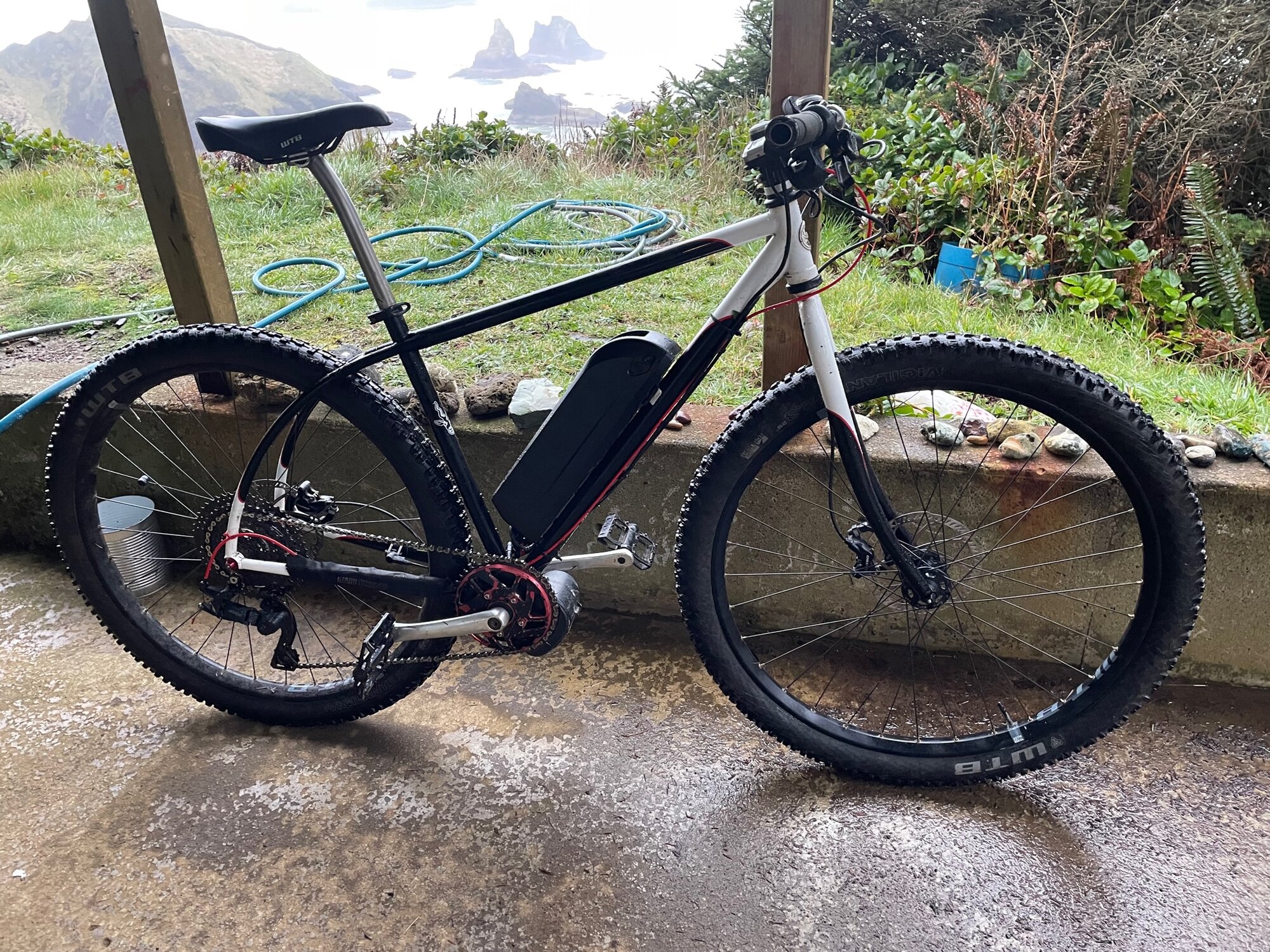

Interesting that it is not recommended for use with nylon gears. Not an issue with the M620 of course but without that knowledge I probably would have used the CH grease in a TSDZ2 if I had one apart. My son and I just put this one together from parts yesterday for him to take back to Canada and use to access fishing spots better.
I still think that bang for buck the TSDZ2 is a great DIY system. Easy to adapt and you can buy one for under a grand usd all in.
That's a nice looking bike. I keep hearing more about those other motors. Might have to check one out for the next project whenever that is. And that is an incredible view.

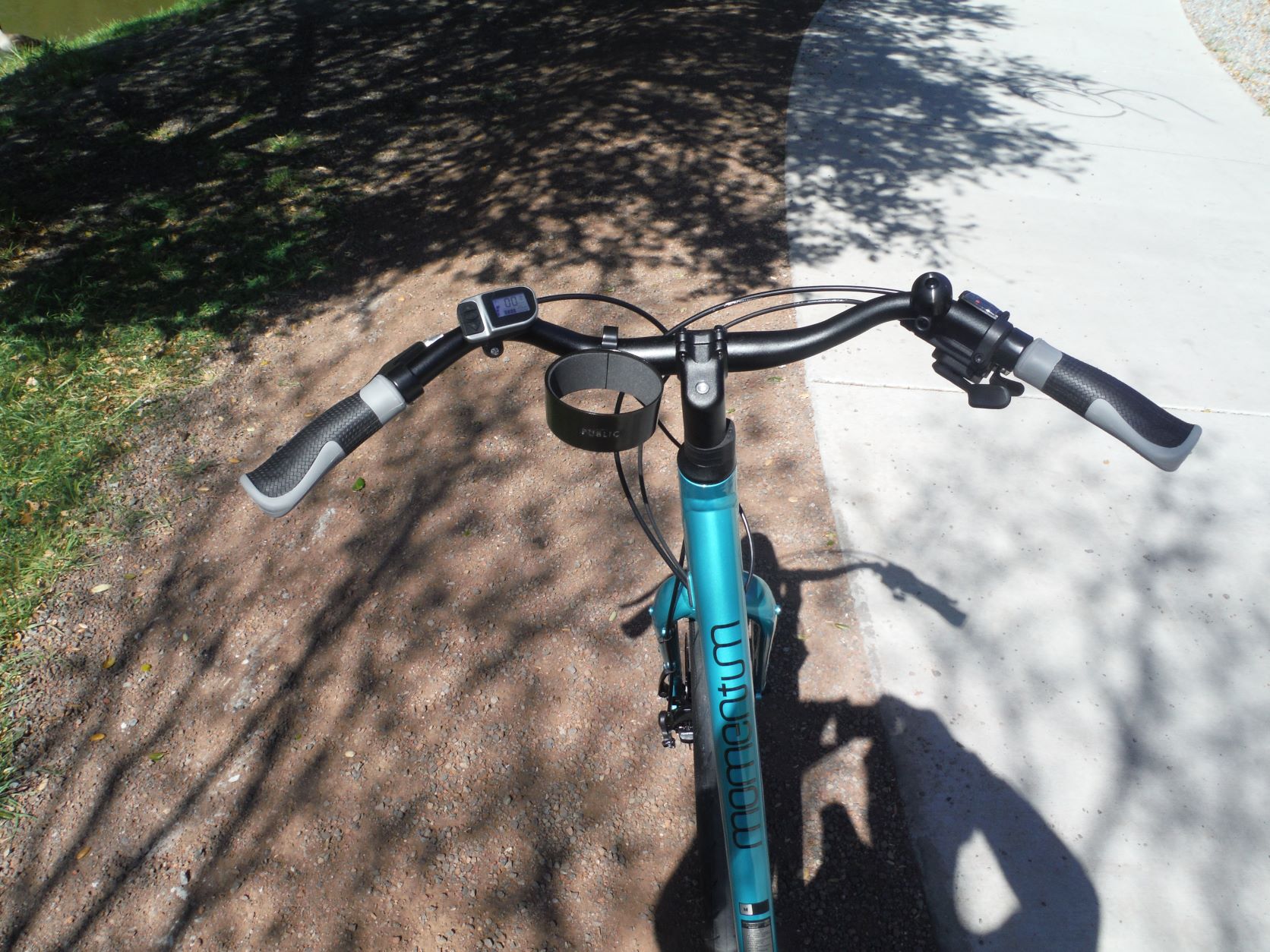

Another one, Charcoal Grey Metallic came in today. A third is a few weeks out. Teal. Galls love this bike. I had the seat up on this test ride. I will route the wire to the battery better on the next, this one is too short and obvious. More screw-ups and learning daily.
