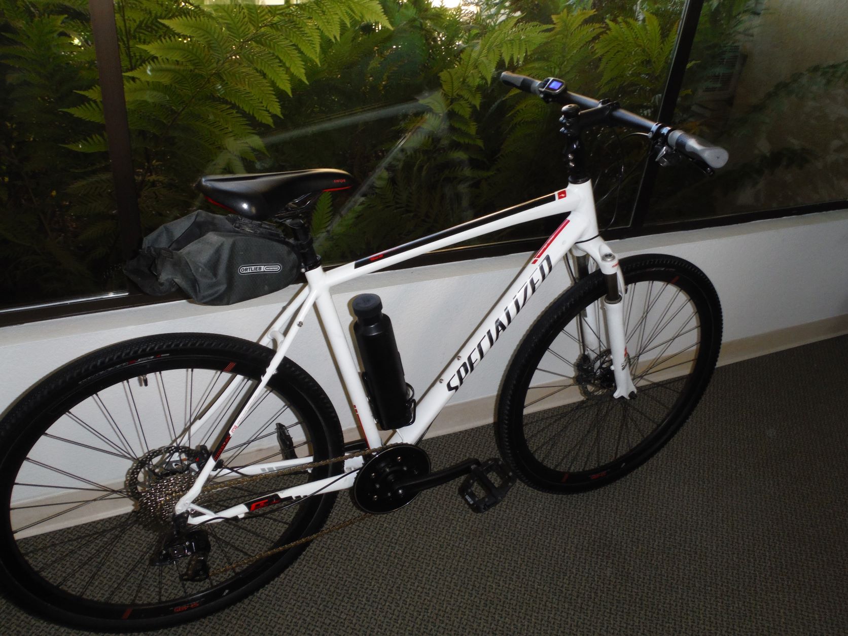

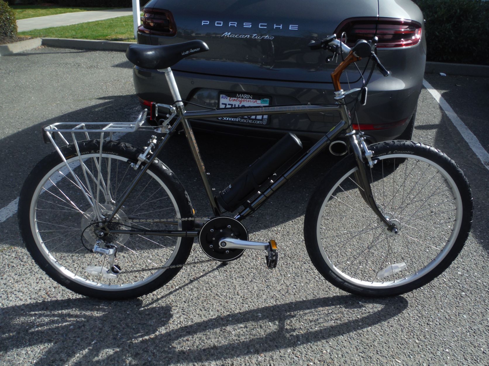

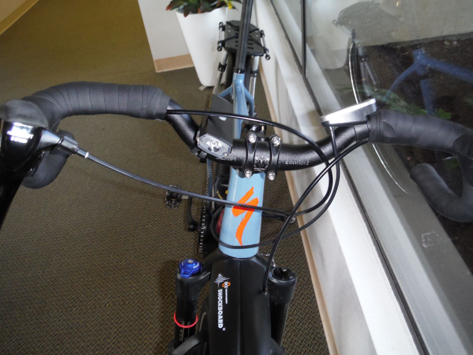

Here is a 1987 bike. It is 48V and has 90Nm with a torque sensor. I have found that once you get close to 100Nm or over you are in for drivetrain problems. This other one is a 2015 with an air fork and hydro discs. Bafangs suffer from surge and lurch with lag. They can also be ghost pedaled which is weird. And they have a bunch off ugly connectors, unhygienic. Better bikes are clean.
