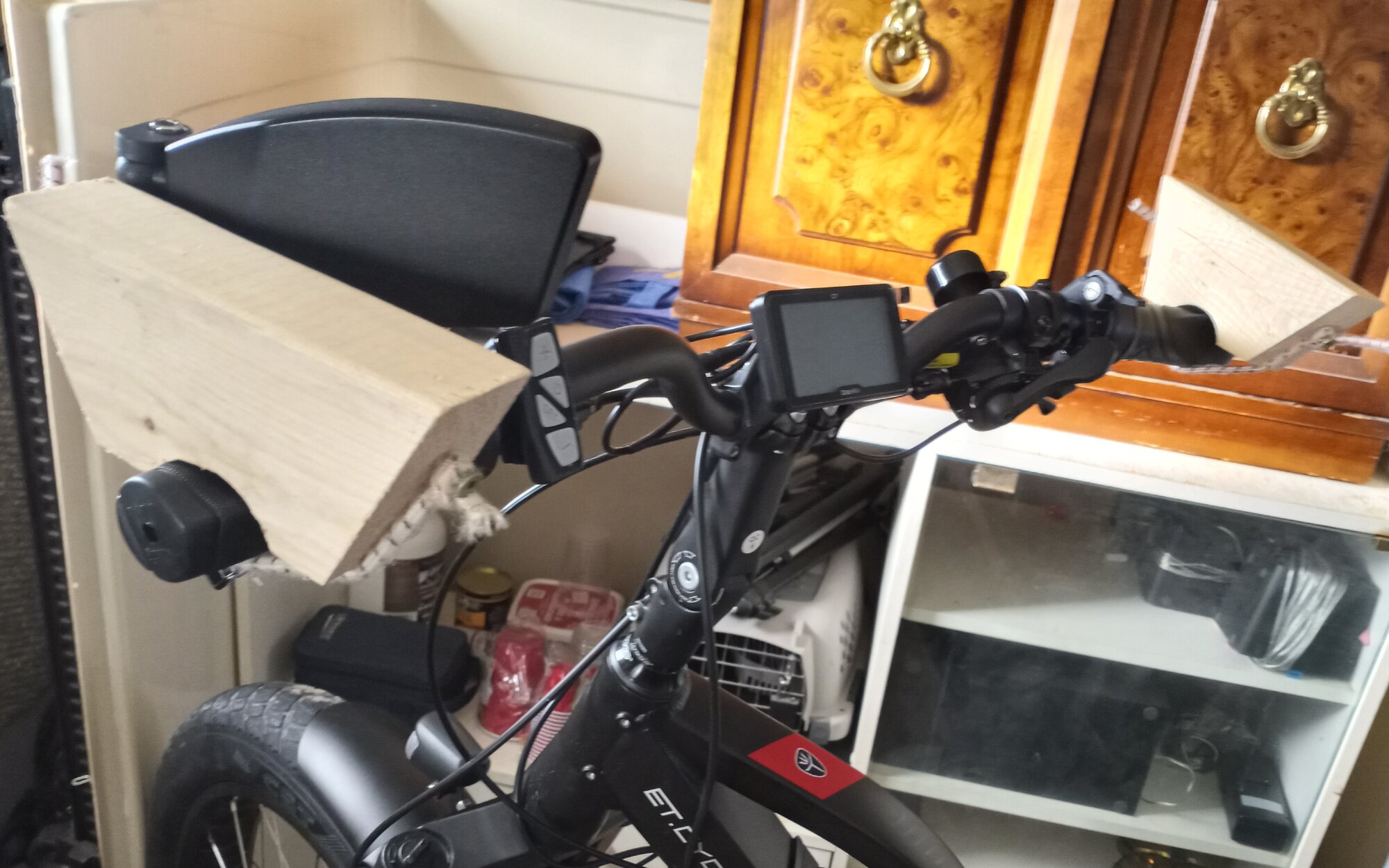

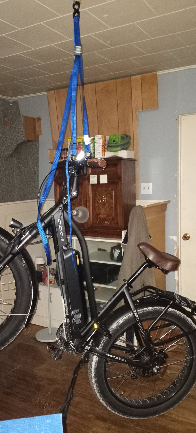

You can also get the tube out of the tire without completely removing the wheel from the frame.
There is enough room past the frame and axle to get the tube out to patch it.
I made these so I can flip my bike upside down without crunching the display and throttles.
Rocks or branches will work too.
And get a mirror.
Gotta have a mirror...

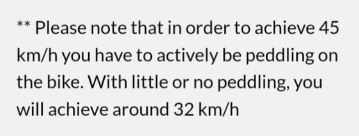

Of course I can pedal actively and get it to go faster.
Perhaps the Australian display keeps the power on after 32 kph?
My power shuts off after 32
I'm sure I could go down an incline at 48 mph
I don't care.
I don't want to go fast.
I wanna go for a long long ride, with a smooth throttle and an efficient power mode.
I think that is correct. On my Amego Infinite+, if I set Max Speed under PAS to 45 Km/h, in level 6 it will continue to provide assistance up to 45 Km/h as long as I'm pedaling at all. I would guess the off road kit behaves the same. For various reasons, I chose to set this value to 32 km/h, not 45 Km/h.

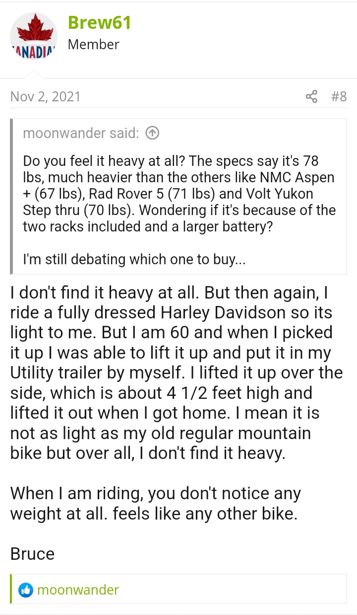

Can you ghost pedal and just float your pedals around, or do you have to really help?
The cadence sensor detects that the pedals are moving (slow, fast, any speed, doesn't matter) and then, the motor is engaged to try to get to the speed that corresponds to the current PAS setting. If the Max PAS Speed setting is 45 Km/h, then in Level 6, if pedaling it will provide power up to 45 km/h. When I tested this, that's how it behaved -- although on flat terrain, I don't believe I could actually get to 45...maybe 40 or so. If I lost some weight, maybe I could! AFAIK the T1000 and T720 have a more powerful motor, so it might get there.

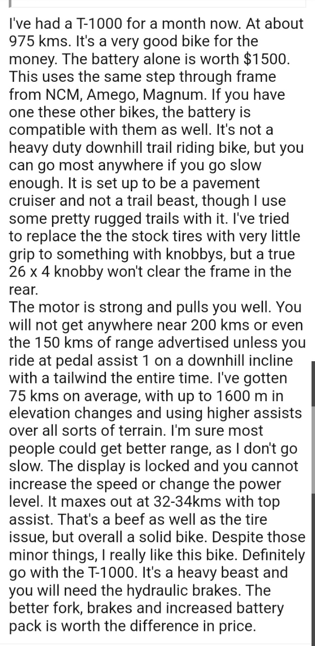

I found a review of the T1000,..
This is mentioned in the review.
I didn't know this, and it is not in the owners manual!!
"CONs of ET CYCLE T1000 100 Mile Range E-Bike:
The battery with on-switch must be turned off before removing them from the battery rail!"
Onother thing that isn't covered in the owners manual is that the rear light is not integrated with the bike and runs off 2 AAA batteries.
The on/off switch is kinda hard to find to turn it on or off, and getting it open to replace the batteries is really difficult and I was afraid of breaking it.
I had to remove it from the bike to see how it is put together so that I could open it up.
The opening point is hidden and you can't see it with it on the bike.

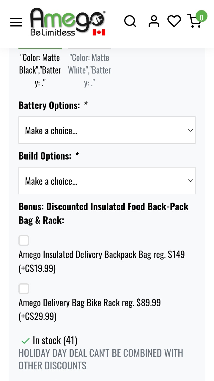

Looks like you can get a bonus rack and insulated delivery bag for $50.
You could get a job delivering food and get paid to have fun ripping around Whitehorse!? Lol
