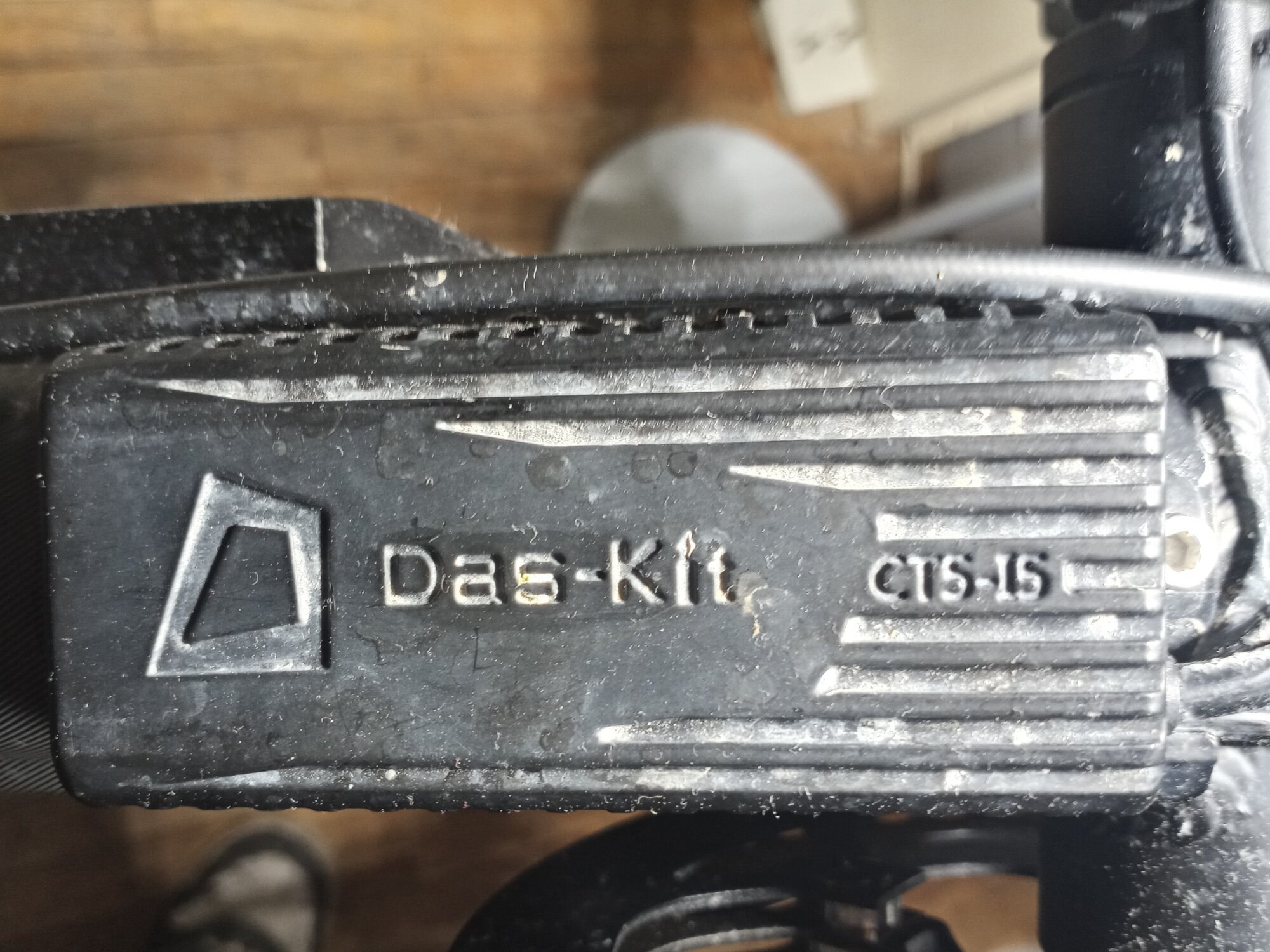

Yes we did get the off road display and I have confirmed the 15 amp controller. Eco mode is a minor difference it does accelerate a bit slower.15 amp controller allows 720 peak and in comparison to my other ebikes I would say it’s in the money.

I'm pretty sure that all the controllers look the same, but the guts are different.

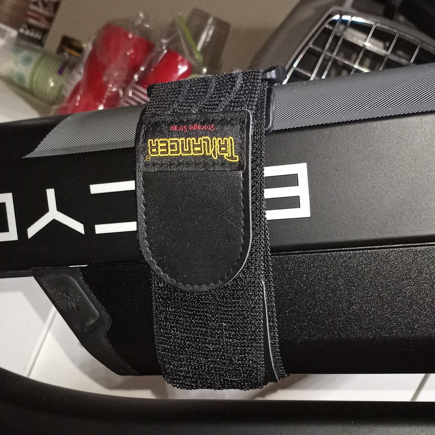

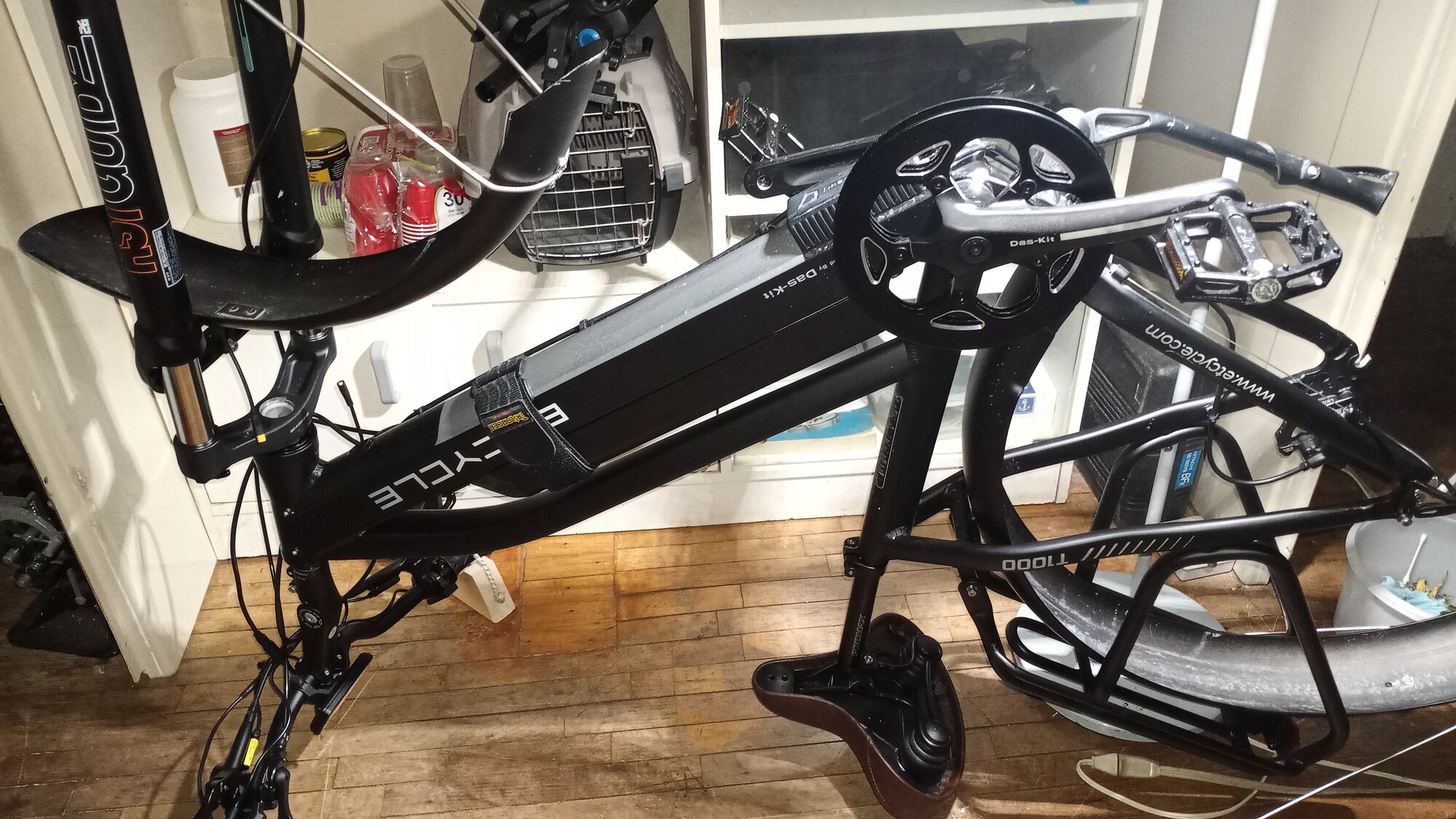

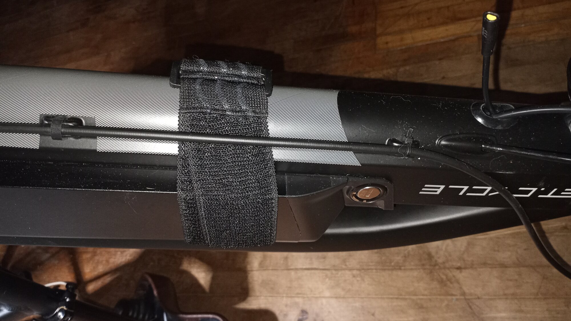

My straps arrived.
They fit perfectly. They are stretched to their maximum so they are nice and snug.
I put two on top of each other.
The battery doesn't move around now.
It doesn't look great, but I don't care.
I fed it under the brake line to not stress the line..

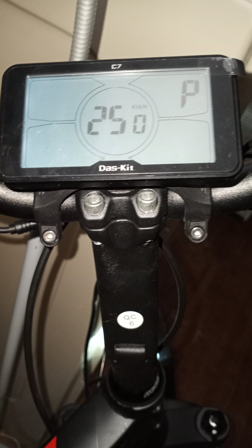

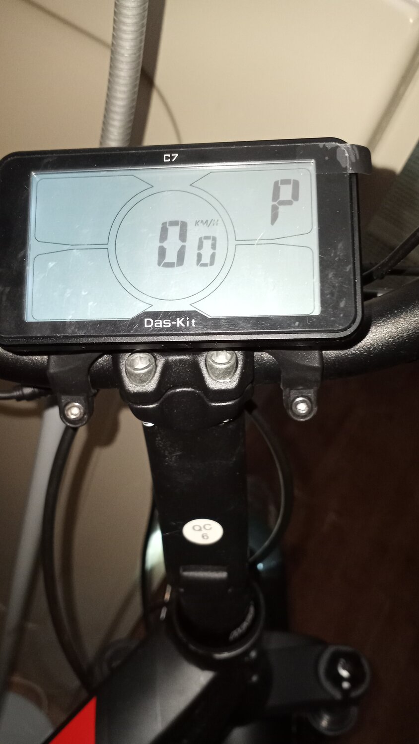

My Off-Road C7 display arrived and I took it for a test drive.
I wanted to get on the road quickly to test it before a major winter storm rolled in just a few hours later, so I test rode it without my bike chain. (it's still soaking to remove the grease before a hot wax treatment.)
I noticed no difference at all between eco and power modes.
I was adjusting all kinds of parameters trying to feel a difference.

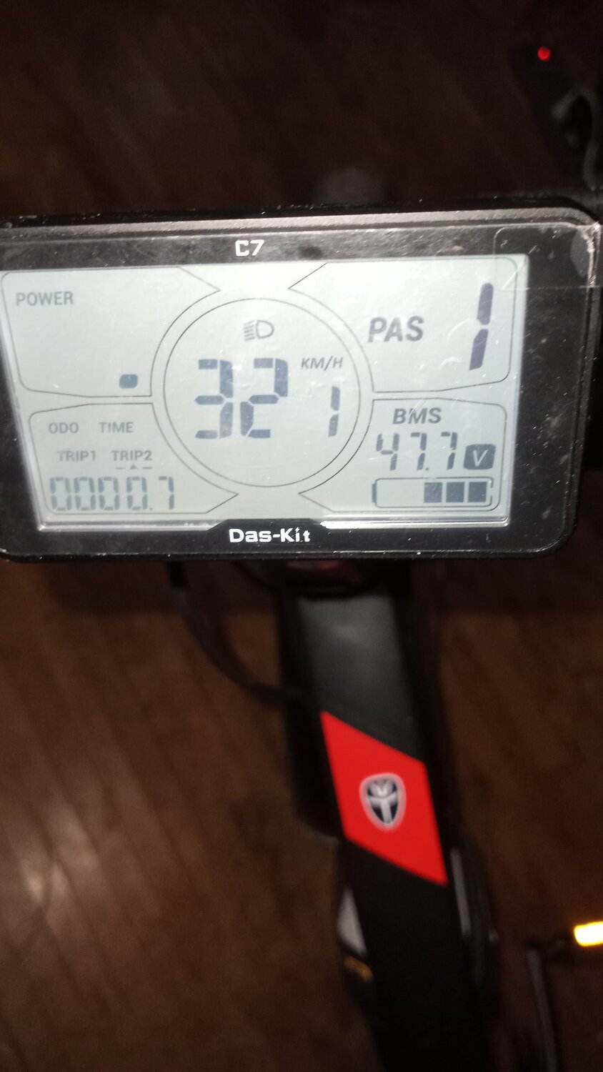

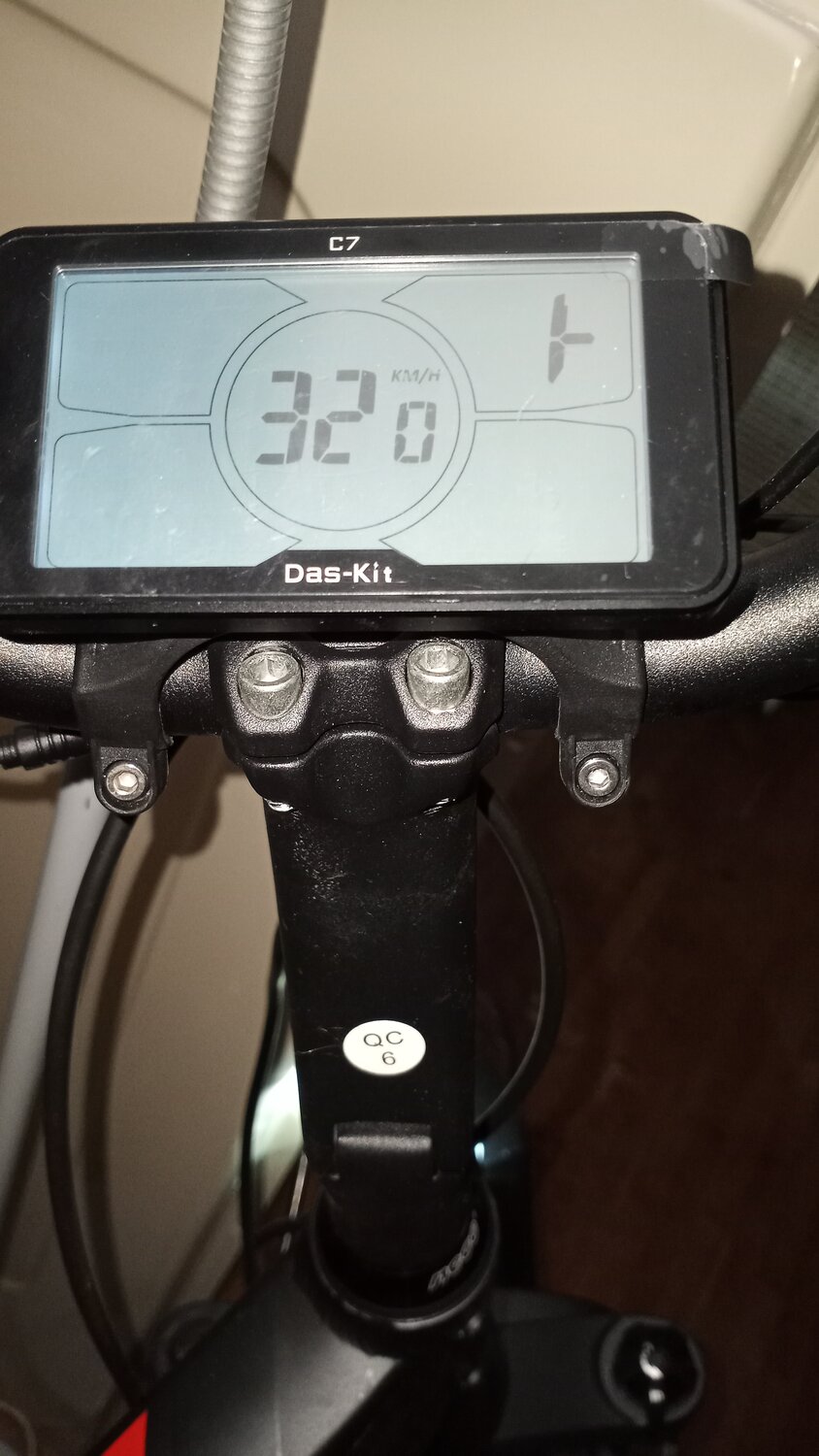

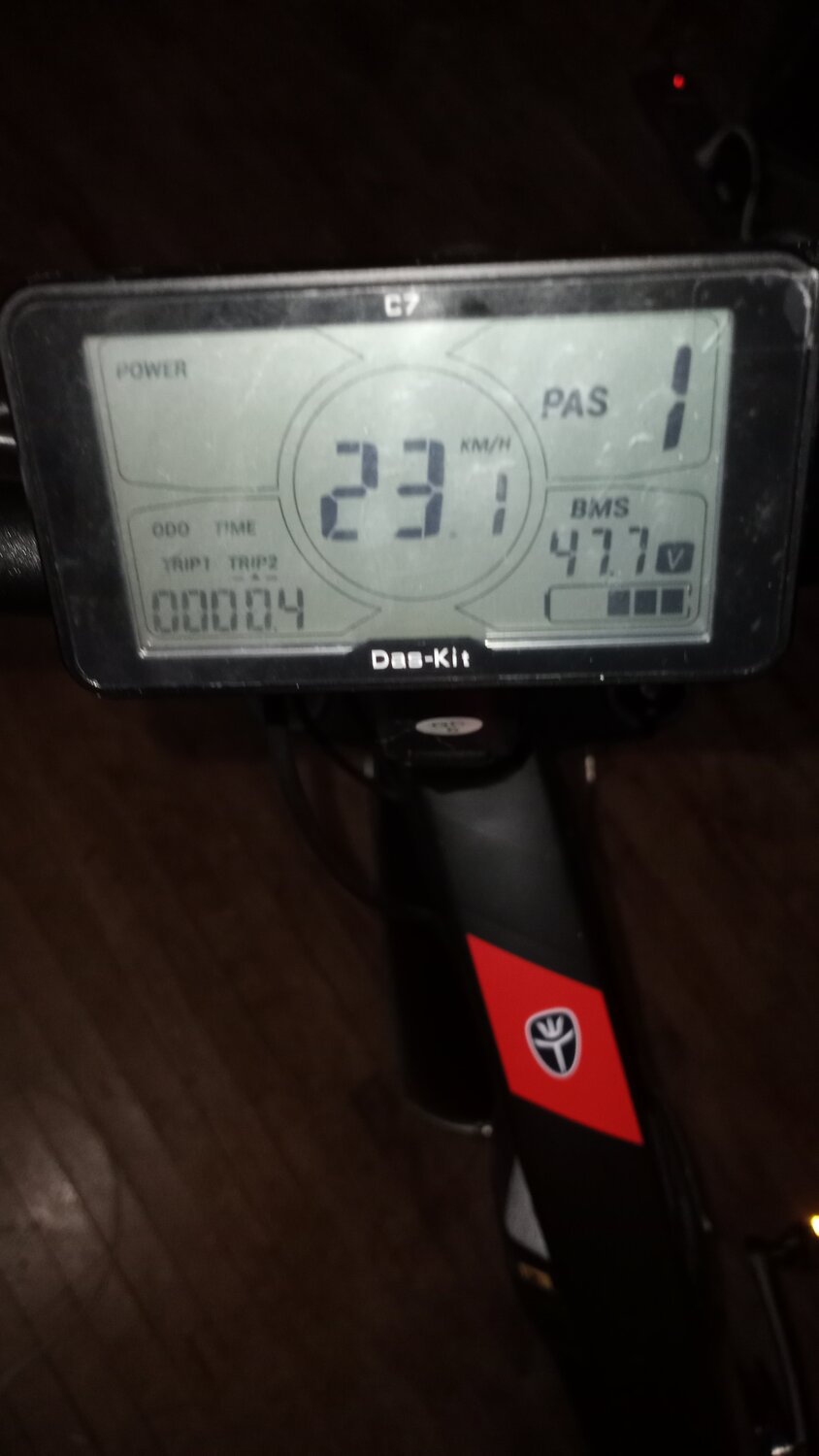

I also tested the 45 kmh setting and it is a lie.
The power cuts out at 32.1 kph and it's up to me to pedal it faster with no power assist.

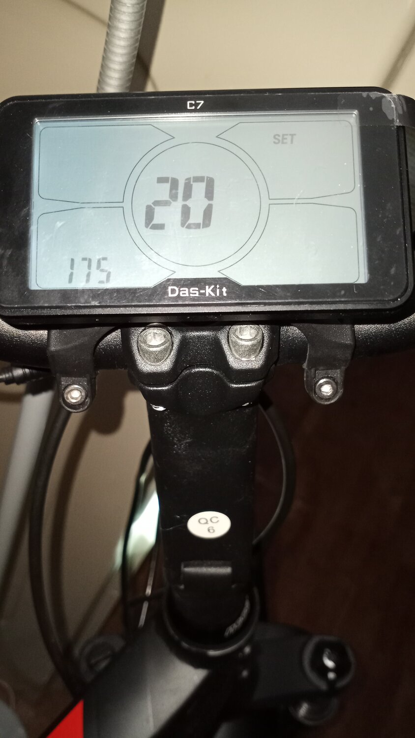

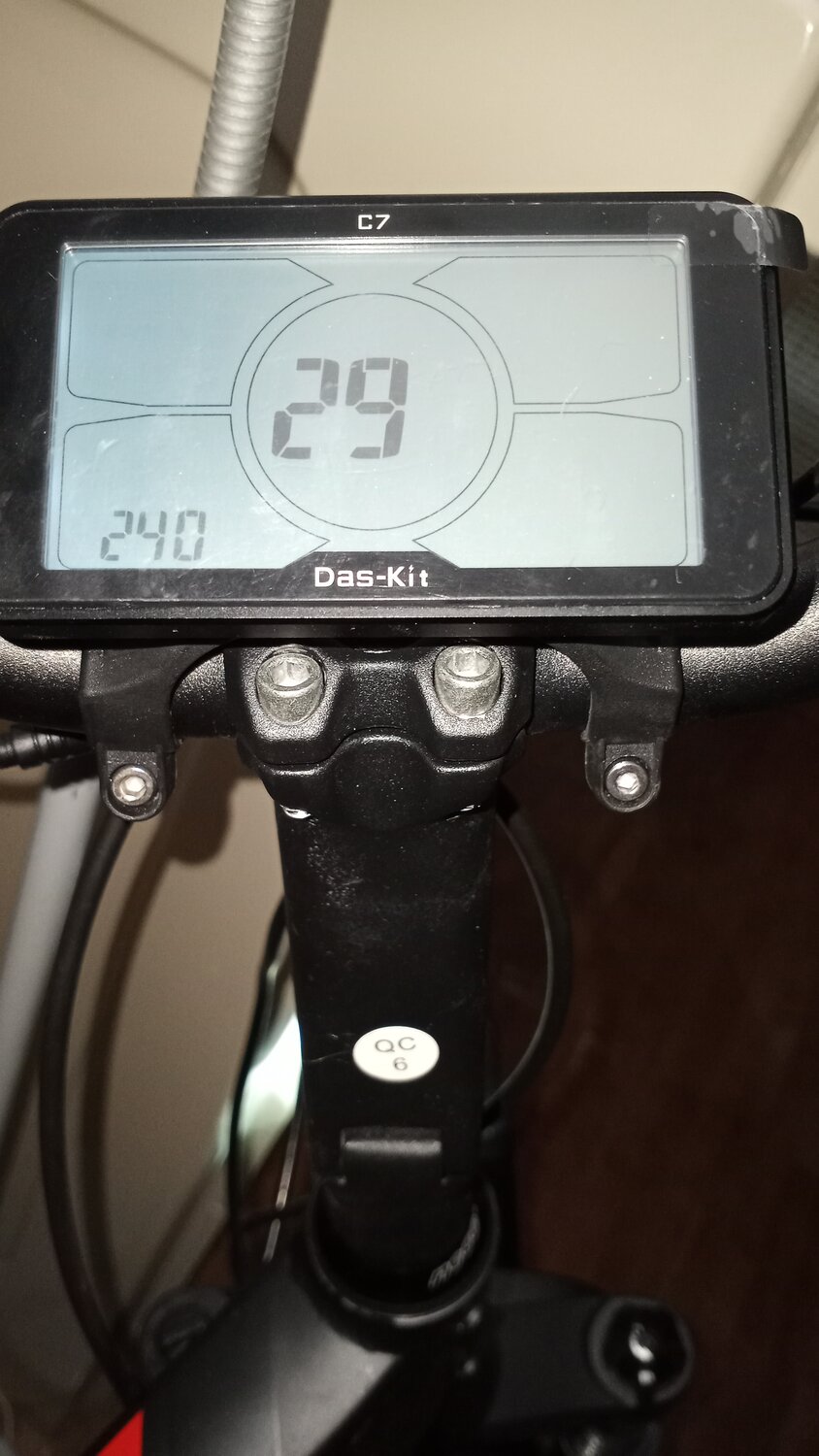

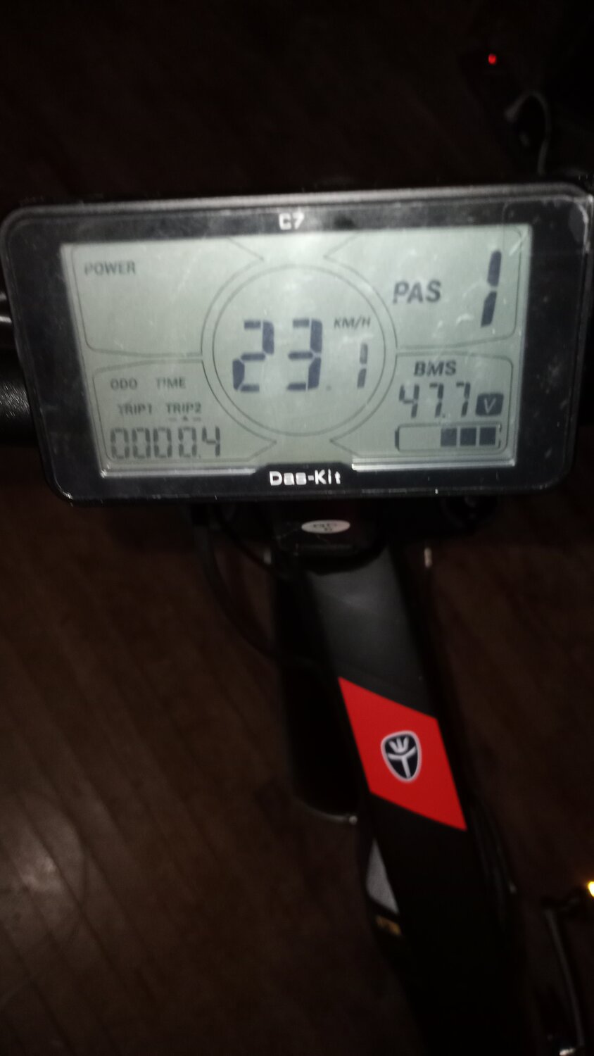

I tried changing the wheel size and that doesn't work either.
The smallest wheel size to select from (out of 19 choices) is 20X1.75 and the largest is 29X2.40
When I select 20X1.75 the speedometer reads 23.1 kph but my actual speed is still about 32 kph.
(I was using my throttle for this picture because my bike was leaning over on the kickstand, and I couldn't spin the crank without hitting the kickstand.)
When I select 29X2.40 the speedometer reads 32.1 kph, but it is probably slower because a 29X2.40 wheel has a larger diameter than my 26X4.00?

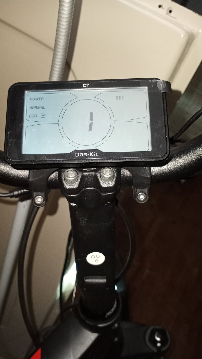

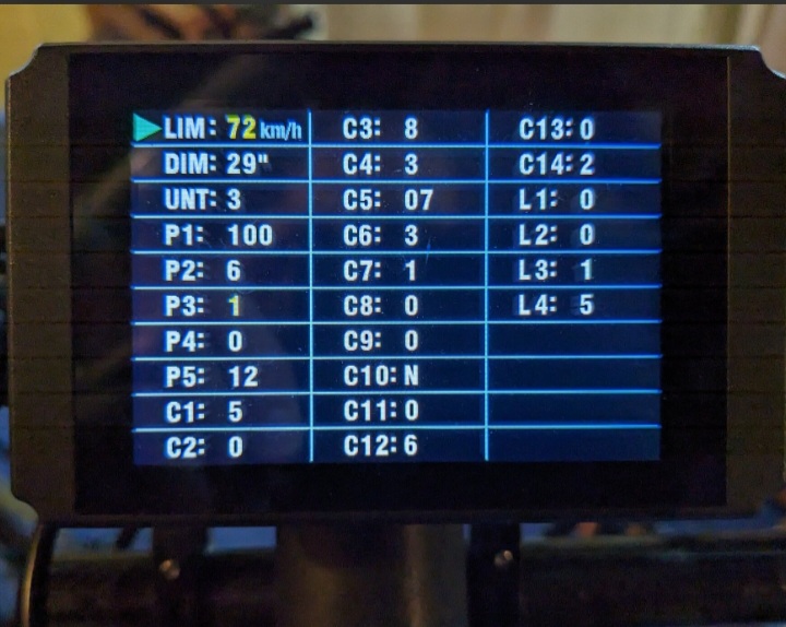

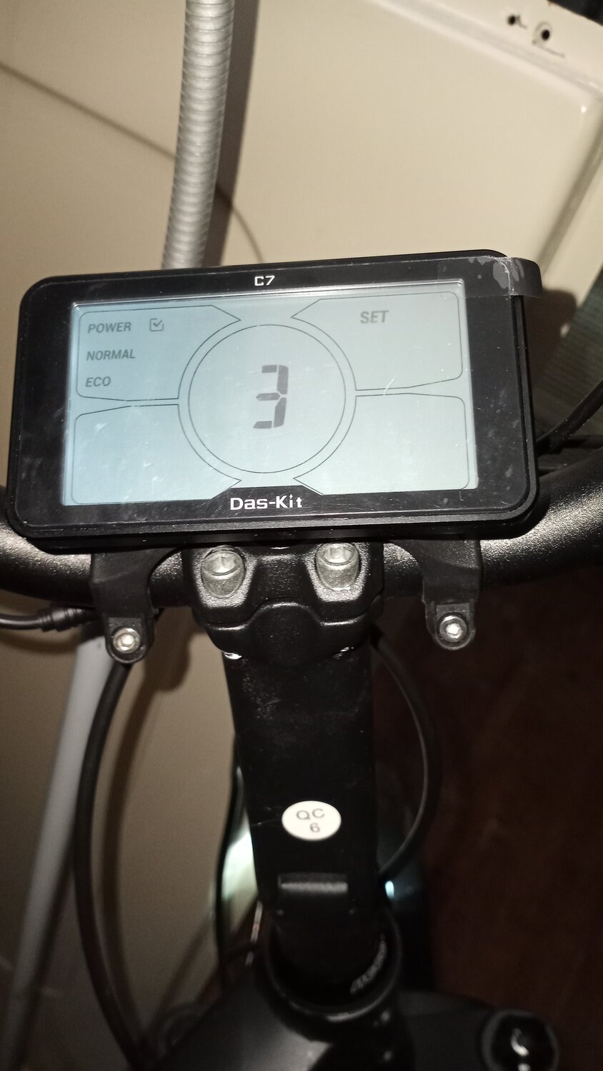

These are the power settings available.
I didn't try "normal", just eco and power.
These are the PAS modes available.
20221224_030217.jpg20221224_030202.jpg20221224_030247.jpg20221224_030119.jpg20221224_033240.jpg

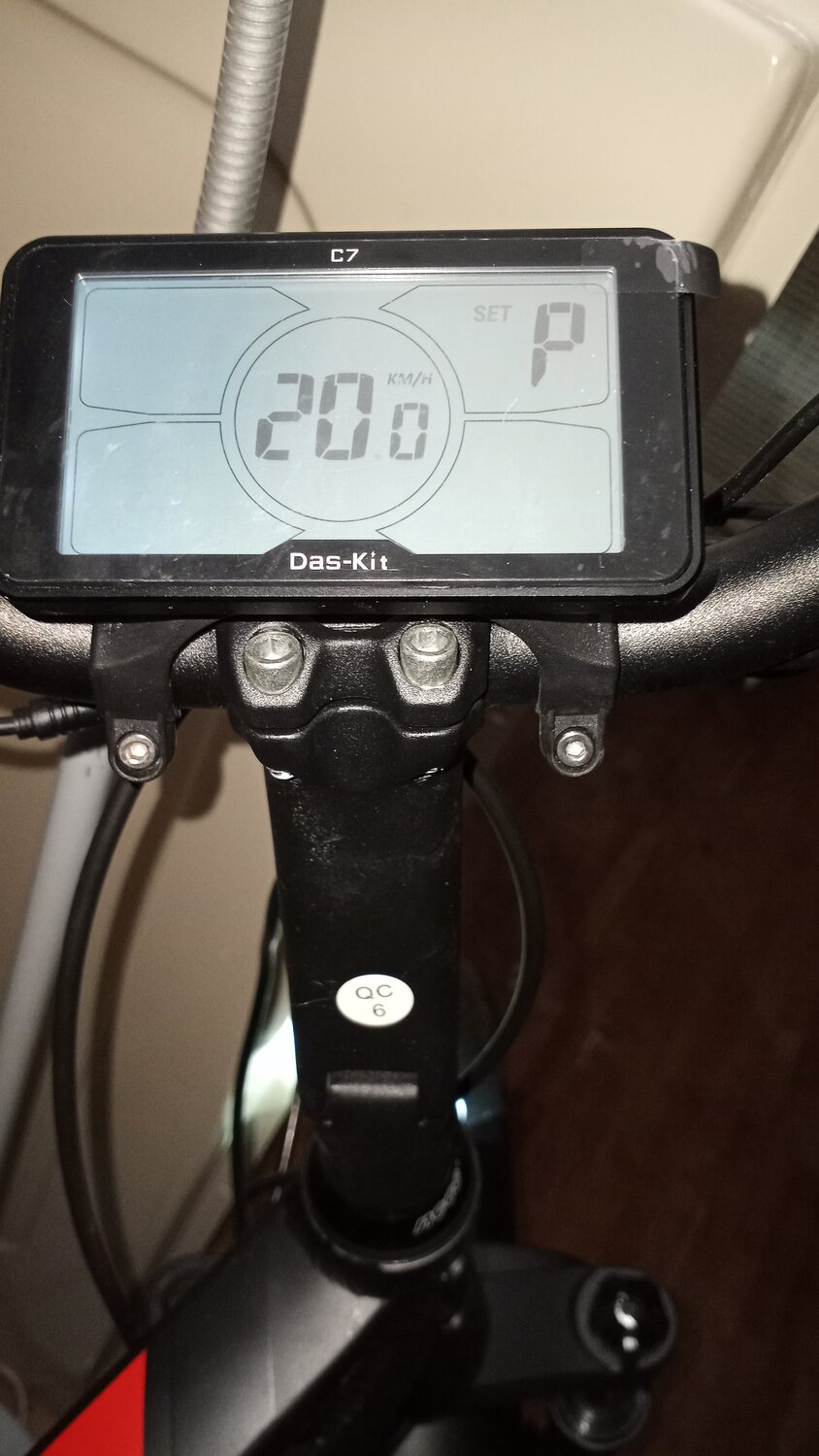

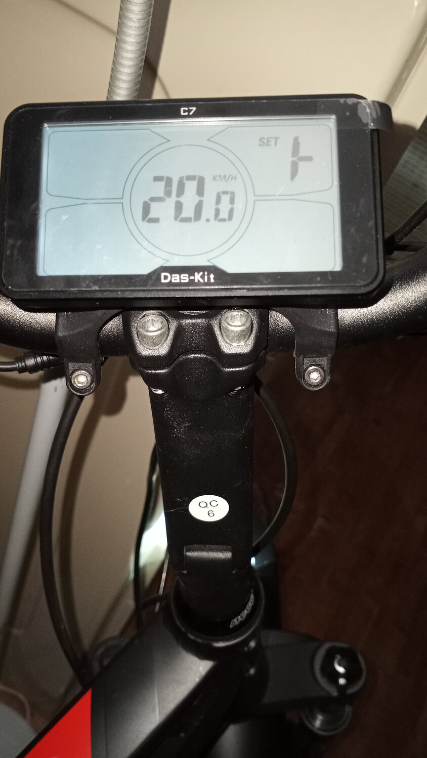

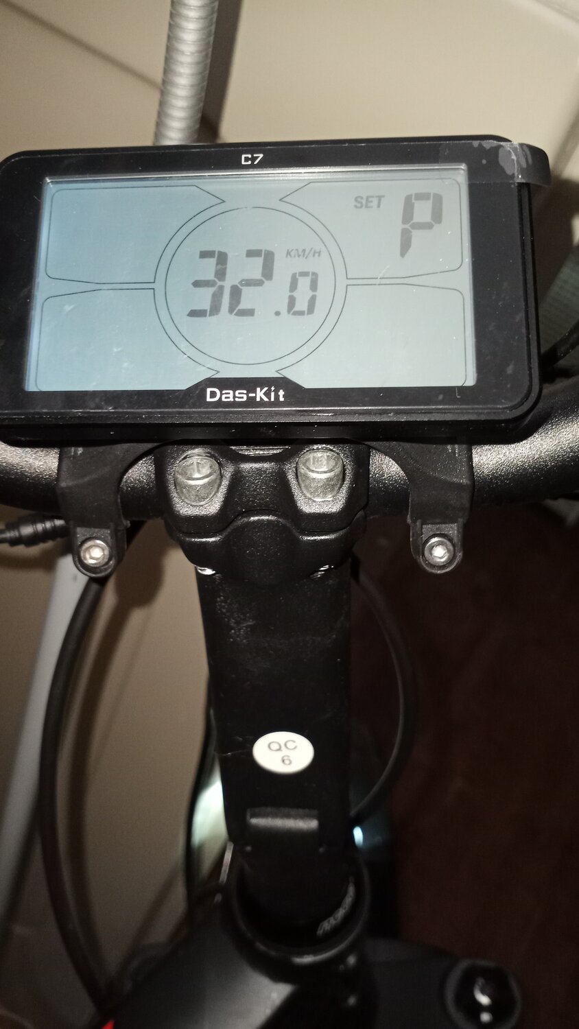

These are the throttle setting choices.

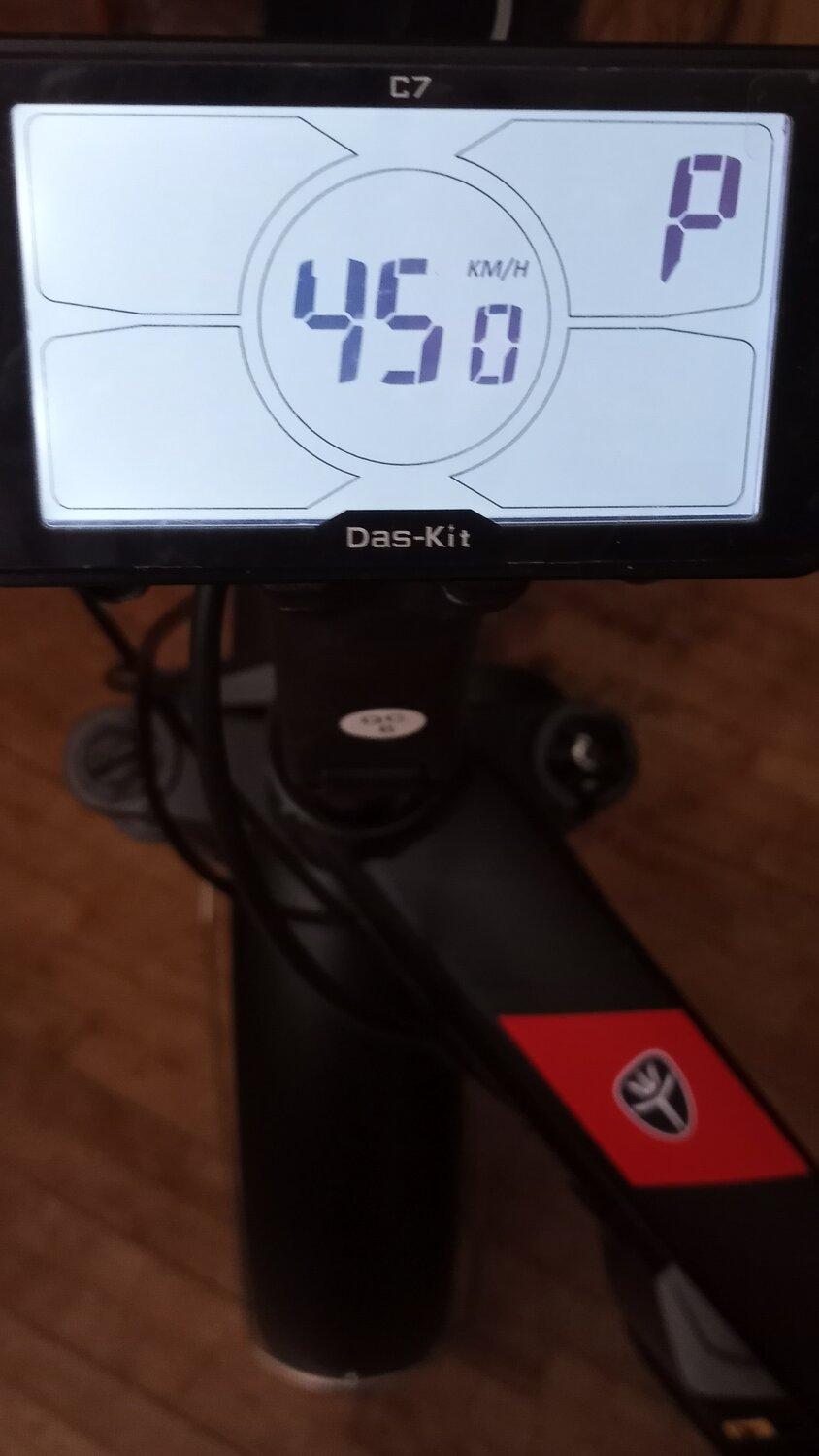

When I select 45 kph, the power cuts out at 32.1 kph.
When I select 32 kph, the power also cuts out at about at 32.1 kph.

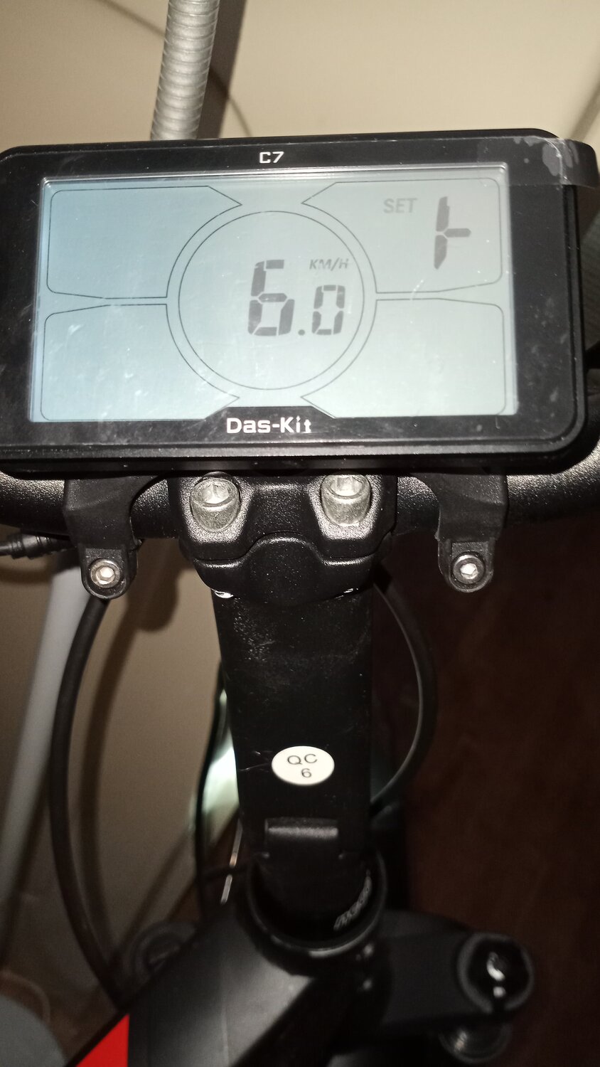

When I select 25 kph or 20 kph the maximum throttle speed selections drop to 20 kph or 6 kph, so I didn't test them.

I noticed that my straps are working and that clunking noise has stopped.

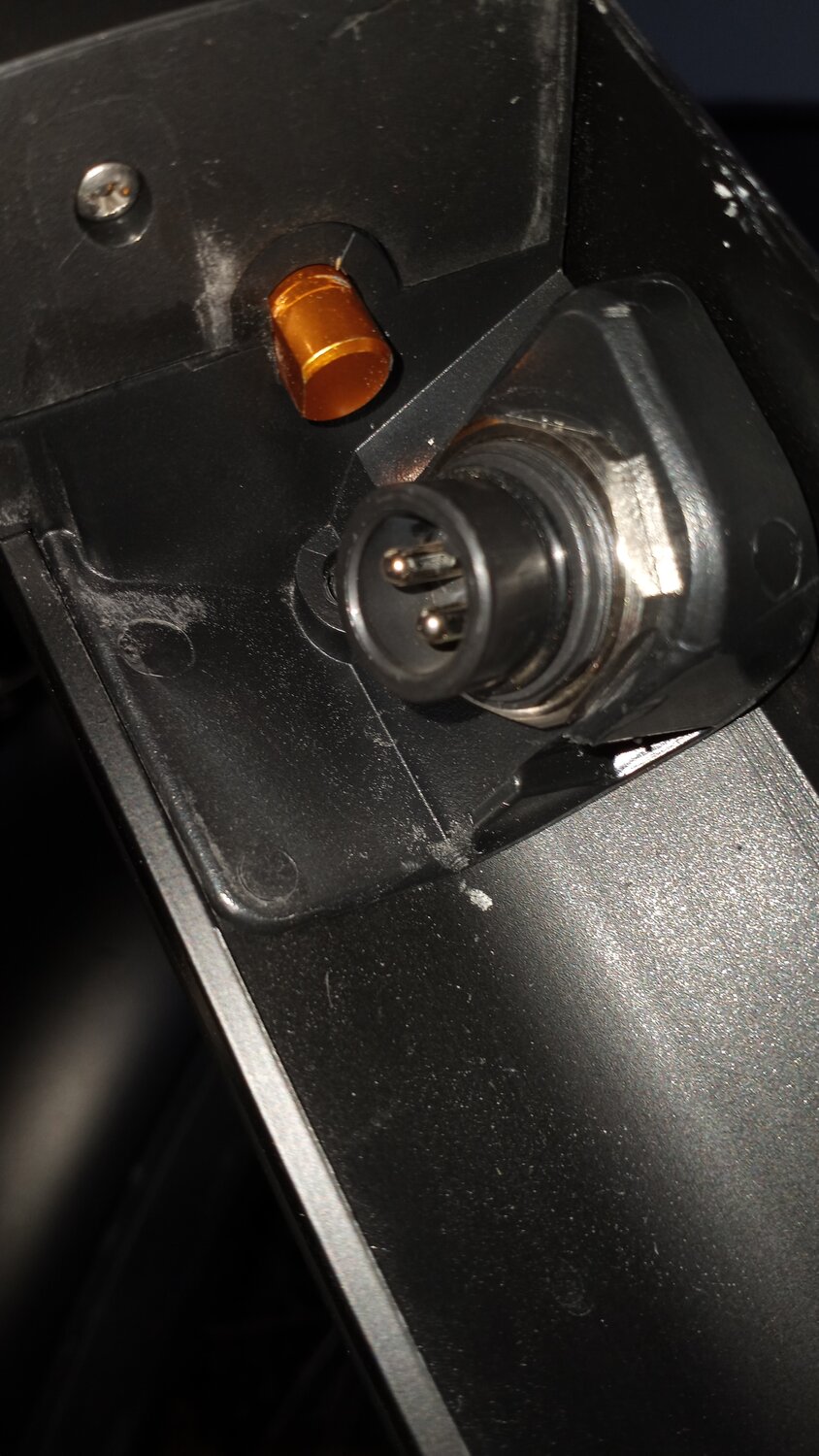

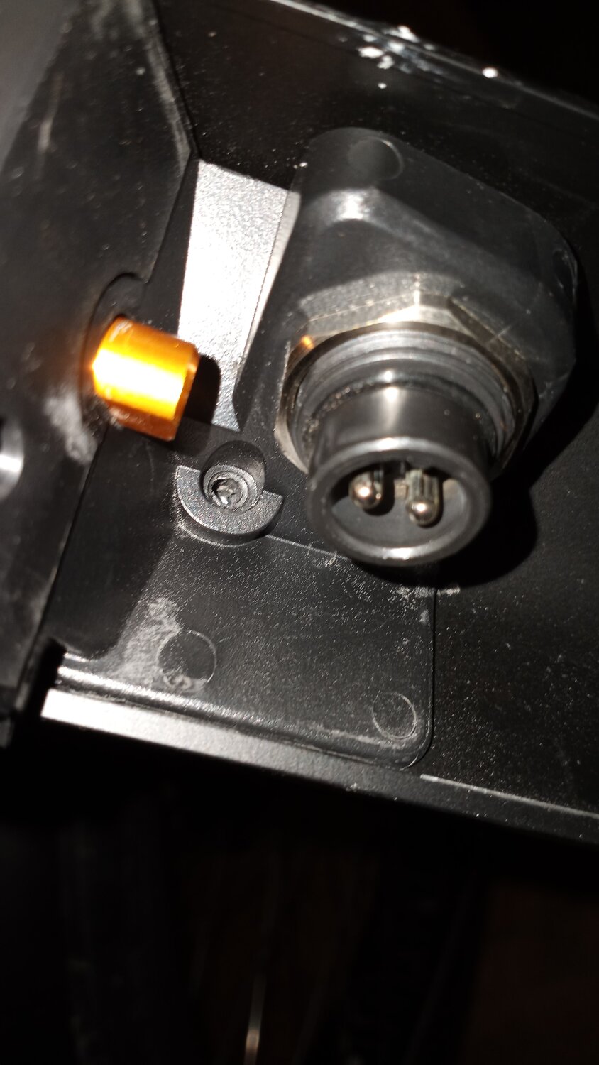

When I got home from my test drive, I removed the battery for only the second time.
The battery was really difficult to remove with the lock and battery being so sloppy.
When I got the battery out, a screw fell on the floor.
It was one of the screws that is supposed to hold the locking mechanism in place.
The battery is much better now with the screw replaced but there is still movement and I'm going to keep using the straps.
The bouncing around is probably what vibrated the screw loose and it could eventually break the plastic battery connection or break a wire inside the battery disabling it.
I would suggest to everyone to at least remove those screws and reinsert them with loctite.
View attachment 143242View attachment 143243View attachment 143244

Yet to try the 6kph setting as i never go that slow. The controller is labelled as the 22Amp one even on the ‘250W’ version sold here. I suspect throttle would easily go above 32 kph its just locked in that way. My Bafang hub drive bike has no restrictions it will throttle to 40 kph no load but i’m to fat-103kg-so i get 36 at most unless down hill.

And it looks like I'll be able to go 72 kph? Lol
Actually I should be able to get to the maximum rpm of the motor which is probably about 45 kph.
