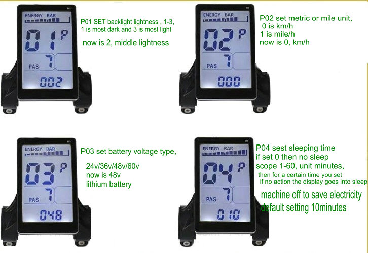

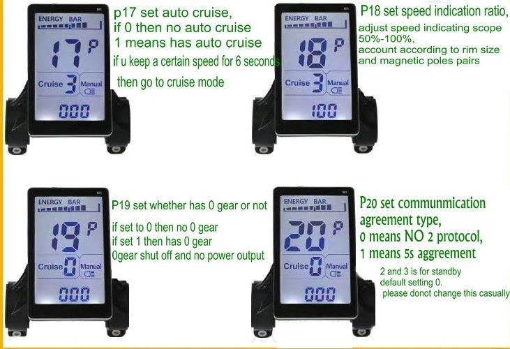

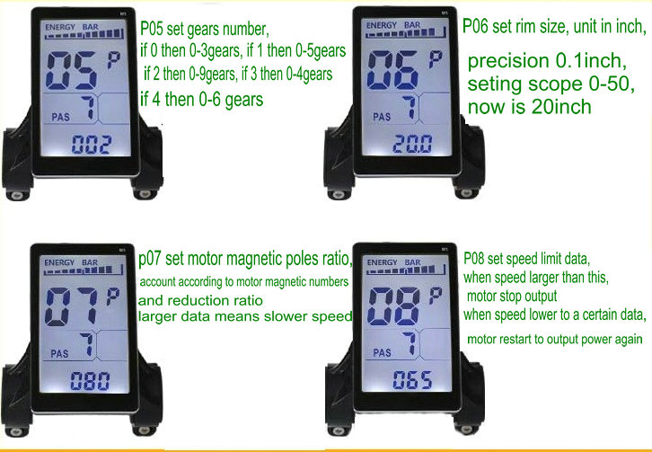

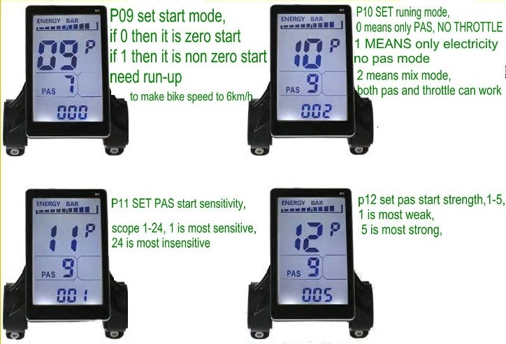

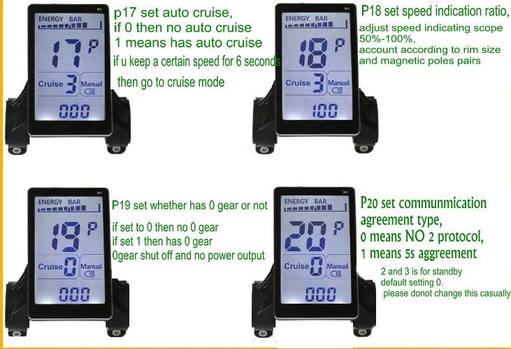

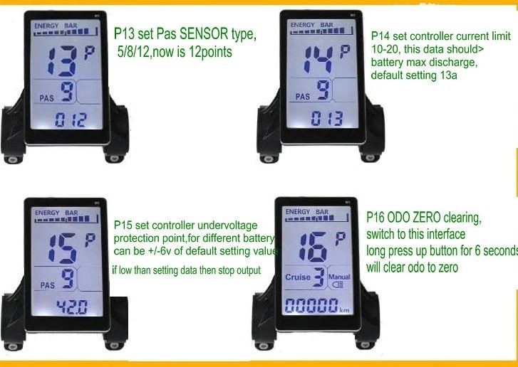

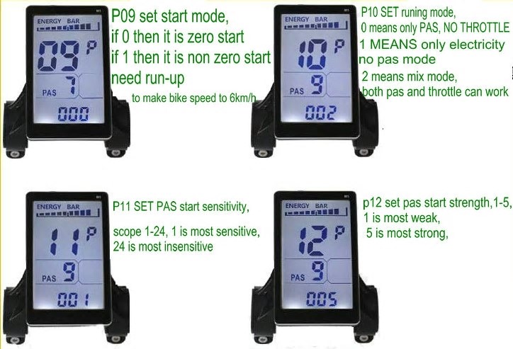

Does anyone have the settings and what each one does? P01 thru P20 codes or settings and each definition, hoping I didnt change any on accident, plus maybe enhance the settings. PAS3-5 is at 20mph, is there anyway to reduce that?

Here are the proper numbers
Hold down the up and down buttons
Cycle through the "P" settings using the "M" button
If needed change the numbers on each setting by using the up and down arrows
Once completed hold down up and down arrows again
Hold M to turn off and save the settings
