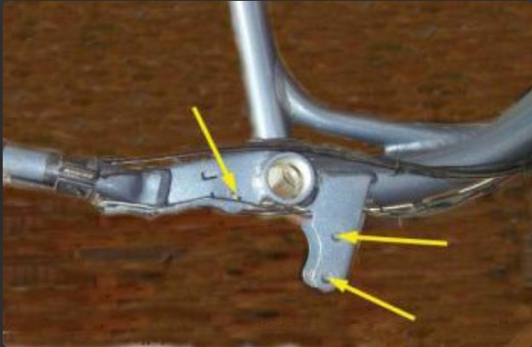

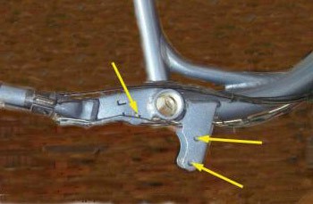

Someone sent me this picture, that they said was of a Kalkoff frame, I am not sure if the round hole is the Bottom Bracket, its such a bad picture, and I have not been able to remove my motor to see whats there
Can anyone confirm if this is the picture of a Kalkoff Pronnect S

There may be a place to mount the bottom bracket, but that looks like a proprietary motor mount that would get in the way and you would have to remove. @PedalUma has mounted a lot of these mid-motor kits and could probably provide better direction on that. Personally, I think you would be better off using a different donor bike for your kit.
Yes; That is for a 2010 24V 200W Panasonic motor. Use a standard frame with an english bottom bracket shell that is 38.8 in its inner diameter and 68-73 in width. I think this is the person in San Diego who emailed me today.
yes that was me!
Rick, do we need to make duty the bottom or is that hole on the other frame picture I sent the bottom bracket? I am not adverSE TO WELDING on a new bracket

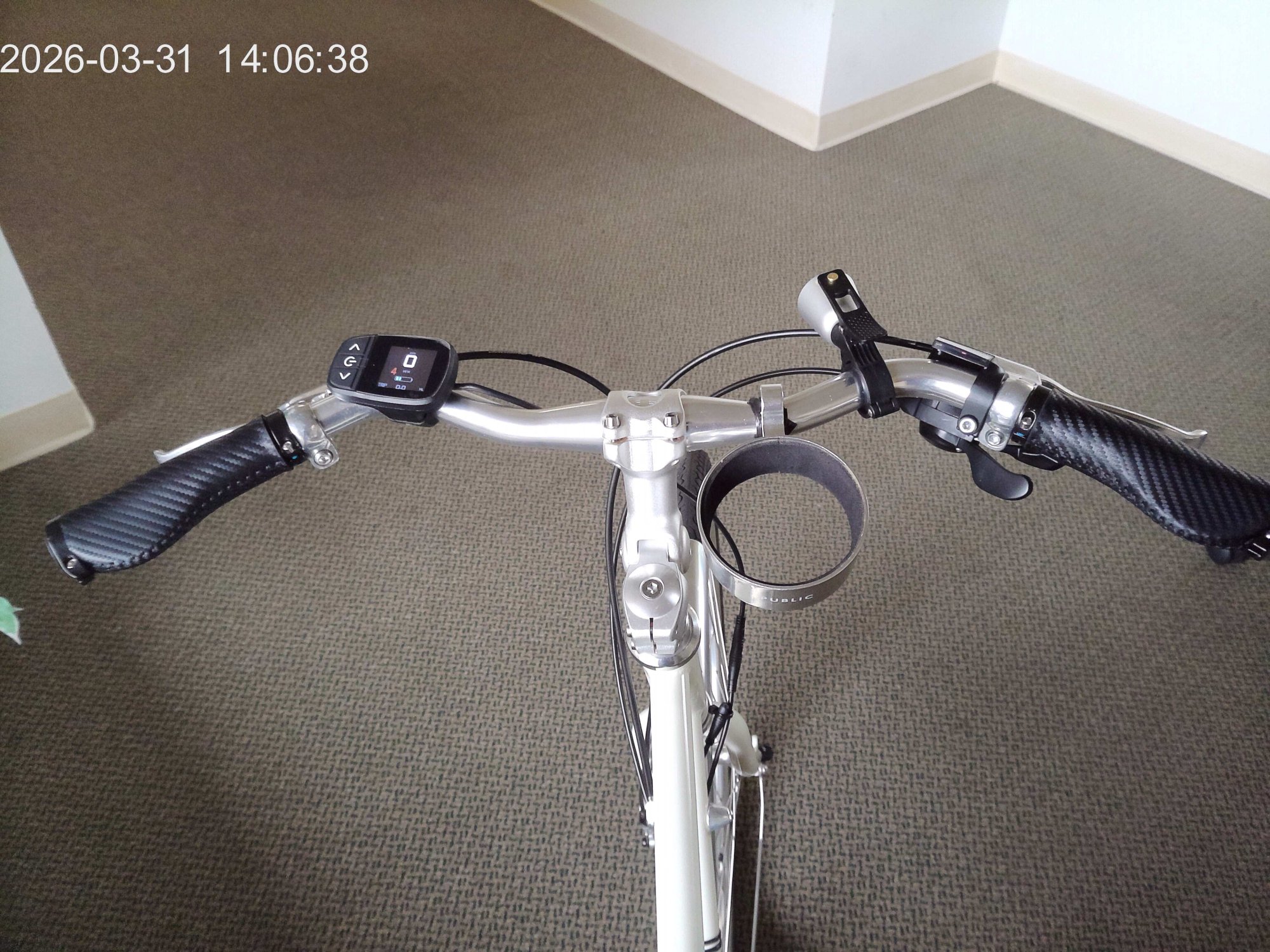

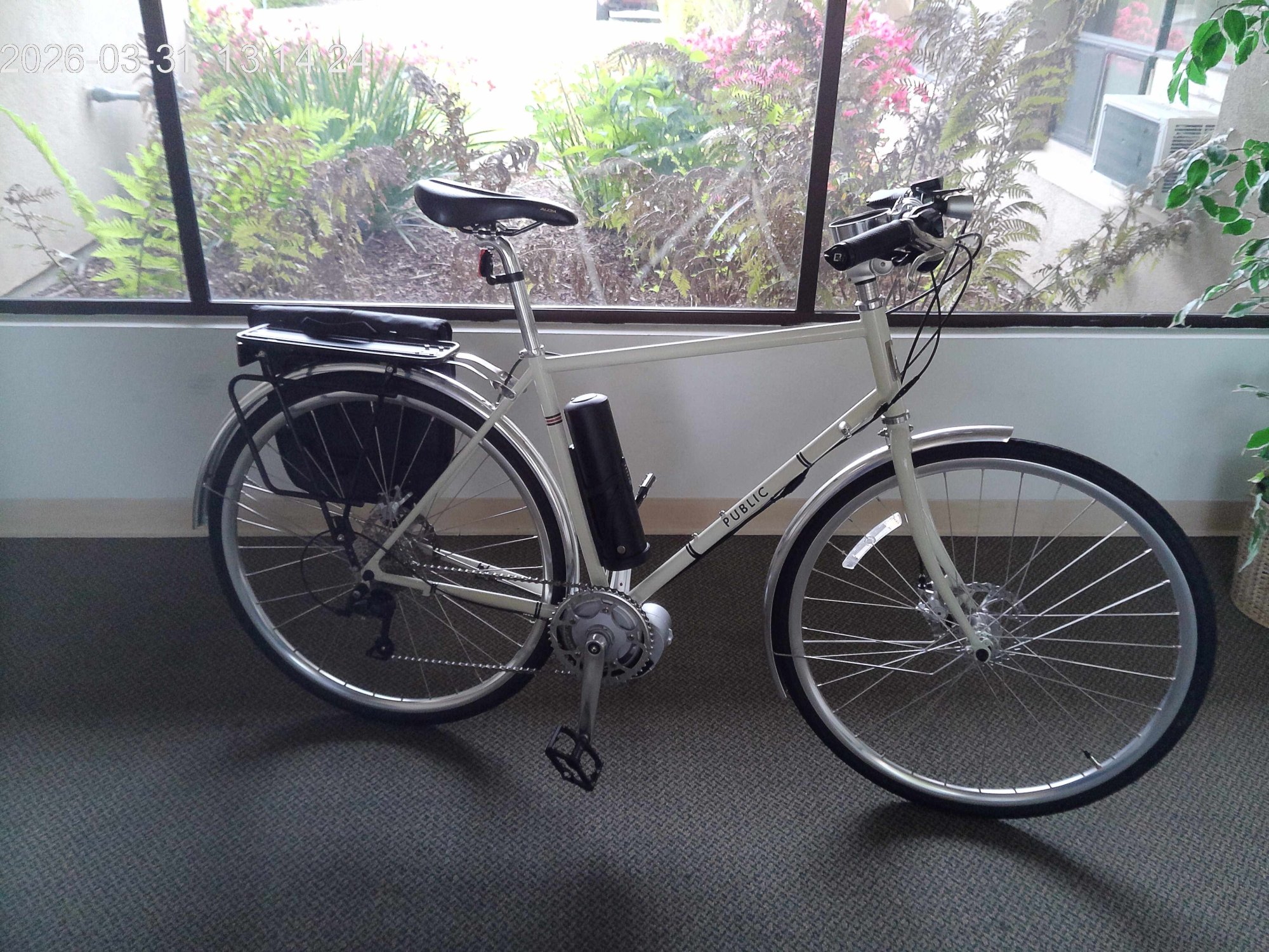

Exactly. This woman's starter bike was $100 at a yardsale. It was a Covid buy and never ridden. I gave it some upgrades and installed the motor and battery. The tires had a seam flap of rubber along the center. New its a $900 starter bike. Now it will rundown and pass $14,400 bikes from stores and will all the feel of a real bike. And with so much classic style and no chunky clunkiness. How many eBikes have polished crankarms and a silver motor?
