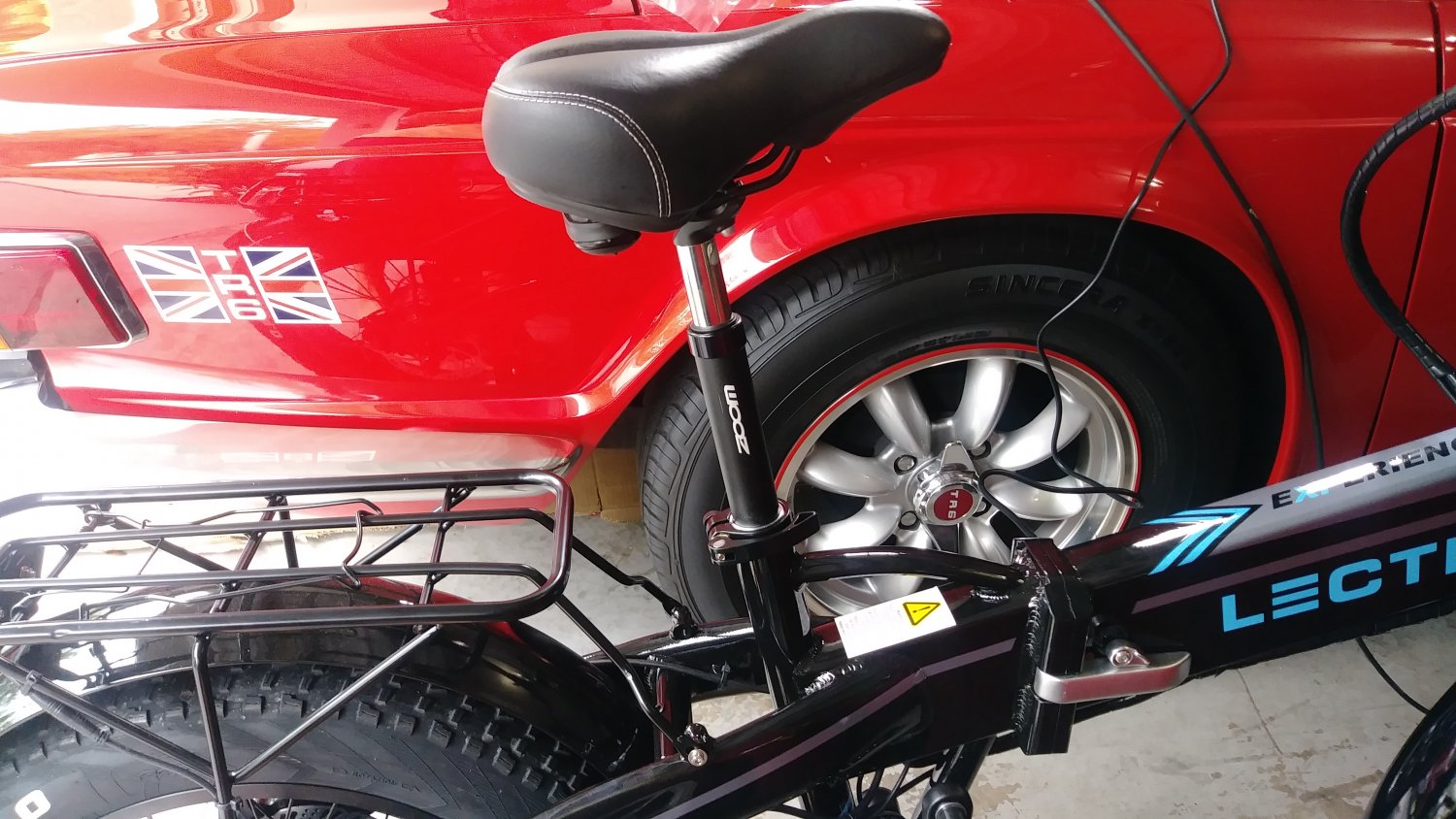

I'm using a zoom suspension seat post under 28 bucks on eBay I'm sure there are better and more expensive ones but this one and lowering the tires psi to 15 lbs works fine for me...View attachment 37345
My girlfriend bought the SunTour I have tried it it makes a huge difference and is easy to adjust she bought one 350 mm long I would suggest looking for the 400 mm long one it gives you more room for adjustment. Hers is so nice I have ordered one. Buy it on AliExpress it's the best price. You have to look for 400mm but it's there.
