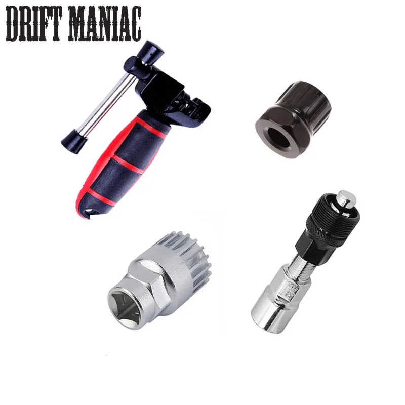

Here is the tool from the same place, I just got both in the same shipment:
#Aliexpress US $16.38 | Mountain Road Bike Repair Tool Kits Bicycle Chain Cutter/Bracket Remover/Cassette Freewheel Remover /Crank Puller Remover Tools

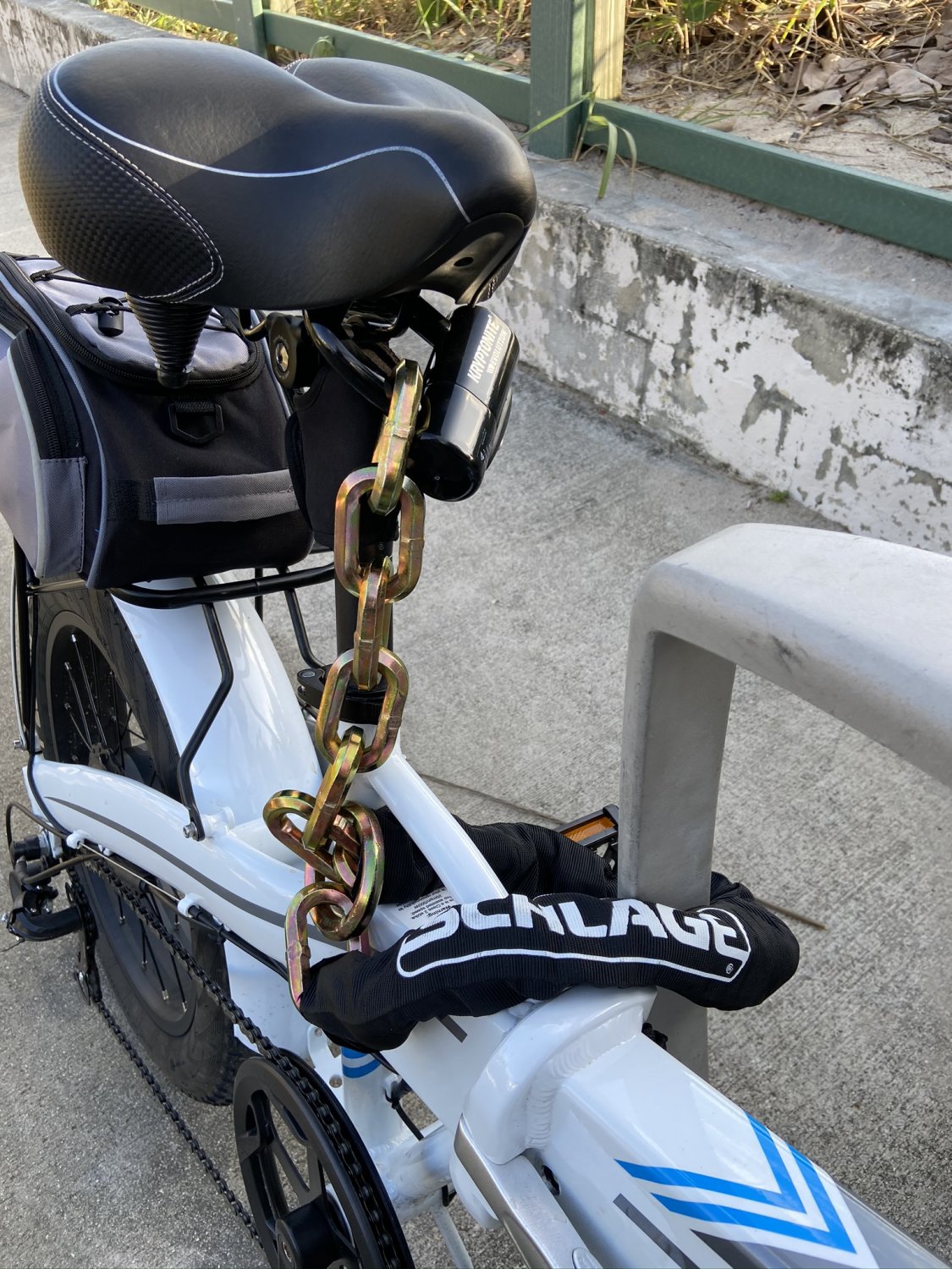

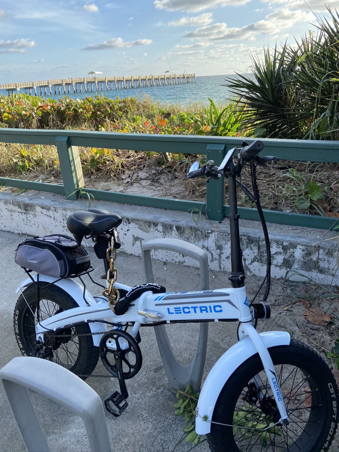

Hi! So after watching a ton of videos about locks I learned a grate deal. What I didnt learn is which ones fit this bike! Im still waiting for mine to arrive, but by examining a picture of the xp it seems to me that not all locks would work well because the frame is so differant. What locks do folks here prefer? I don't live in the city but there's thieves everywhere and I'm hopping to travel.
I use a big noose chain and lock to secure the frame and suspension seat post. I store it with a repair kit in a bag on the rack, only takes a minute to deploy. 4646846467
I use a big noose chain and lock to secure the frame and suspension seat post. I store it with a repair kit in a bag on the rack, only takes a minute to deploy. View attachment 46468View attachment 46467
WOWZERS! I looked at those- they are serious business! I guess your seatpost would be desirable for any bike, where as the real wheel wouldn't be as much? How would you use this lock if there was only a tree and not a bike rack?
The noose chain i use is a little over 3 feet long. If I were going around a tree I may not be able to also secure the suspension post at the same time, unless I used a cable also. I did use to carry a cable lock with me for that purpose but found I was not ever using it.
