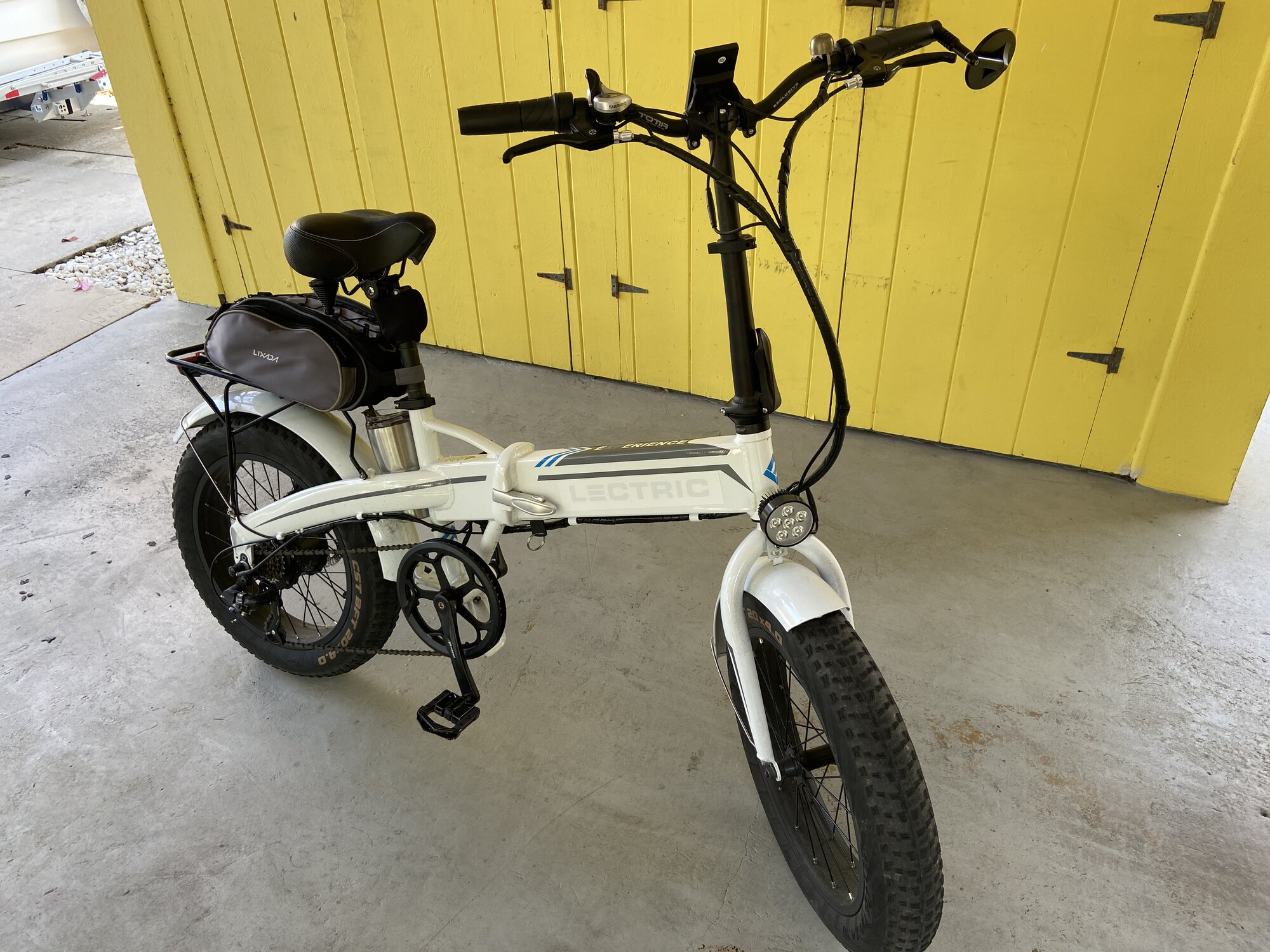

This is what it looks like on the bike
is that a different headlight? looks different than mine
It is this one that another member (maybe Darceman?) found and posted a while back:
It is much brighter than the original but does not look as nice on the bike.
