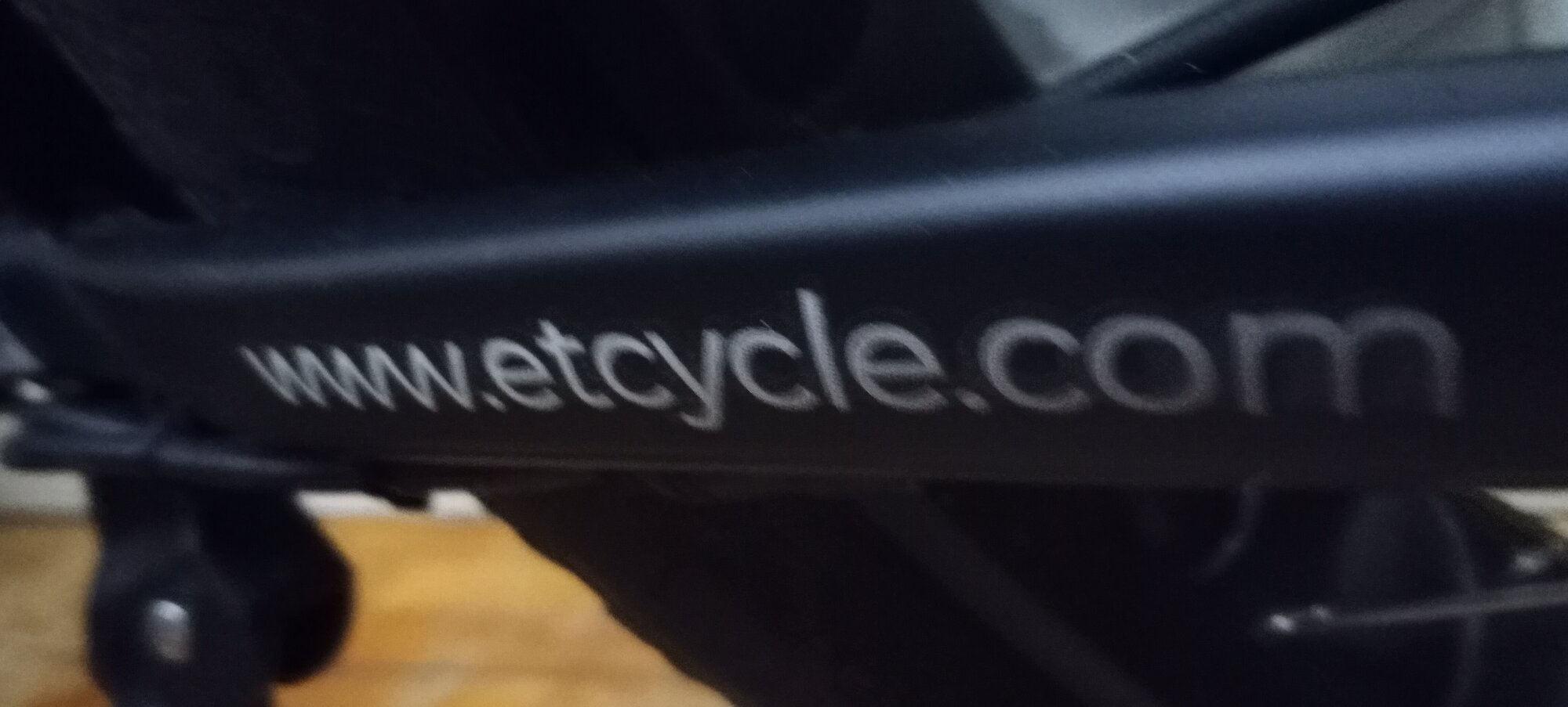

I just bought an ET.CYCLE T1000
PCeBiker
Canada
There is no ET.CYCLE reviews, so I thought that I would post a thread here along with my Das-Kit cousins.
Information on this bike is really hard to find, but I have learned a few things.
If anyone has any light to shed on this bike, I would greatly appreciate it.

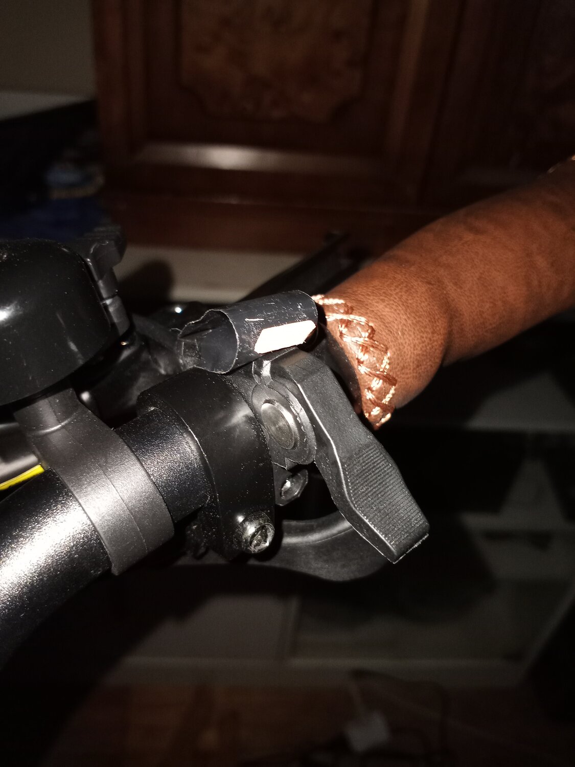

One thing that I have figured out is that my ebike does have an active throttle, but the thumb throttle is useless.
It is nothing more than an on off switch in practice, so I purchased a half twist throttle and 3 pin throttle cable extension to cannibalize to get it to plug into my Das-Kit C7 Display.

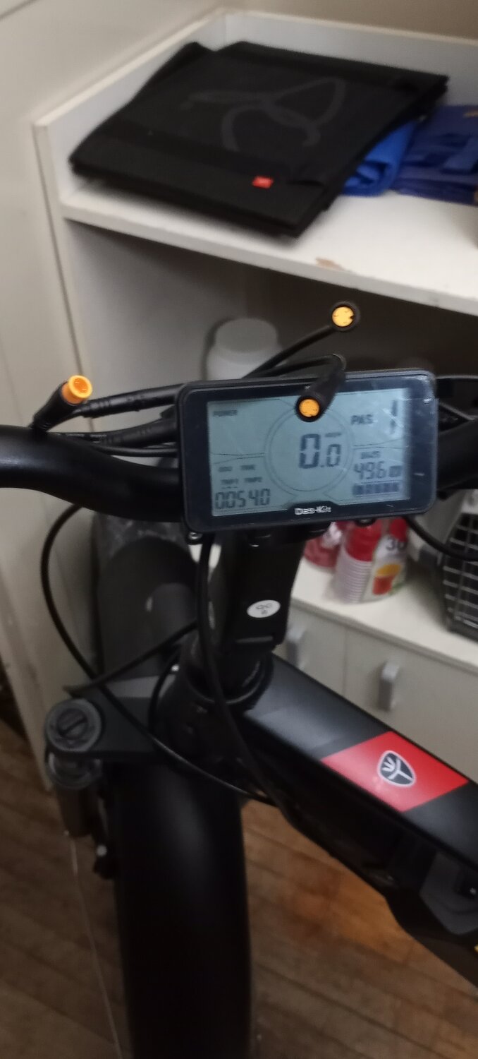

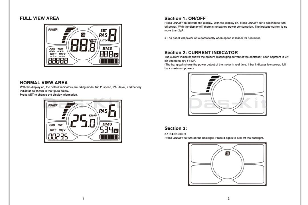

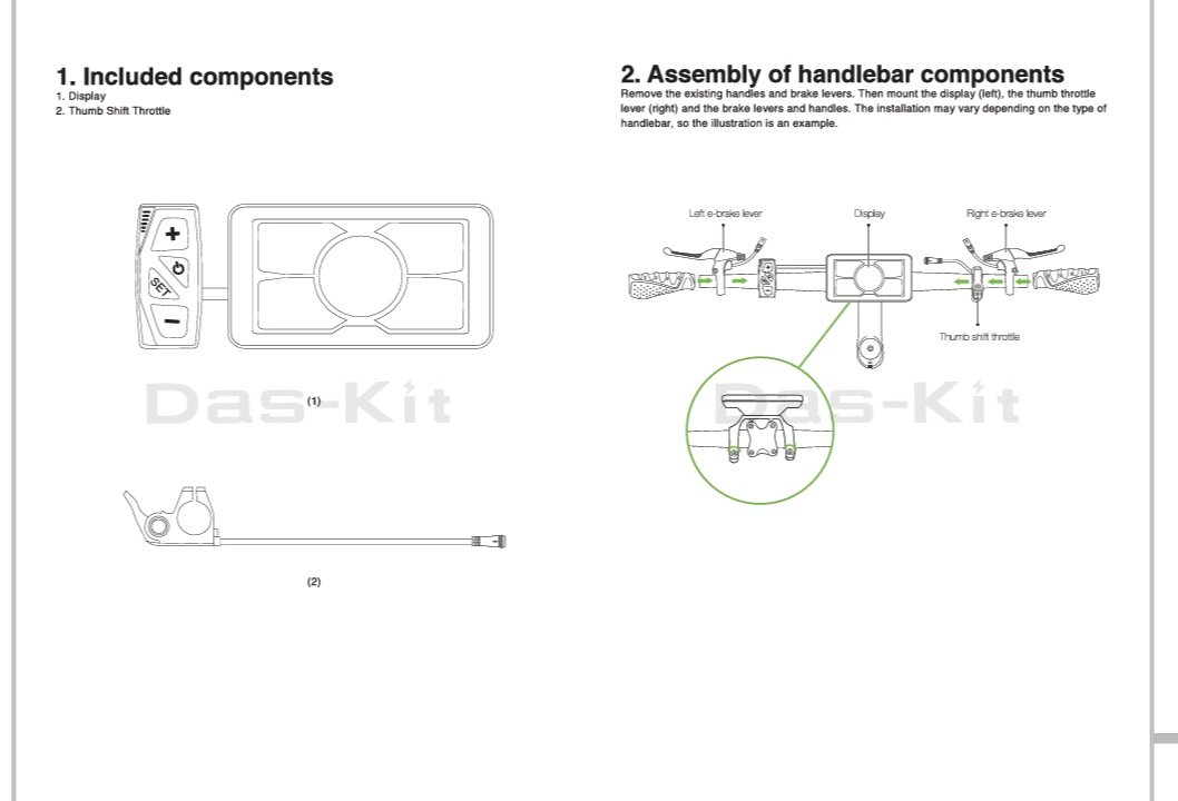

I think that bike uses the same Das-Kit as the other NCM bikes, including my Amego Infinite Plus. I haven't heard that complaint about the thumb throttle. Curious to see how the twist throttle works out for you. If you decide to part with the thumb throttle, PM me and I can take it off your hands.
OK I'll do that.
I have to wait and see if my new twist throttle works first.
Luckily I can plug it in and test it without messing with anything on the bike except unplugging the thumb throttle.
Does your ebike have the C7 display?

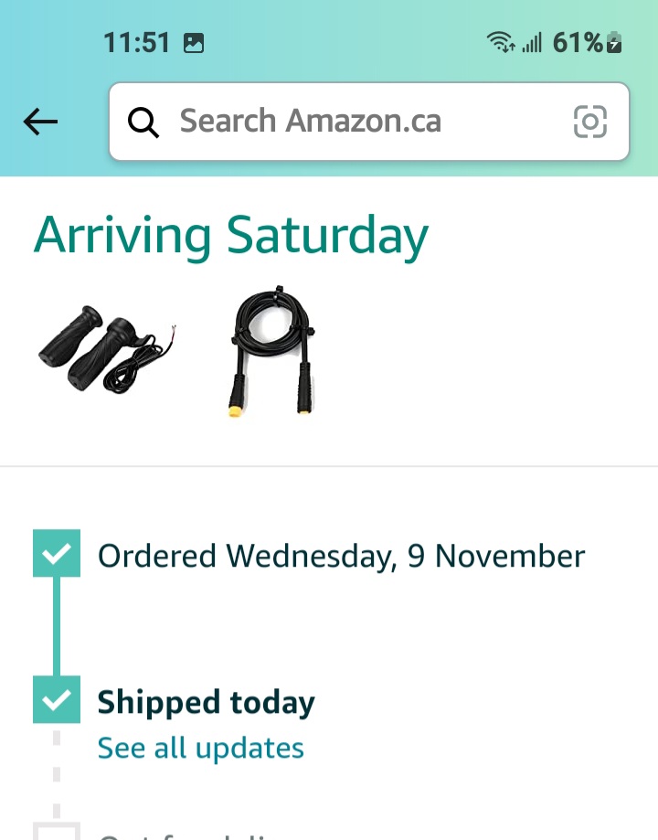

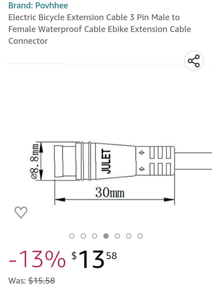

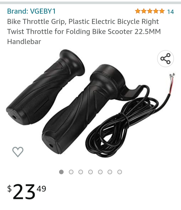

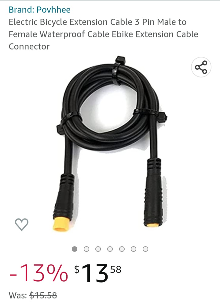

I could have bought this half twist throttle but it didn't show the dimensions of the julet plug.
Someone on a Amazon bought a throttle, but the julet plug was a bit bigger and wouldn't fit and I wanted to shorten the 17.7" cord to about 6" anyway.
I also needed to spend $5 more to get free shipping, so I bought this stuff.
Screenshot_20221110-175631_Amazon Shopping.jpgScreenshot_20221110-175622_Amazon Shopping.jpg
The throttle extension cable showed the dimensions of the plug, so I know that I have the right plug.
Screenshot_20221110-175535_Amazon Shopping.jpgScreenshot_20221110-175550_Amazon Shopping.jpg
So now I'll wait until Saturday when it arrives to see if it works.

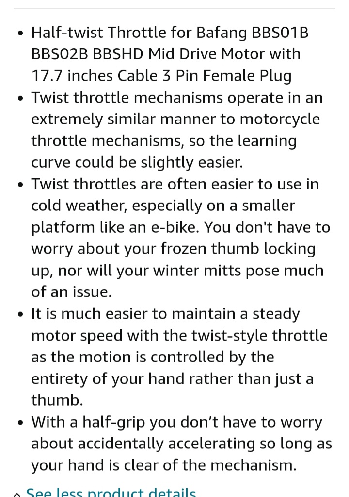

Here's what is said about the twist throttle,..
I went with the "full grip" throttle instead of the half grip.
No... it's an L7 Display, but I believe it uses the same throttle
I'm pretty sure that all displays (even BAFANG equipment) runs off 5 volts. It's kind of a standard voltage for electronics and USB devices.
The display sends 5 volts to the throttle where it goes to a variable resistor.
When you are not on the throttle the output wire is 0 volts, and as you move the throttle, the voltage slowly rises to about 4 or 5 volts.
The display uses that voltage to know where your throttle is at.
My useless thumb throttle goes from 0 volts to 5 volts with about 3 mm of throttle movement.
I thought it was just an on off switch until I stuck a piece of popsicle stick in the throttle to jam the throttle open so that I could go riding no hands at 32 km/hr and not have to pedal. Lol
It worked pretty good.
I was full throttle and full power at top speed.
I just had to hit either brake lever to disengage the power then release the brakes to go full speed again.
So yeah, I'm lazy and don't want to pedal or have my hands on the handle bars.
I drove for over half an hour with no hands today, smoking a cigarette.
So much for healthy exercise. Lol

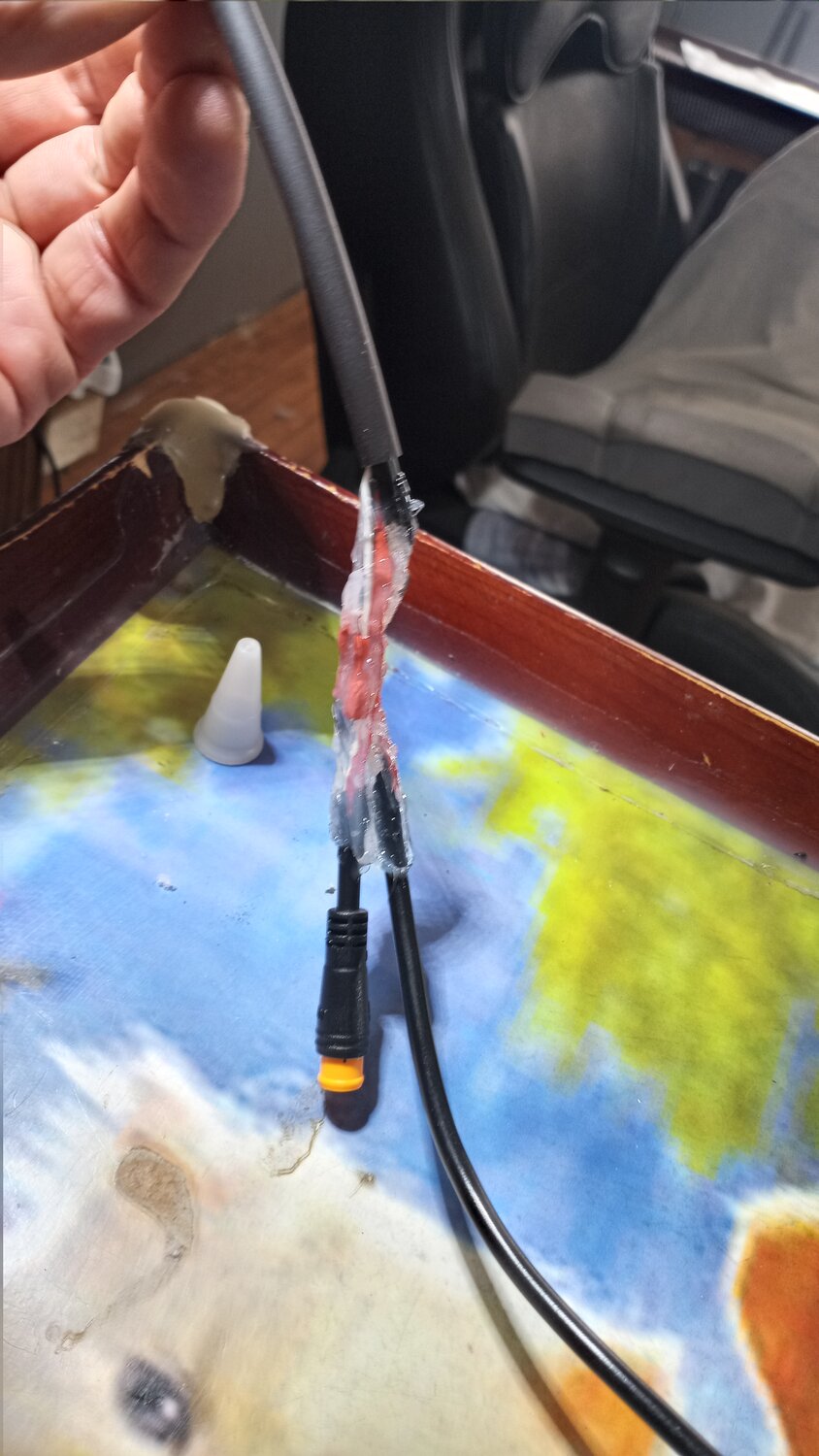

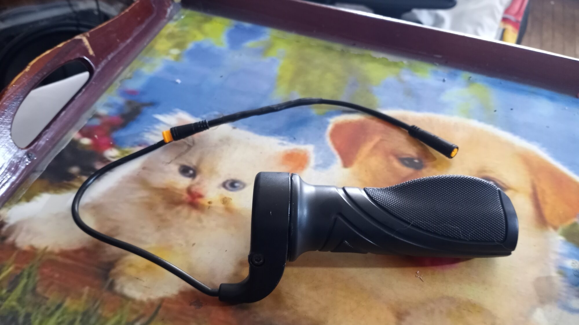

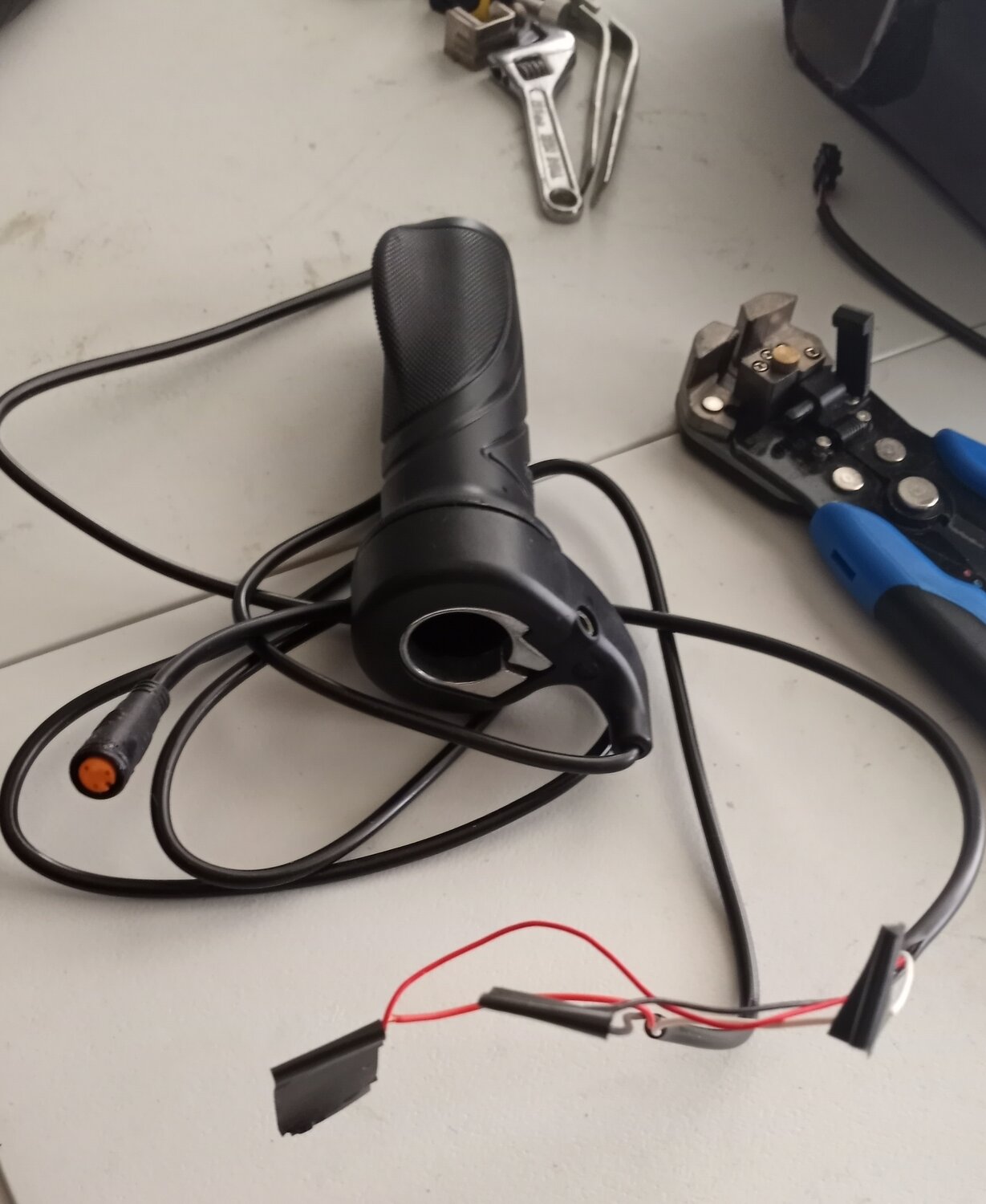

My twist throttle and extention cable arrived.
I put it together roughly and tested it, and it works.
There is a bit of twist on the throttle before it engages, then the speed climbs to max of 32 km/h, then a bit of twist left after maximum.
Now I just need to shorten the cord to about 9 inches and patch it together neatly.

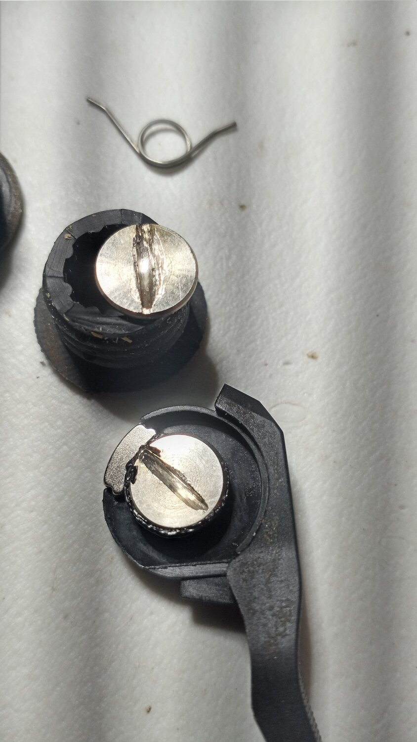

I spent a while trying to decide what I was going to do with my throttle.

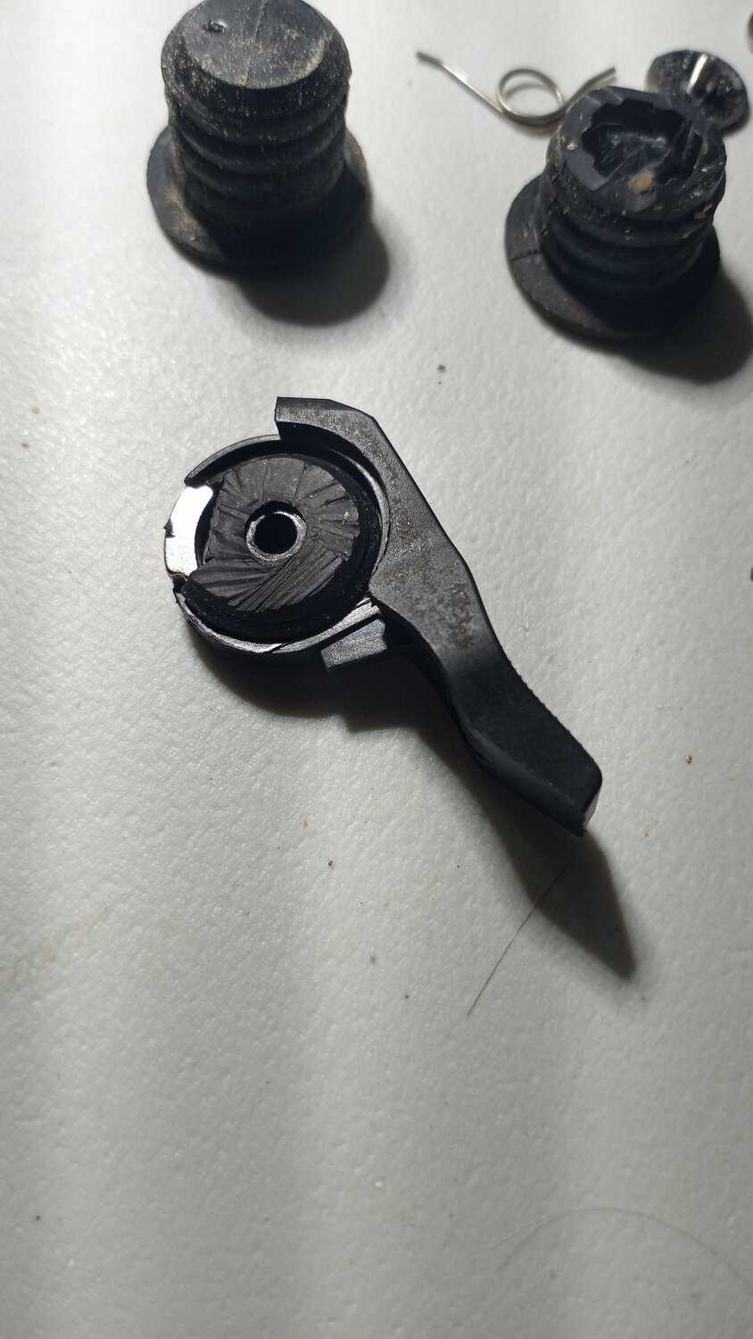

I ended up combining both my thumb throttle and my twist throttle, hooked up in parallel.

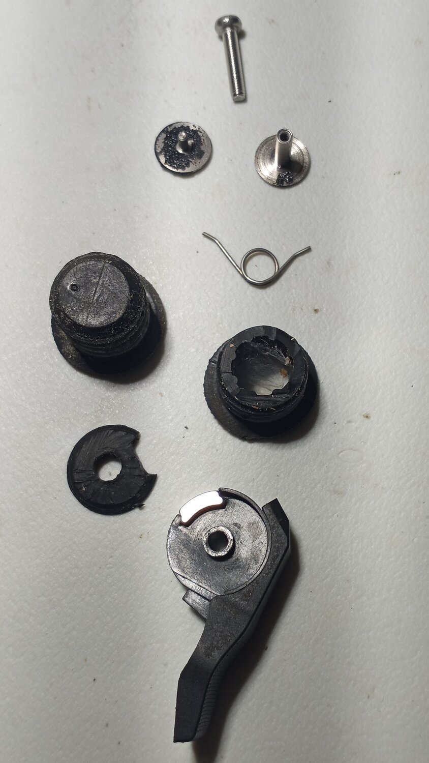

I took my thumb throttle apart and replaced the spring with a rubber washer, so my touchy throttle stays where I set it.
Now, instead of using PAS modes, I just set the thumb throttle to hold any speed that I set it to.
If I twist the throttle it overrides the thumb throttle and any PAS mode that I have it set at.
Whatever has the highest speed setting takes priority, either the thumb throttle, twist throttle or PAS mode setting.
If I have my thumb throttle set to half, I can twist the throttle to override the thumb throttle.
When I release the throttle, the speed goes back to the thumb throttle setting.
Just like cruise control in a car.
There is no problem if I have both throttles turned up. When I release both throttles, the power shuts off.

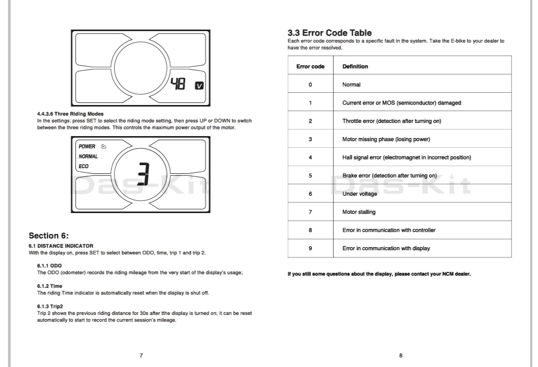

If I accidentally have the thumb throttle turned on when I turn on the bike, it doesn't start moving.
The Das-Kit logic knows that the throttle input is wrong and deactivates it.
I just push the throttle to off, then back on, and it starts working again.

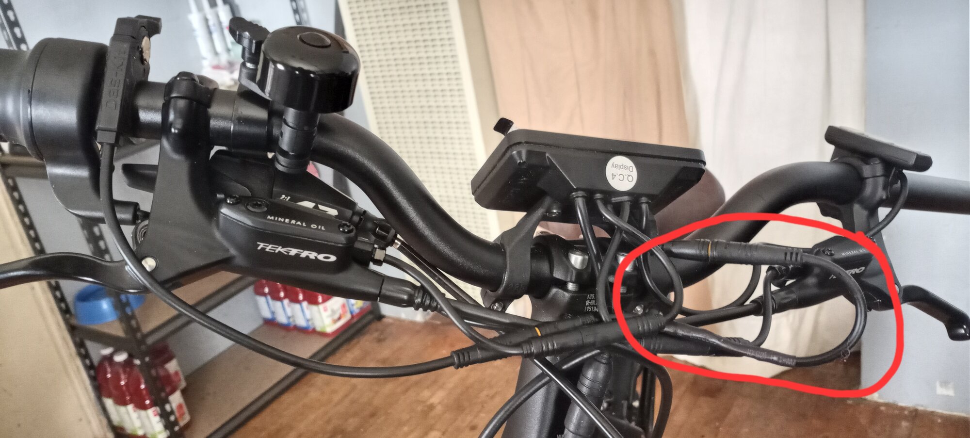

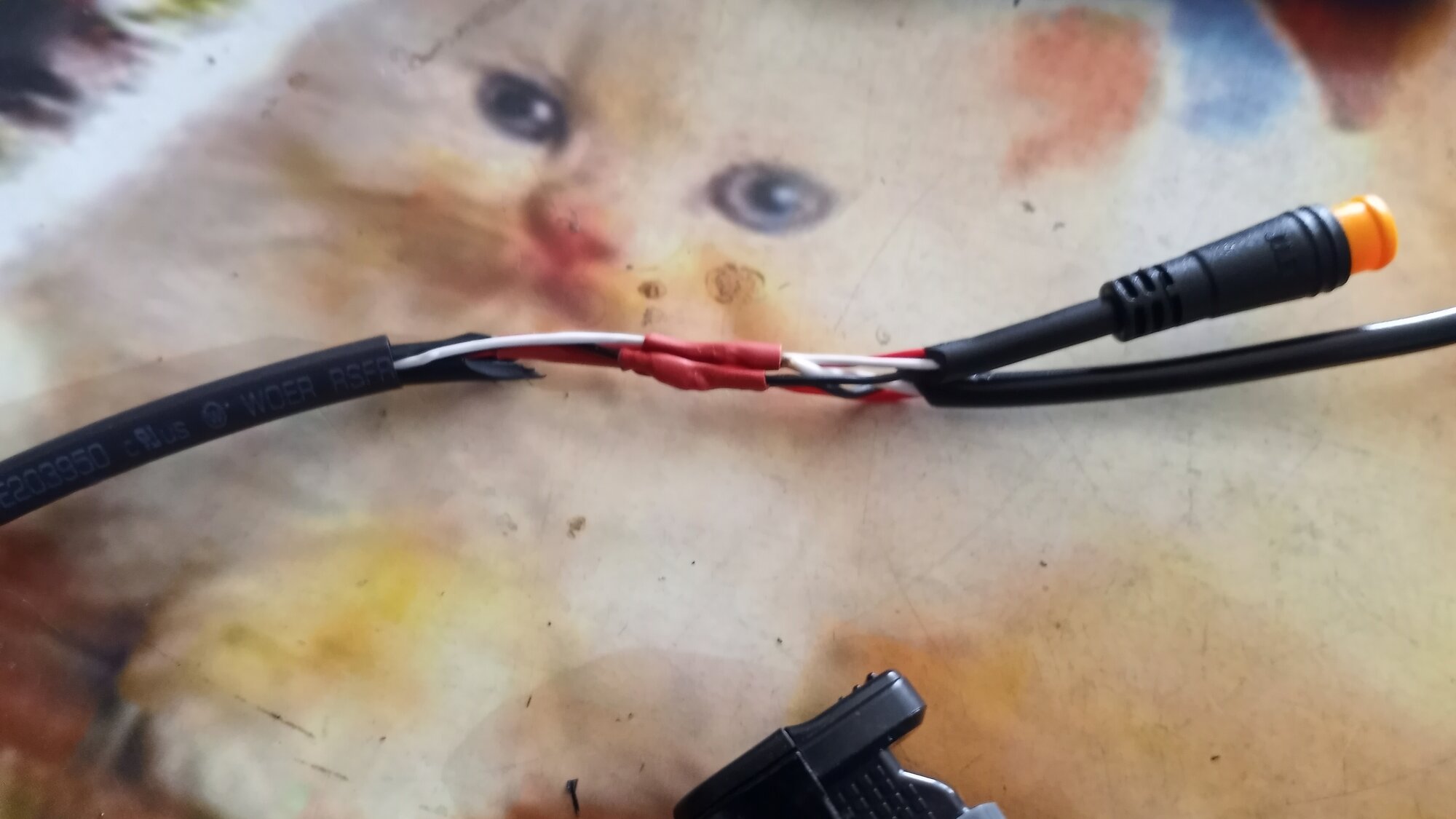

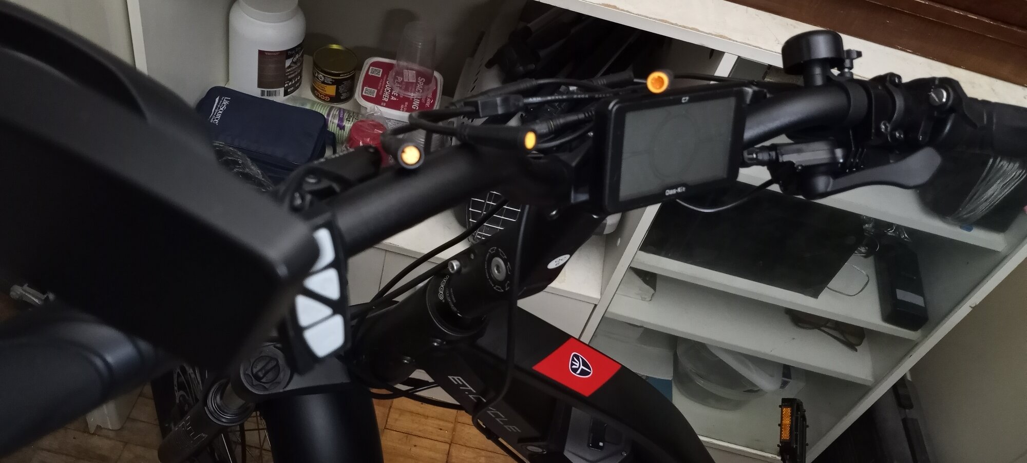

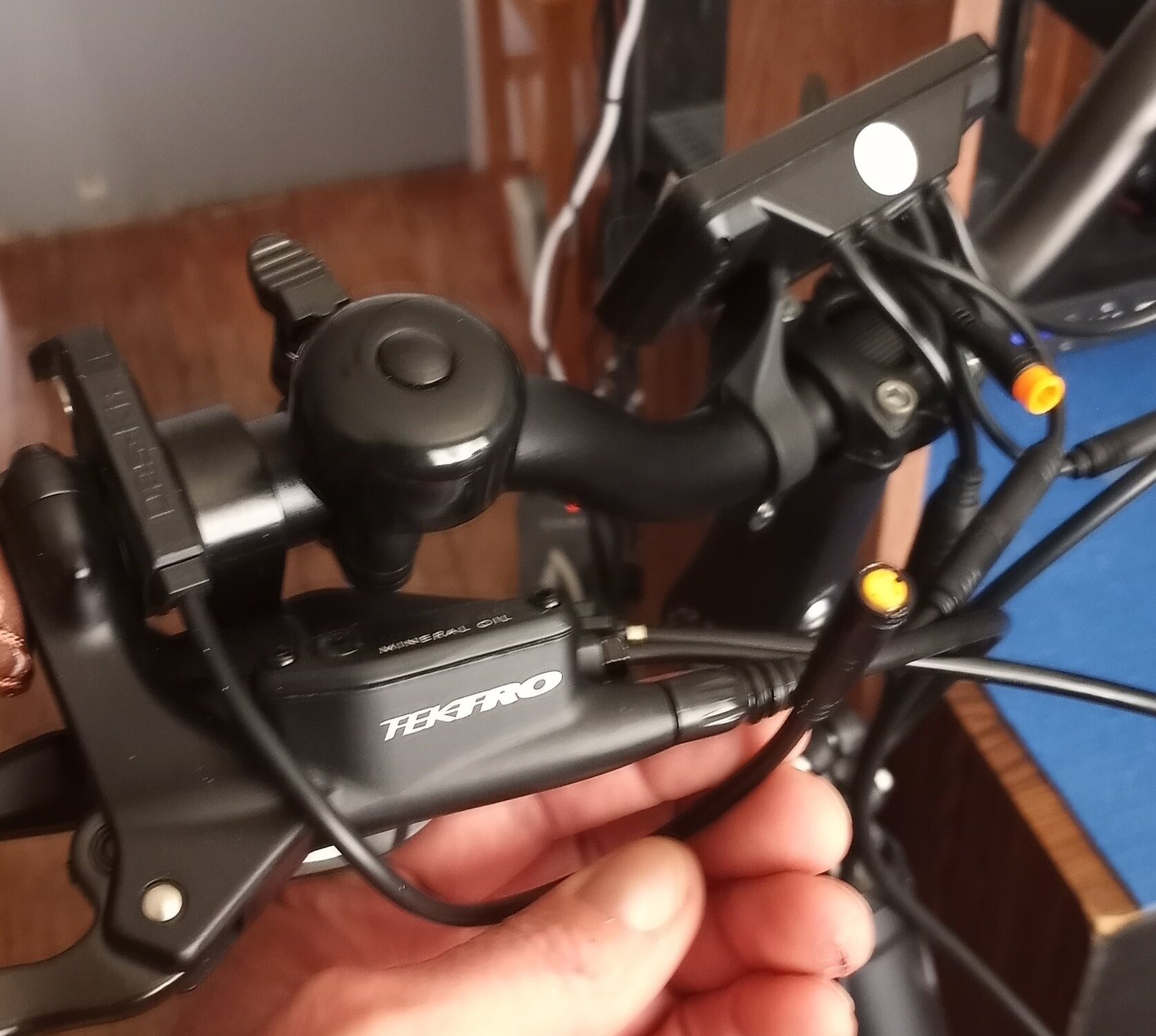

I used my throttle extension cable to make a Y connector for the throttles.
I swooped the throttle cable input to the other side of the display to give me some wire length to work with for soldering.

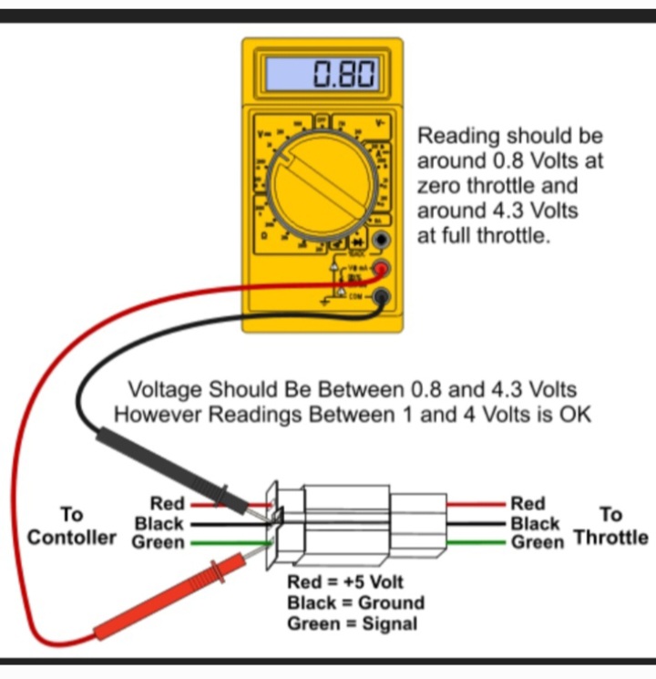

I was wrong about that.
The display does send 5 volts to the throttle, but it doesn't go through a variable resistor.
It uses a magnet moving in front of a hall sensor.
The output of the hall sensor needs to be less than 4.3 volts or more than 0.8 volts or the input signal is rejected.

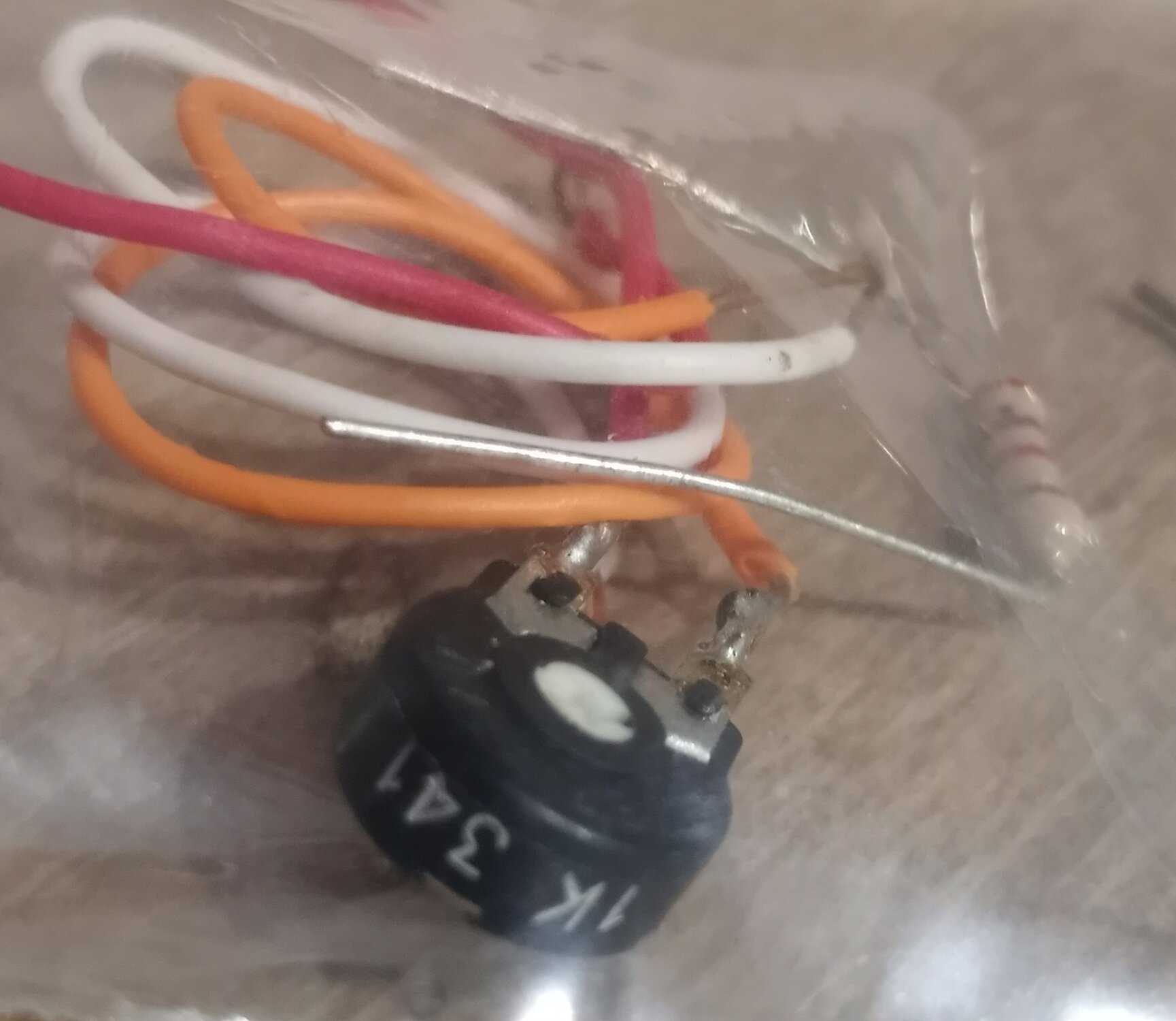

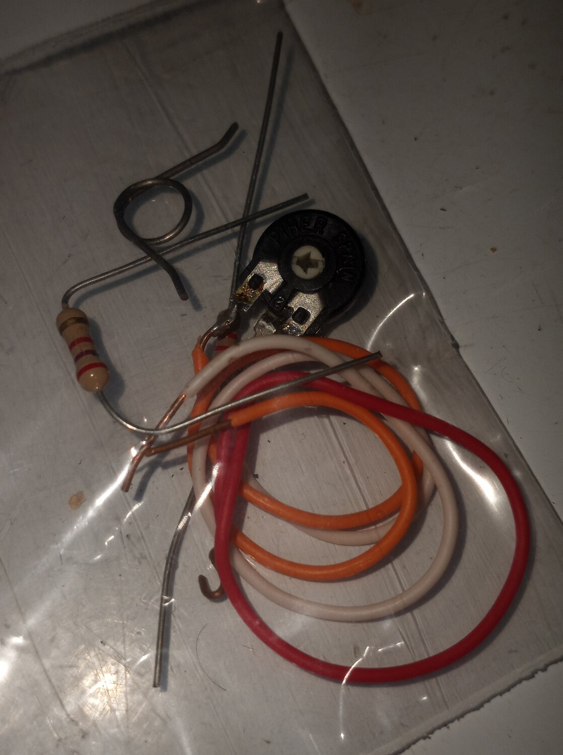

This can be emulated with resistors and a variable resistor to make a throttle.
I've got the parts, but it's only for testing purposes.
I don't want to install this on my handlebars with duct tape, silicone and coat hangers. lol

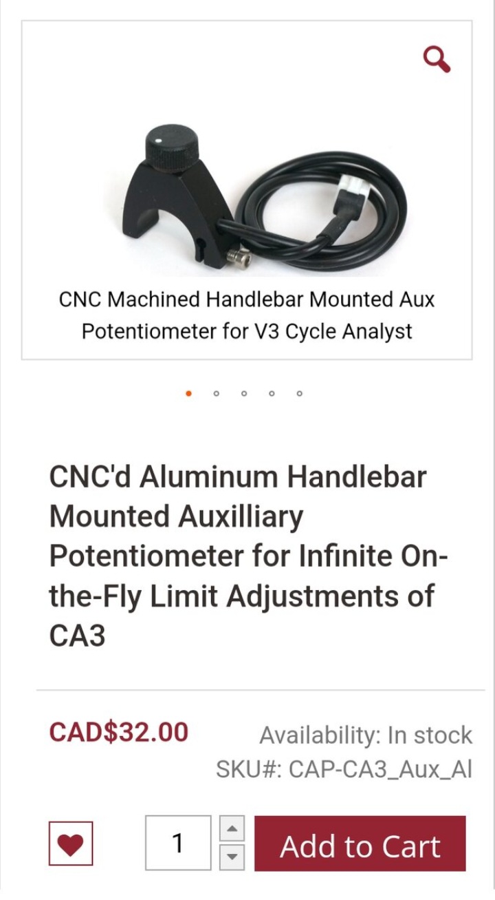

I may in the future get myself one of these to replace my sticky throttle?
I decided to buy the $32 auxiliary potentiometer but there is $26 for shipping and then with tax, it would cost over $65.
I'll just use my sticky throttle.

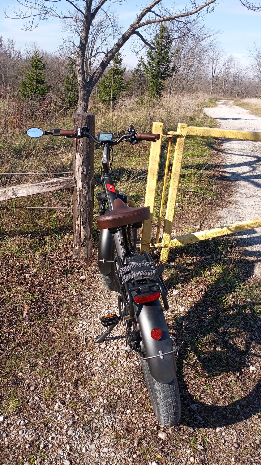

Finding places to ride,..
Just lift it up over the fence.
A guy on a gas powered dirt bike drove his bike past me just in front of the fence.
I jumped the fence and joined him.
There's a trail and huge hills on the other side.
I was more than 20 km from home when I went into the dirt.
I made it home with plenty of battery to spare.
Me too.
I'm not supposed to trespass apparently, but a gas dirt bike just passed in front of me.
I lifted my handlebars over the fence and joined them.
It was awesome, and my bike climbed like a beast.

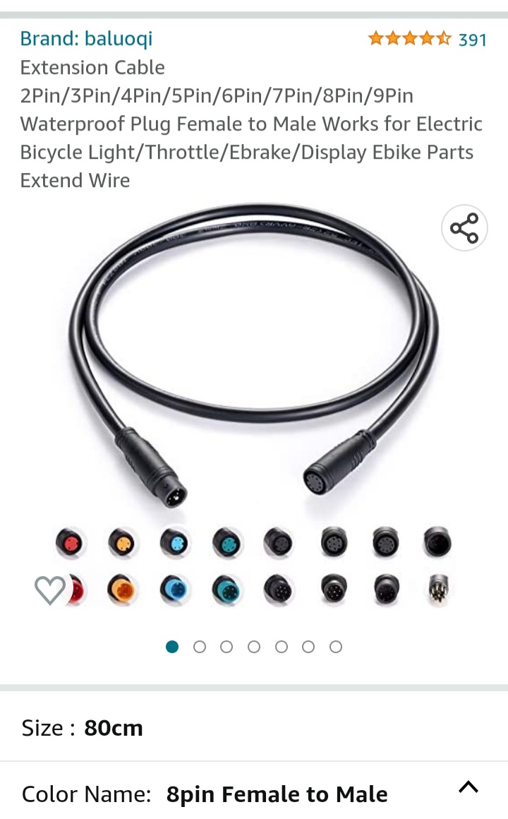

I'm going move my sticky throttle to the left side of the handlebars and install a switch for it.
I was thinking of tying the switch into the brake cutoff switch, but then realized that it would kill the motor all the time, so I decided that im going to splice it into the throttle cable to turn off only the sticky throttle.
I bought a 3 pin Y connector to make a new connection for the left hand side.
I bought the 8 pin cable and 2 pin Y connector just to have them.

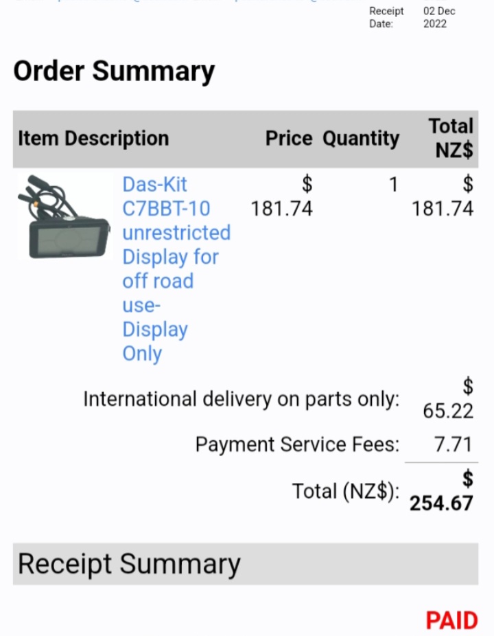

I was considering the C7 display from Amego, but it cost $140, plus $25 shipping, plus the tax on both, for a total of $186.
For $68 more I got the Off-road display.
Now I can turn my ebike down to Eco mode, and I won't have the lag when I stop pedaling or start pedaling in PAS modes.
