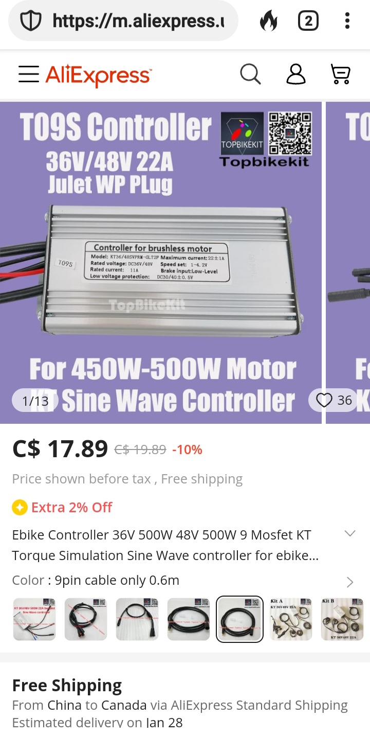

It's a sine wave controller, and it's a Torque Simulator as well, which I understand means that it is power/current based, not speed based?
And it's only $17.89 !!
A Das-Kit Controller is $190.00!!
And I just spent $250 on a useless Das-Kit Off-road Display.
I was thinking of waiting for my warranty to expire but at these prices, I think I might just go for it, especially if it is plug and play with all the necessary connectors.

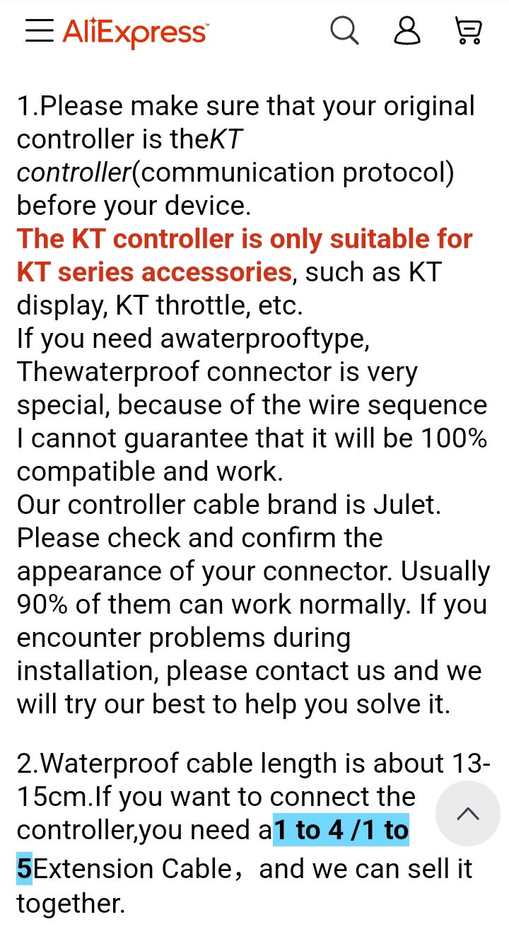

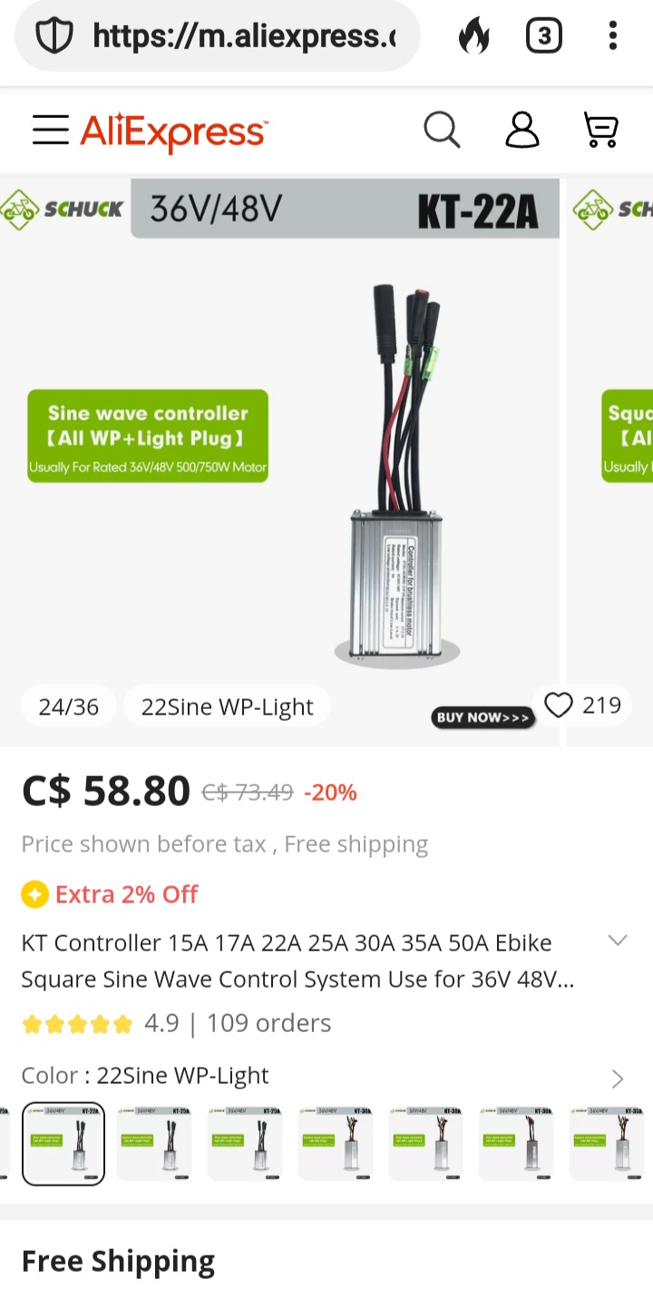

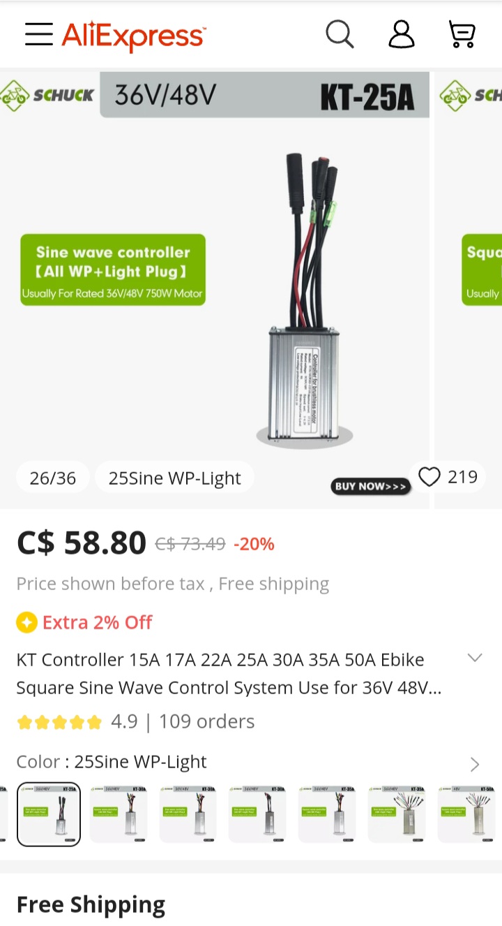

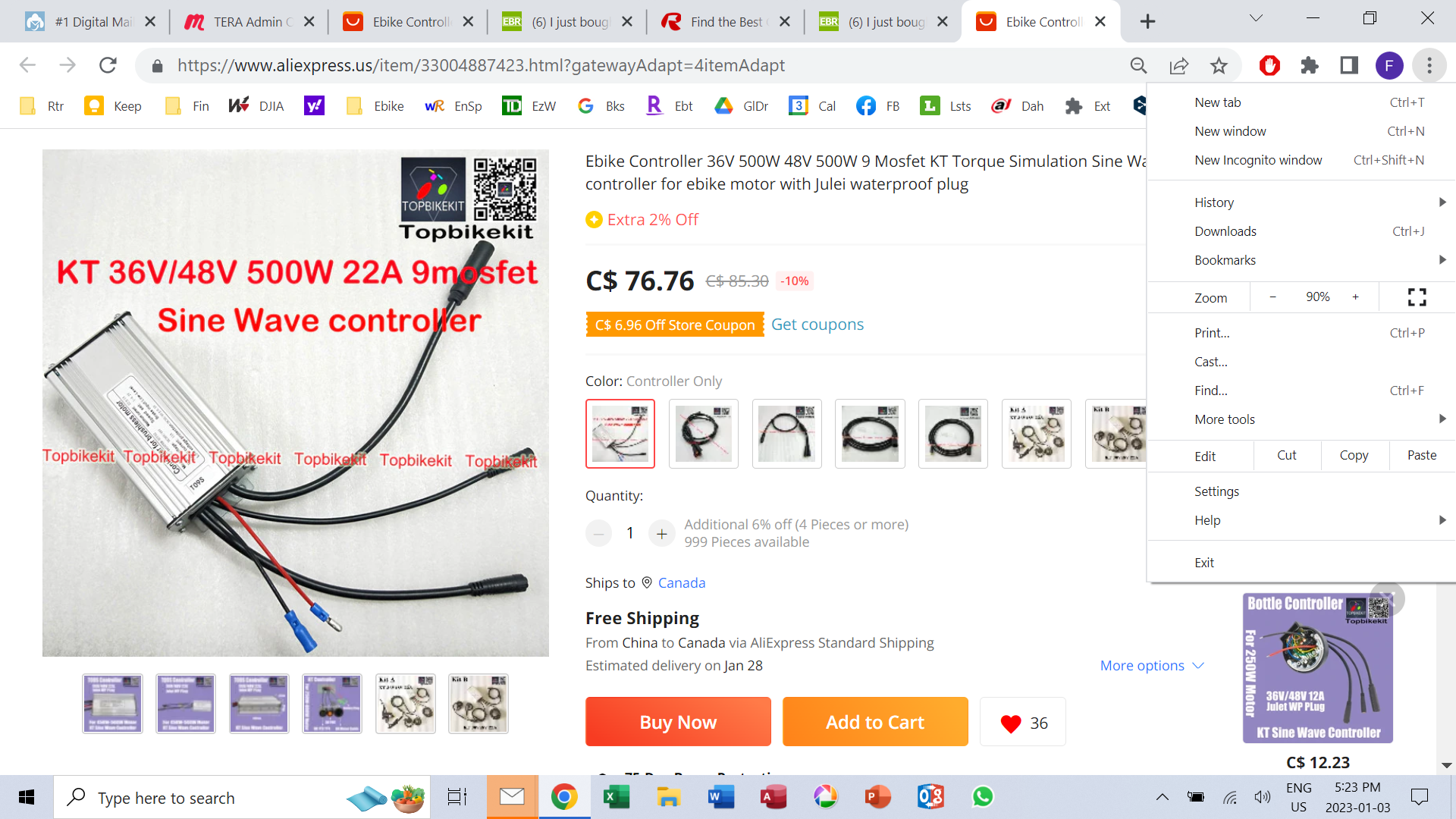

When I go to that site, I see a price of $76.76Cdn for the controller. I think that lower price is just for one of the cables?
Yeah, I couldn't use the link properly but when I access aliexpress on a separate page, then I can search.
Now I get this,.. (but duck duck go says it's unable to open this kind of link ??)
I need to figure out the different controller and display options.
I don't mind reducing the power to avoid overheating anything and to increase my range.

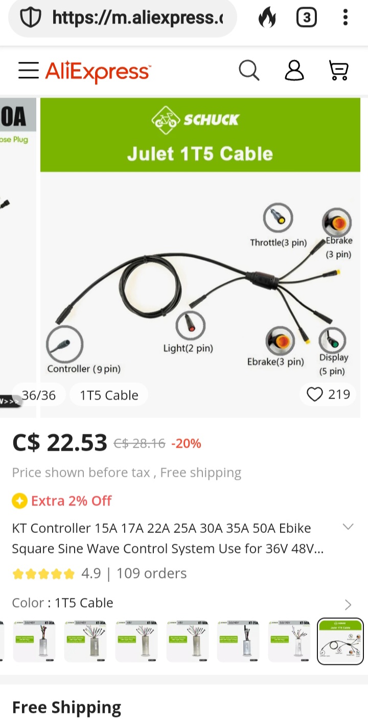

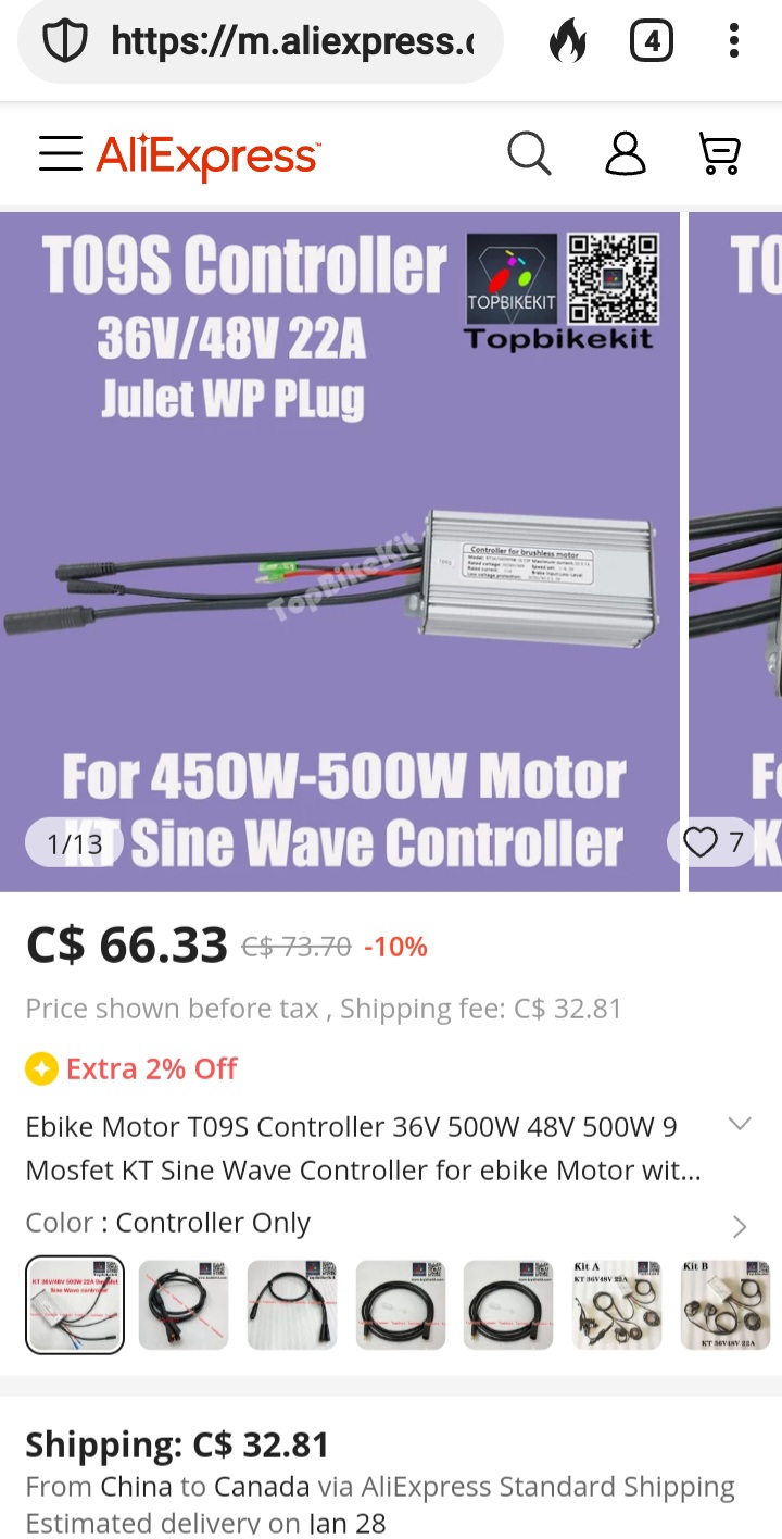

I've been doing some searching and came up up with this stuff,...
Being as I can apparently turn the power of the controller down to half, the 25 amp controller might be best?
With it turned down, I won't be over powering or heating up the controller.
But I also found this,..

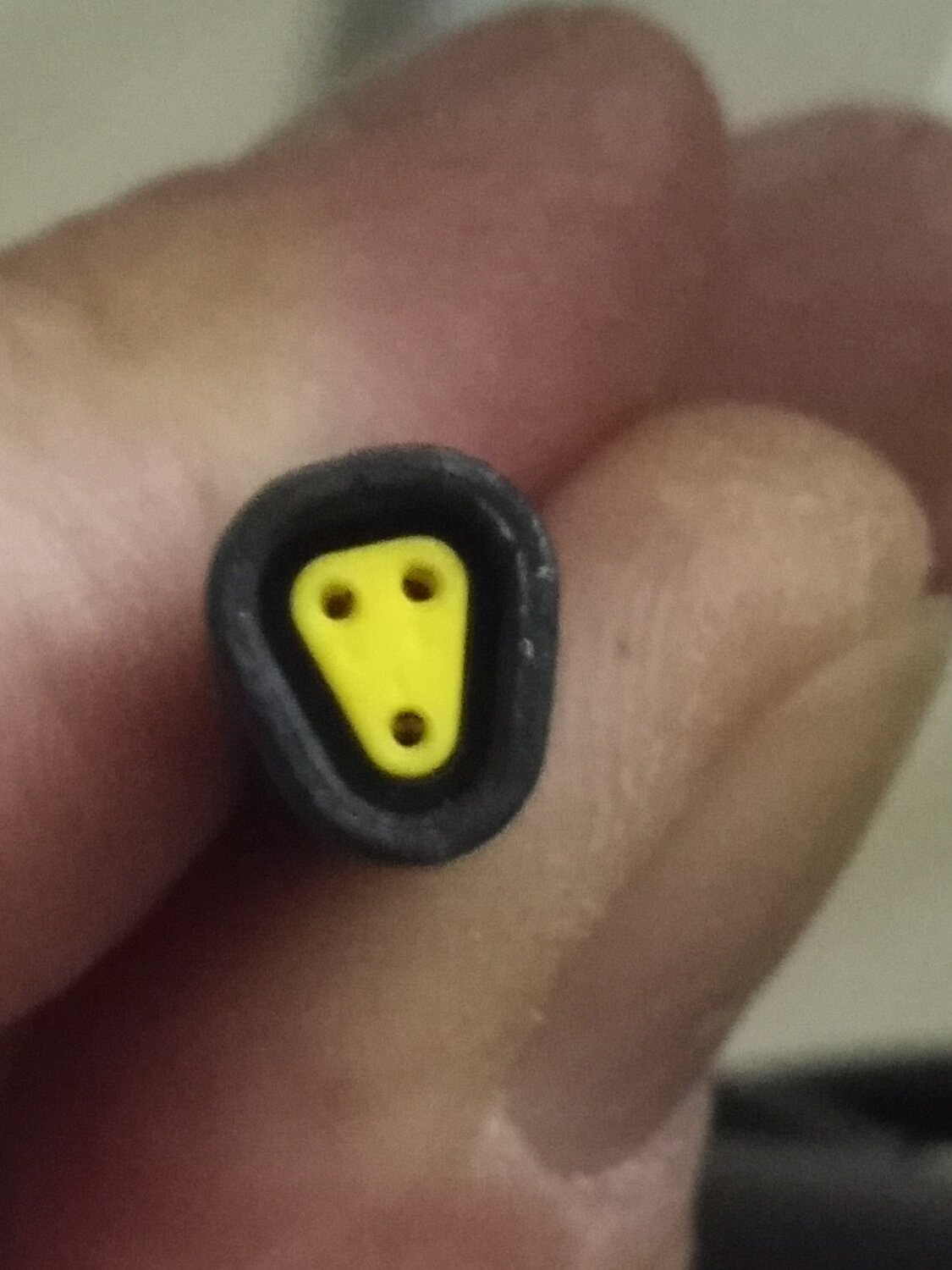

I'm guessing that Das-Kit has the pin orientation changed and it might be a different Julet plug?
And this is a cable to connect the controller,..

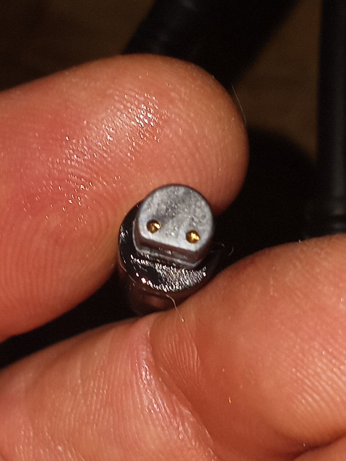

It's got 3 pin brake cutout switch connectors, and my brakes are a weird 2 pin Julet connector.
I can splice into the cable, but I don't know if I can splice a two pin into a three pin connection?
I think my brake switch is just an on off switch, and the KT controller uses a 3 wire HAL sensor.
Perhaps a couple simple resistors can emulate the hall sensor and get my 2 pin brake switches to operate?
I can figure out how to wire up a 2 wire light connector to my 3 wire light.

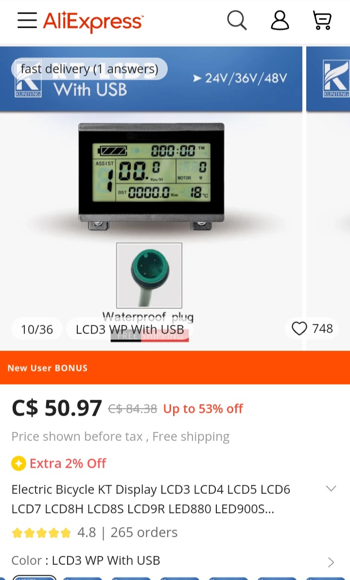

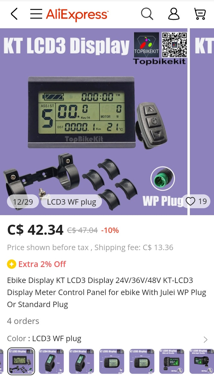

And I'm kinda liking this display,..
It's got a Watt meter which is something that I'm interested in monitoring.
It's USB.
I don't know what that means, and I would need to use my original button pad and I don't know if it's connect able?
There is this option, but I kinda want a Watt, volt or current meter.

I found this,..
It's pretty much what I want.
Wow !! There's a lot of stuff out there on AliExpress for e-bikes.

Sometimes Amazon have a better description of the same product (and sometimes, but not always a good price)....Here's an example:
it even shows a pic of the USB connection, but still not clear what it's for..maybe the keypd as you suggest?

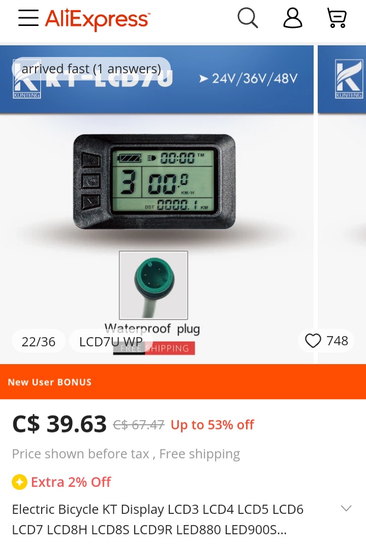

It looks like I need to get the LCD8H color display to be able to turn down the maximum power of the KT controller.
It also allows for A LOT more adjustments of A LOT more parameters as well. In fact maybe too many. Lol
I don't have to mess with too many of the settings but it would be nice to enter the motor parameters if I ever find out what the hell they are? Lol

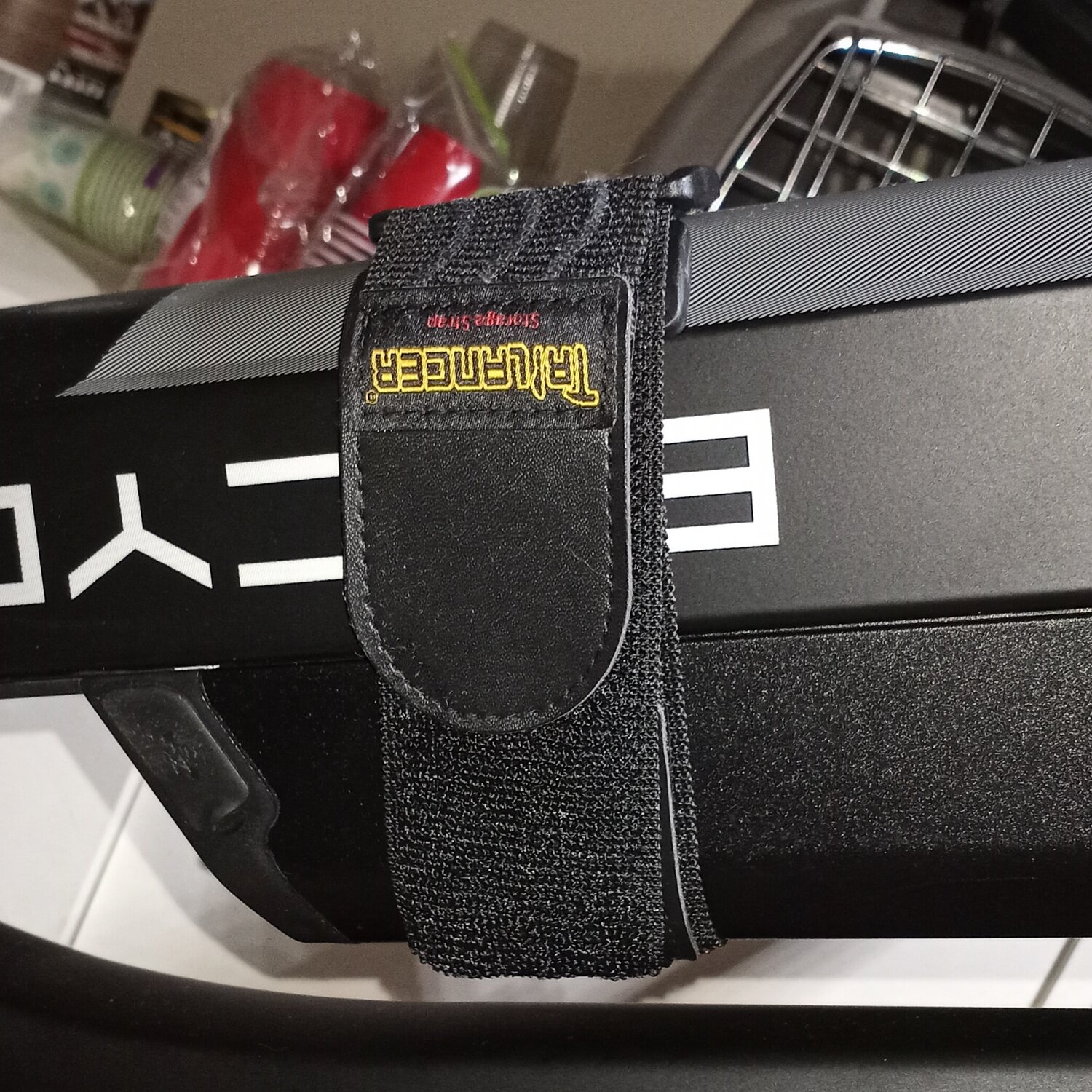

The battery is still bouncing around.
A heavy battery needs a heavy duty clamp.
I'm going to keep strapping down the battery so it doesn't break.

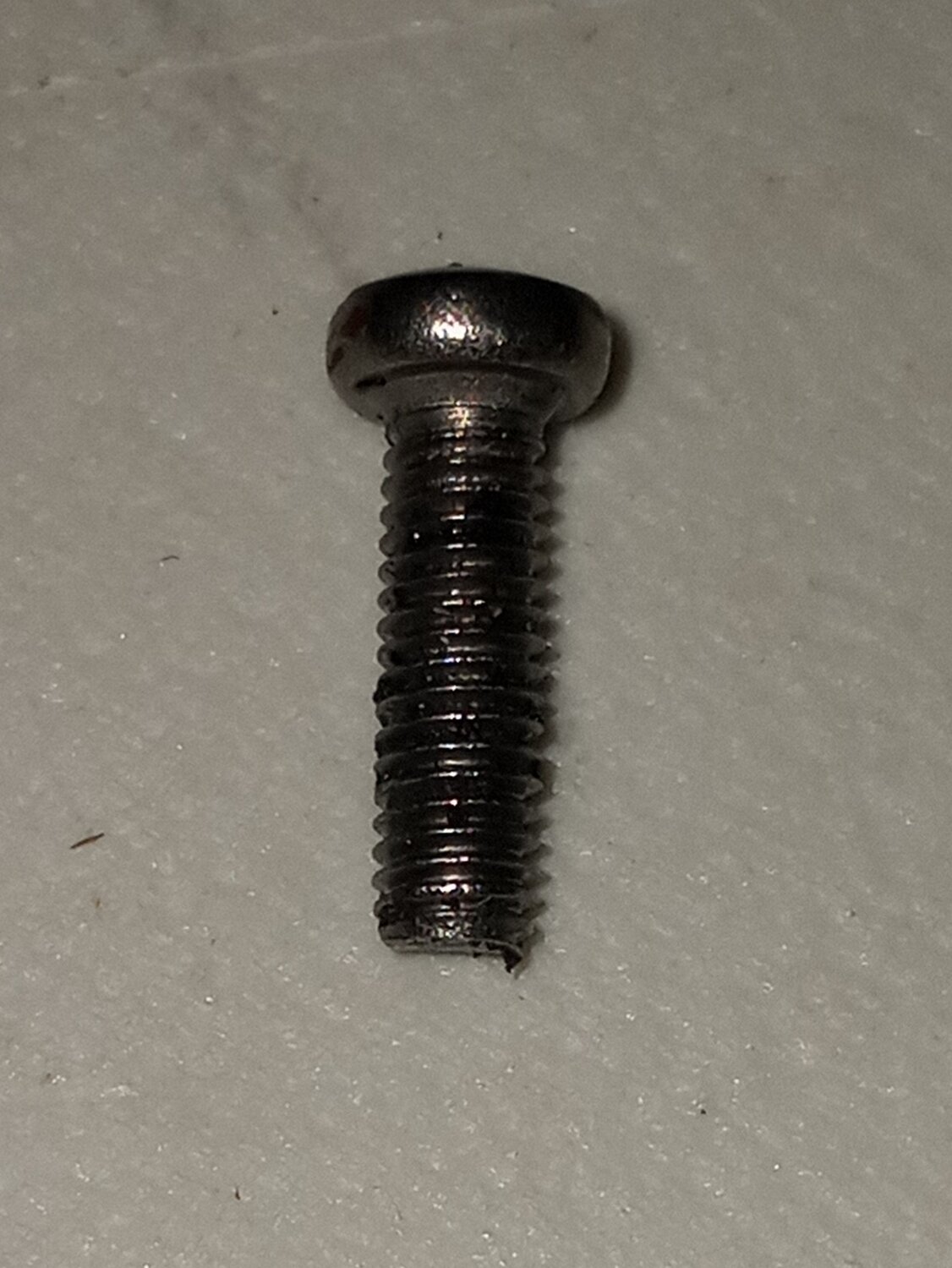

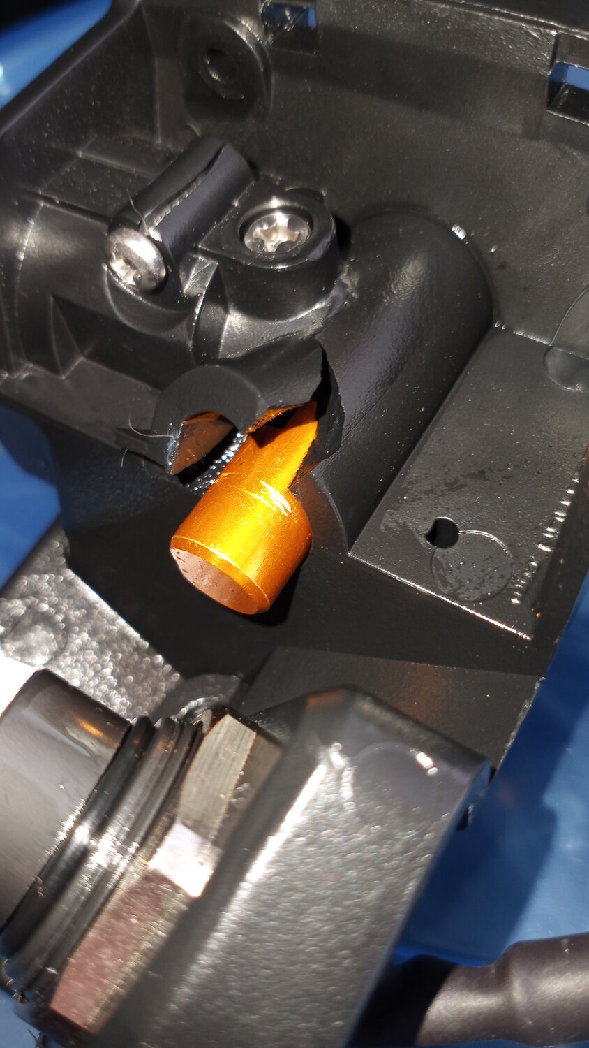

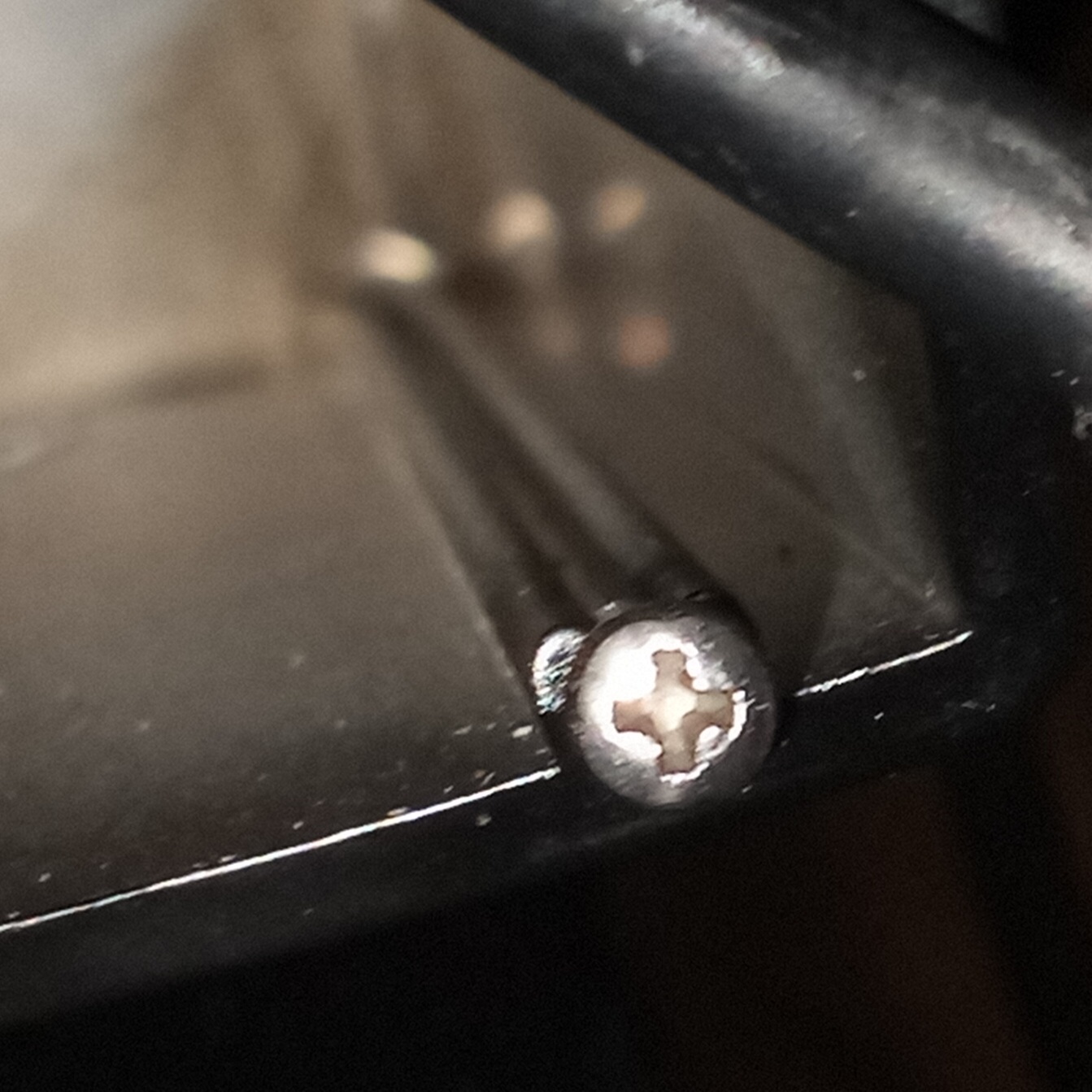

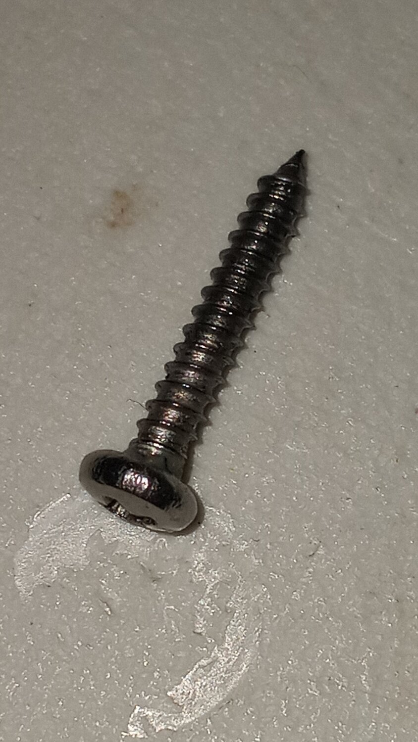

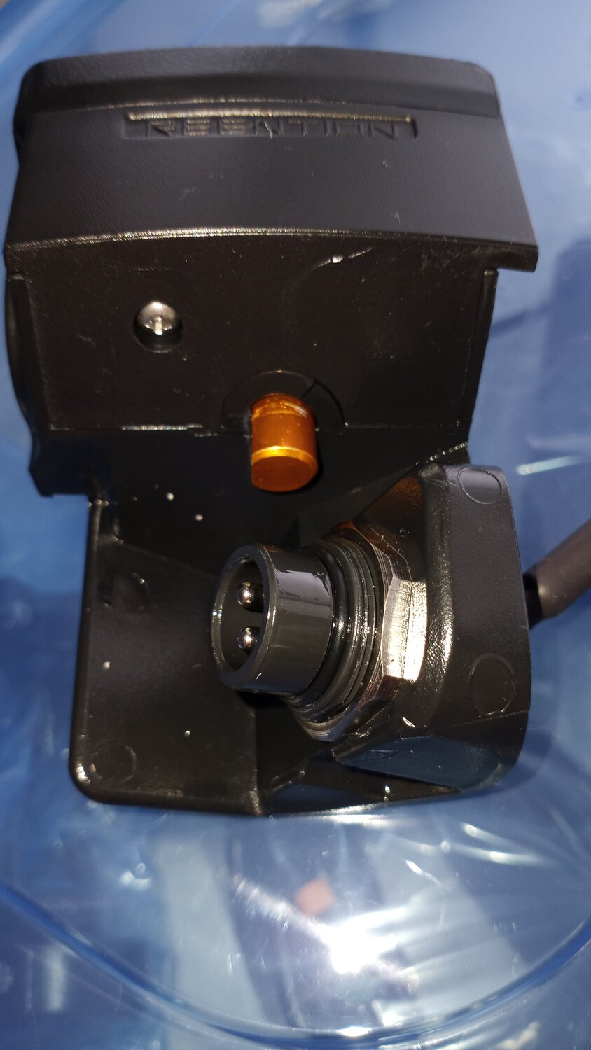

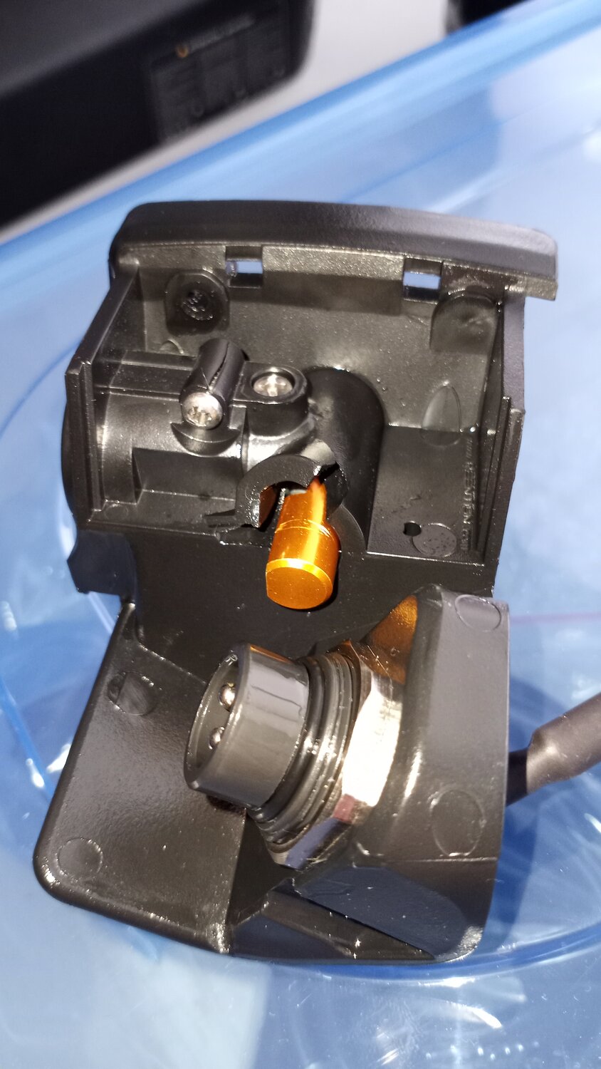

A bit of an update about the reention battery bracket,..
I realized that the screw I tightened up wasn't holding the bracket on to the frame.
It's holding on a cover that has another screw underneath that is holding the bracket to the frame, and it had come loose as well.
The screw that holds the cover on had cracked it's mounting hole and the plastic was broken around locking pin.
The bracket is roughed in for a second screw but ET.CYCLE decided not to use a second screw.
The top bracket is held on by a single machine screw into a threaded hole in the frame, and a single "wood screw" threaded into an aluminum "channel".
So the most expensive part of my e-bike is held on by two little screws, one of which loctite has no effect.
I'm certainly going to keep strapping down my battery.
My bike isn't designed to go over ANY kind of bump at all.
I would recommend replacing it with a cotter pin same diameter that goes all the way through the hole and lock it in place.
The machine screw is OK and holds with loctite but I don't think locktite has any affect on the other screw.
Why couldn't they weld on a metal tab then drill and tap it to use a proper machine screw.
That aluminum channel is useless.
The whole reention battery bracket is a bad design.
I might drill through the bracket and into the frame and either tap the hole or drill right through the frame and bolt it on.
I don't care what it looks like, I don't want my damn battery falling out.
The strap does work.
The battery can't bounce which should help keep the screw from vibrating loose.

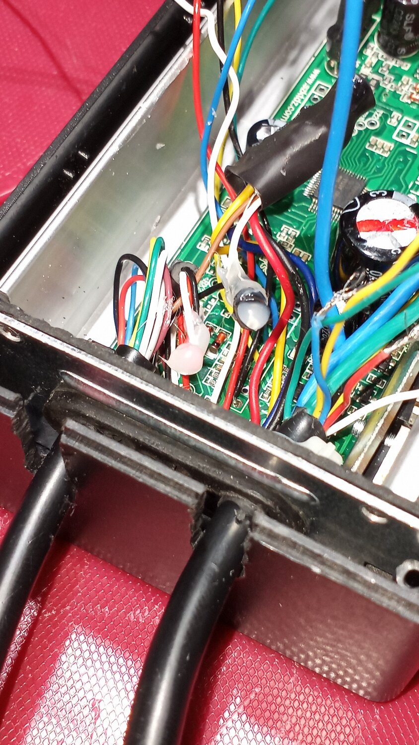

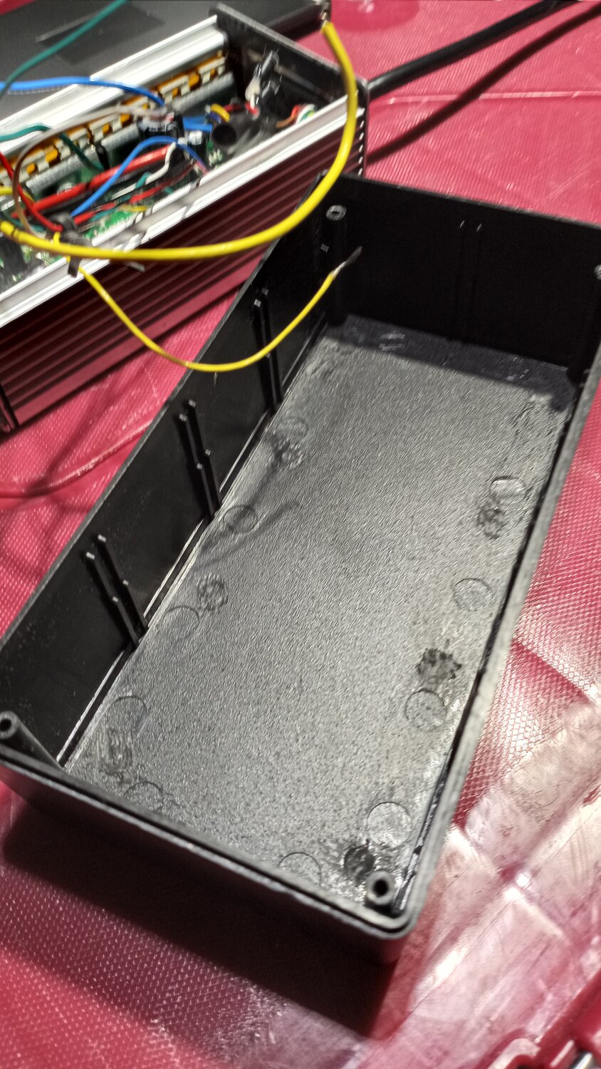

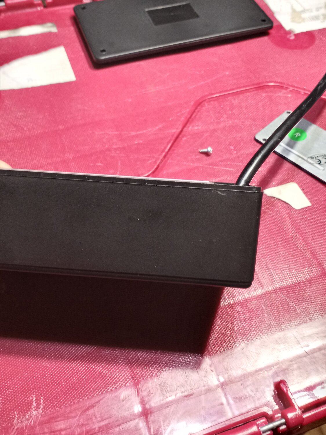

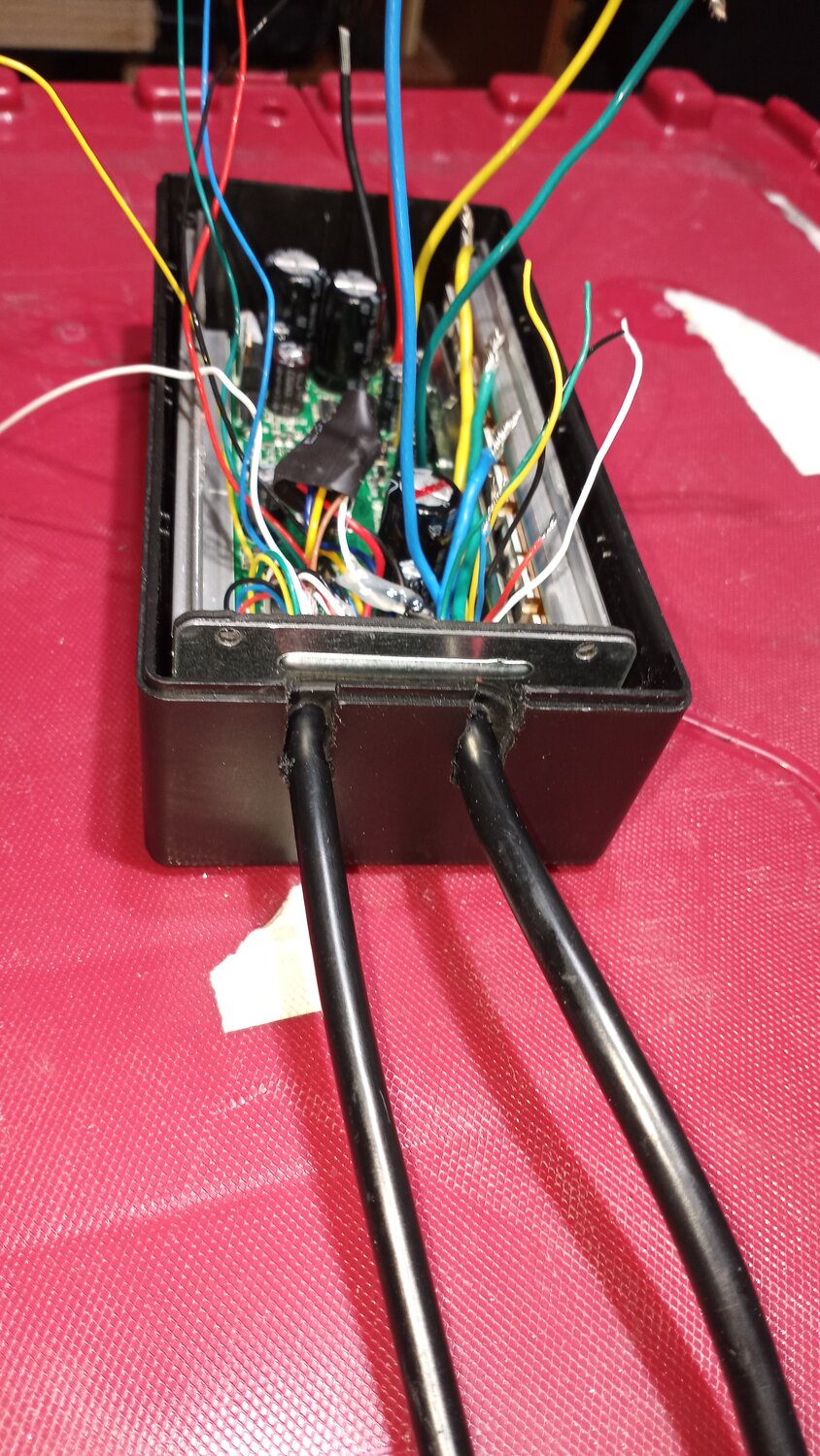

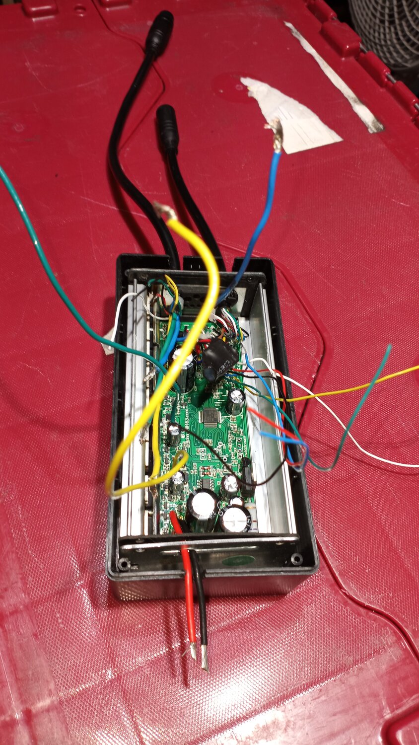

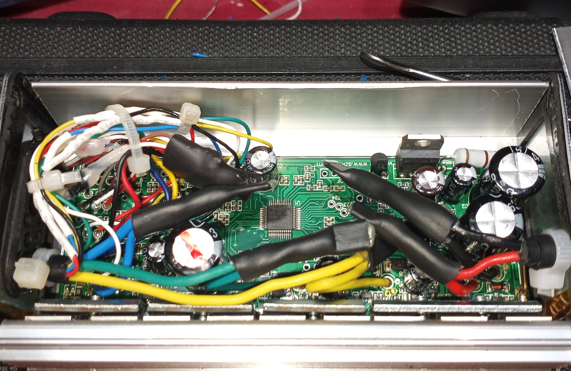

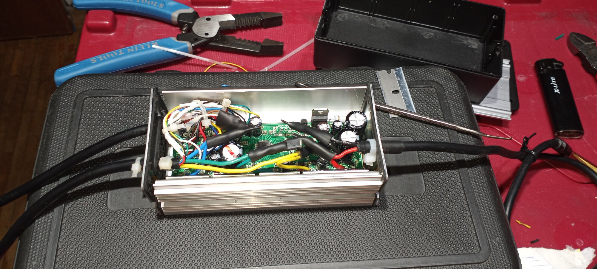

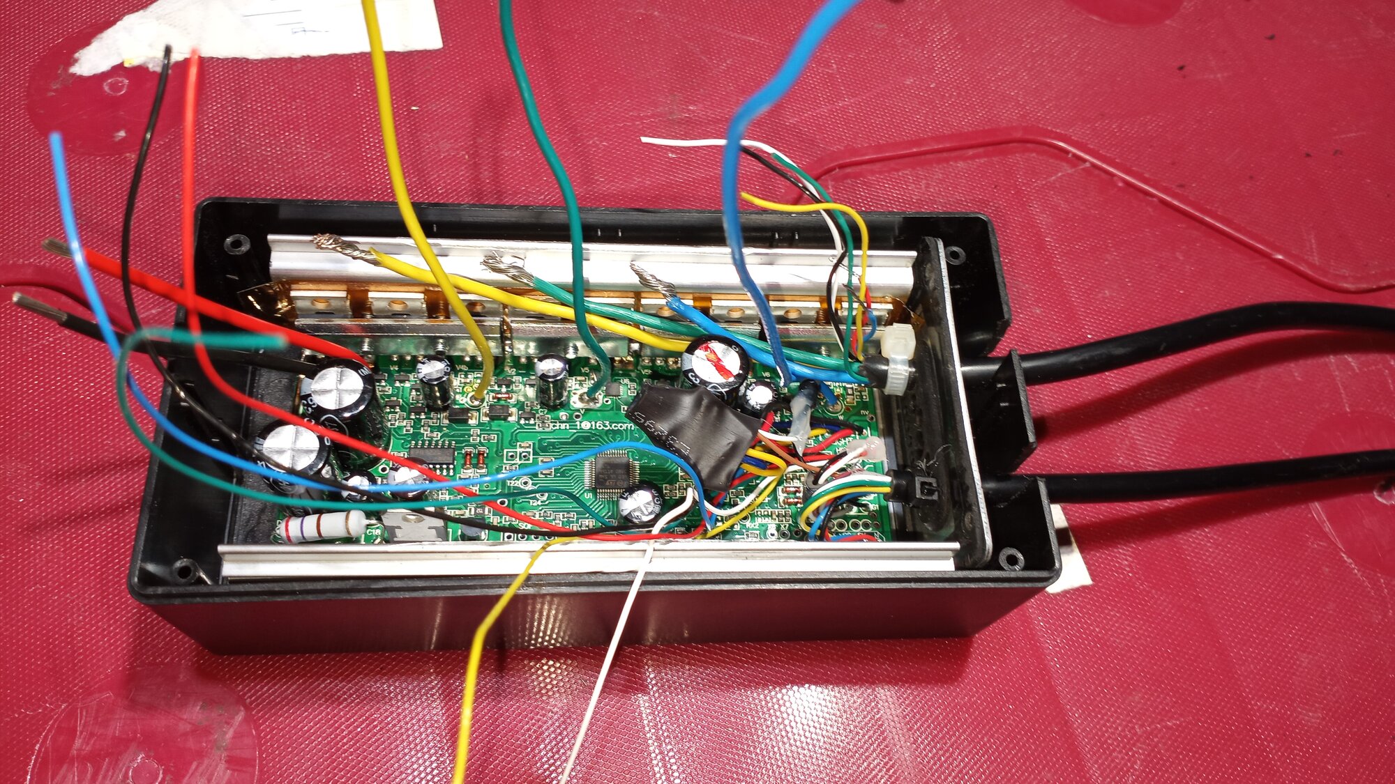

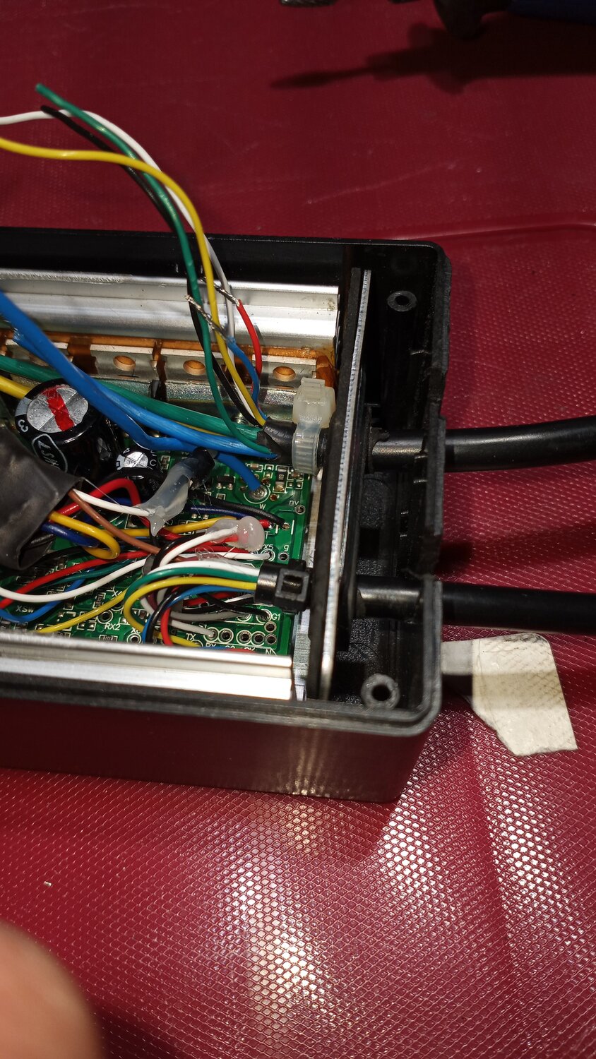

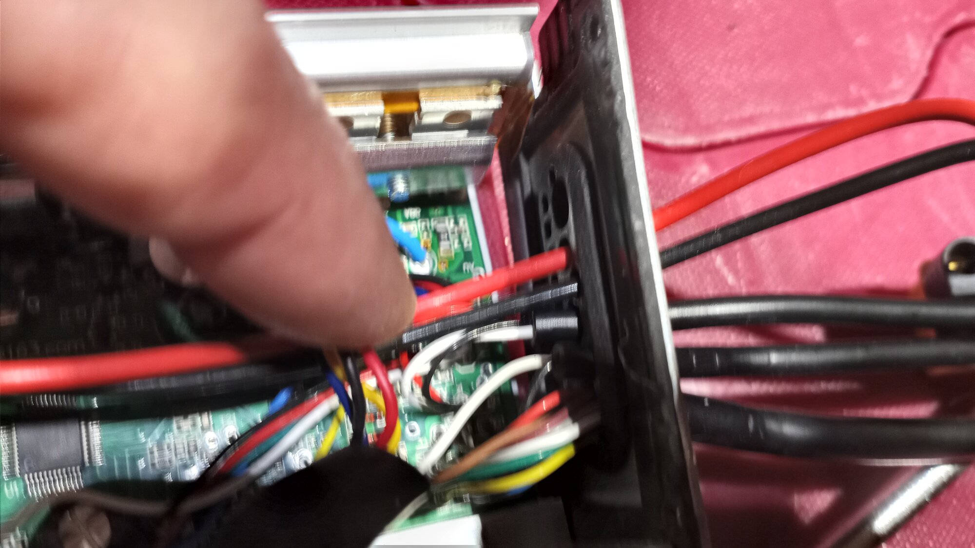

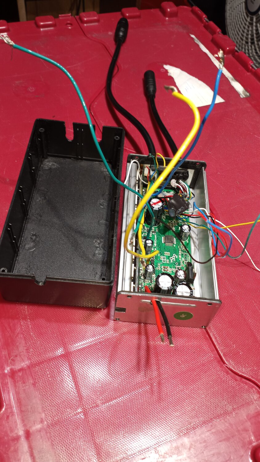

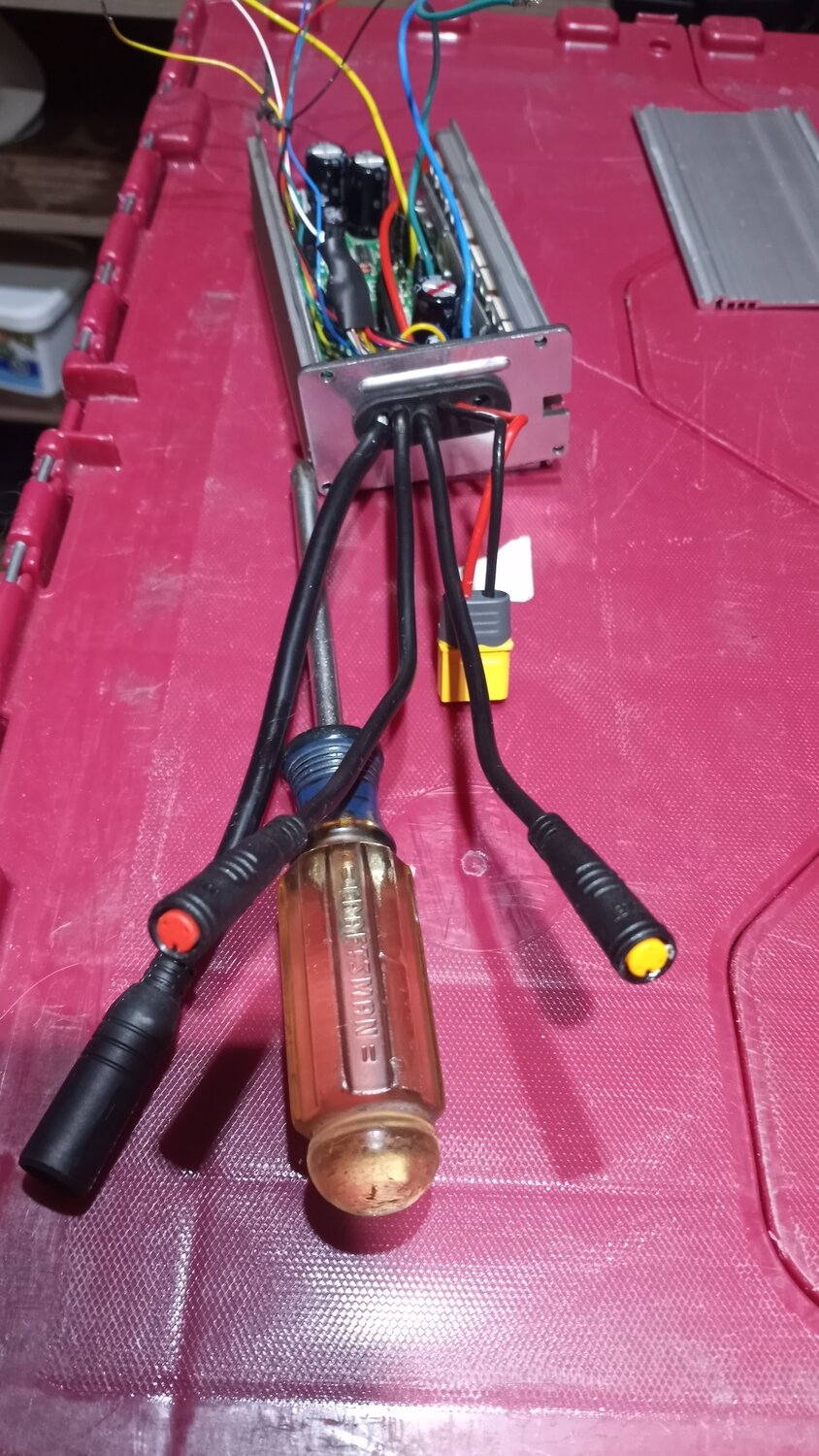

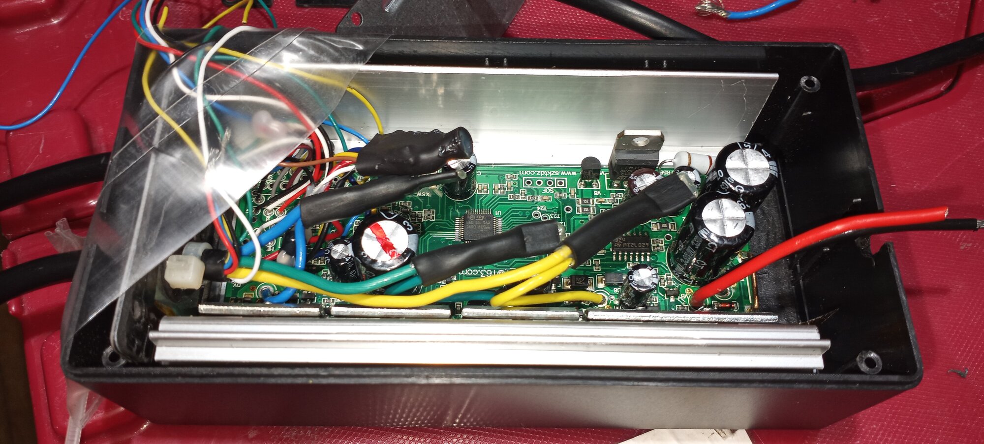

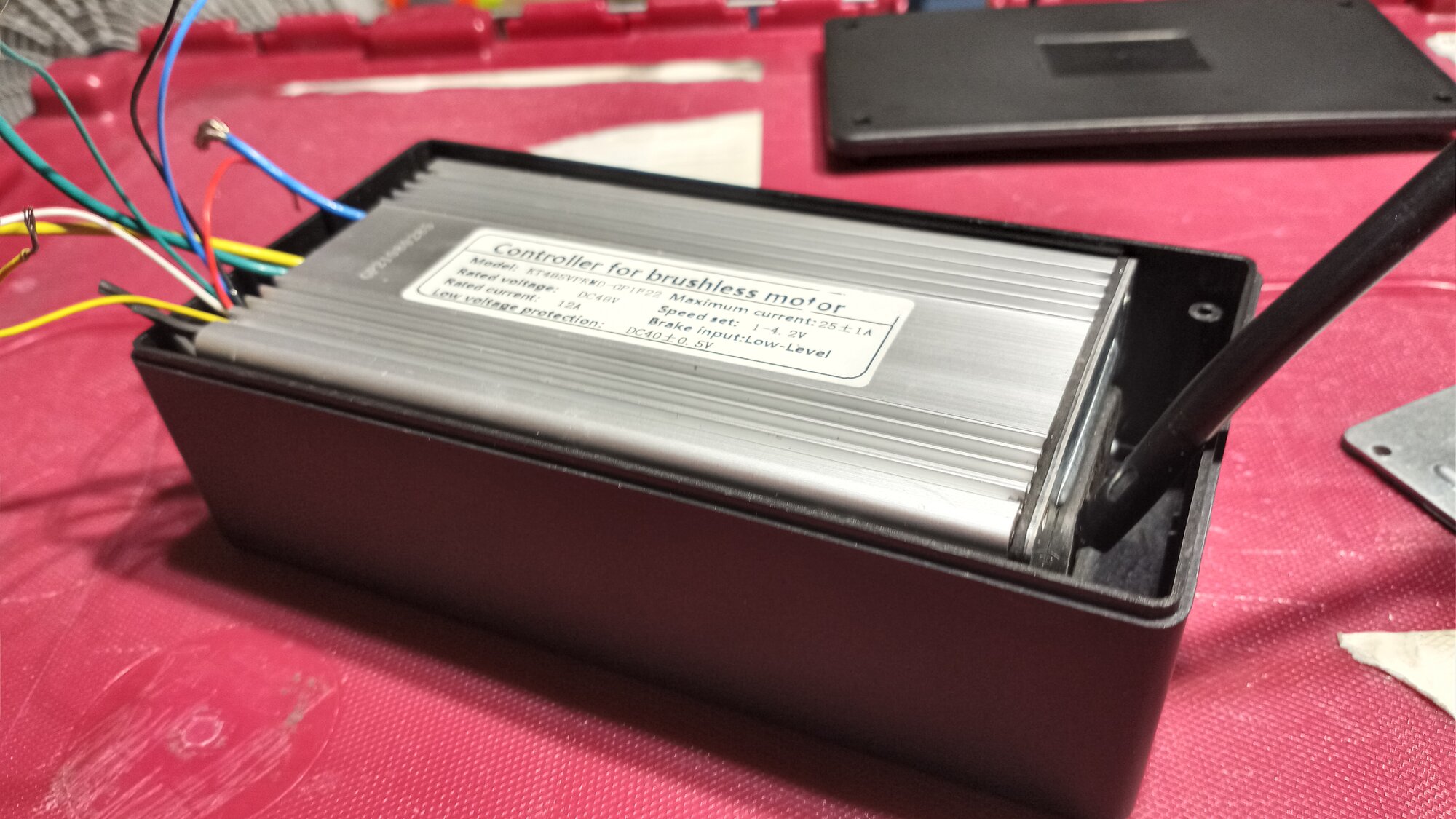

I decided to put my controller in a waterproof box, and had to wait a few weeks for it to arrive.
I used the same box as @jkvt to make sure that it fit inside.
@jkvt mentioned that the controller is a little bit too tall to get the lid fully closed, so I cut the spacers off the lid and the bottom of the box to get the lid fully closed.

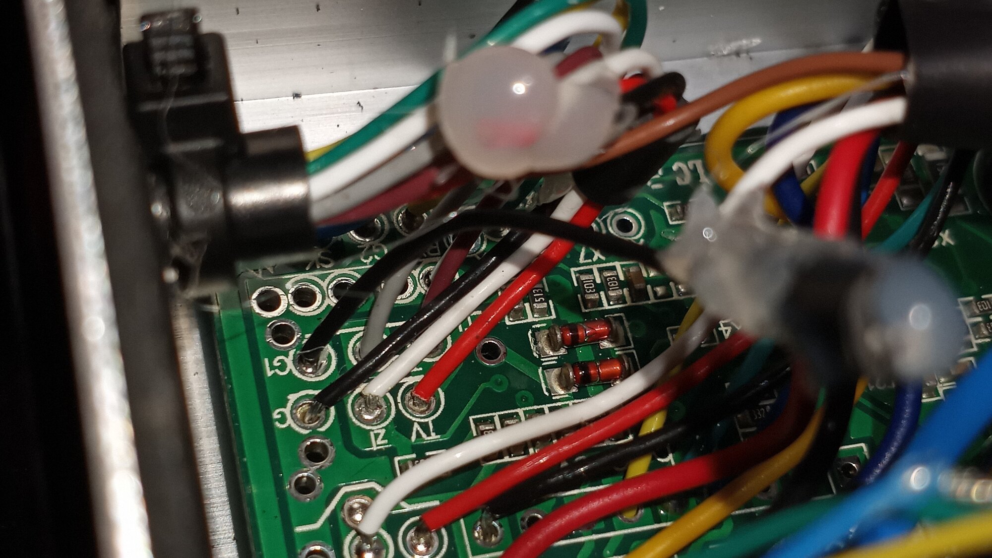

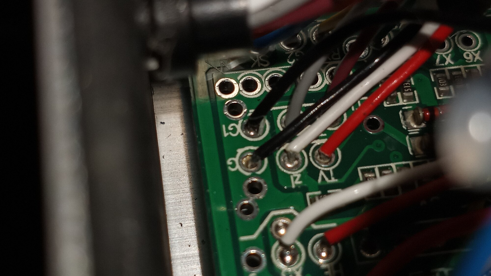

I also decided to not use PAS or my headlight output, so I cut the wires off inside the controller and sealed them up with hot glue.
I left enough wire length inside the box to be able to reconnect the wires if I ever want to hook them up.
I should be able to install a relay for the lights inside the box to power up stronger lights and a tail light.
Maybe even brake lights at some point?

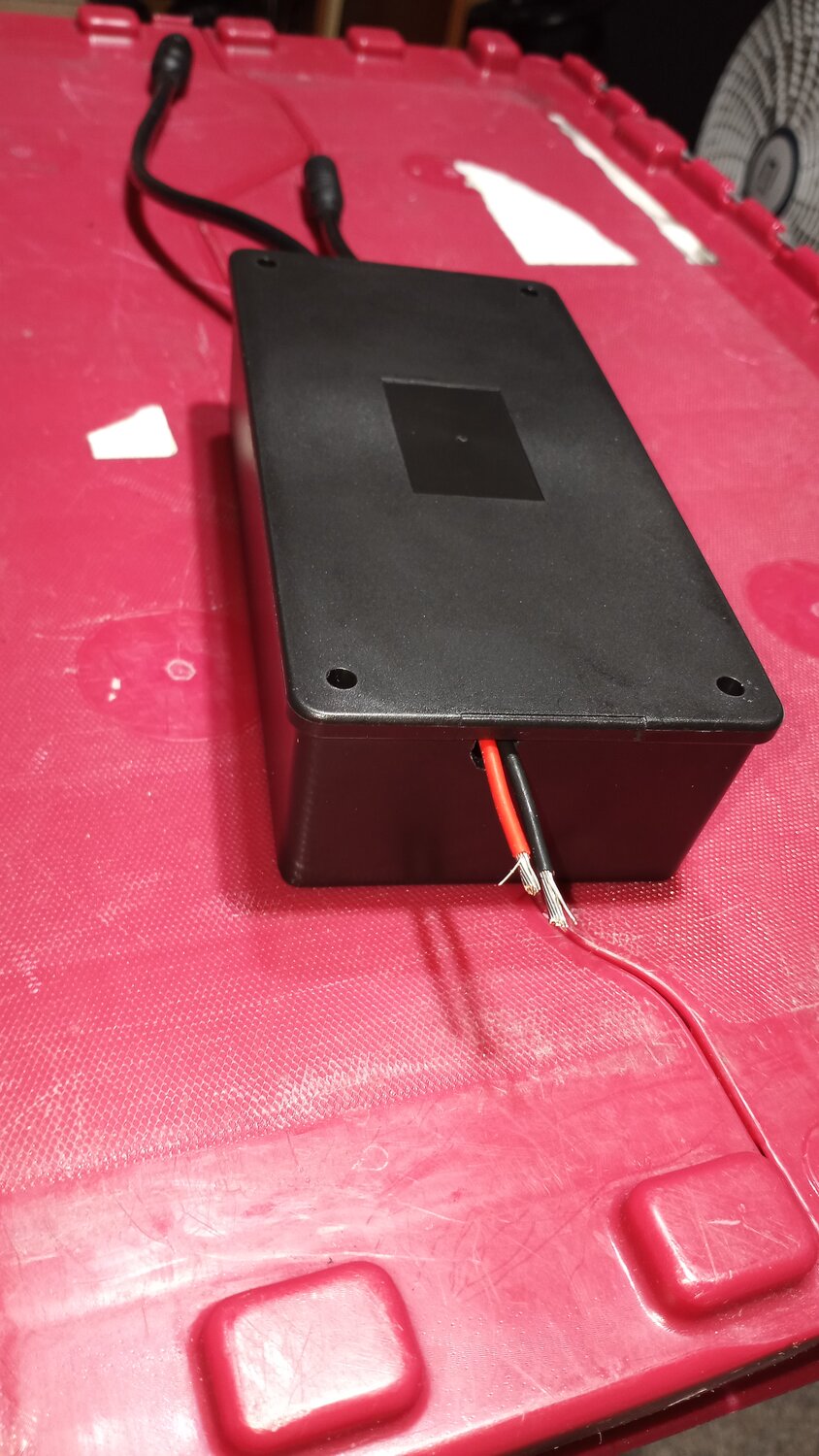

20230223_114803.jpg20230223_114910.jpg20230223_123659.jpg20230223_124035.jpg20230223_124156.jpg20230224_134001.jpg20230224_134047.jpg20230224_134114.jpg20230224_172359.jpg20230224_172431.jpg20230224_173011.jpg
I've still got all the wires to solder up, but I've figured out how I'm going to put the box together and I bought some 4:1 shrink tube with glue to get everything sealed up nicely.
Looks good. I guess it's a matter of personal preference, but if it were me, I would be hooking up the PAS, especially as I believe that controller has quite a bit of setup flexibility including this "simulated torque sensor"? If you don't want to use it, you could always turn it off (PAS 0?). Looking forward to hearing how it works out!
Looks good. I guess it's a matter of personal preference, but if it were me, I would be hooking up the PAS, If you don't want to use it, you could always turn it off (PAS 0?).
I didn't want to bother drilling another hole through the controller and the plastic box for the PAS sensor or the headlight.
