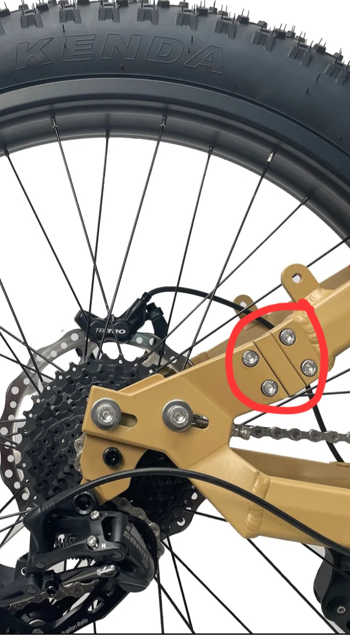

I found that sliding the axle plate (which contains the locked axle) back and forth, as little as 1/8" difference makes a big difference on the speed sensor magnet of the rear wheel so it does not work correctly and throws an error code..
In the above photo I ripped off, Thanks PCebiker,
you can see the 2 silver bolts, and at 3 o'clock, the adjustment bolt for sliding the axle plate, behind the 2 silver bolt heads, to see what I am talking about.
The end of the Black axle bolt is just above the shift cable and holds the other side plate on both sides etc. (The red circle has no bearing on what is being talked about).
I went back to my log book and found the original setting, measured from the back of the plate to the screw shank and or just change the wheel magnet distance setting from the tire rim..
Reset this distance and NO code 21 showed up, moved about 1/8" and the code showed again, so now I know what and how this happened. ymmv
Hopefully, your magnet or sensor is adjustable so that you don't pop a code in the field when you deploy your chain tensioner.
