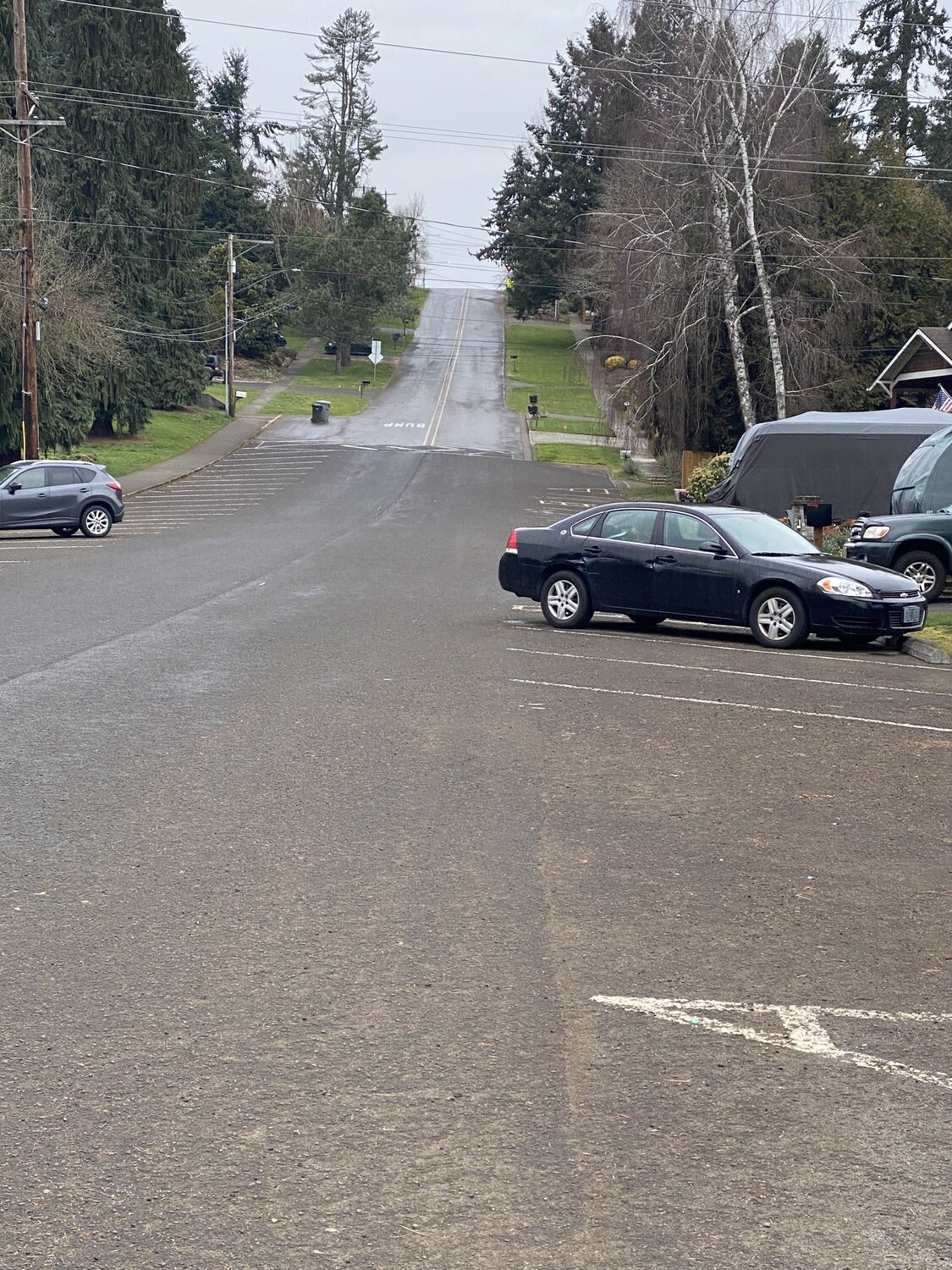

you sure you got a 29% grade thats extreme steep. here is a 18% grade I road today and took a lot of effort on my bosch.
